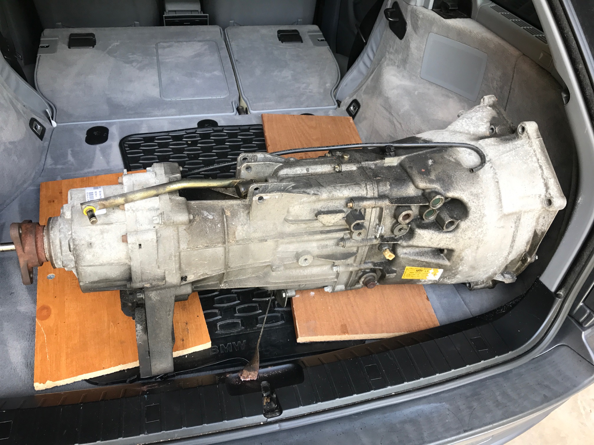

    Mandatory pic when doing such a swap..

        #46
        The trans looks long but remember that the xfer case is attached still. I took it all out as one unit. So it does look enormous
          That's what she said...

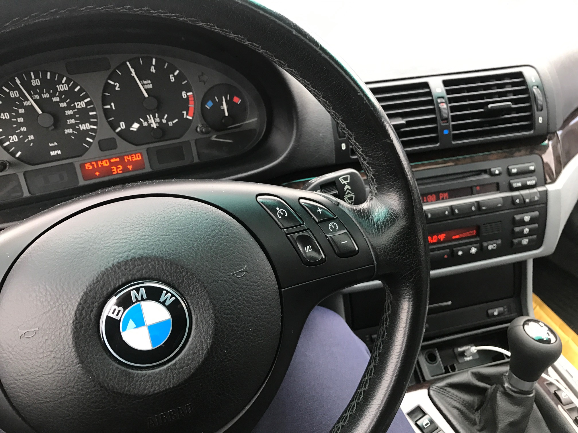

                                          This is likely the last post of this thread until Spring season when I start to do some not-very-interesting-but-required aesthetic mods like tint, wheels, black out the chrome window trim, kidneys, etc.
                                          So the car is officially on the road and overall driving great. Blizzaks were mounted yesterday. Still has a CEL for a bad o2 sensor, and I have noticed a couple things now after 150 miles of driving that I'm going to deal with. I used MT-90 fluid in the transmission and I believe that's a bit too thick for the cold climate as when the transmission is not warmed up, it's pretty fussy about the gears. This week I will be putting in MTL instead which should be more viscous. The rear passenger shock is blown and leaking so I have 2 new rear shocks on the way from FCP right now and will install those this week as well.
                                          Overall I'm pretty much ecstatic about where the car is at right now and have been taking excuses to drive it whenever possible. Obviously working from home doesn't give me a lot of reasons to go out, but I'm trying to find them anyway because for the work I've put into the car, I'd like to enjoy it a little bit. It's crazy how much more engaging this thing is with a manual transmission.
                                          Pic for posterity - yes it makes it up to 5th gear and does freeway speeds:
