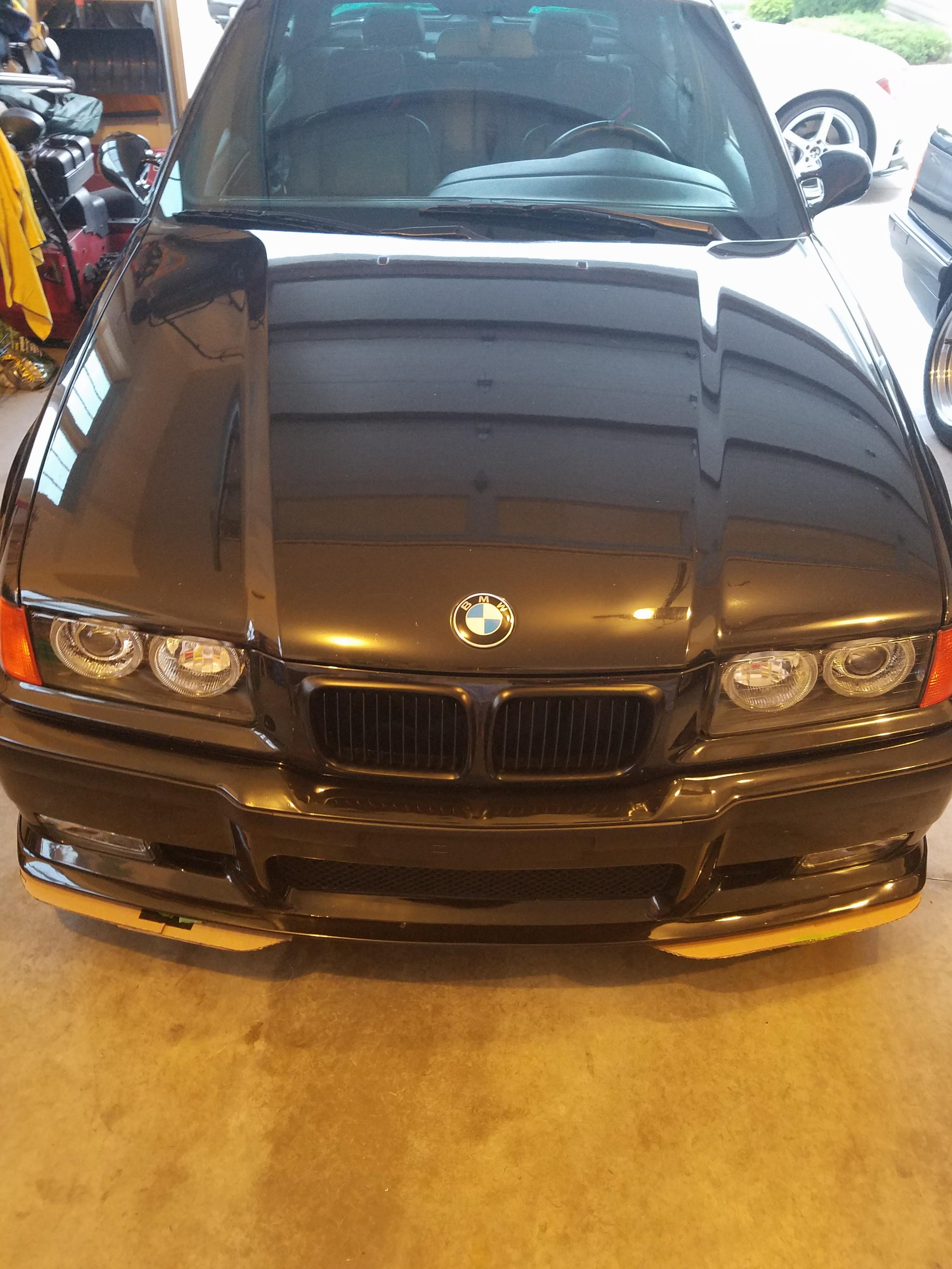

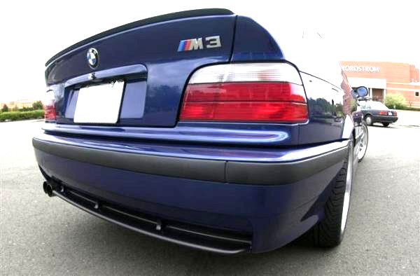

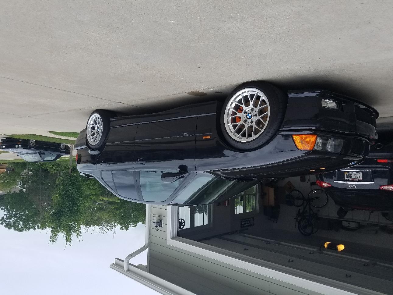

                                Finally got the clutch back up and running.  So, figured I should show a few pictures after a wash and wax.  No idea why they show up crooked.  I rotated them and re-saved after uploading but they're still messed up.  Oh well.
                                Next project is to get a new trunk on.  I'm not a fan of the huge spoiler on there.  I found a nice white one without a spoiler at the junk yard.  Got to strip it and paint it then I'll go with that and a smaller m5 style lip like shown.

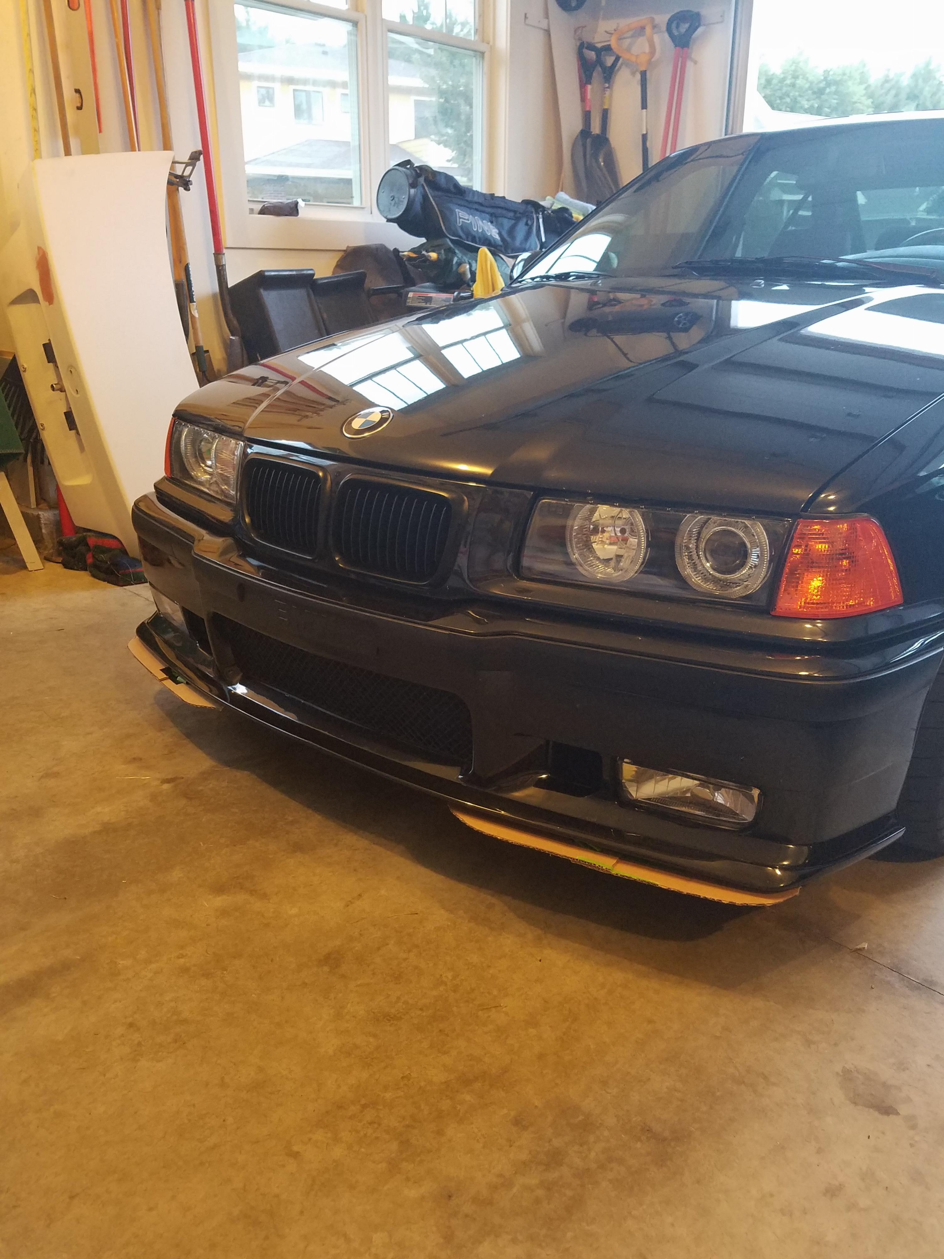

                                      #98
                                      Wife gone, proper garage.  Also, mocking up some splitters I'm gonna make.  Thoughts?
