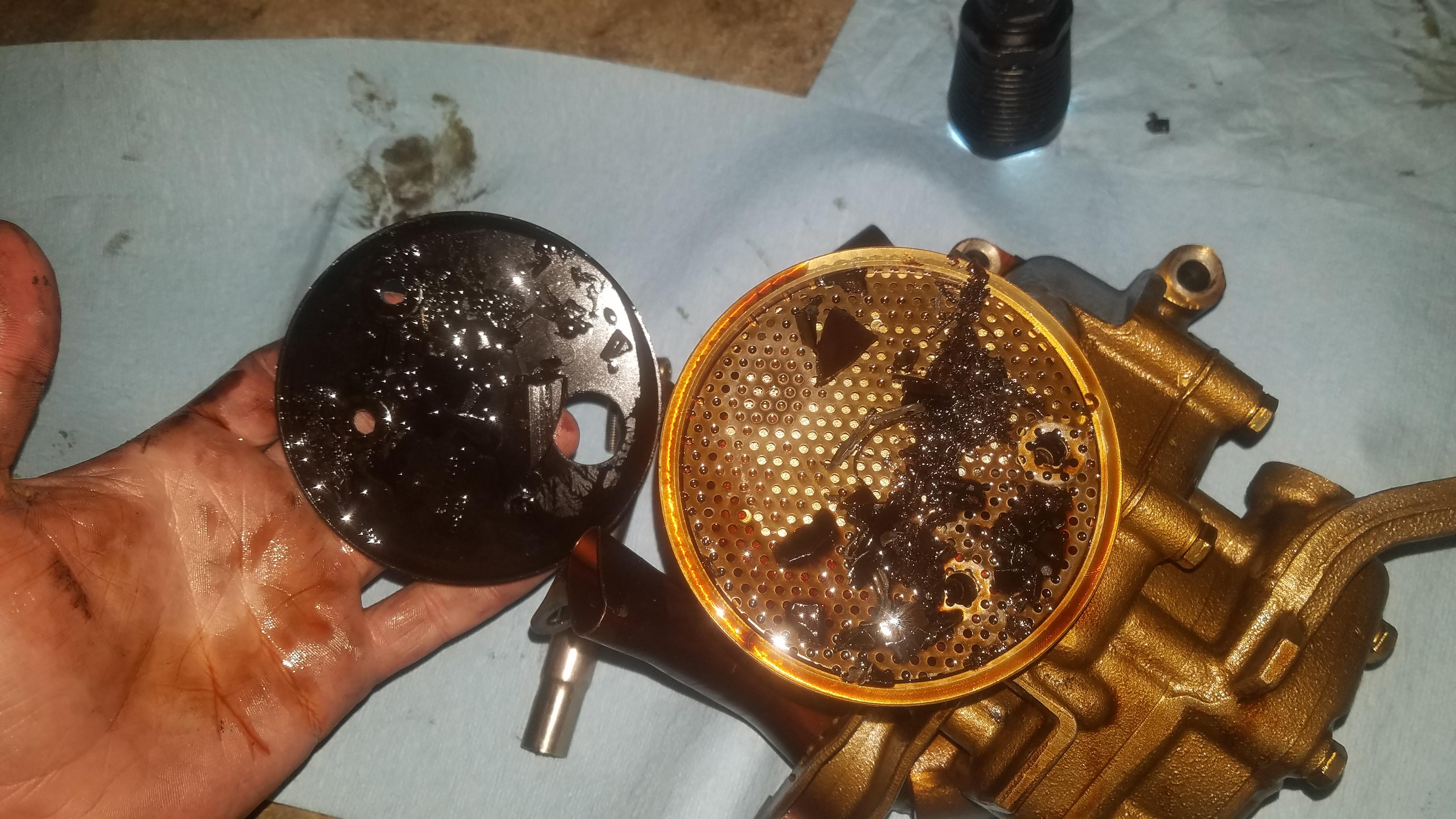

                                    So here is where all of the little pieces of timing chain guide went... that's pretty f@cking terrifying. Really hoping this screen and the oil filter have done their jobs lol.

                                      #38
                                      holy shit. I don't have a better response for that image lol

                                        #39
                                        Were there any loose bolts on the pump too?

                                          #40
                                          The bolts that hold the pump itself together? Or that hold the pump to the engine? Either way they were all tight.
                                          I think I'll be doing an oil change after the first 50 miles just to try and get any left over pieces out, or at least a filter change.
