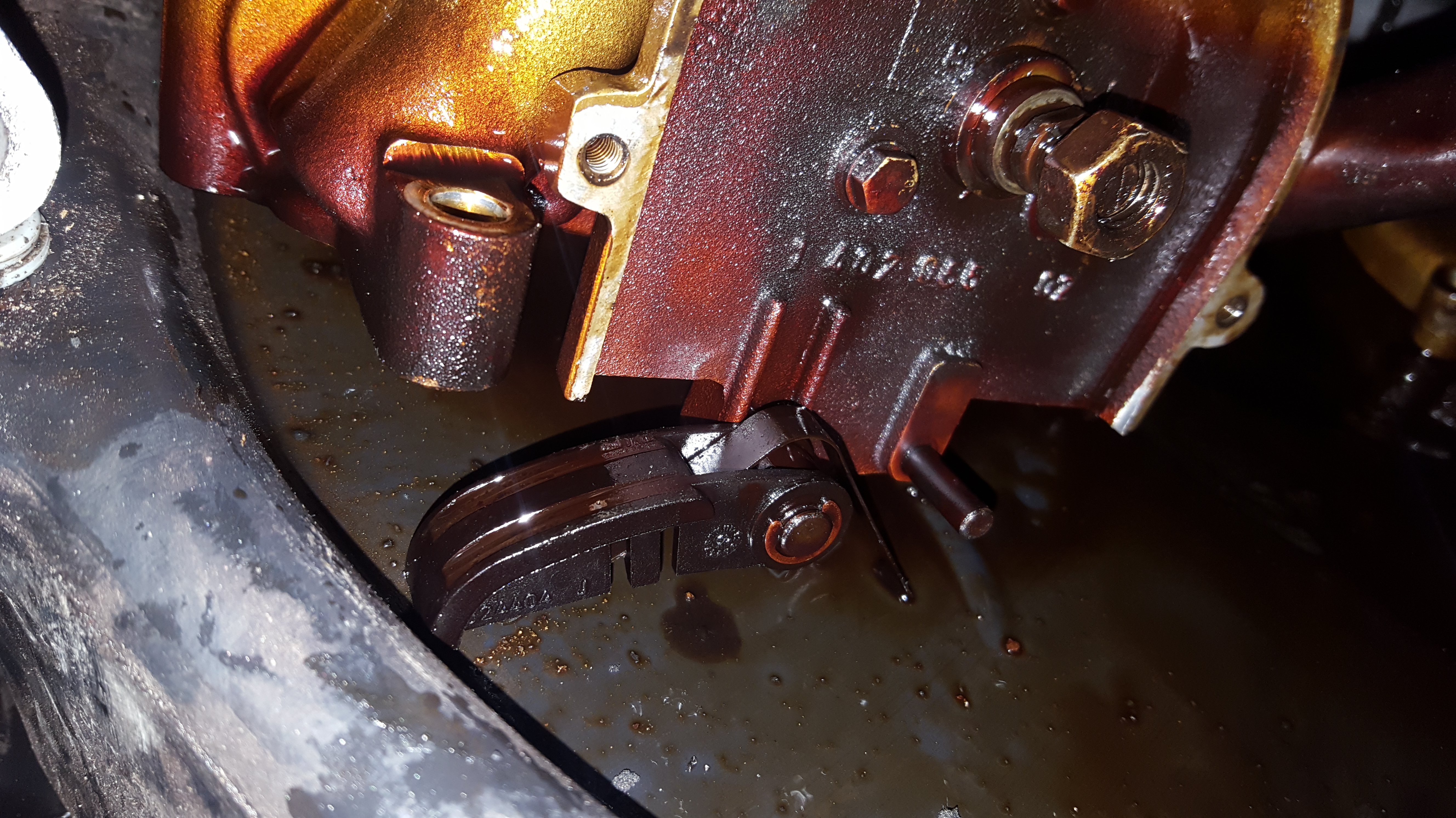

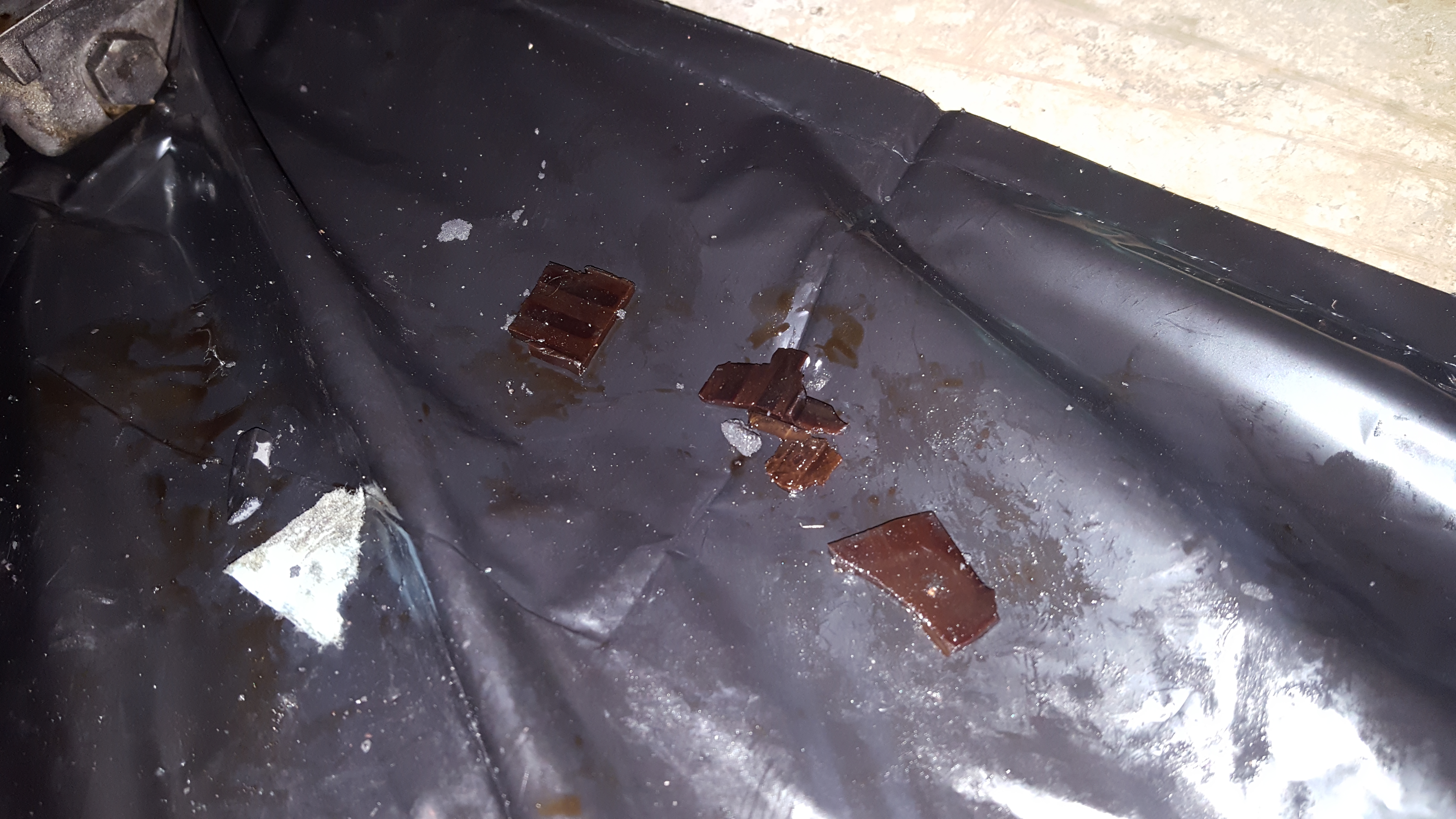

    This is when you find the oil pump driveshaft sitting on the workbench

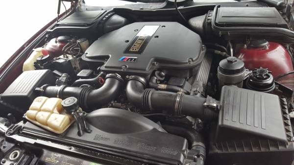

        Started the M5 last night! Runs and sounds awesome 😁 I'll be getting plates for it today after work, can't wait to put some miles on it! I'll try to get a quality video/pictures this weekend maybe. 😎
