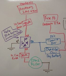

                                        since i stole back the 12v power, i needed to wire in the electric fan again. for starters, i wired a relay to be powered by that same 12v washer pump (on with ignition position 1) and to be switched by the stock AC fan switch. if i hit the ac button, the elec fan now comes on. I have to finish at some point by wiring it to the temp switch as well.  the only thing missing from the harness here is the ground wire from the elec. fan, as it went straight to the chassis ground that is nearby.
                                        noob electrical question - can i have two sources for the switched power of the relay? i.e. have the physical AC button and the temp sensor both spliced in right before the relay, so that if either is active the relay will energize? or can that 12v coming in from the wrong side of the ac button switch when the temp sensor activates cause a problem, and vise versa?

                                          The thermo switch and override switch should be in parallel from the same power source like the example shown below I cant see a reason why it would be an issue if the power is from two different sources and each circuit would run at half the current when both switches are made
