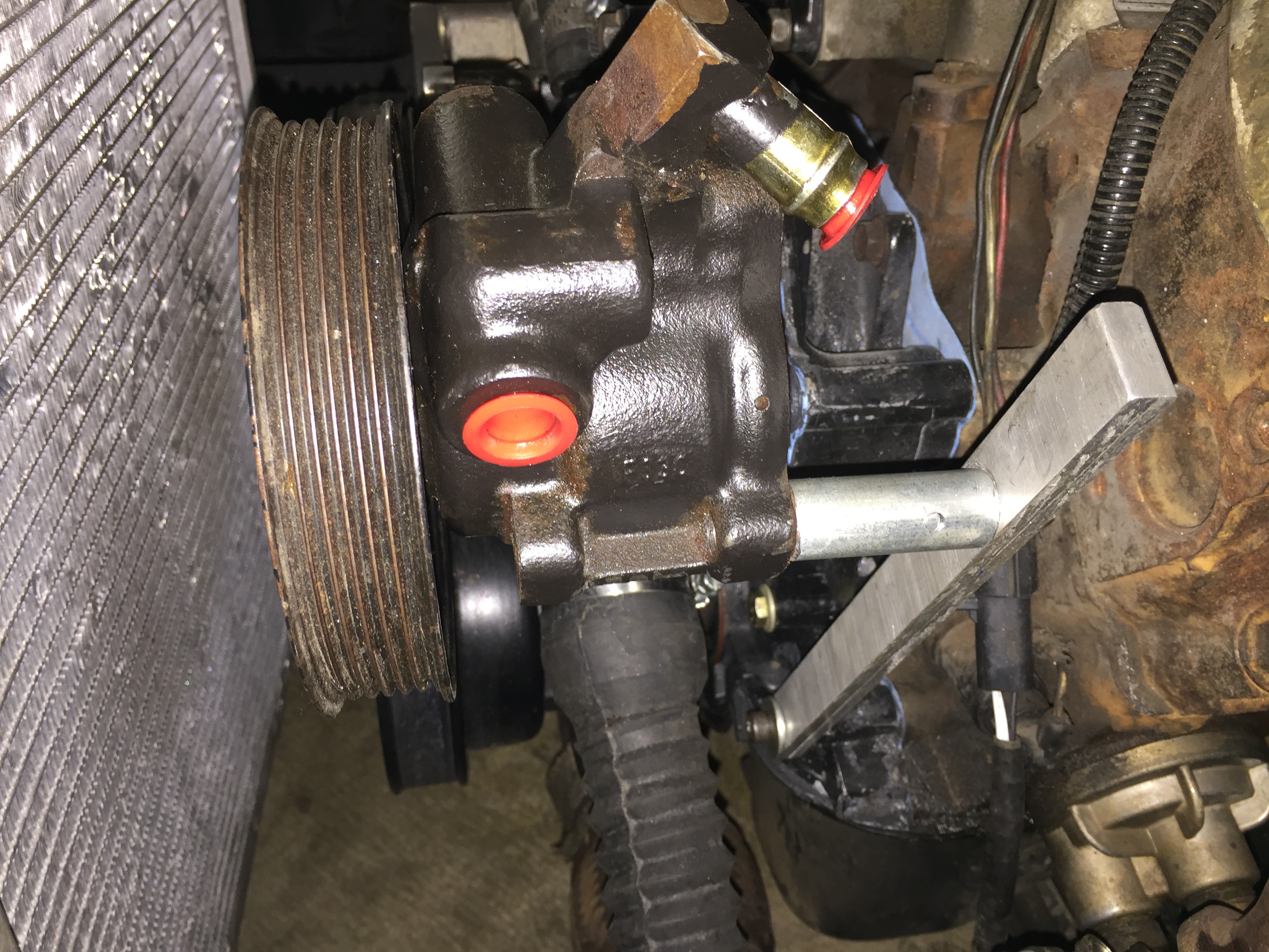

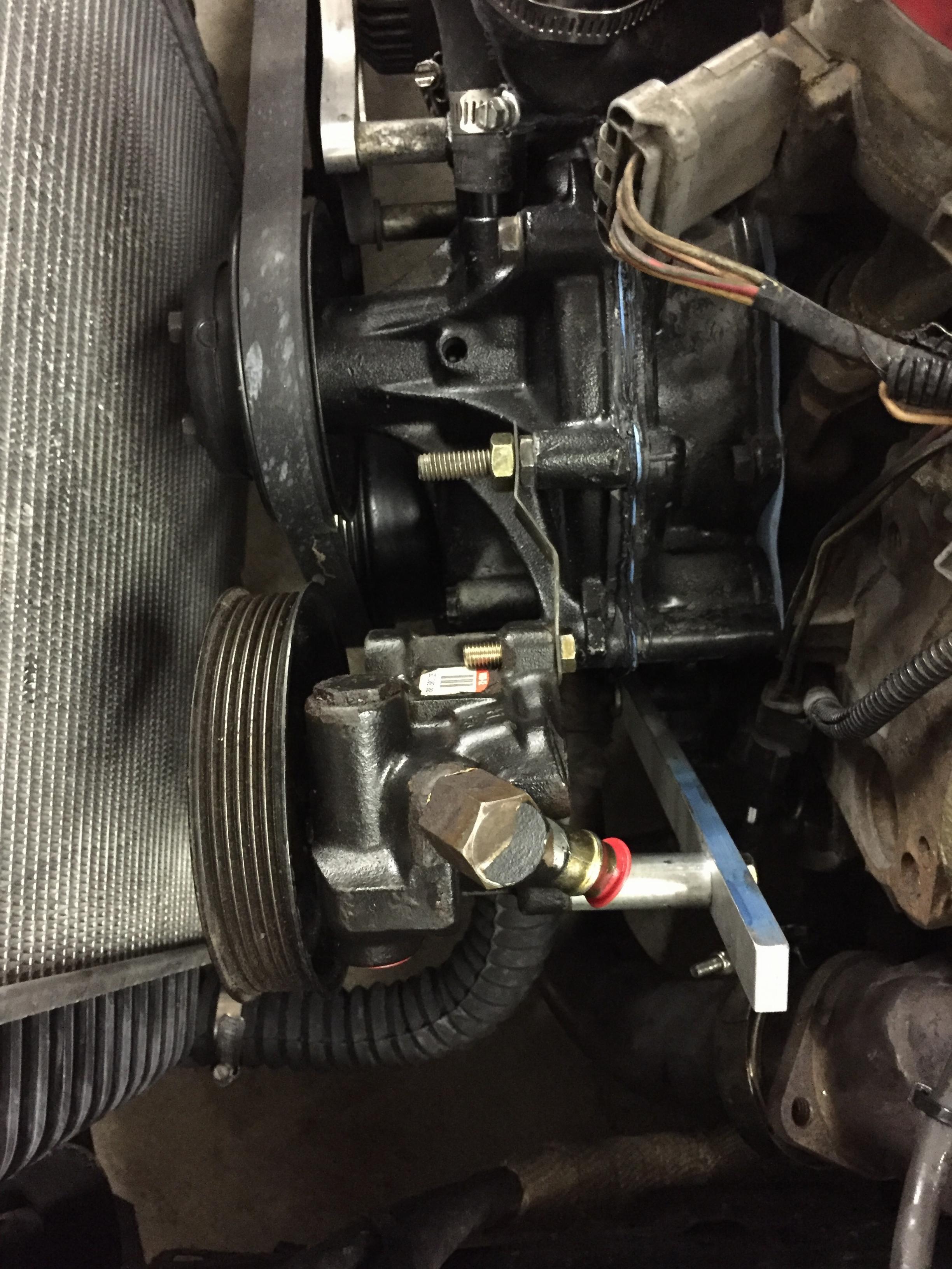

                        Okay, so more progress on the water pump/ power steering issue. When I got the car the guy gave me a bunch of random parts and boxes he had sitting in his garage that went with the car. In one of those boxes was two of what I believe to be late 90's V6 vulcan Ford explorer power steering pumps. Since looking for any information about this Ford 302 motor is a nightmare because of 394853 different styles of everything, I just decided one of these pumps will have to do. I grabbed some various material I had laying around to mock up brackets to hold the pump in place. From here I plan on making something a little more acceptable in CAD and machining it. This is what I cam up with so far:
                        High quality, I know. But its serving its purpose for a good mock up. I don't really have to worry about adjustability as there is a heim joint on the alternator to adjust the slack in the belt.

                          On another note, I am finishing the power steering brackets today and should have that installed tonight. I also started looking into paint treatments and photoshoppped some to make the car look more ratty. I think I might be using some red paint carelessly tonight....
