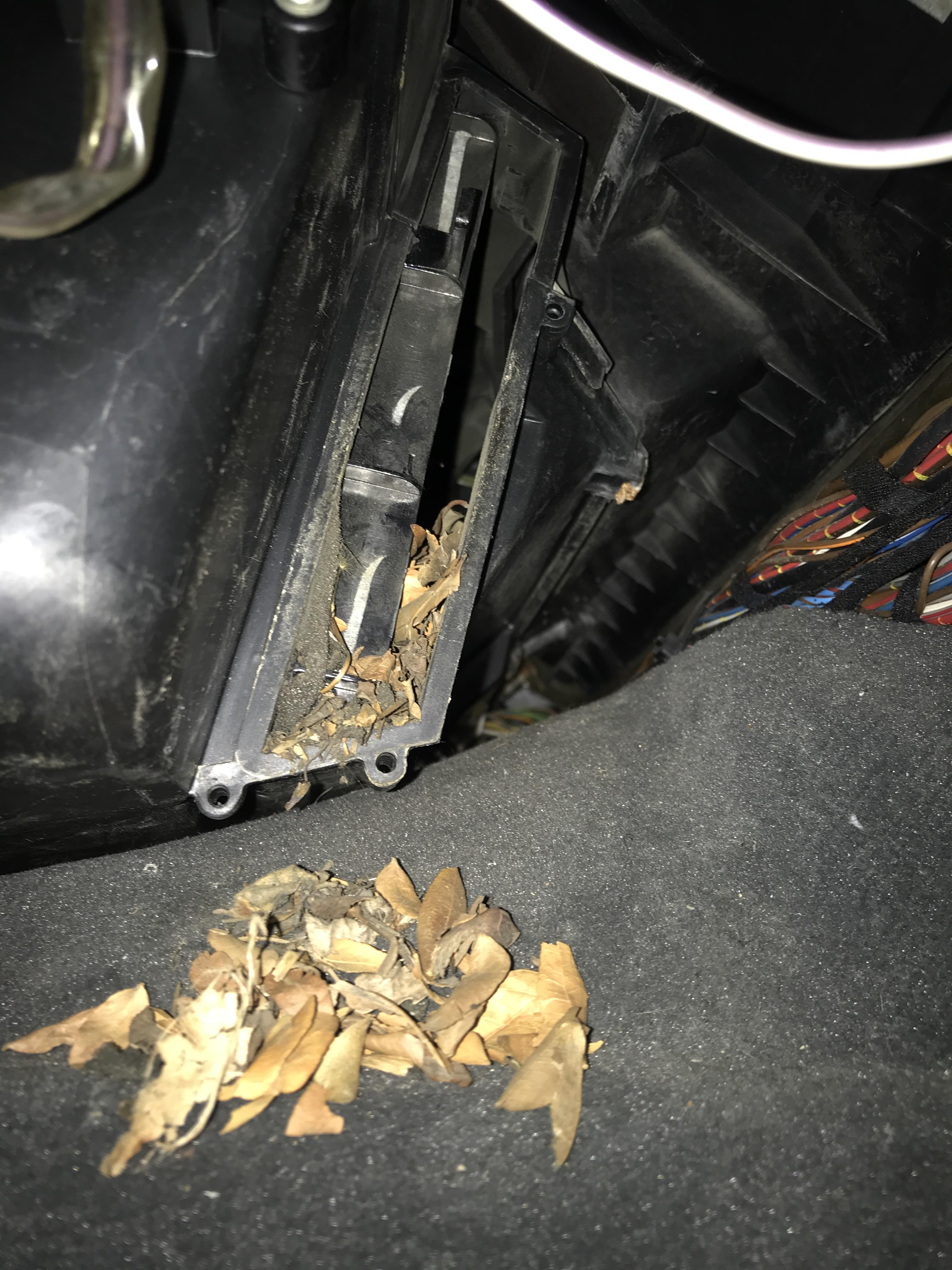

      I "THINK" I fixed the heat.
      I did a quick google search of BMW E36 with "weak interior heat" and found a video of a guy explaining that its a common issue. Turns out the fix was a new cabin filter.... DUH.

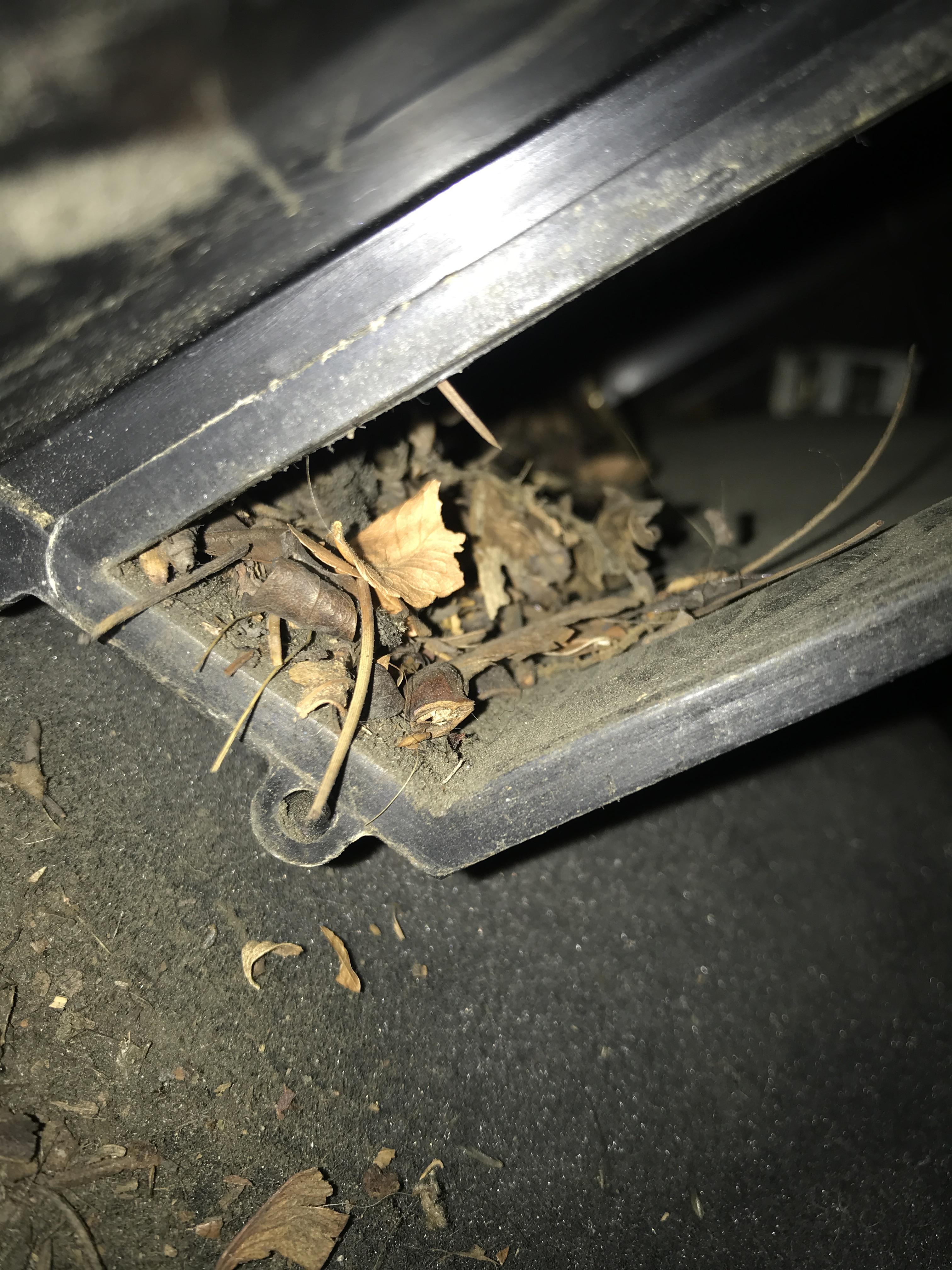

      So I pulled the glove box and half the dash apart to find this:
      Yeah thats about 10 lbs of leaves, dirt, nuts, and whatever else debris made its way in there.
      I reminisced that when I got this car it didnt have the cowl cover and the guy had this car sitting under a tree for over a year with the windows open. I needed to get a vacuum in there and suck out as much as I could before I even was able to remove the old filter. It was wedged tight with material and it wouldnt even move.

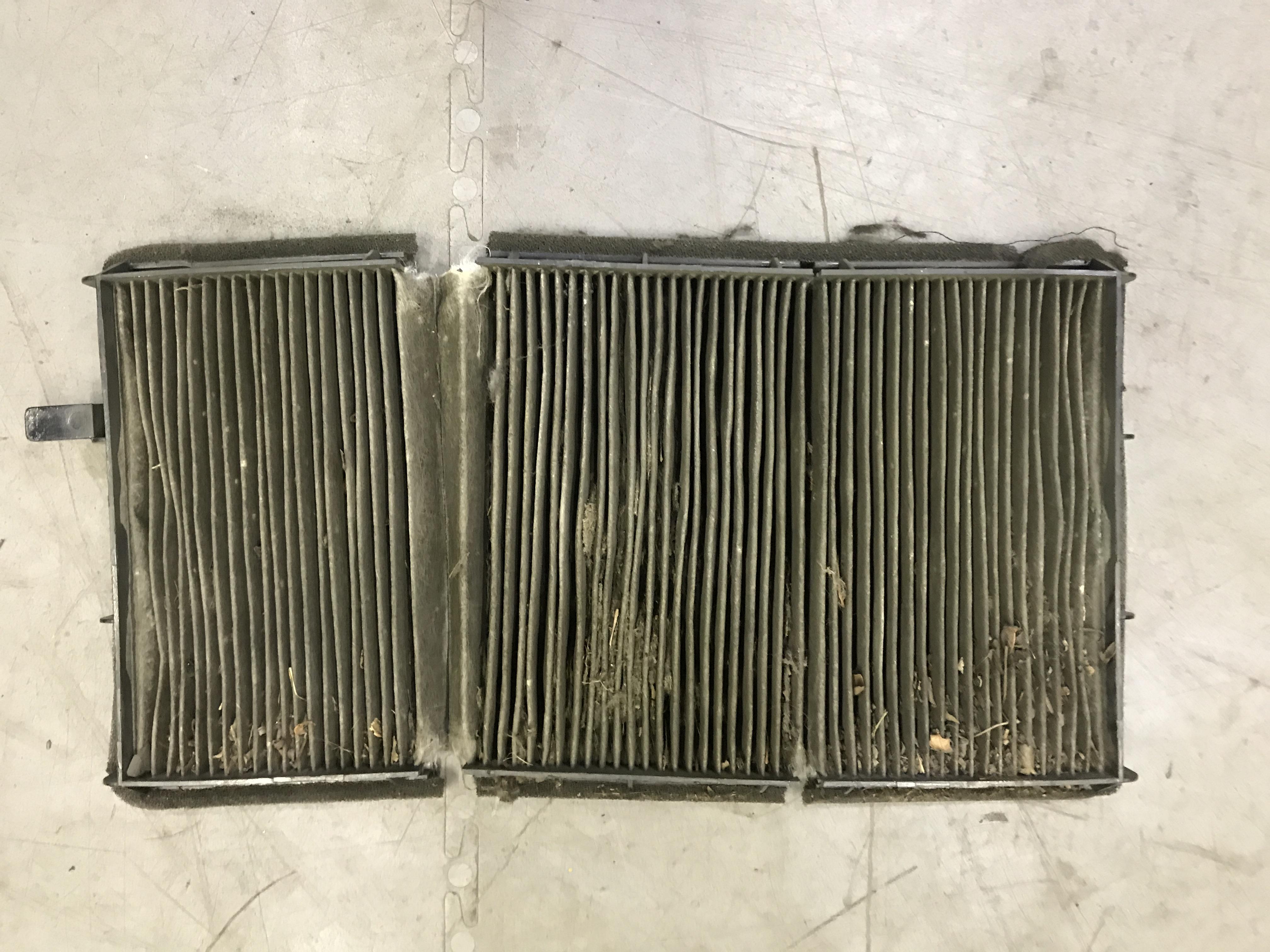

      When I got it out, this is what it looked like:
      $15 across the street and Oriely had me back in business.
      Image result for E36 cabin filter
      I have yet to drive the car aroudn and see if it makes a difference. BUT I will say just turnung the blower motor on, there is a DRASTIC improvement of the force of the air coming out of the vents. I want to add a simple patch panel to the floor and improve the hacked up trans tunnel to keep the cold air out before I start driving this more often in the cold weather.

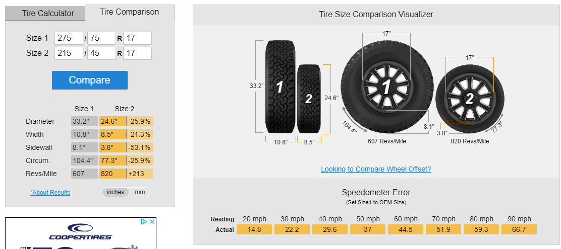

      Also, does anyone know if 275/75R17's will fit an E36?
        #603
        Tire fitment unlikely without saw/grinder action.  That is a big tire.
