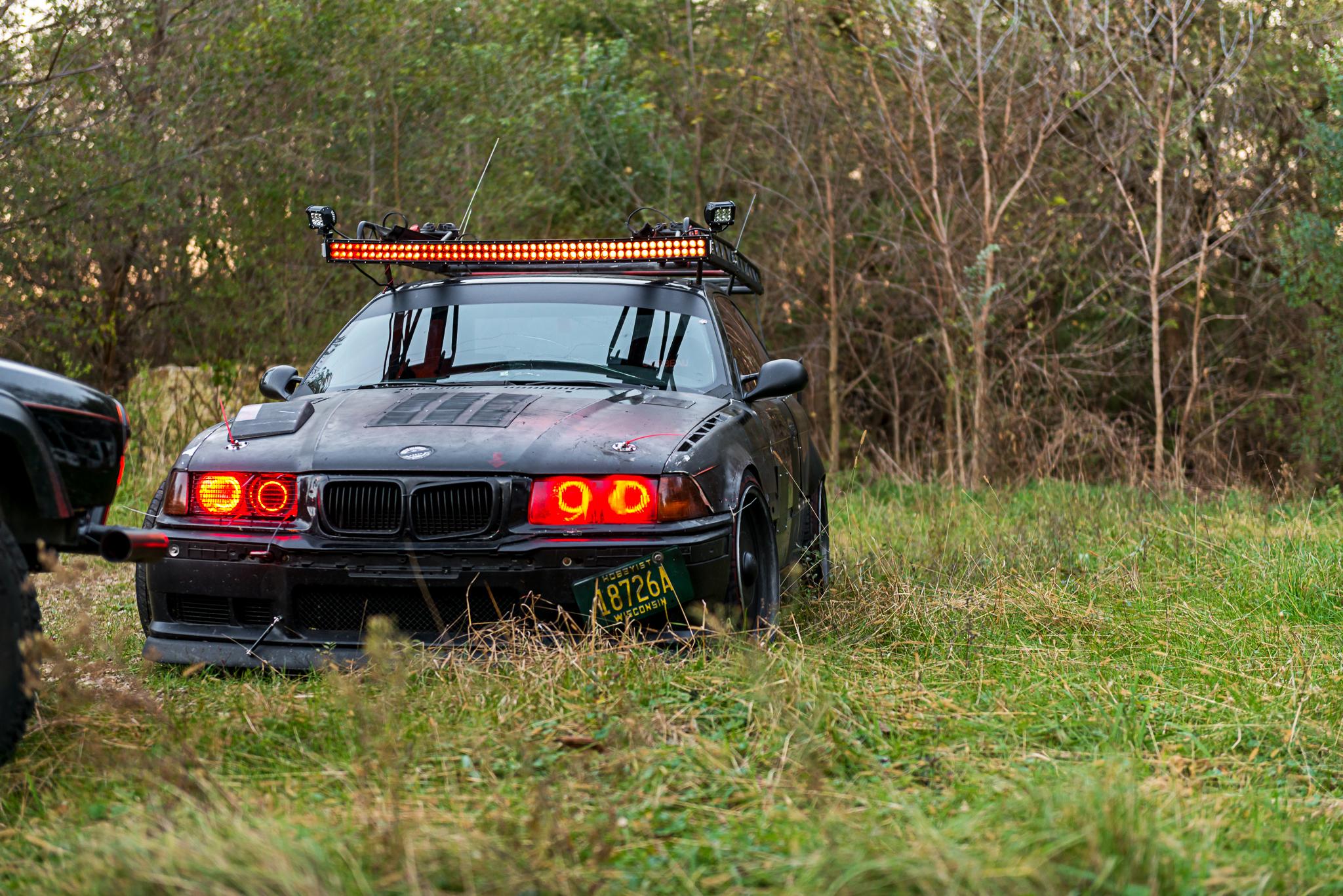

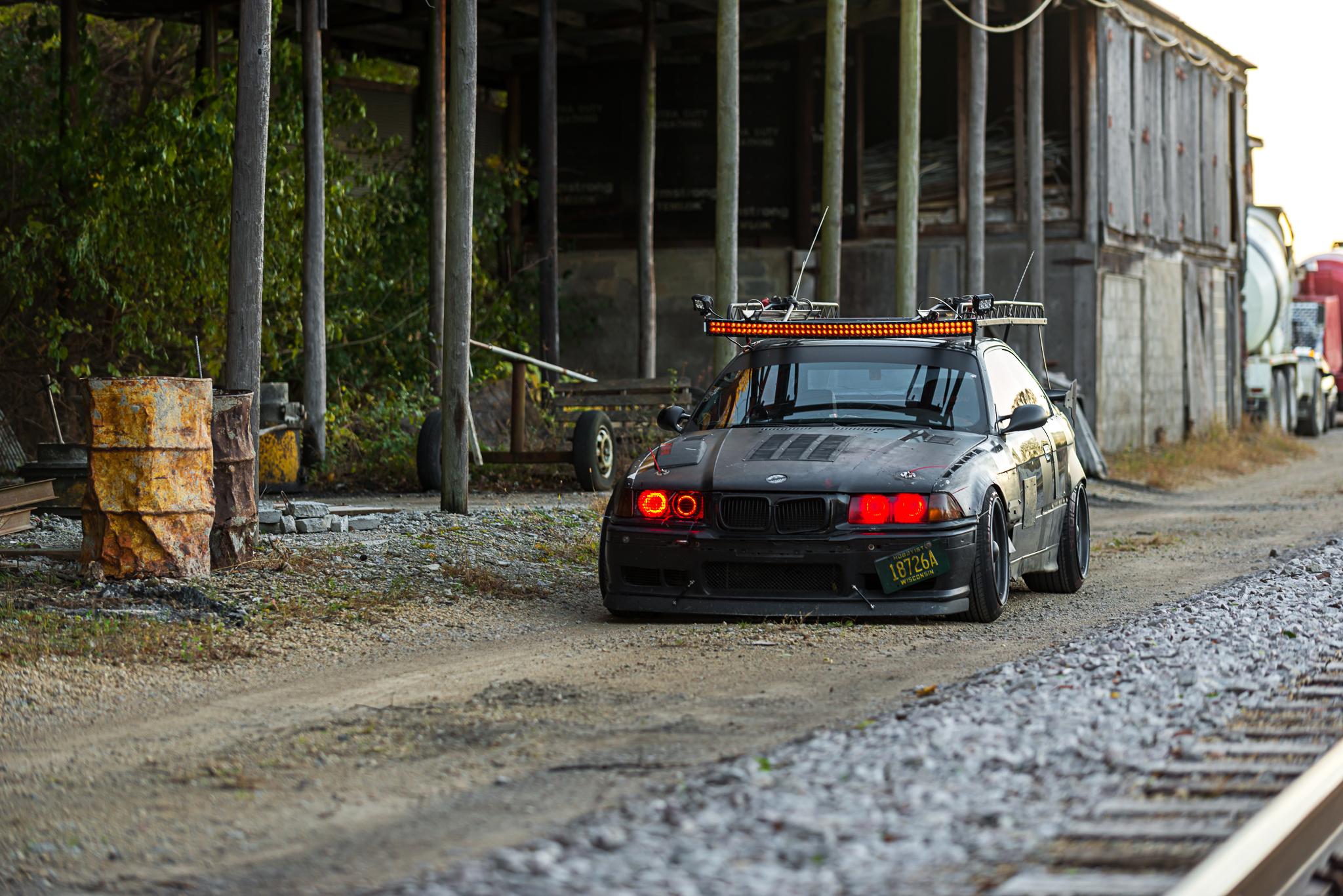

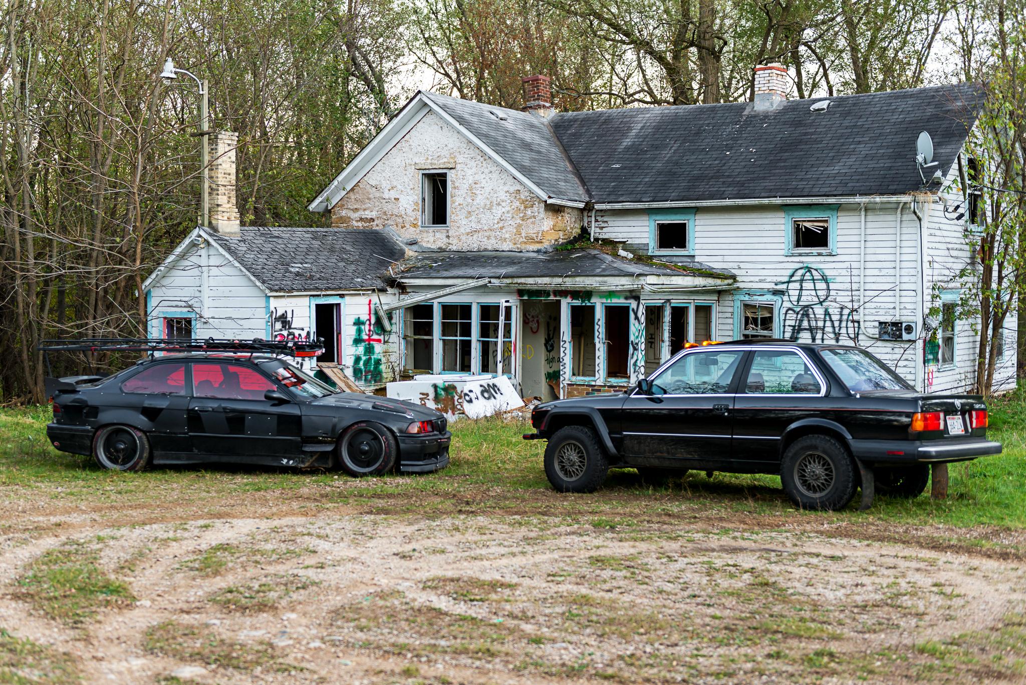

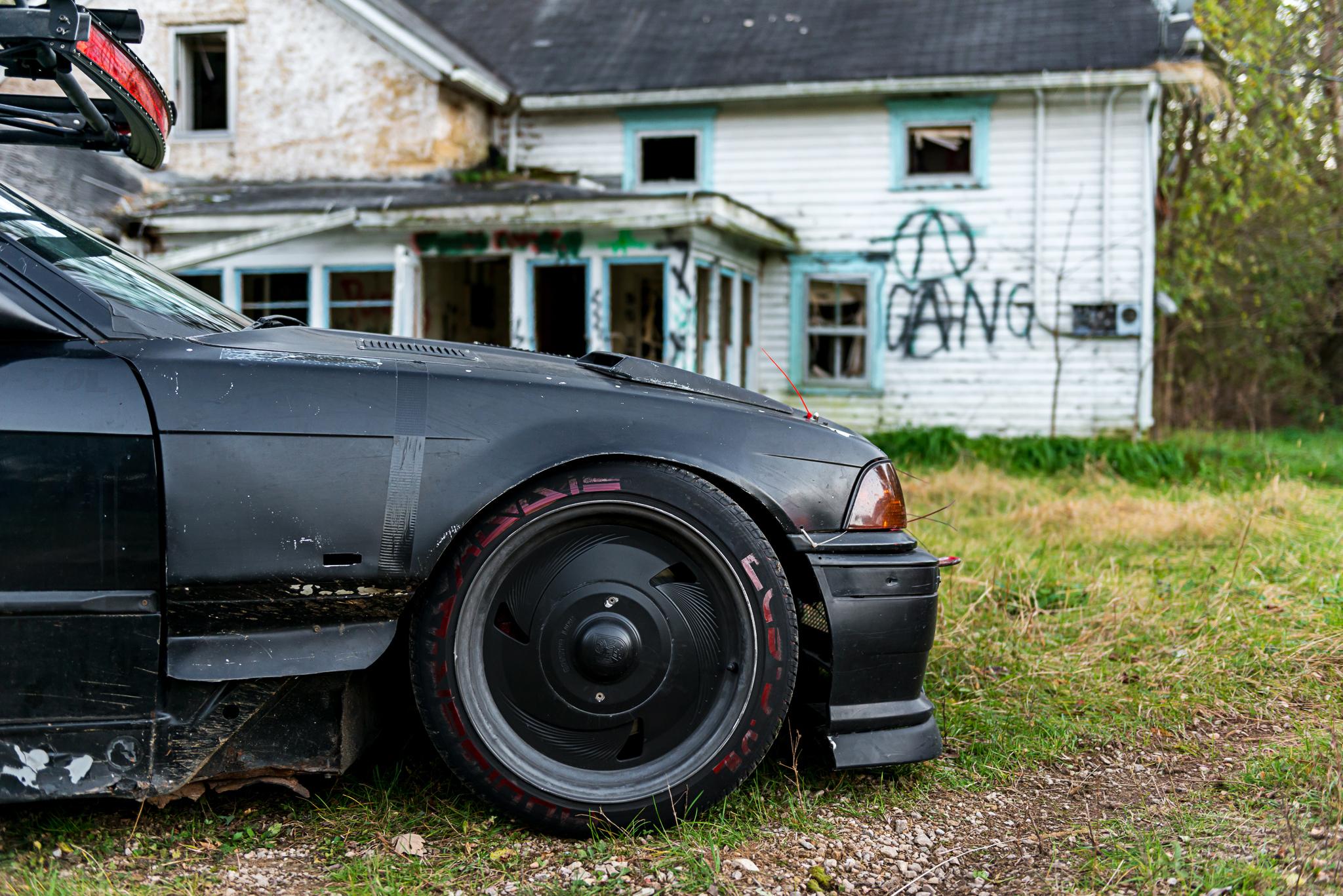

                              Finally got the rest of the images from http://noggsphotography.com/
                              20181021BMWShoot012.jpg20181021BMWShoot013.jpg20181021BMWShoot021.jpg20181021BMWShoot022.jpg20181021BMWShoot018.jpg
