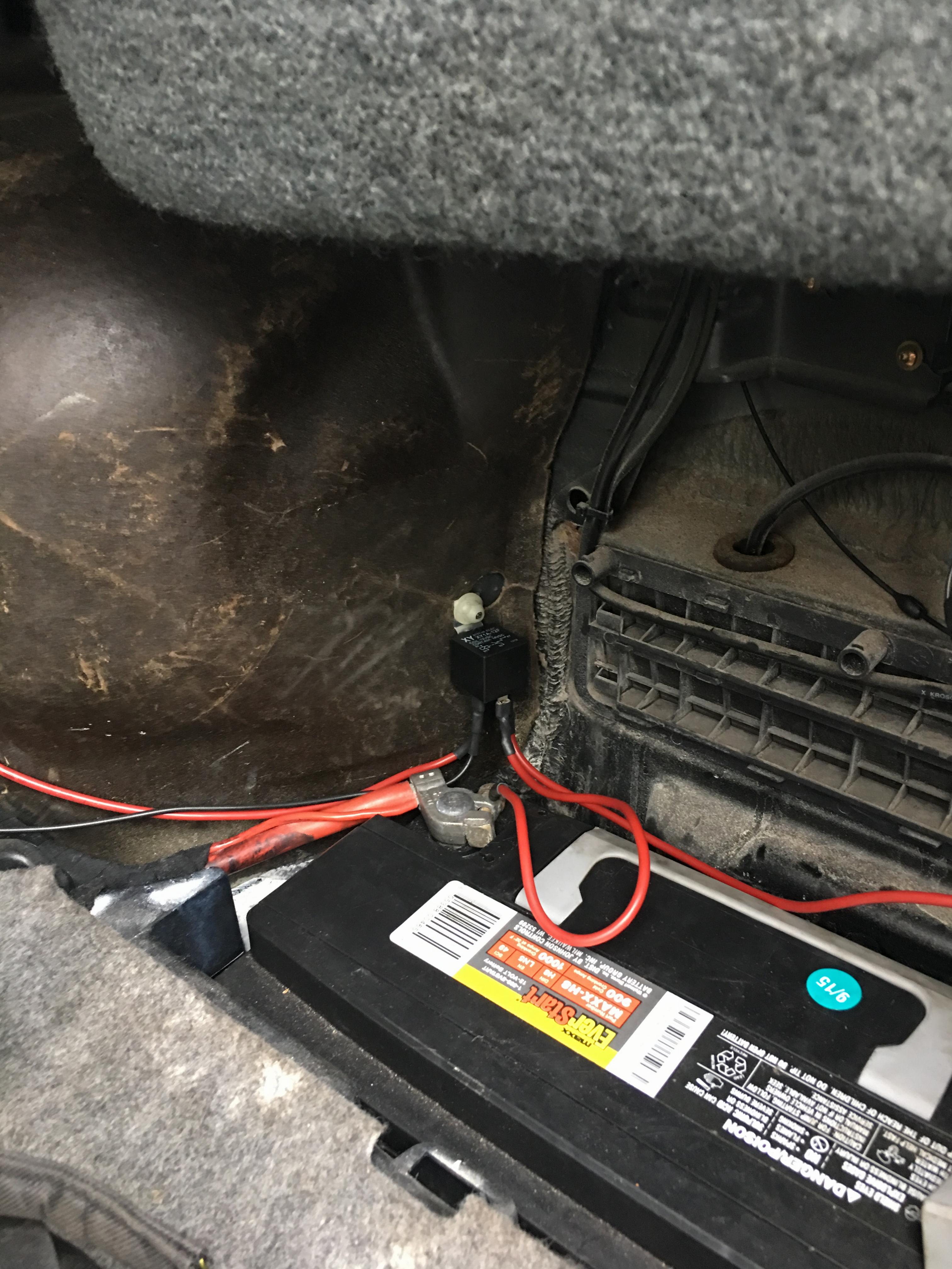

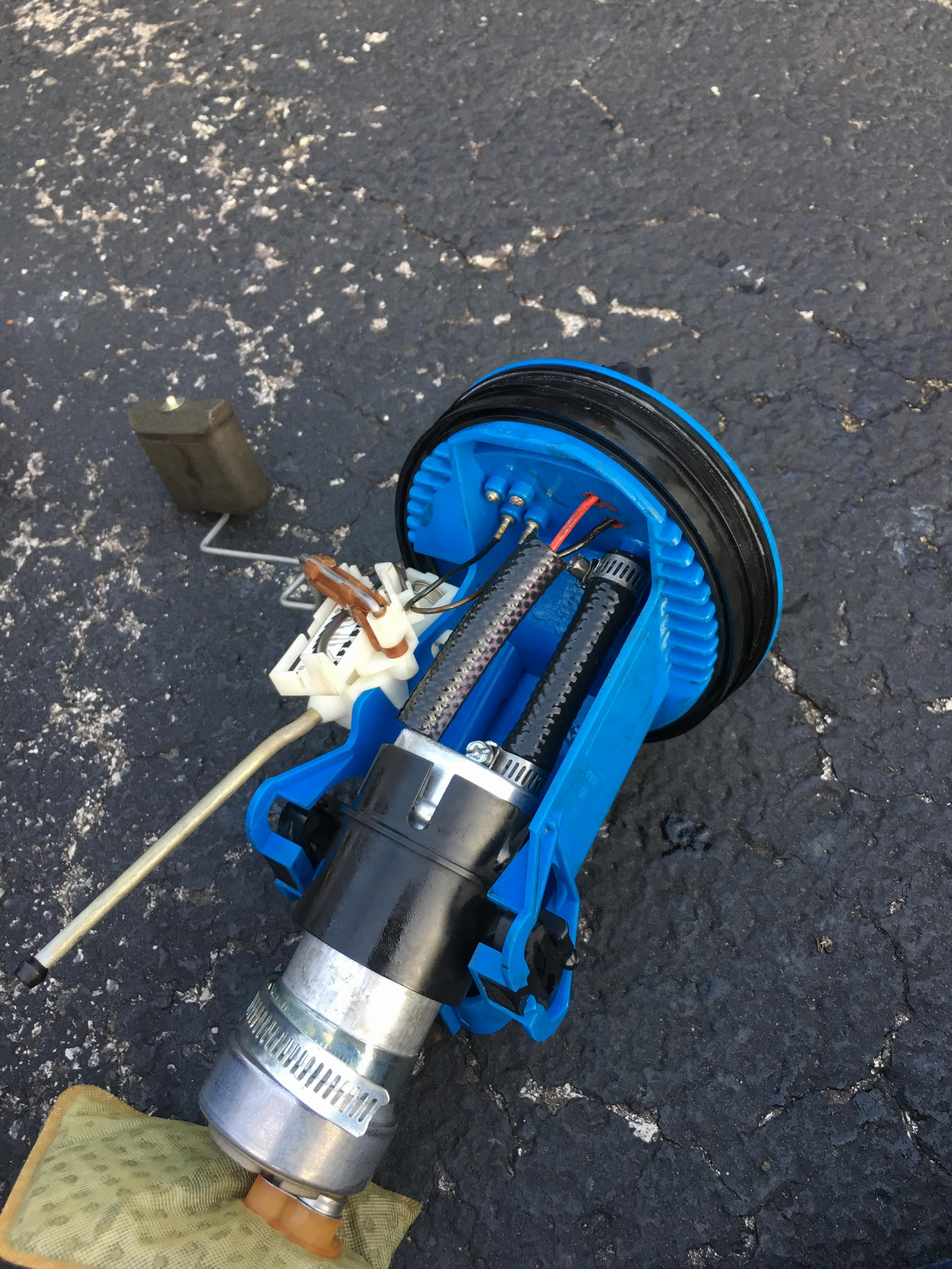

                  Well any progress is good as Jason would say.

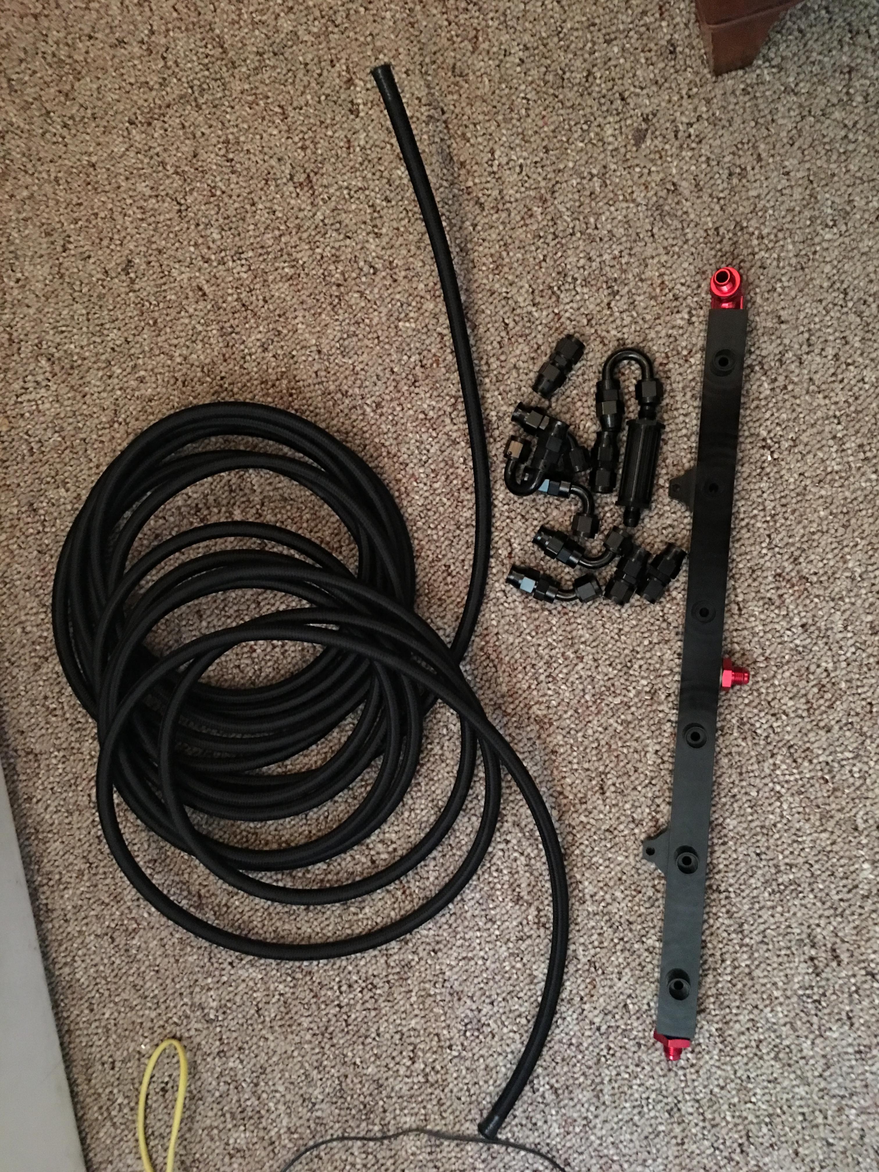

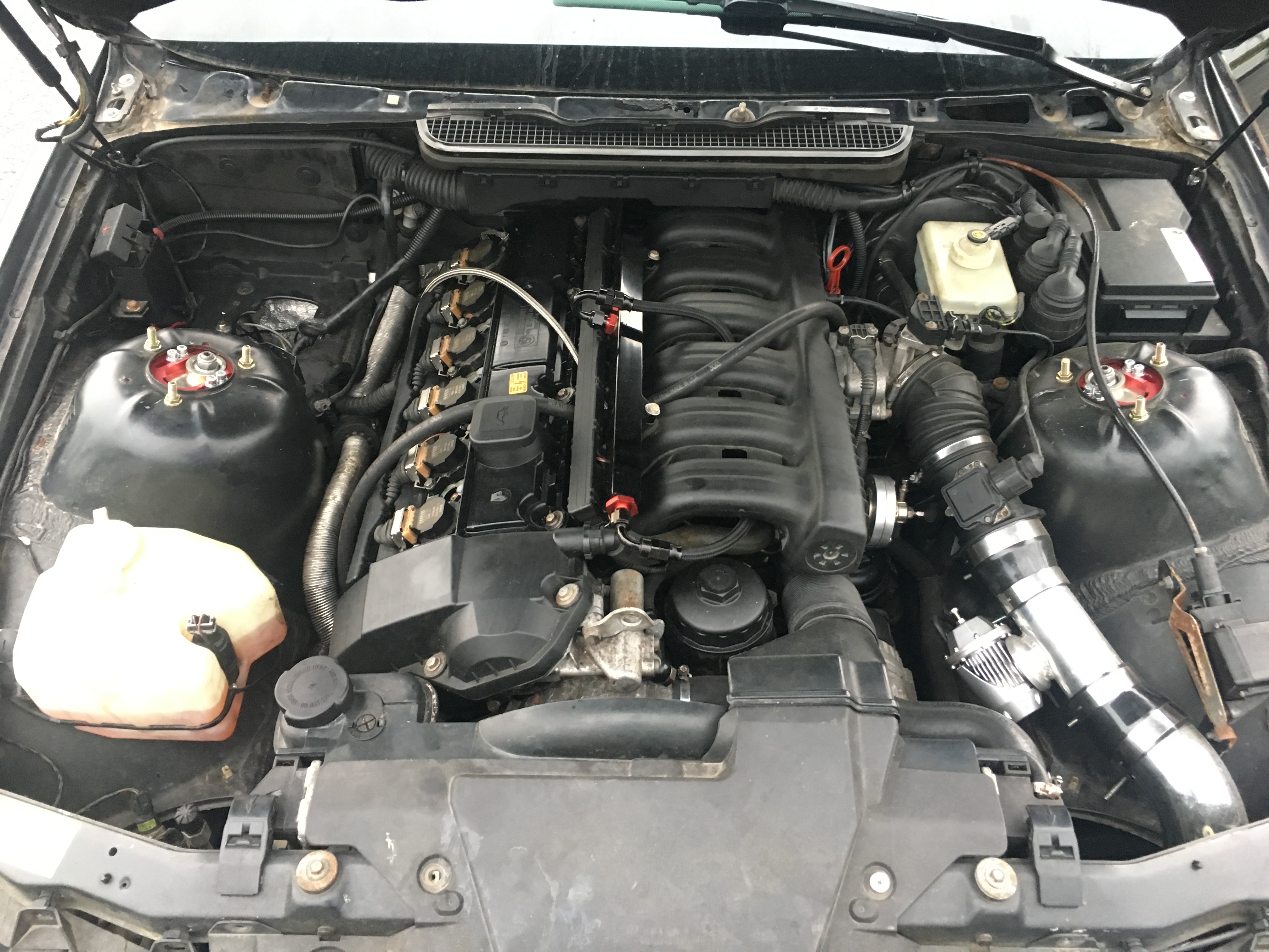

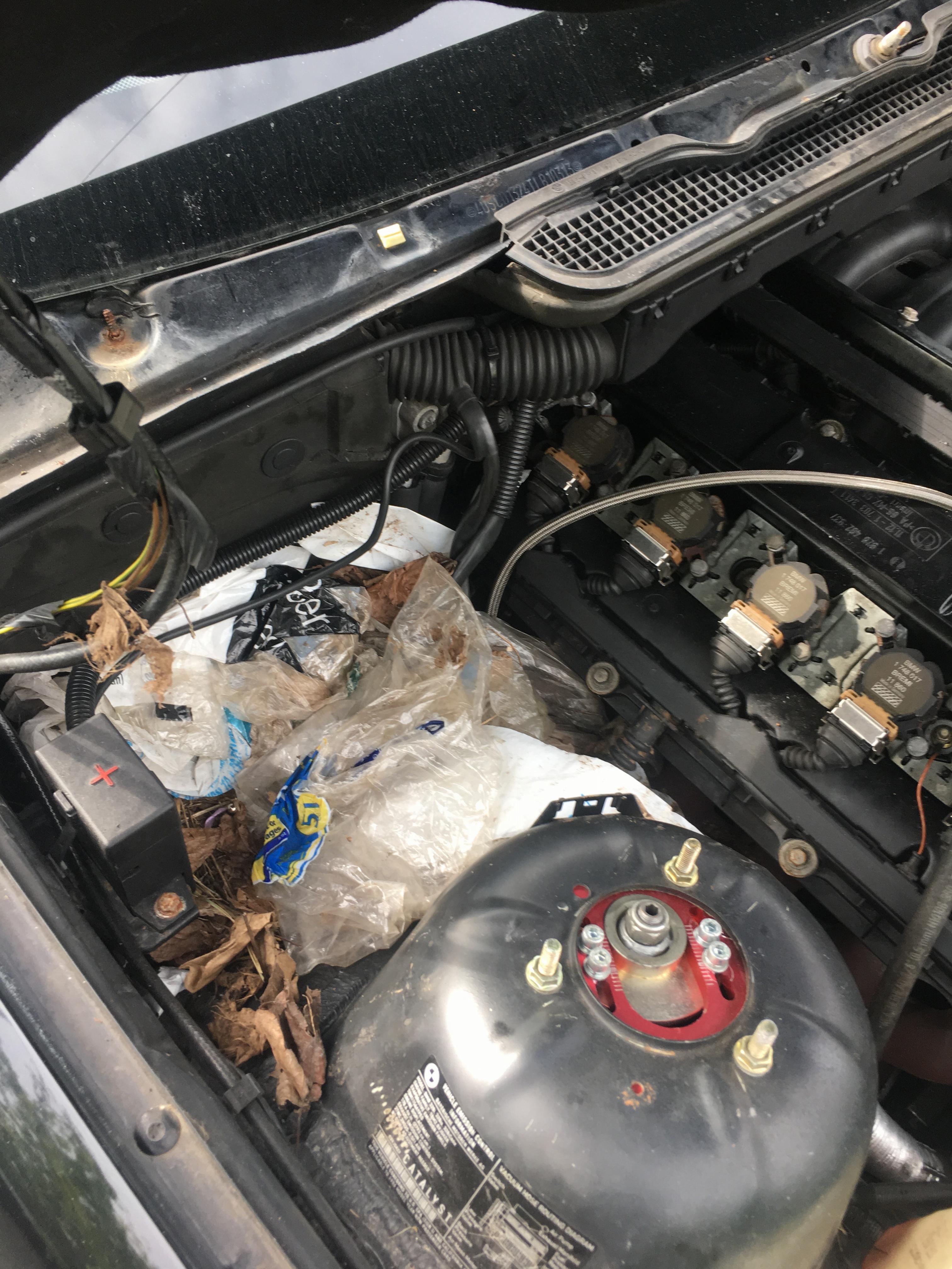

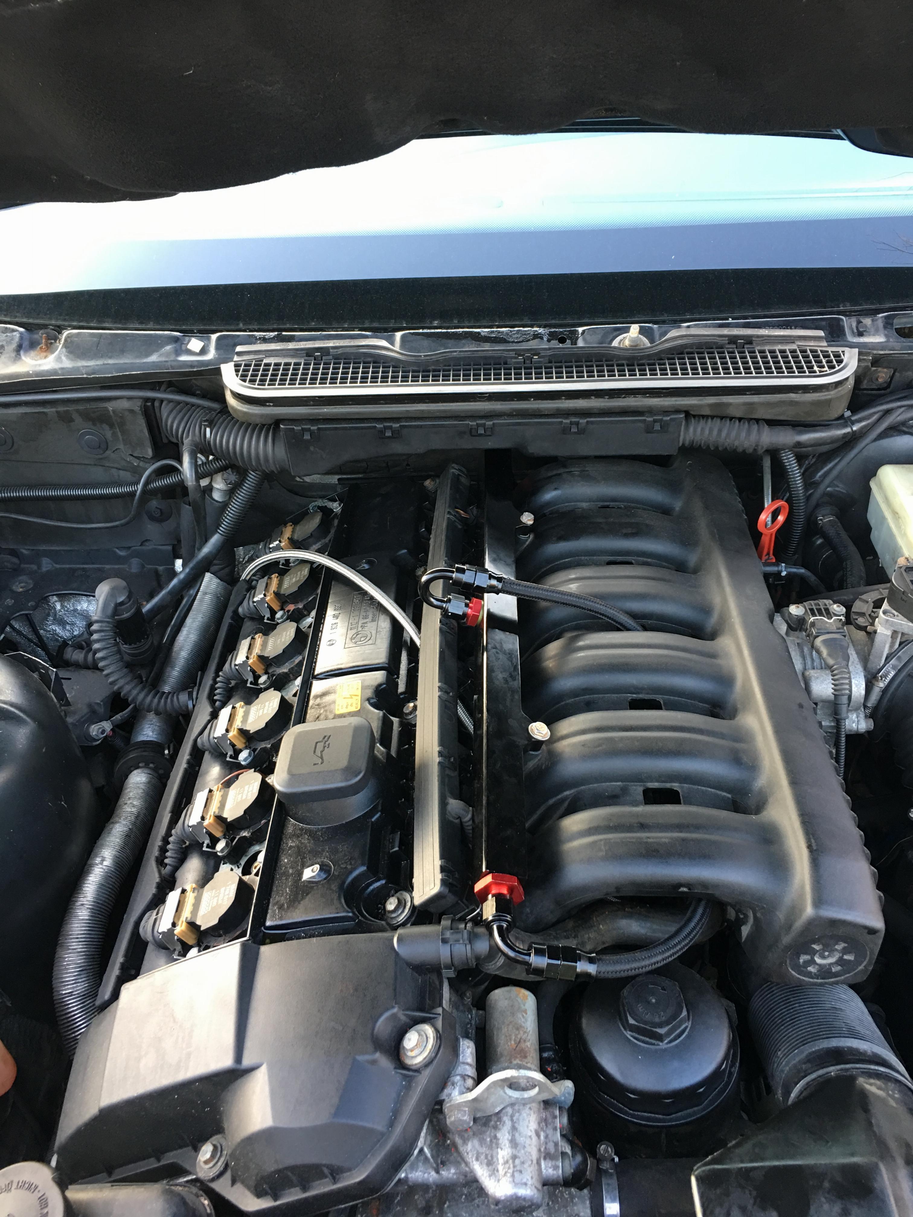

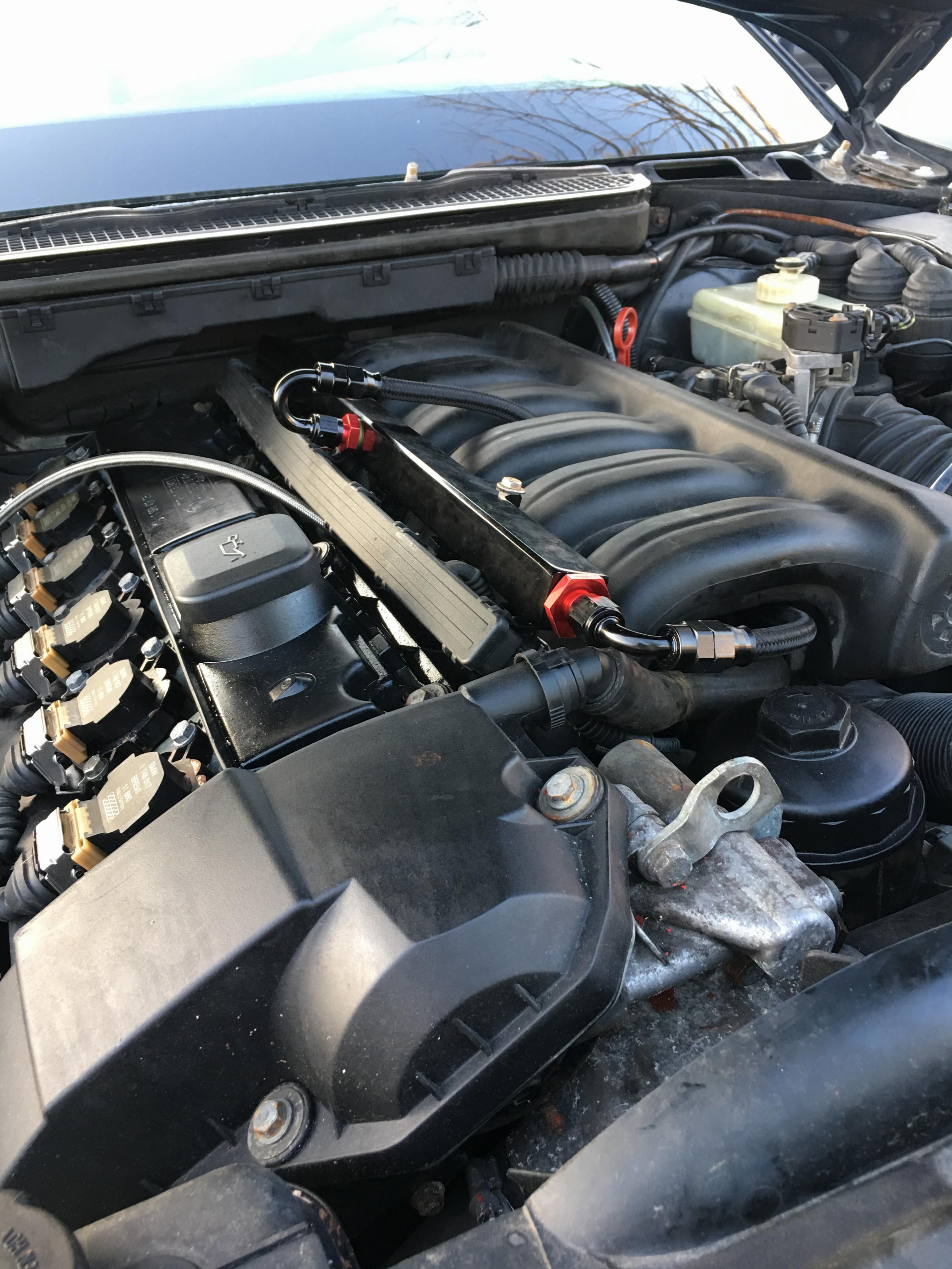

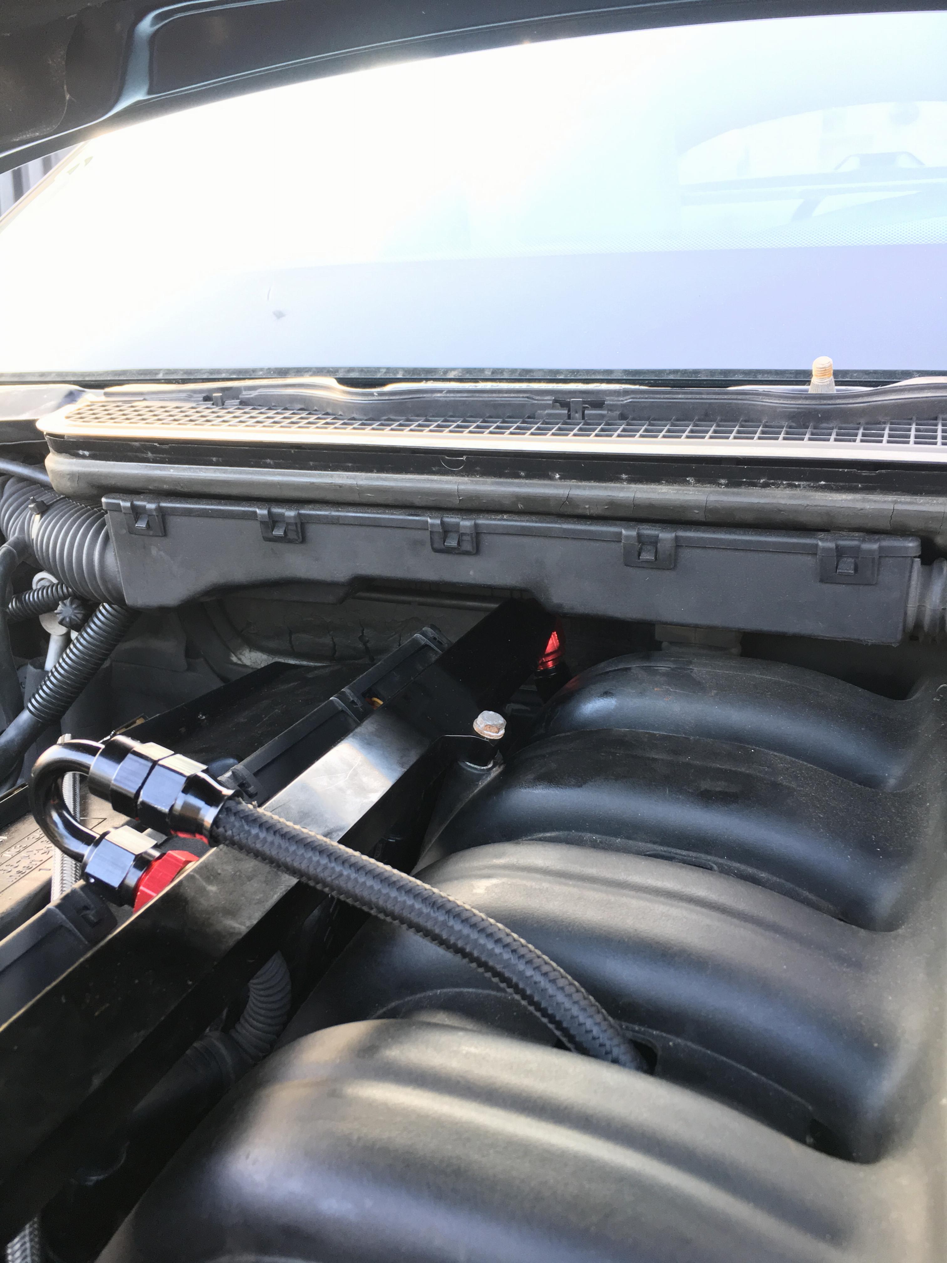

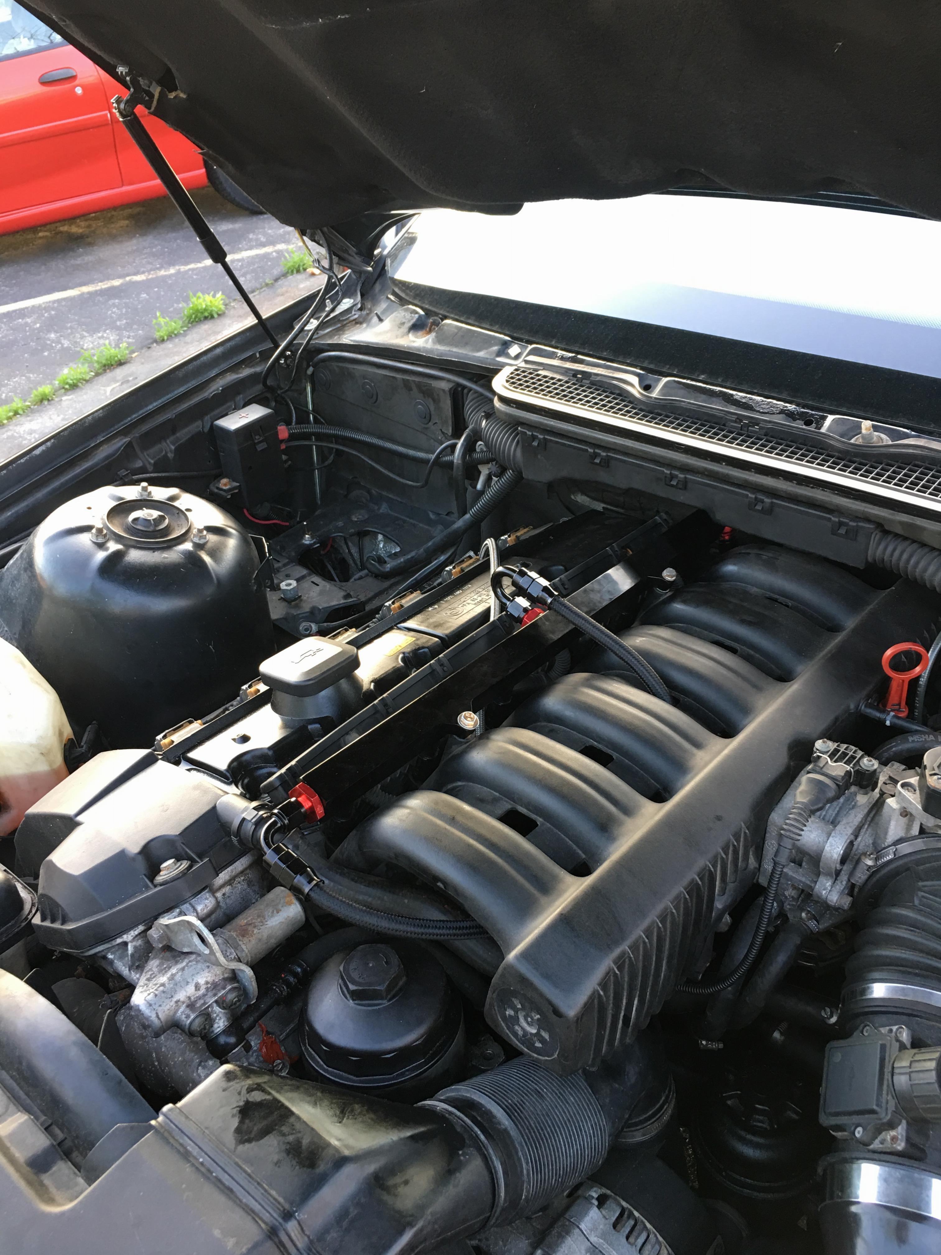

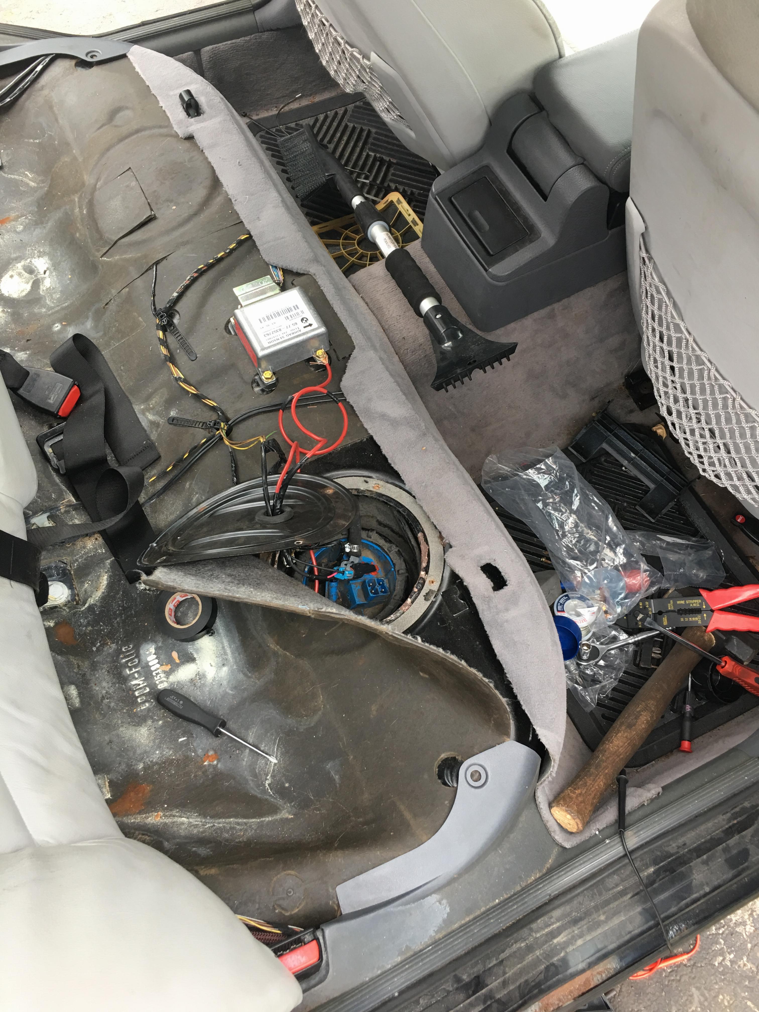

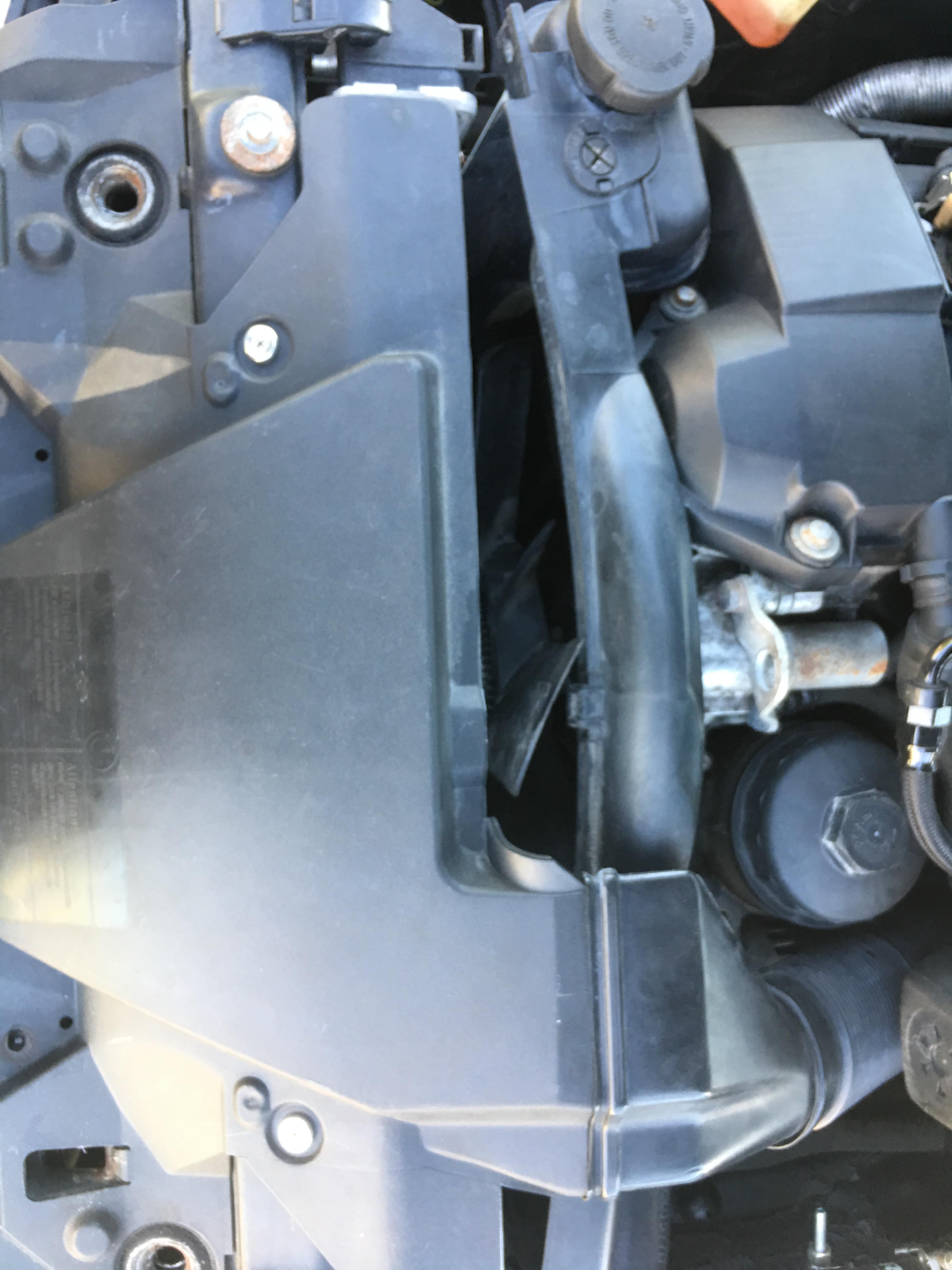

                  Got the new in tank fuel hose installed, cleaned out the engine bay, and repaired some wires.
                    #95
                    Didnt know they had "New Construction" conduit boxes for fuel pumps

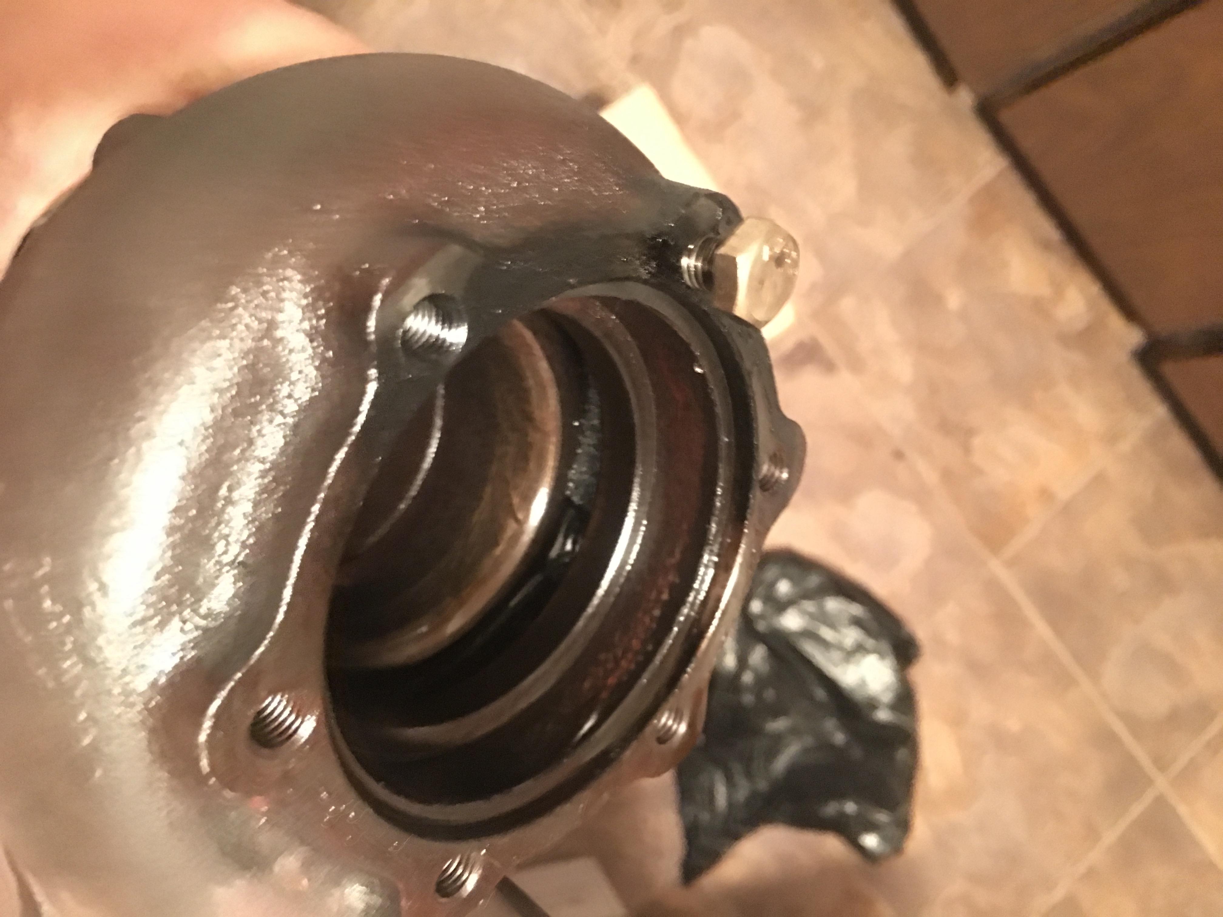

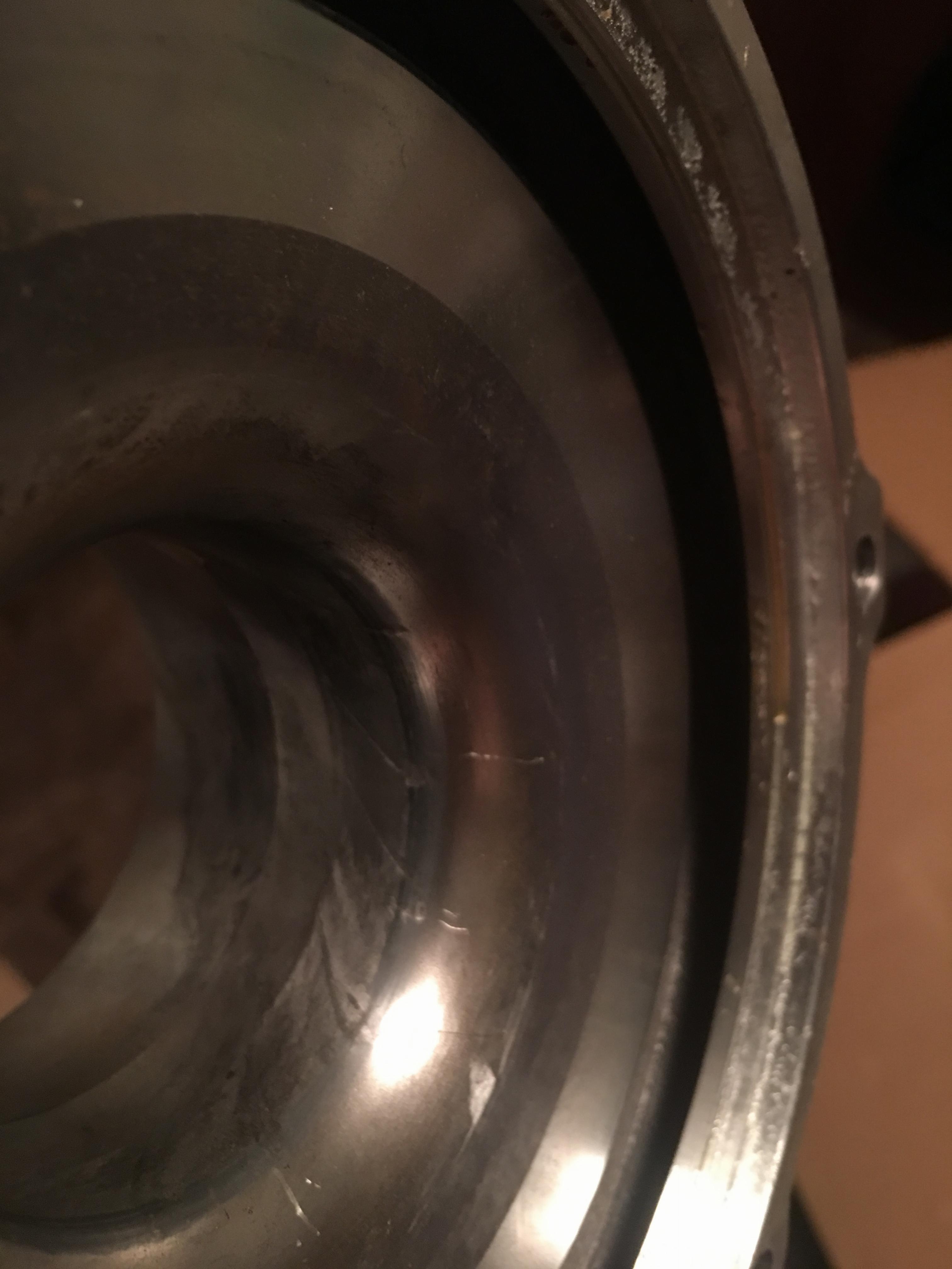

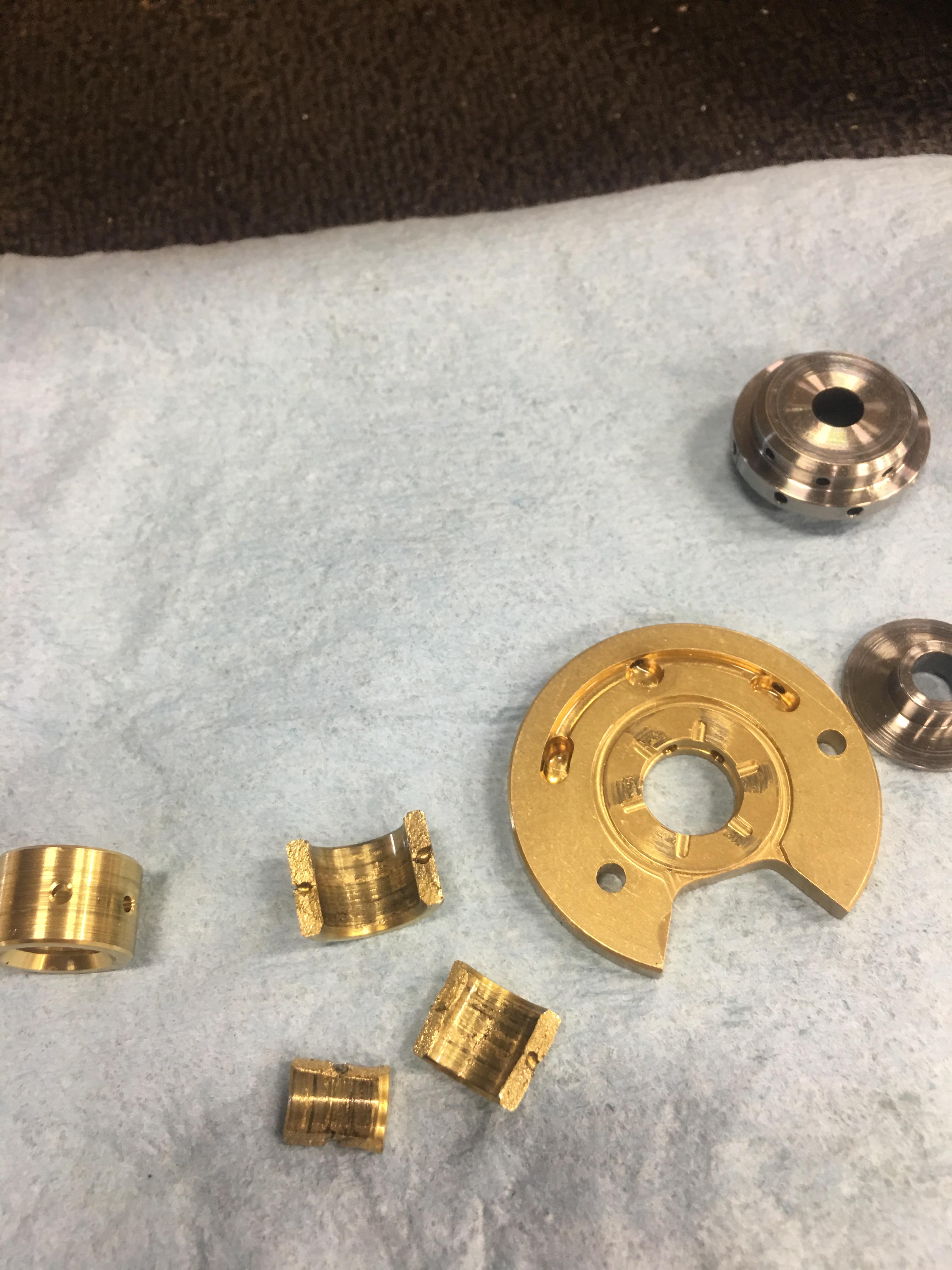

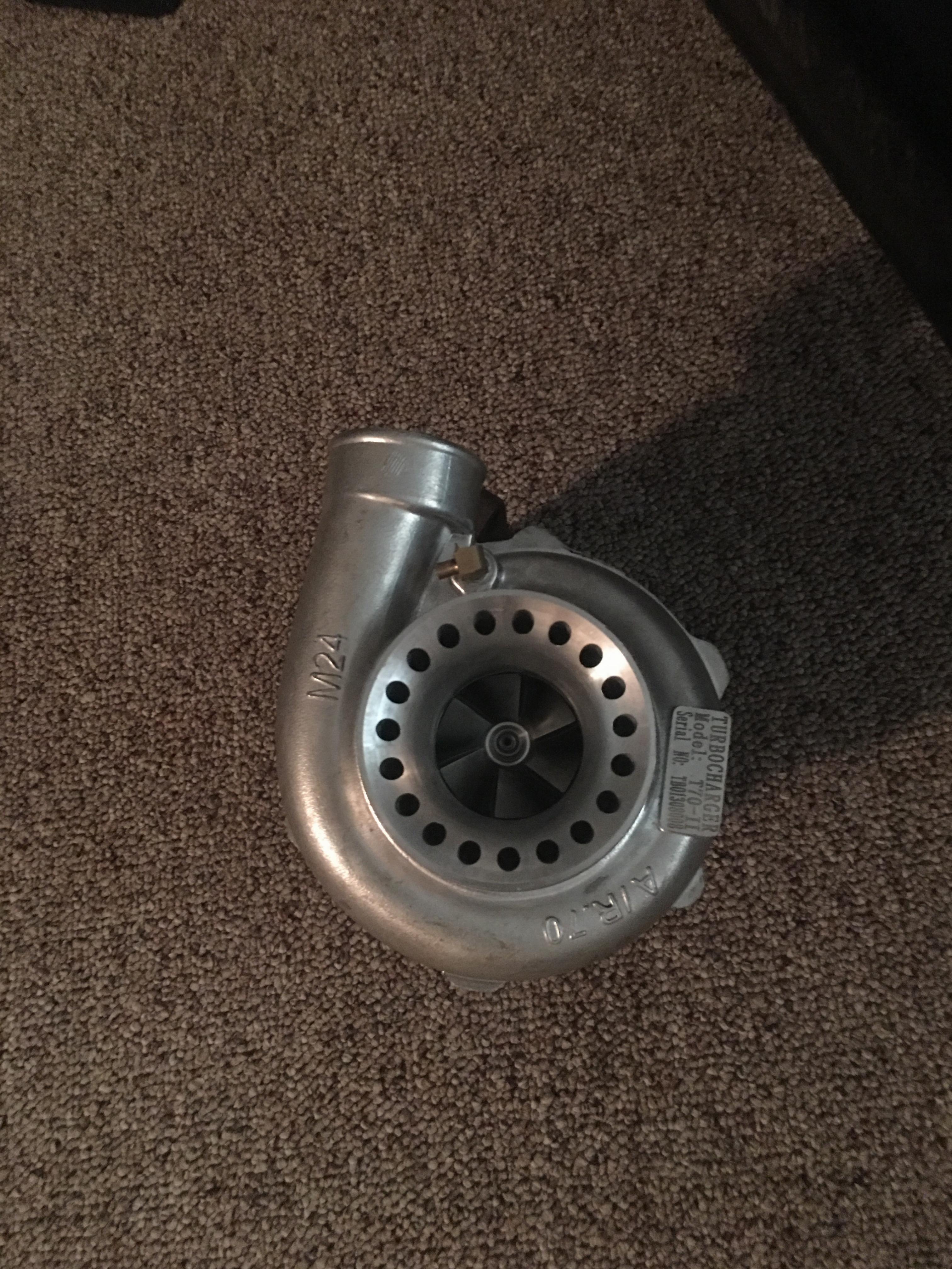

                                    Well just been driving this thing and not working on it. It's different, but there is one problem once I put the new turbo on I get boost creep. Whenever I go full throttle below 3k it will spike to 12psi when boost initially builds, wastegate is 8psi. It will drop back to 8 after but causes some jerking and odd a/f ratio. Both turbos were egay turd blows, but the ARs and trim on these don't always match up to advertised. So basically will be going to an external wastegate, which means a new exhaust manifold unless I weld it to the current one that is cast or the turbo exhaust housing which is also cast. Time will tell

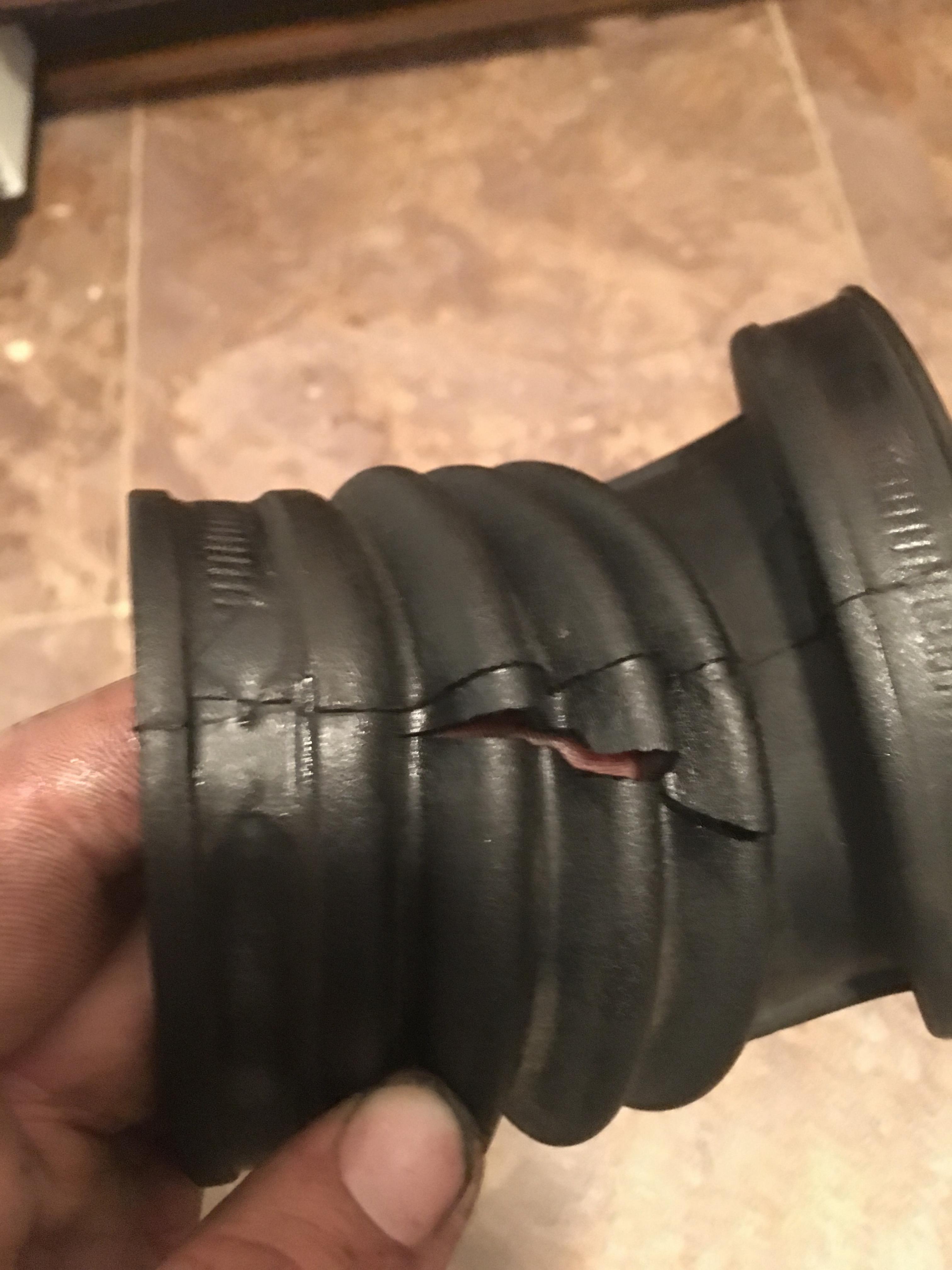

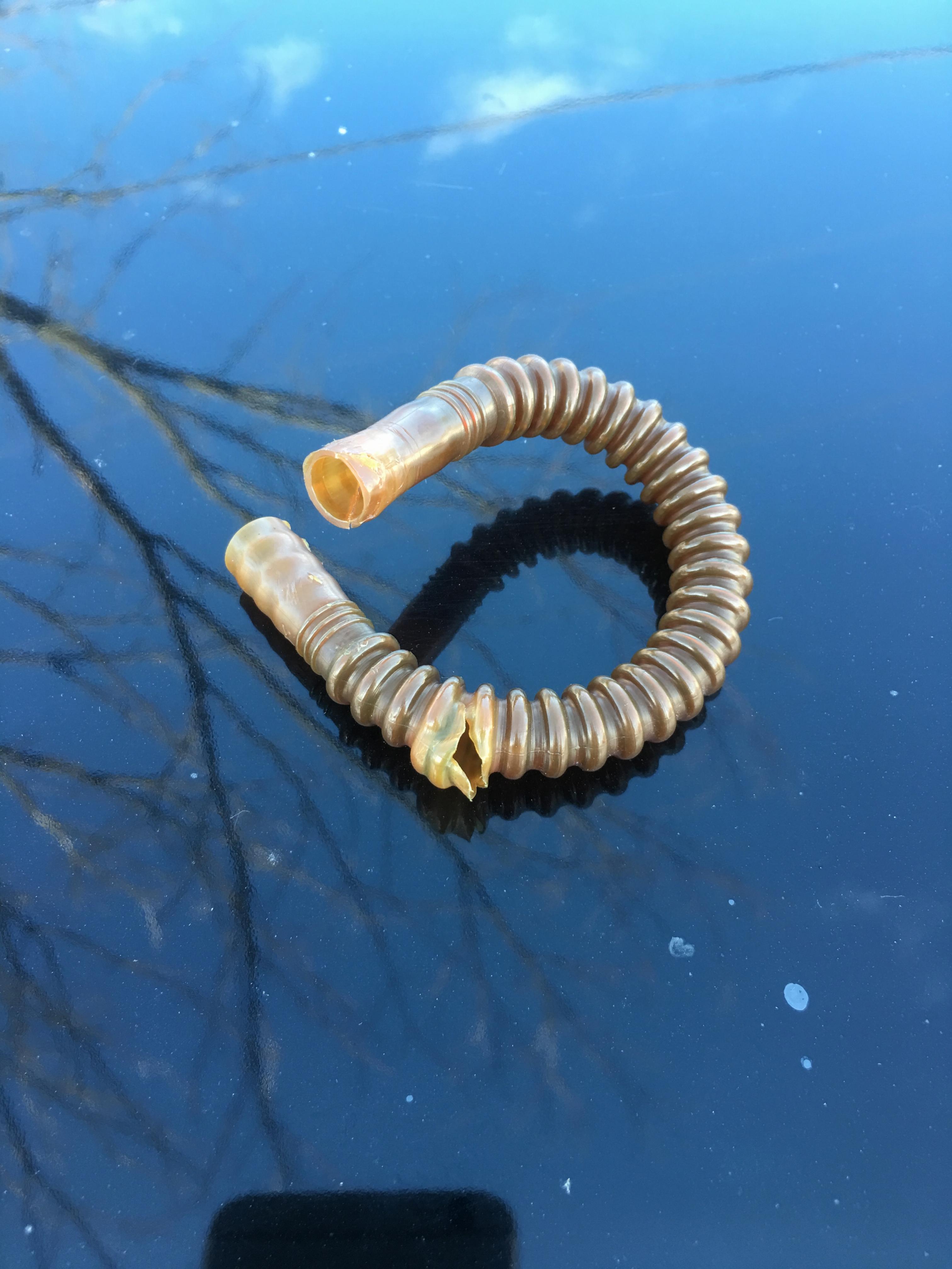

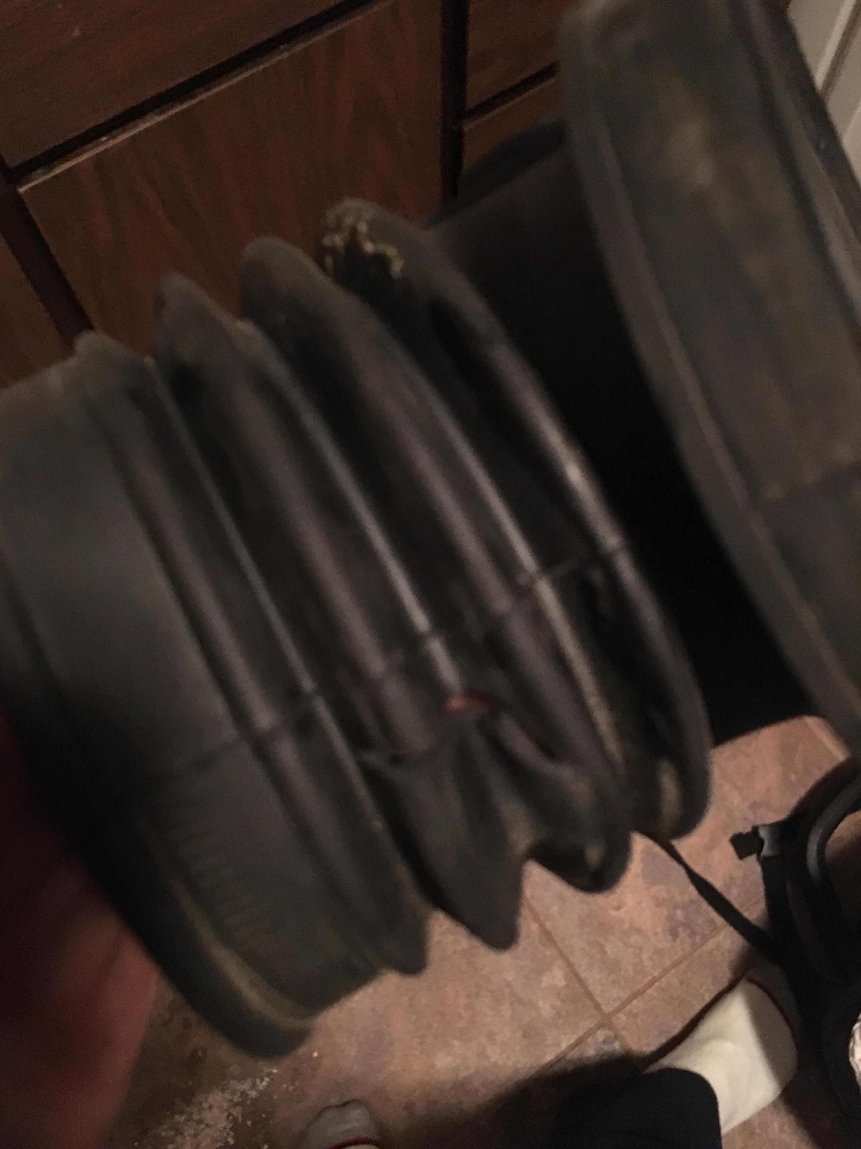

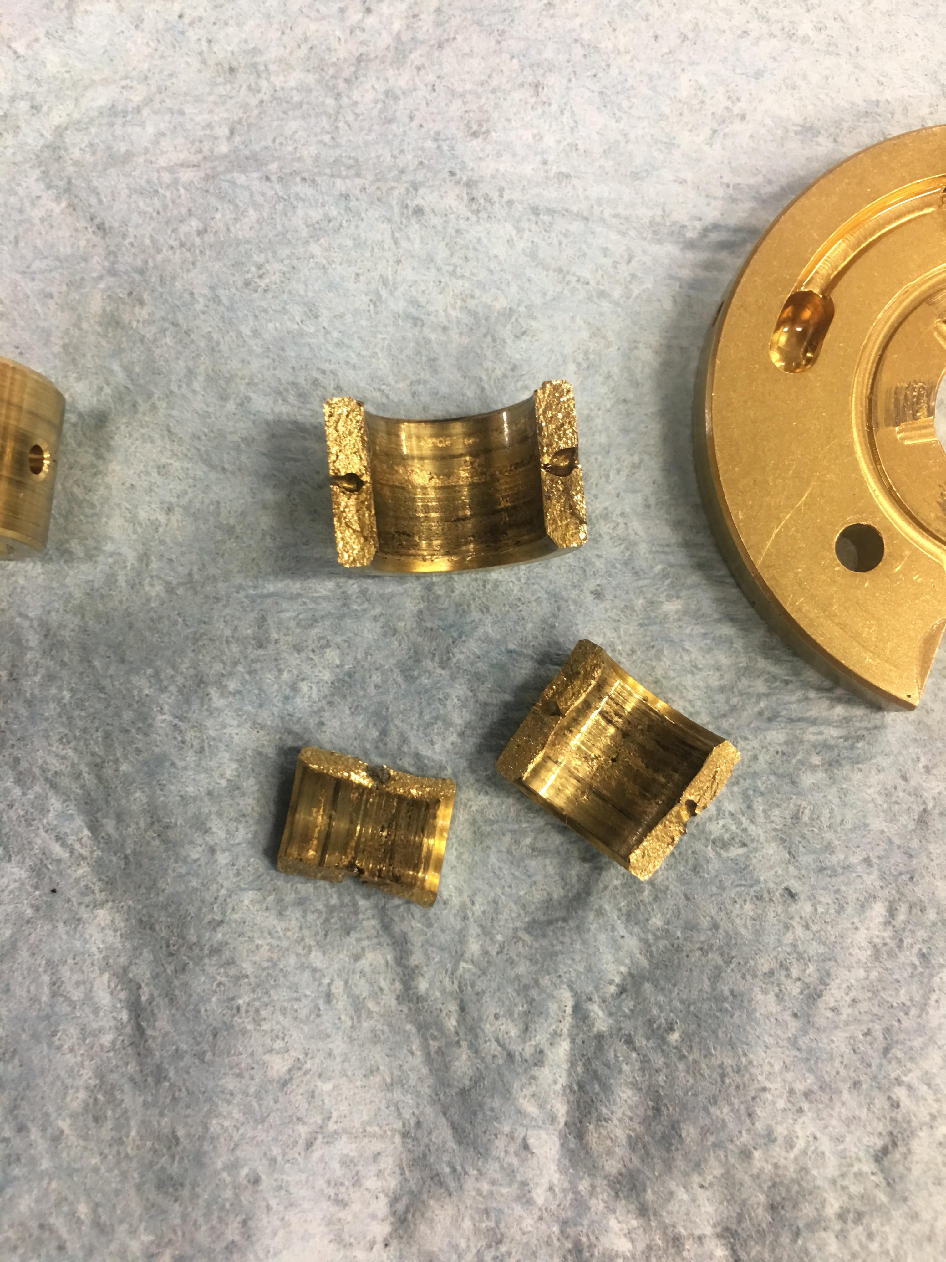

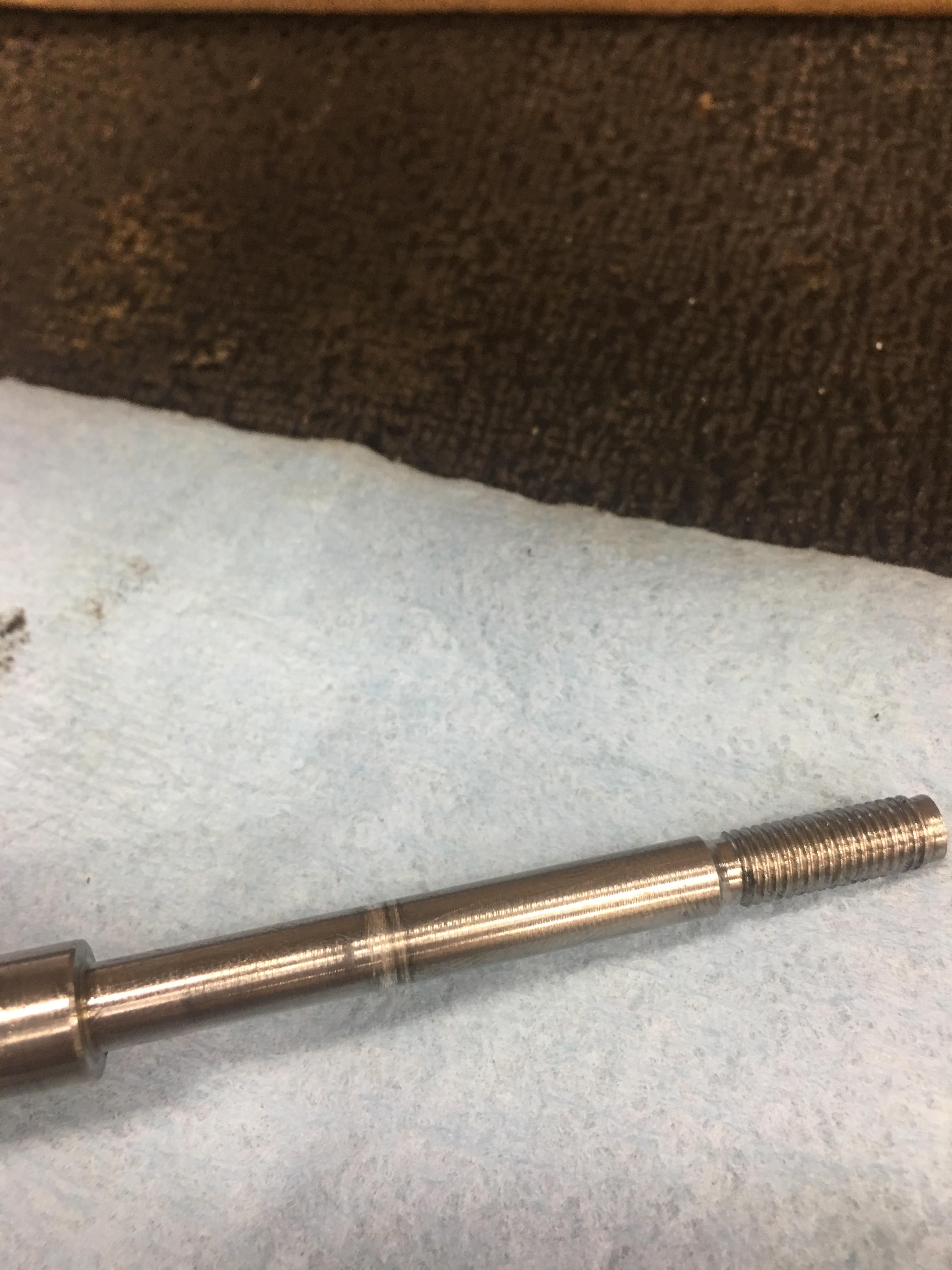

                                    Also did this today
                                    lost power and car ran like crap, got it home figured it was just an intercooler hose that blew off but it was this guy. Might upgrade this but have a few spares so we will see how long the next few last. Out of all the places it would've gave out I didn't expect it to be there.
                                      #104
                                      Interesting how you are getting boost creep at lower rpm where the mass flow through the turbo is low.
                                      It almost sounds like the wastegate sticks until there is enough mass flow to force it open
                                      • D
                                        Daggerty
                                        #105
                                        That is exactly what is happening
