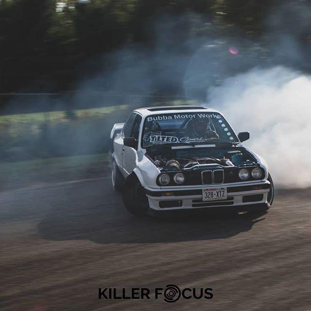

            #65
            Gone for awhile, but im back. Winter Build has started again. After never having my car actually run consistently i have decided to ditch this outdated chip tuning. The new MS3ProPNP has been order and should be dropping the car off to get tuned at the beginning of the new year!!!

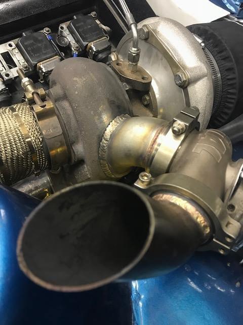

                            Been a hot minute, but still have the car. Just never made an update.
                            Car is tuned and is a rocket ship. Because of the manifold design, the waste gate had to moved to turbo housing.
                            Before waste gate modifications, we saw boost levels of 26+ psi while the car was at the dyno. While the number it produced was impressive, it would have broken everything
                            With waste gate modifications we have 100%  control and car is making 450 whp at 10-11 psi on pump gas.
