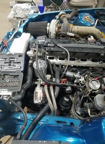

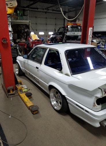

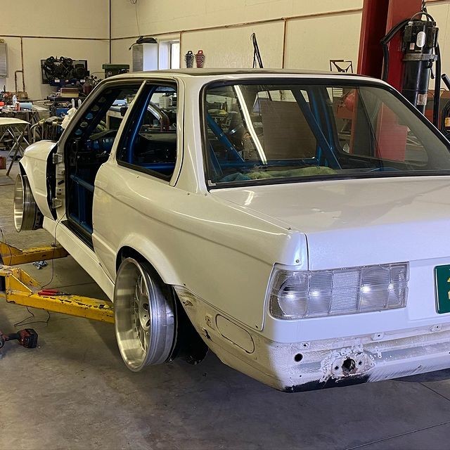

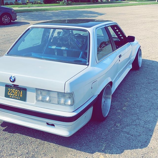

                Been a hot minute, but still have the car. Just never made an update.
                Car is tuned and is a rocket ship. Because of the manifold design, the waste gate had to moved to turbo housing.
                Before waste gate modifications, we saw boost levels of 26+ psi while the car was at the dyno. While the number it produced was impressive, it would have broken everything
                With waste gate modifications we have 100%  control and car is making 450 whp at 10-11 psi on pump gas.
                One more event this year then who knows what will happen next...... 😎

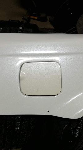

                                    Ahhhh the good ole build thread.  Been a very tame winter
                                    I wasnt planning to rewrap the whole car but after a few panels we noticed my car has seemed to turn and orange color. So a whole re wrap began.
                                    Not sure exactly why is changed, but i imagine the level of heat the rear tires gave off, the dirt build up after drift days, and the fact the I never took that great care of the outside are definitely factors.

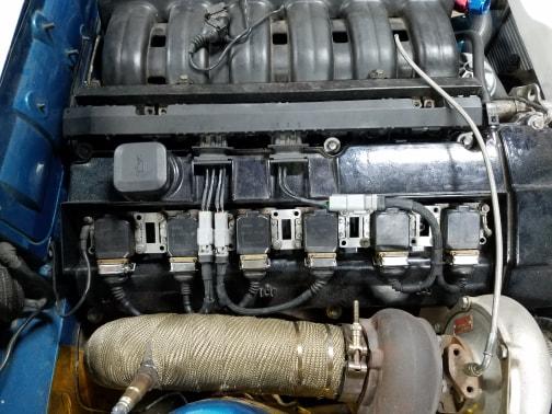

                                    Next, after burning up a ton of coil packing wires last year, @Tkuhn rerouted a couple things and make everything quick disconnect so if they burn up I can just plug a new set in instead of rewiring. Currently designing some clips to hold the connectors down.

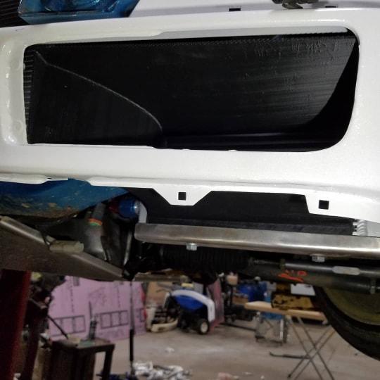

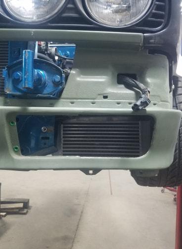

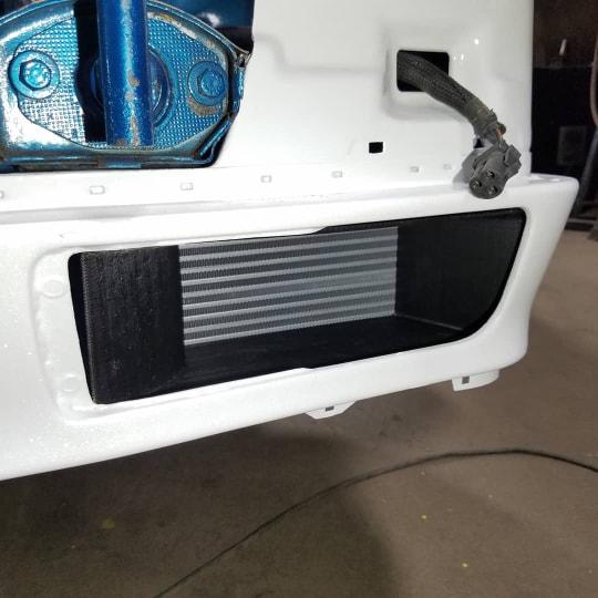

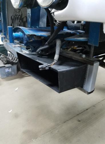

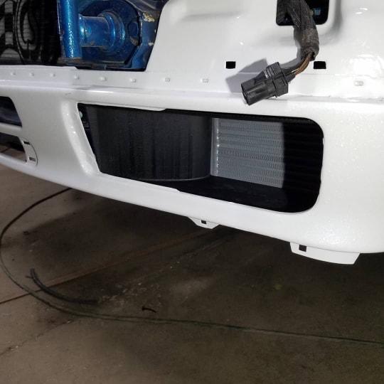

                                    Still fighting cooling issues, i finally decided to install an oil cooler with the s54 oil filter housing @DrLeadFoot sold me like a year ago. Putting the cooler in the brake duct/fog should provide the freshest air possible.

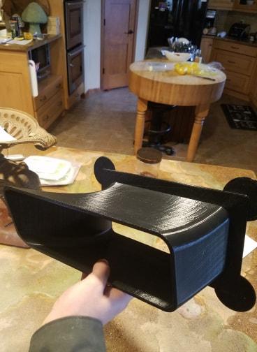

                                    Getting into 3D printing awhile back I designed and printed some custom ducting to get all the air flow possible. Pictures are of the V1.2 duct, V1.3 (last ducting picture) has been printed with small changes to make fit up to valance perfect. I have some plans for 3D printed radiator ducting, but those plans are on the back burner till the car is up and running.

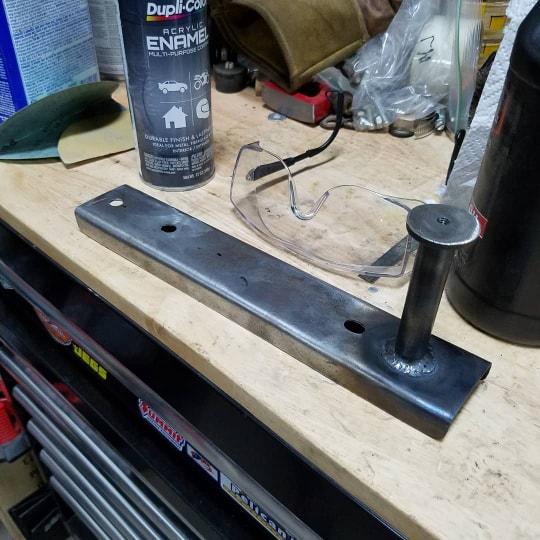

                                        Made up some bumper brackets to adapt the factory crash bar.
                                        963641413189324790859516122567732618592256n.jpg975107572903926553012836008082020679286784n.jpg966889775363198502830621853030431172067328n.jpg957300866184118554555085784912908639010816n.jpg
