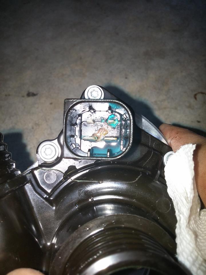

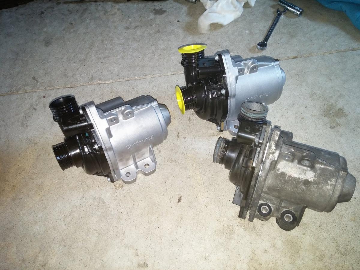

    started when i needed a new pump as my old one was leaking. then i put in a new vdo unit..then after one day the new pump i put in was faulty...very weird failure. Started by getting oil condition sensor inactive. Next ibs and alternator malfunctions. Turns out its all on a serial bit interface loop and the water pump is in that loop. Got a water pump code then i decided i should look at it. When i pulled the electrical connector of the pump it started leaking coolant!.wth... That cause the bsd interface to fail giving me all the issues.. New pump under warrenty thanks to muller motorwerks. Stand up guys. Just a heads up for y'all

        I bought the pump from muller mototwerks.and the owner personally delivered me a new pump the next day and printed me a return label. It dont get better than that. Awesome guys
