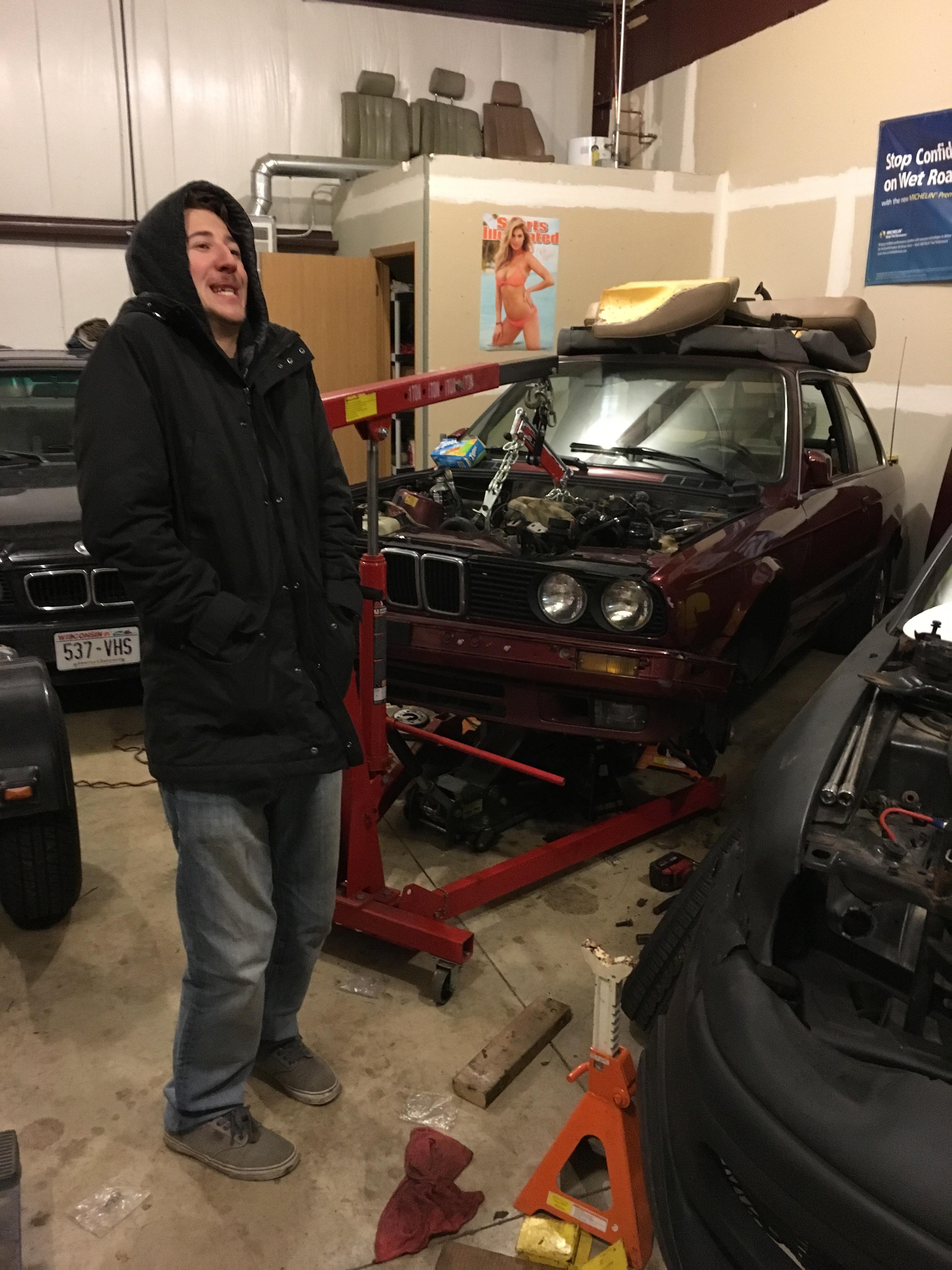

                            Winter is here and is so motivation to get this going! Have been slowly working on getting the motor out which I planned on today. Decided to drop the trans and motor down under the car to avoid dealing with the starter. Everything is unbolted and ready to drop except we're hung up on the steering knuckle. Kaiser will send pics of what he had to do to get his subframe out. So yeah until next weekend...

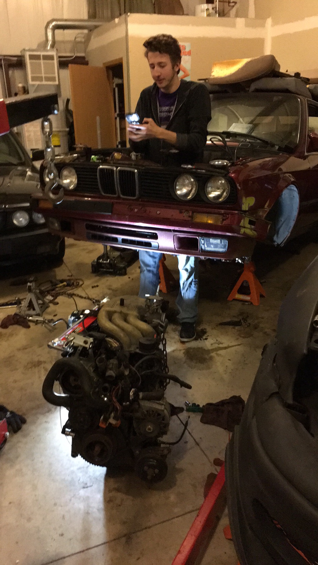

                                    unfortunetly this was true. The rubber flex disc had crimped studs going through it. Ended up undoing the slip joint under the kneel panel and pulled it out.
                                    So we dropped the subframe, pulled that, then dropped the motor on the floor. Raised the car up as high as the 3ton jack went and slid the motor out from underneath with just enough clearance.
                                    Discconnected the trans and removed the clutch and flywheel. I've never mounted a engine on a stand before but the stock bell housing bolts weren't long enough to fit through the mounts unless I have it set up wrong. Suggestions?
