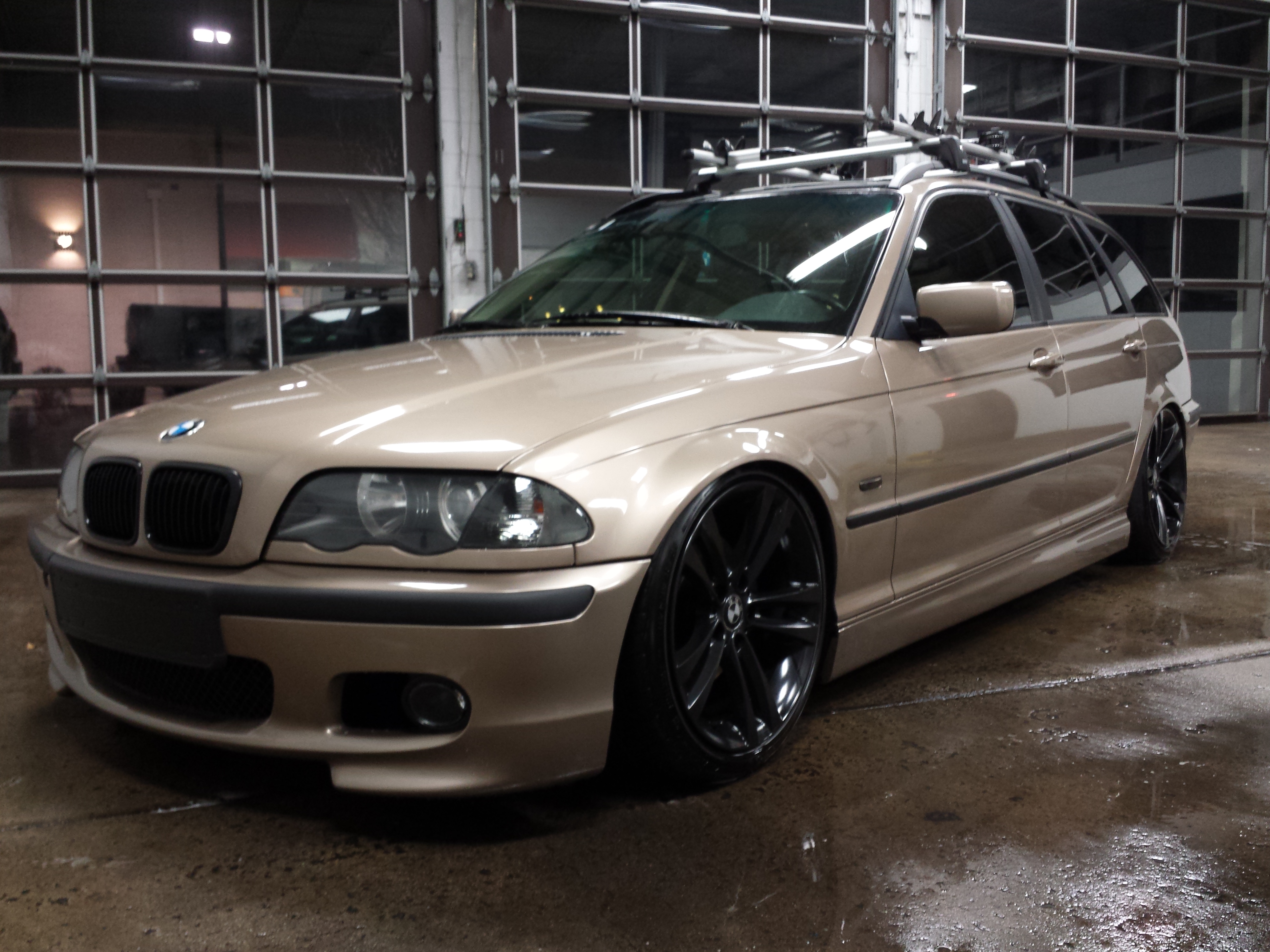

                            So heres an update:
                            Well I think my account was deleted due to inactivity, had to create a new account. Not a lot happened has happened with the car in the past year. I sold the LM replicas, didn't have the money at the time to do anything suspension wise and it killed me to have those wheels on stock suspension. Well I have a co-op with Mercury Marine now making a pretty good wage throughout the week and I still have my Bergstrom job which will be paying dividends for access to tools/lift/alignment rack/etc.
                            The car bug has recently bitten me again and now making better money I plan to actually do something with the car this spring/summer.
                            Headed down to Illinois this Saturday to pick up some new wheels, style 68's.
                            Bergstrom lifts making life easier
                            First impressions looking good
                            Yeah, that looks better
                            Taking care of the rust this summer
                            I found out that I had a broken spring at the way bottom of the coil in the rear. Car rides fine, but probably is the explanation for why it sits at a different height by a finger on that side than the other. So the plan is to go with the FK coilovers for the price and basic lowering. This is just a daily, have heard the Fk's ride similar to the sport suspension but slightly stiffer.
                            Other mods to come this summer. This lip, which is apparently one of the only options for the stock bumper. For $80 though I can't complain
                            For 80 dollars I'll also be picking up some new headlight lenses because mine are super pitted and hazy. (have tried to buff and cut them already)
                            Also would like to pick up a set of LED tails, they are only like $150 on Ebay, so I dont see why not.
                            For maintenance I need to replace the lower front control arm bushings. Was quoted $1500 at Bergstrom when I got my ebrake fixed, fuck that. Have seen the DIY's and they its a 2-4 hour job, and the bushings themselves are 70 dollars.
                            So thats the status of the car as of now, excited to finally make some changes that will reflect the way I want the car to look. Excited for this summer.

                                I had FK's on my e36 and I enjoyed them.  They were comfortable for daily driving, stiffened the ride without being harsh and went low.  I think you'll be happy with them.  I would highly recommend finding a set of adjustable top mounts so you can properly align the car or you're going to be eating through tires like crazy!

                                      GC makes a great camber/caster plate that is customized to your set up, i.e. spring size and strut rod size.  K-sport makes some that I can order but it's questionable whether or not they would work with FK as they state that they do not recommend using them with any other coil over set up.  KMAC would be the other option through Turner Motorsports and their stage 2 is camber/caster adjustable and comes with various adapters to fit a coilover.  GC or KMAC both have great reviews and are similar in price in the $400~ range.
                                      Either option is going to increase ride harshness (NVH) because you are reducing the rubber in the suspension system but you give that up for a proper alignment.
                                        #134
                                        I had no issues with camber wear up front on my e46 and I ran that car super low on FK's for 35k miles. Just knock out the alignment pin on top of the strut mount and you'll get way more camber adjustability. I would recommend adjustable camber arms out back though. My car ate up rear tires pretty bad. I had the arms but never got around to installing them. Picture for reference.
