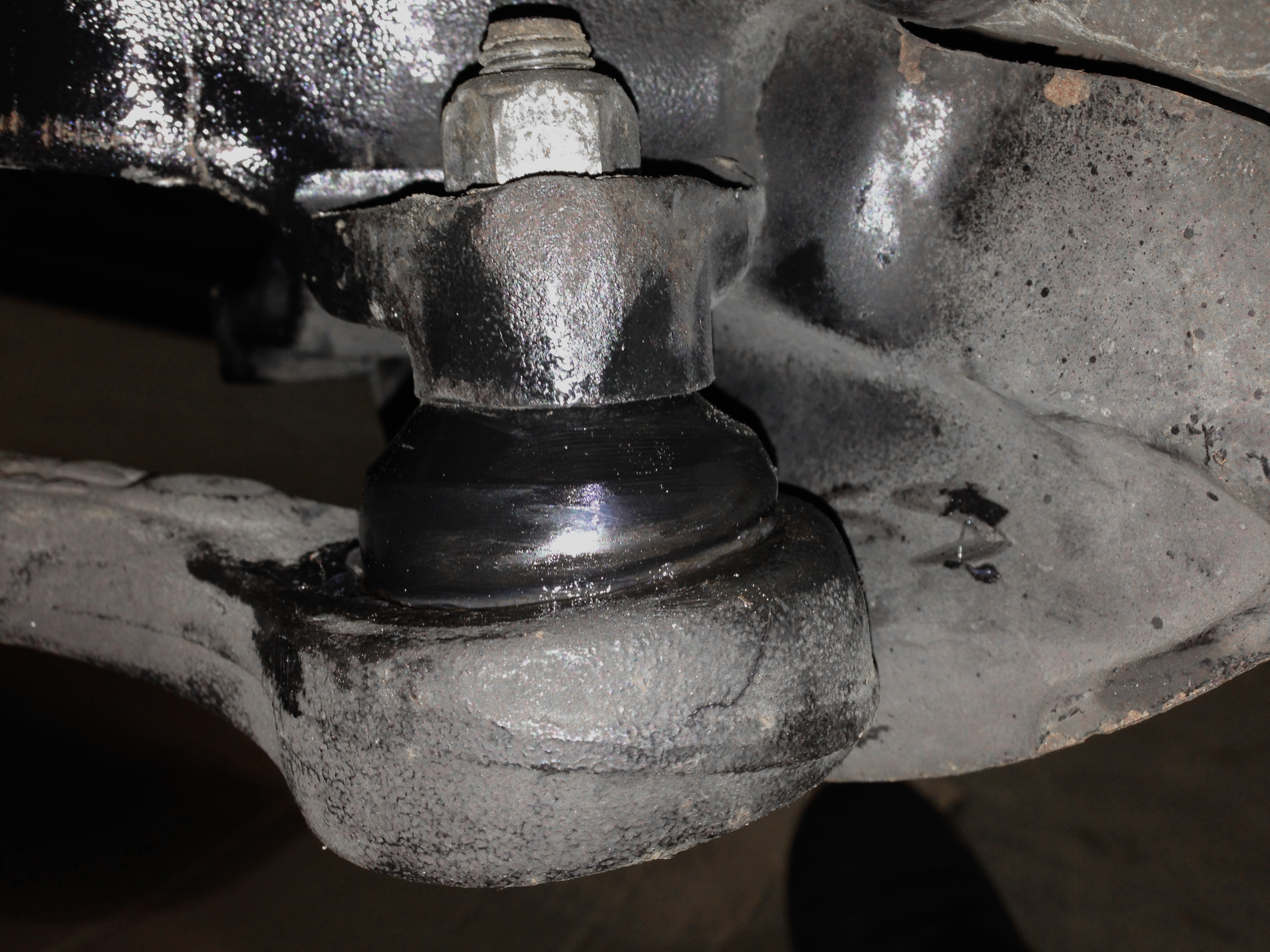

                        So I looked over the balljoints again and they are just fine, I only tore the boots removing them. I decided I will just replace the boots and re-grease the joints. Would anyone happen to know what the dimensions of the boots? I was looking into getting something more durable like urethane. I had Energy suspension boots on my civic and they were awesome, I just don't know what size to order. here is a picture for reference:

                          just get new ball joints they may seem fine now but they're out already so why not??? They're gonna go bad eventually...

                            Because of the stress it will put on the arms of pushing the ball-joints in and out. Normally that's why its suggested you replace the whole arm. I have factory arms now, I figure I wont be able to find castings as nice unless I get OEM. So why replace them if they don't need it yet. I have always had the mentality of don't replace it unless it's broken or is an upgrade.
                            Also consider the cost.
                            $400 on arms that dont need to be replaced < $20 maximum on new boots

                                  So I contacted energy suspension yesterday and provided me with this awesome link:
                                  http://www.aftermarketsuspensionparts.com/Universal-Dust-Boots.asp
                                  If you ever want to upgrade your shitty rotted out boots, or happen to tear one like a dumbass( me) this site has all the dimensions of the boots they carry. I found the ones I need, which also fit a 67 ford mustang "Merica." I called the local Oriely's auto parts store and they had them shipped next day for less than what they were listed for on Energy's site. I should be picking them up tonight and finally seeing how retarded low my car will sit. I can already tell I will be able to bury my wheels so far into my car it will look like a hovercraft (perfect). Now its time to start collecting oil pans....
                                    #57
                                    Installed the front coils last night. The Dust boots I ordered were a perfect fit! If anyone needs to upgrade their lower outer ball joint boots on an E30 the part number from Energy Suspension is 191725.

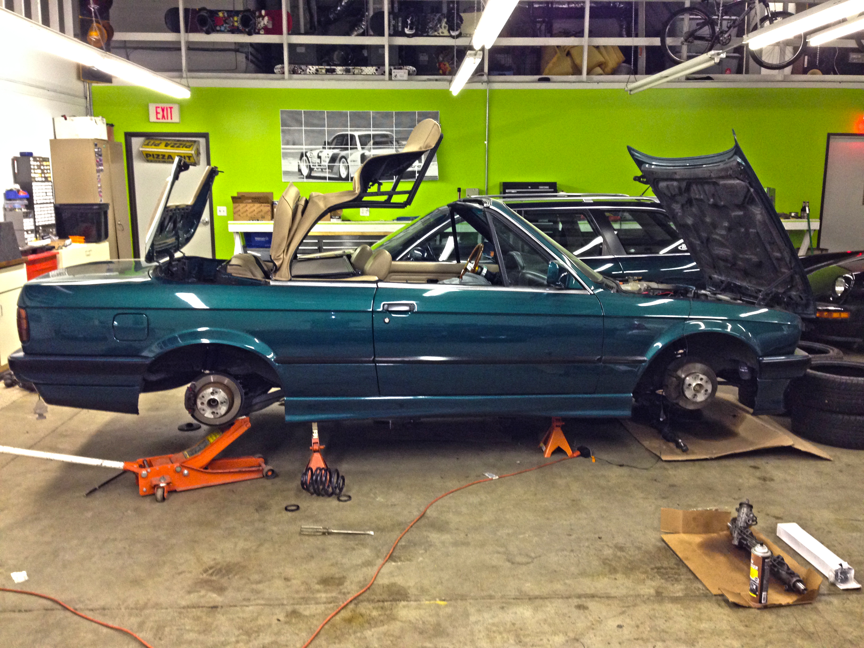

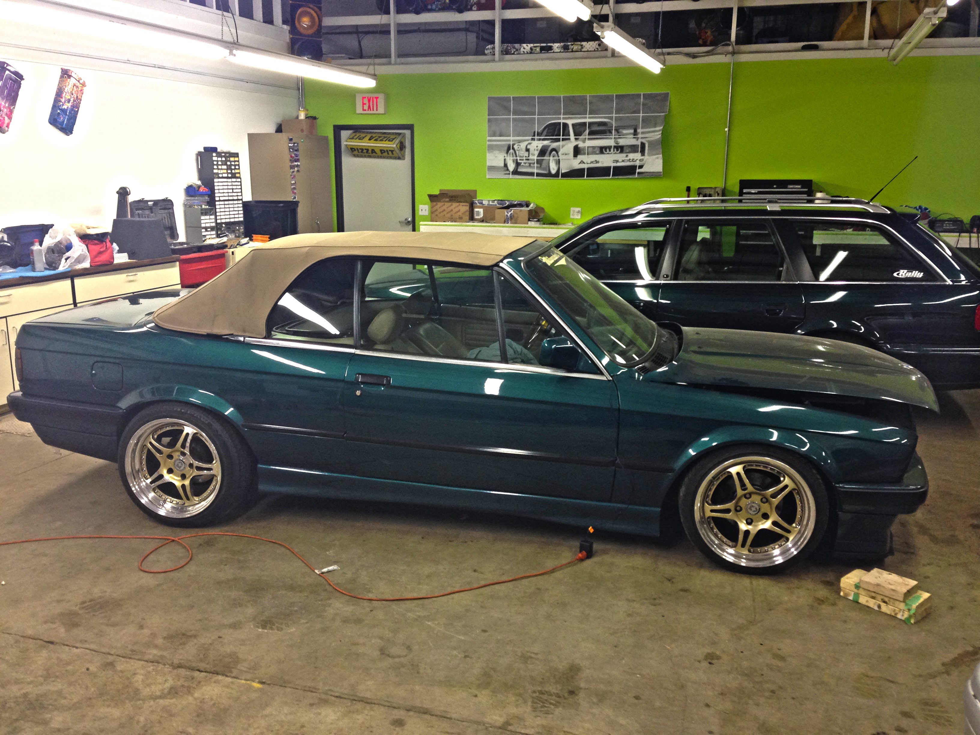

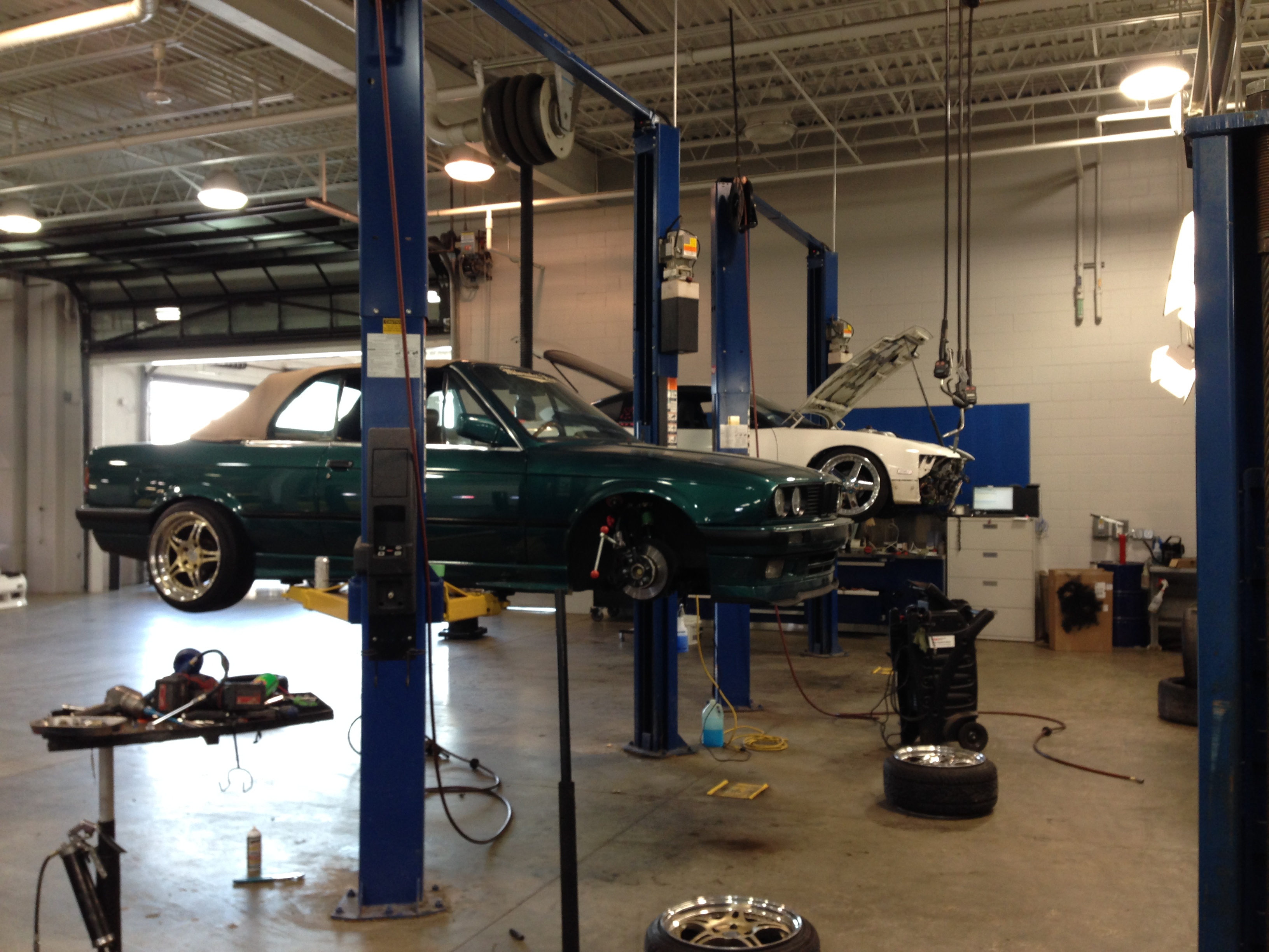

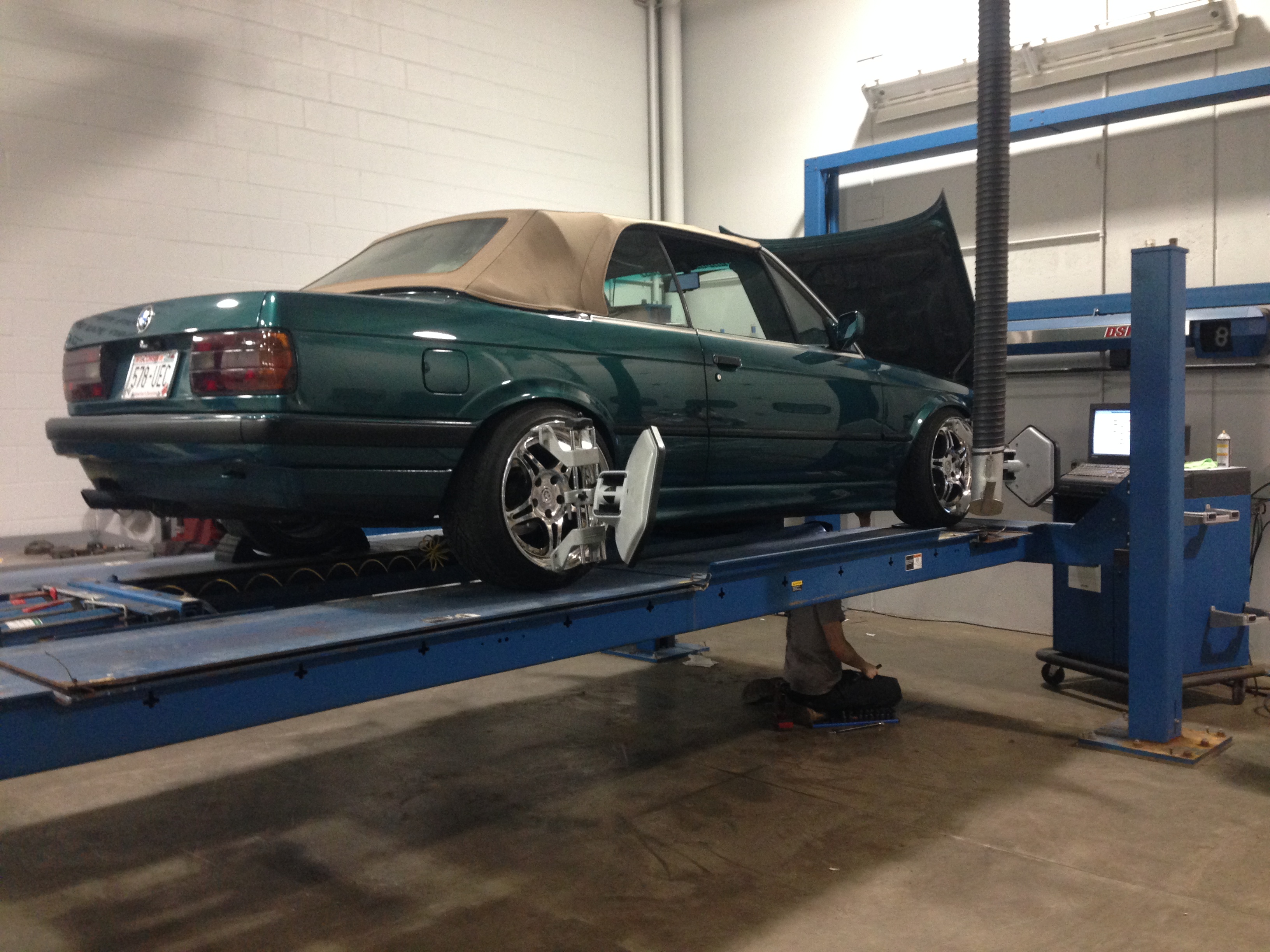

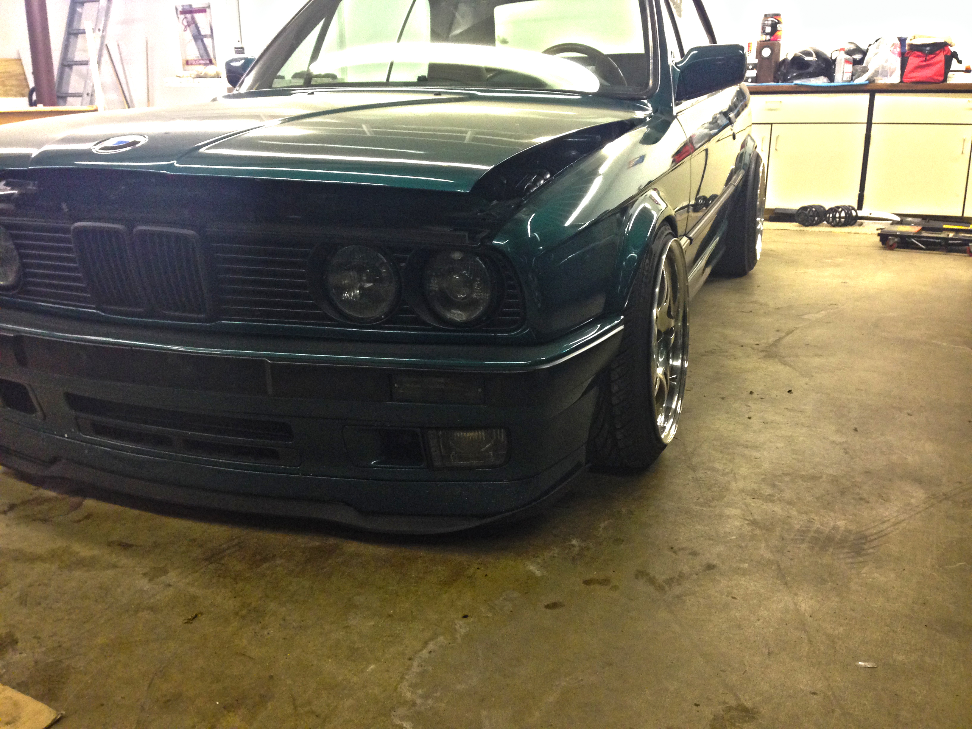

                                        Installed the coils last night and finally got my car back on the ground. I am really happy with the amount of adjustability. Now I cant wait to actually drive it! I got the steering rack put back in and did a basic string mount alignment. I have an appointment at my buddies work to get it aligned and swap out those terrible rear tires! I hope I can get it a lot lower in the rear after making the adjustments, I know I have about an inch to go in the front. Here is how it sits now

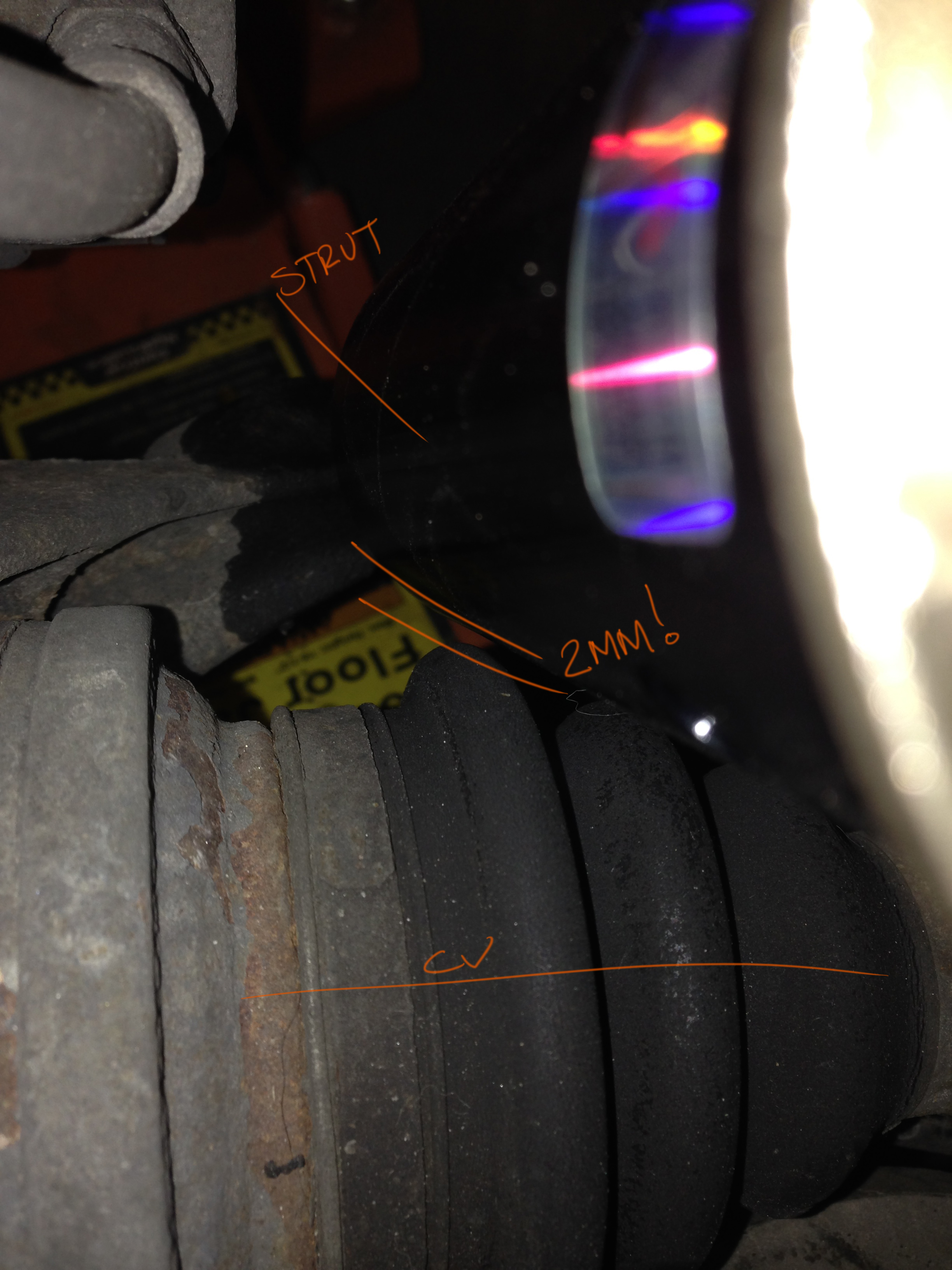

                                        This was a little concerning seeing how close the boot was to the actual strut housing in the rear. Its about 2mm away. I checked compression rate and it seems it will be fine with suspension movement.

                                          My front drivers side coilover hits the barrel of my front wheel. Only underload (turning left) or when I am reversing? Really odd. After staring at it for hours and taking it apart more than 10 times, have come to realize that flex is the culprit. All the way around the coils are really close to my wheels but this sucks. Guess time to order new adapters. Has anyone else ever had this problem before?
                                          I also noticed that when I had it on the rack, I could not get as much camber from the drivers side wheel as I could from the passenger side. I know that some cars have different geometry from left to right, is that true with E30's?
                                          Either way I still drove it as the rubbing caused no damage and only occurs when turning left(Good thing I'm not in the Daytona 500). I am really please with the comfort of the BC coils. You would never guess that they are 10-12k rates. Now I just need to weld in the camber tabs in the rear and buy new adapters.
