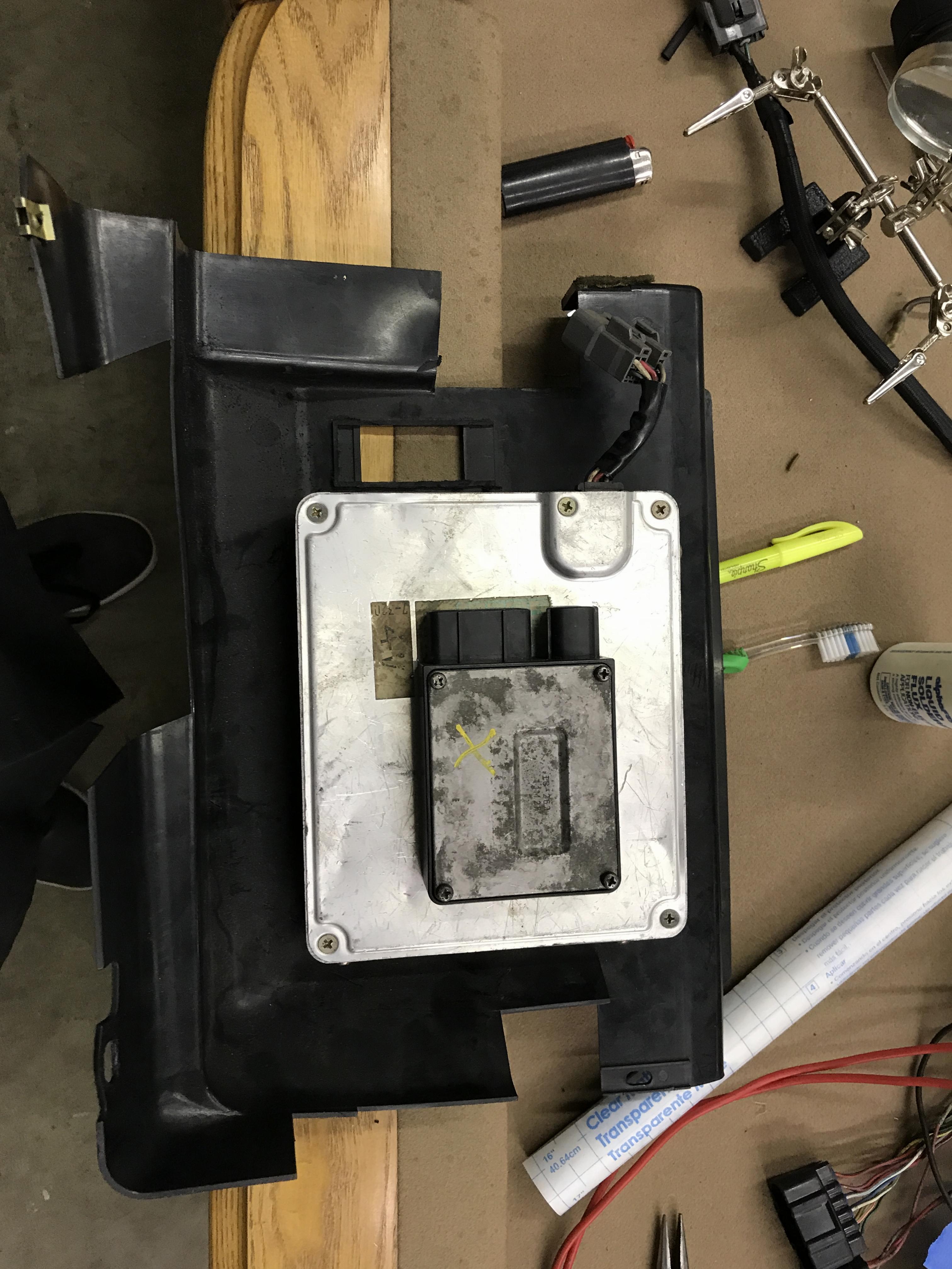

                    I figured out how to mount my ECU and Igniter for the time being: 3M DualLock Its like velcro but better

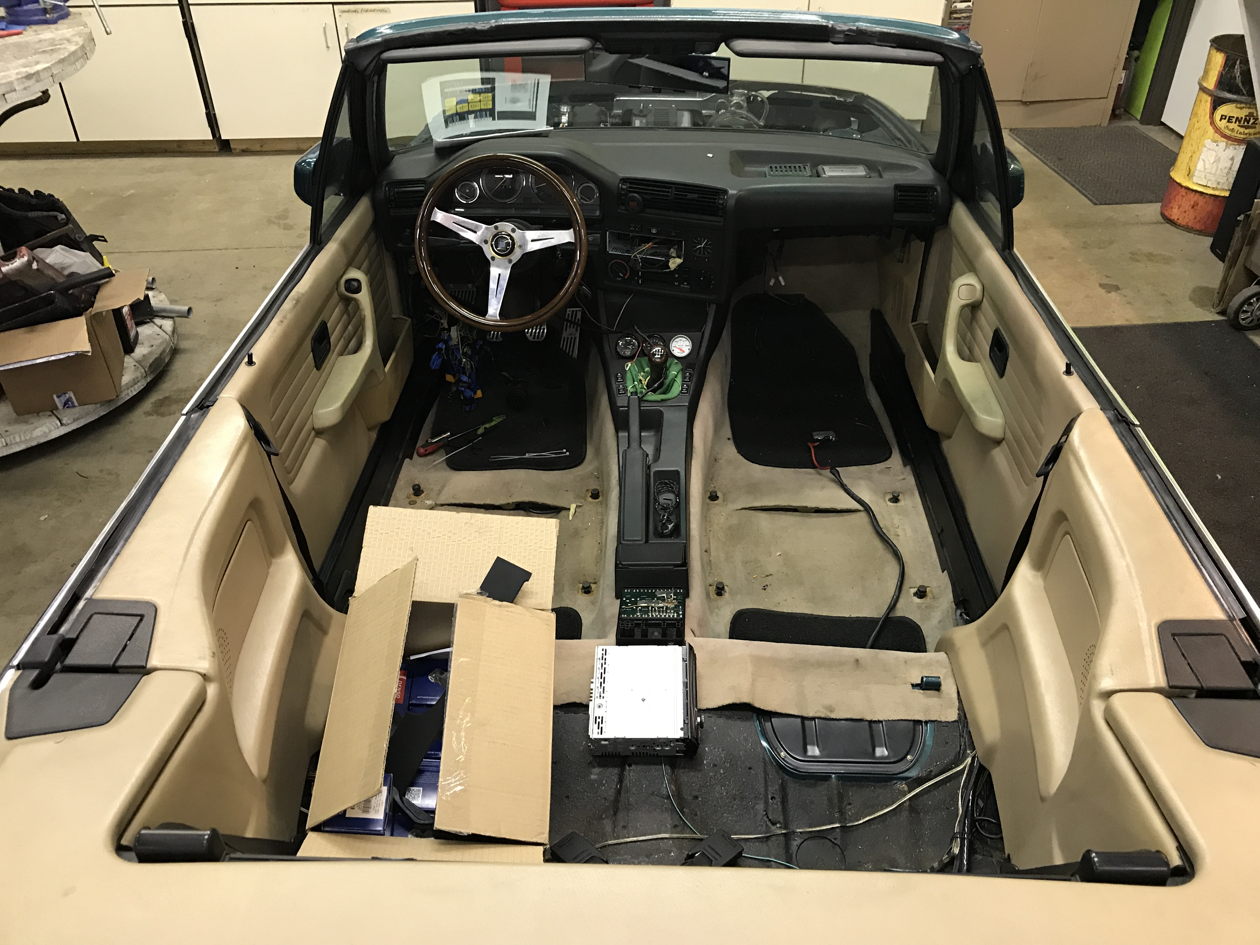

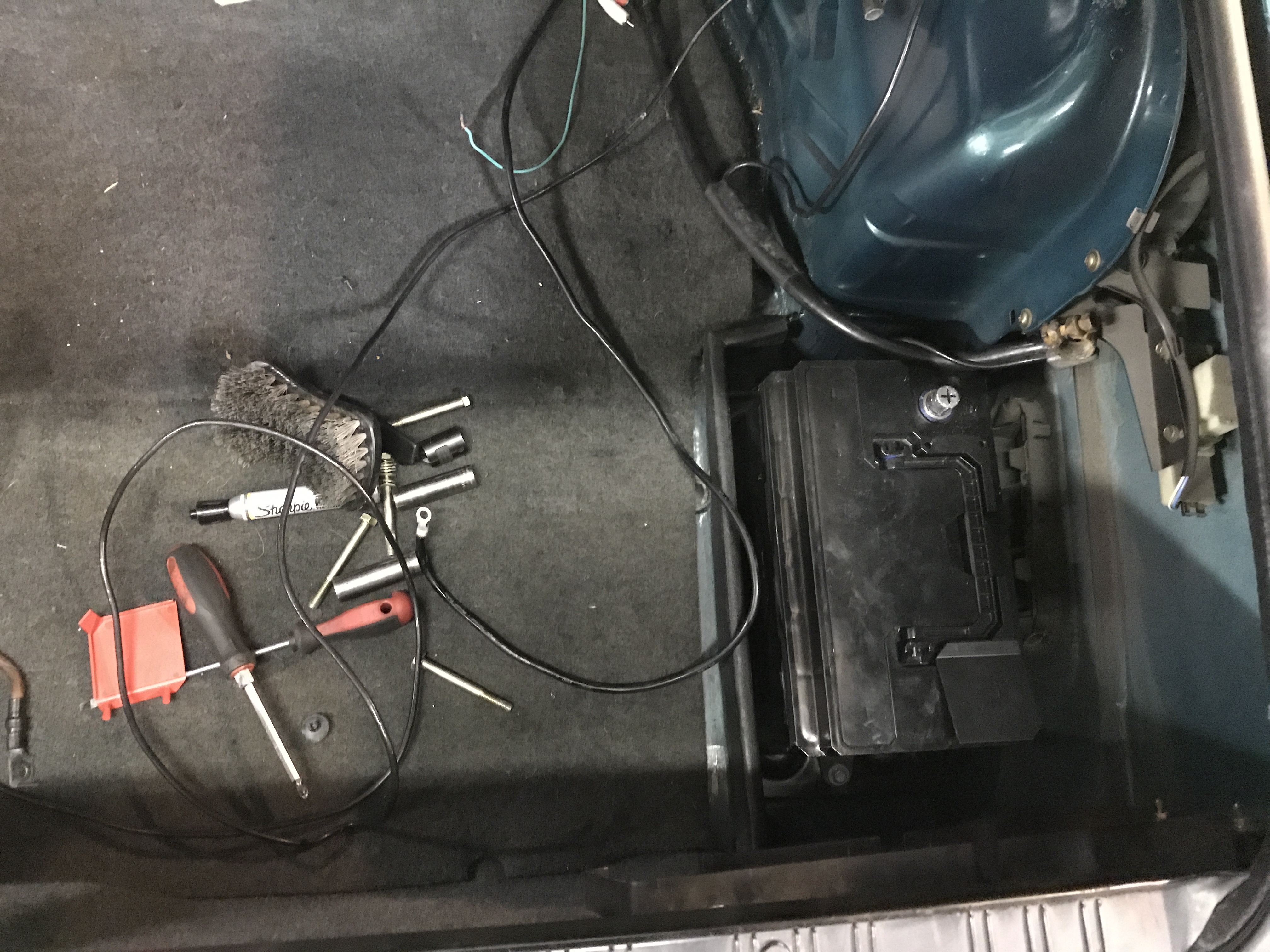

                    I routed the Battery Cable finally and Mounted the battery in the trunk. This entitled me to removing all of the seats and panels on the passenger side of the car.  I also removed the 50lb Weight/vibration Damper

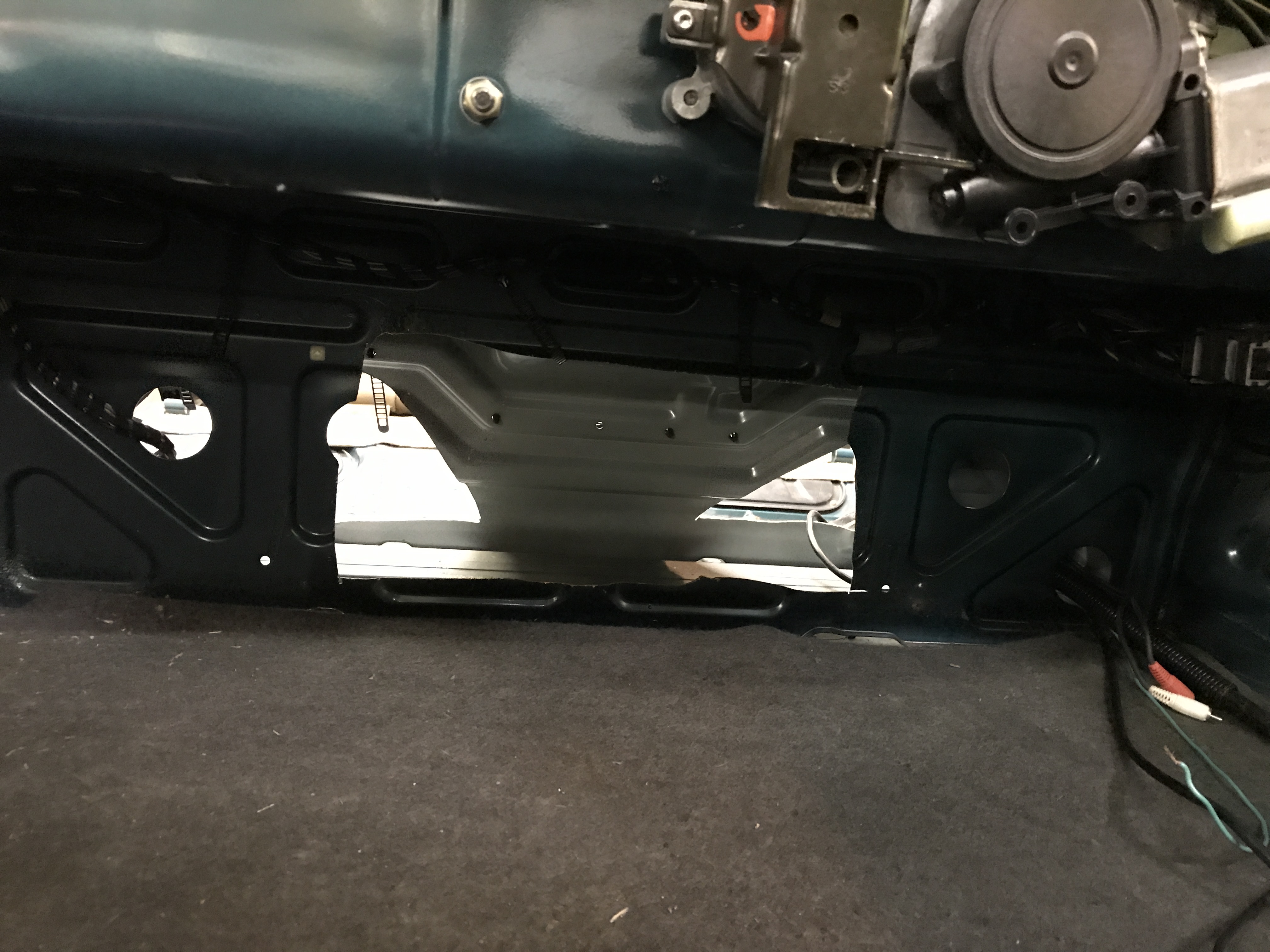

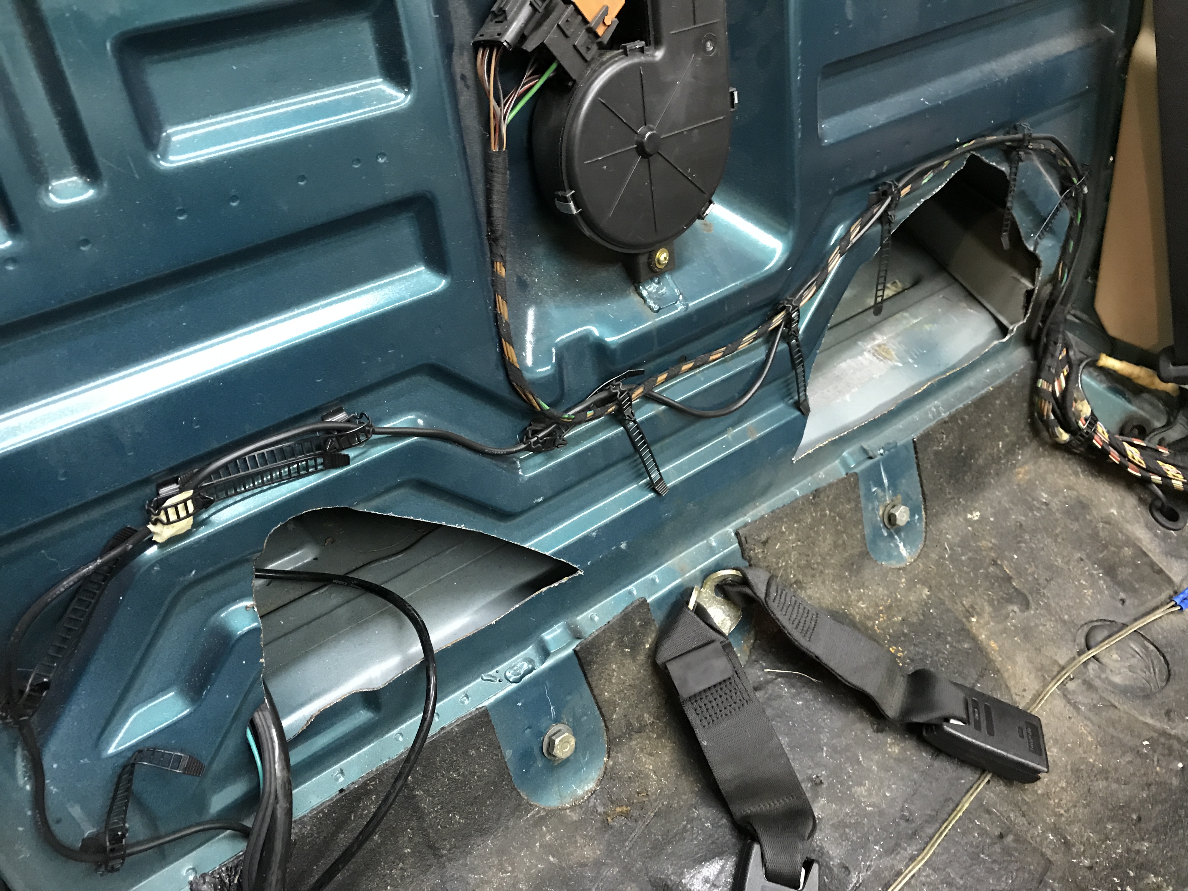

                    I took a picture of the holes the previous owner cut into the space between the seat and the trunk which once contained large amount of pure Colombian Cocaine

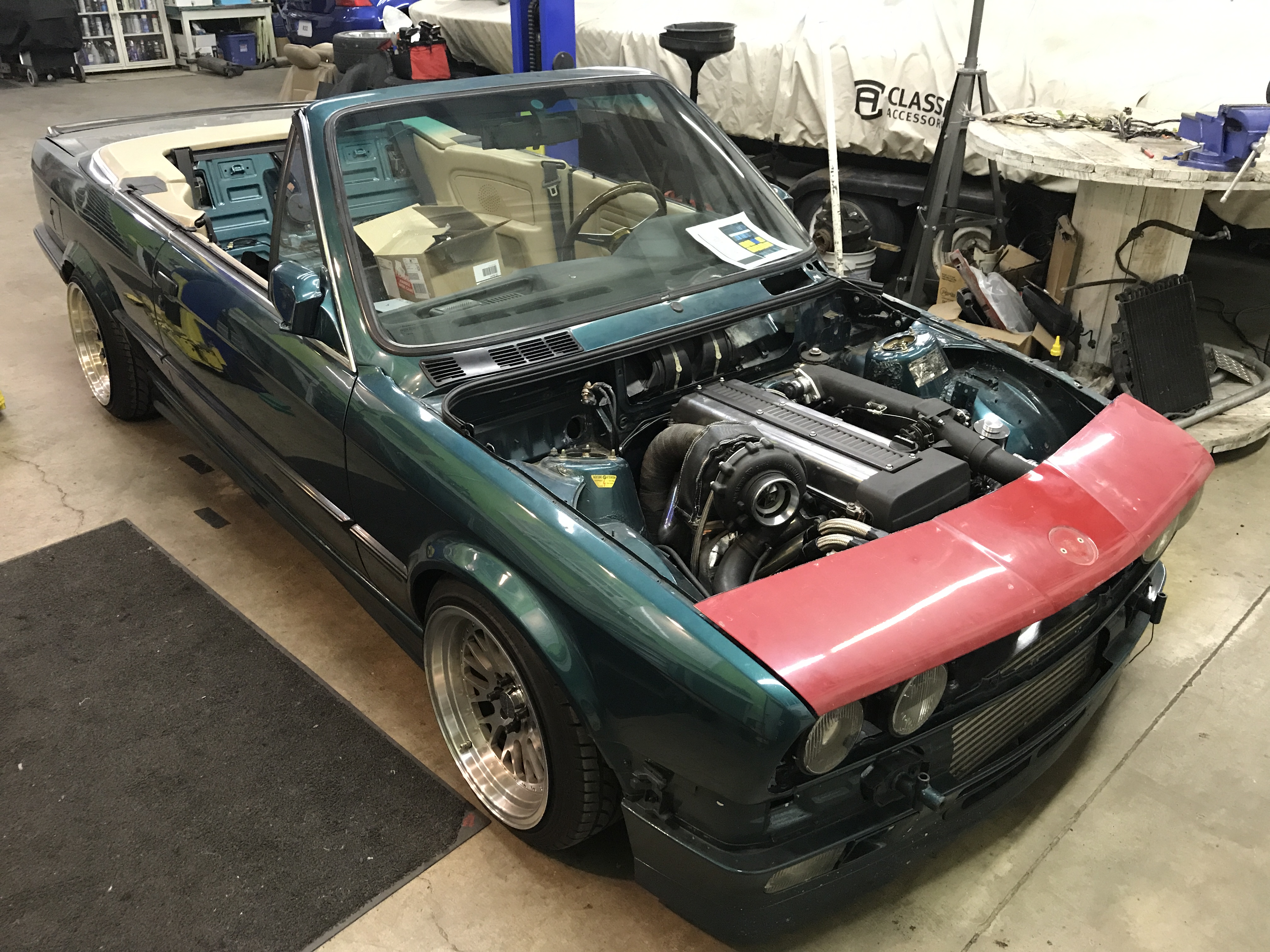

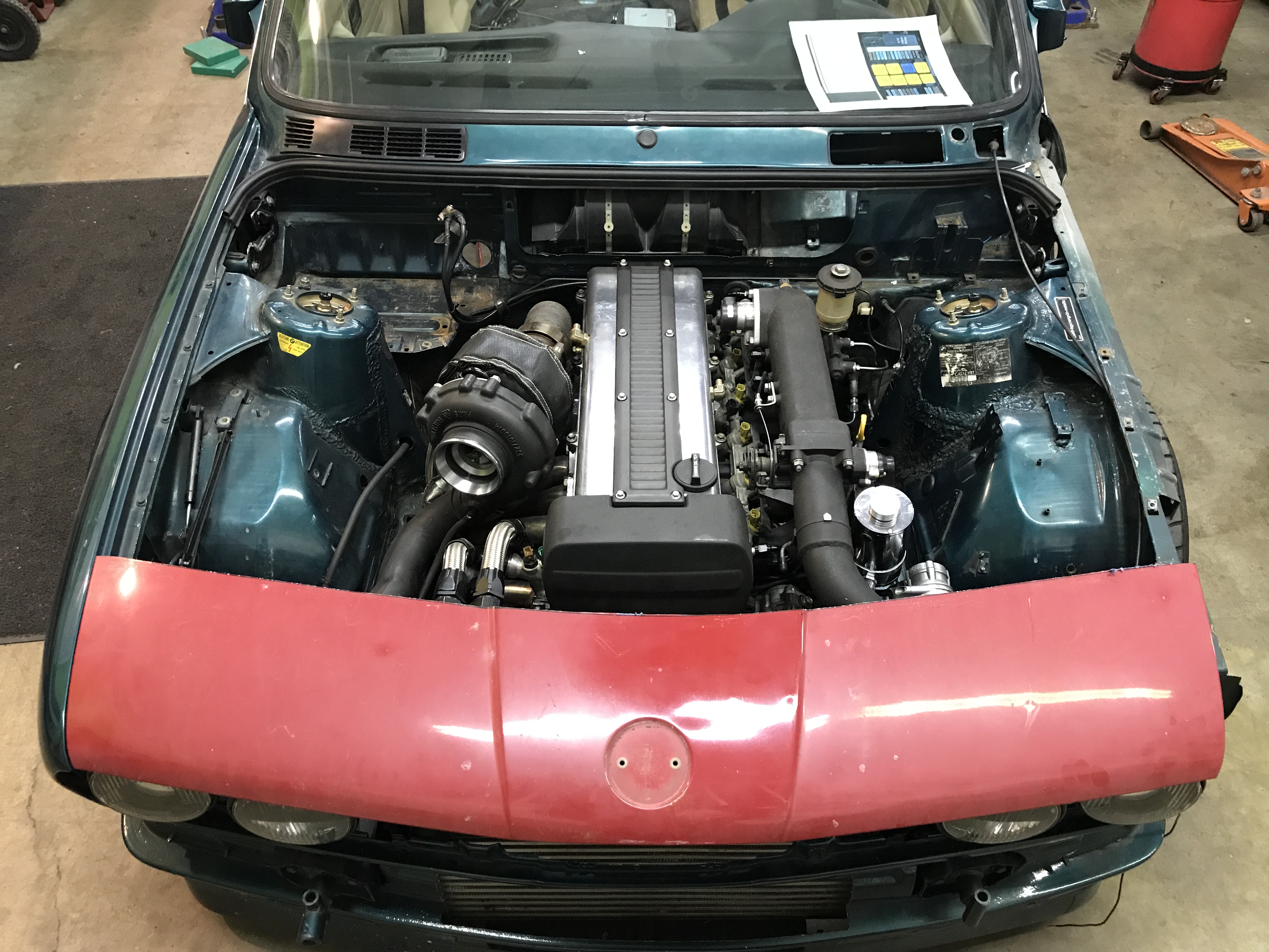

                    I chopped the hood into a nose piece today on lunch break

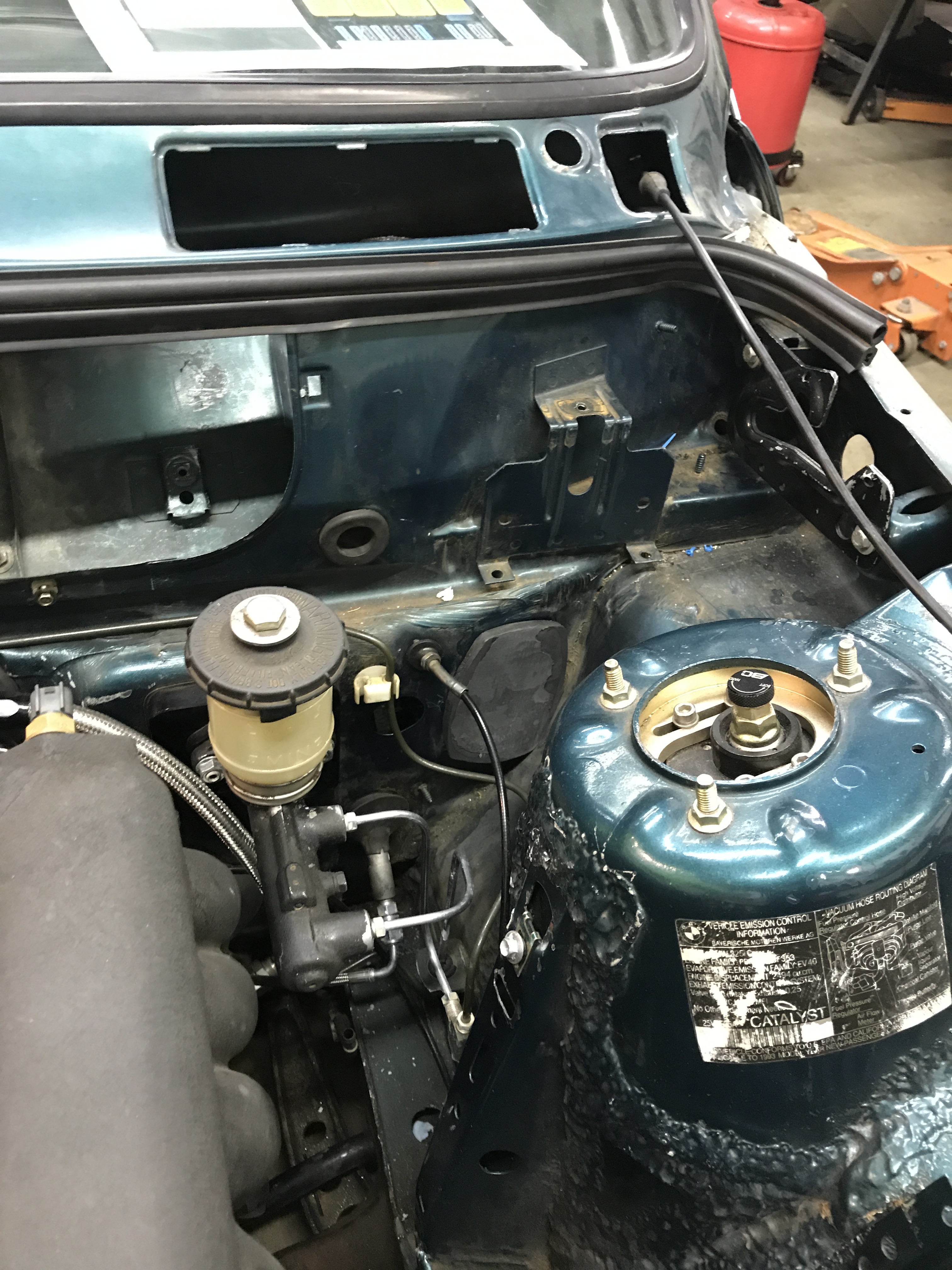

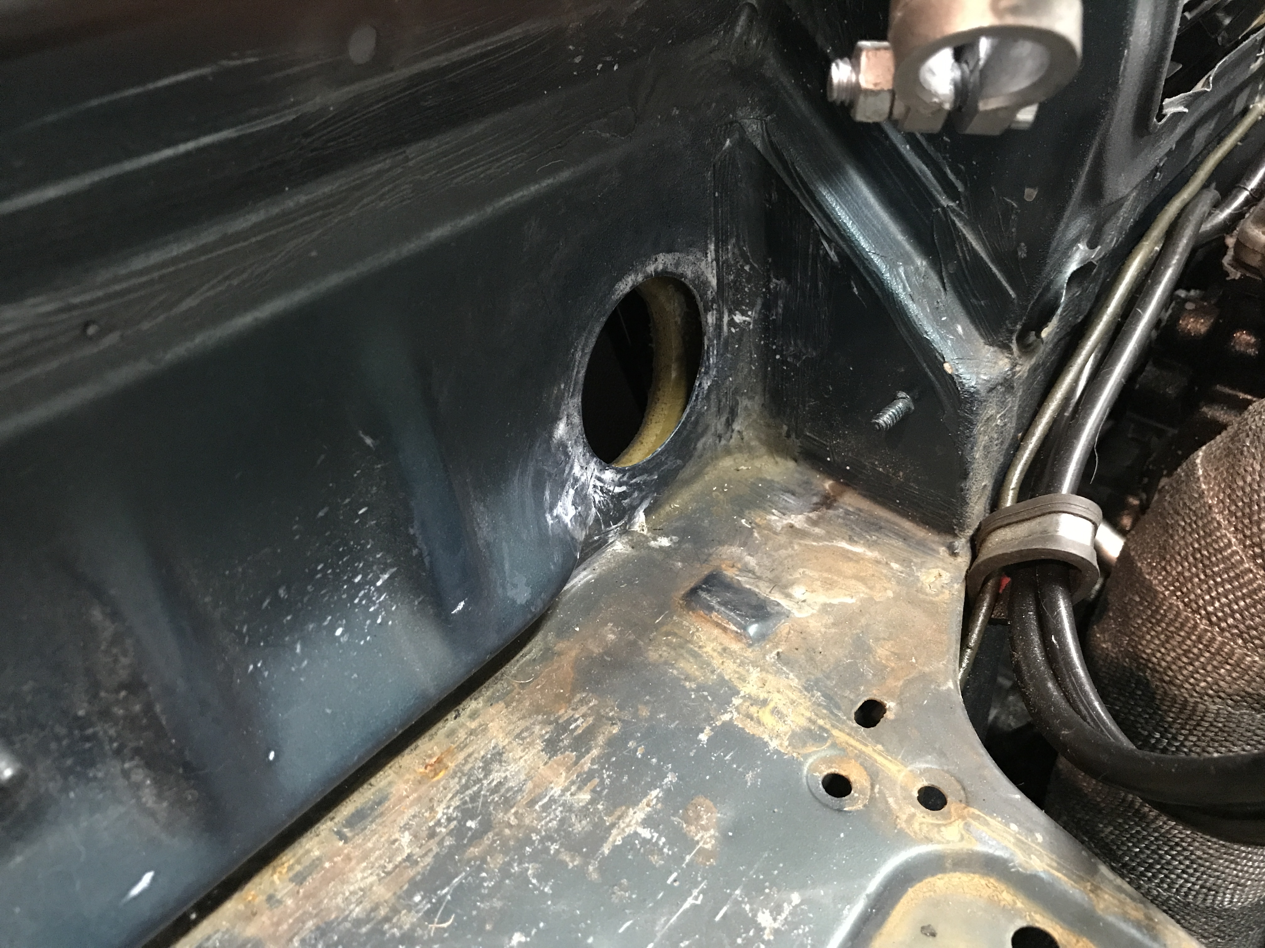

                    And I installed a firewall plug that I modified with polyurethane so I didn't have a large hole. Its just to the right of the throttle cable. This will be later filled with metal when I shave the bay.

                        Was there seriously that much coke hidden in there? lol Did you find it when you bought the car or was that a story from the PO? I remember you saying the car had a stash spot but wasn't sure if you had been the one to find it or not.
                        You also cut that hood at the perfect spot=P
                          #312
                          I say lexan the rest of the hood for that see through look

                            I wish I found that much coke in there. It would make justifying a Toyota motor in a BMW easier to digest for some.  I wish i  could cut the hood closer to the front of the car, but the headlight core support is really deep for the headlights 😕
                            If you can find me a whole Lexan hood, I would totally rock it.
                            Image result for lexan hood
                              #314
                              I think it looks perfect to me because it hides everything forward of the engine and you focus right on the engine=P

                                  I mounted the ECU and the igniter onto the cover inside the glove box. I added some foam along side the Duralock to help with any noise or vibration it might make.

                                          No more battery in the bay!!! I also made new Battery cables for the Alternator, Starter, and from the battery in the trunk all the way to the dash where I mounted a junction block.
