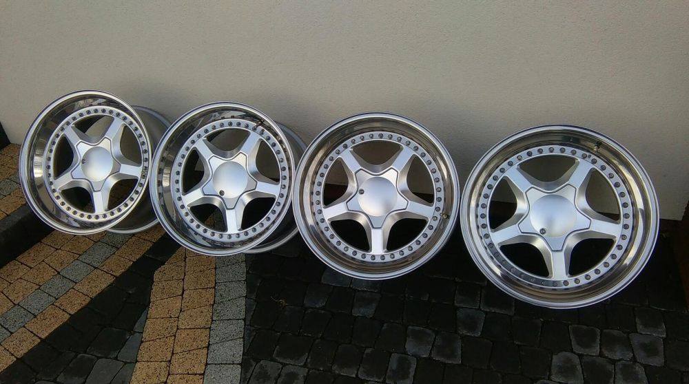

      New wheels on the way from Poland. I have spent a fair amount of time to find a really nice set of there rare German Eclairs for the right price and ended up making a post looking for a set and these appeared.

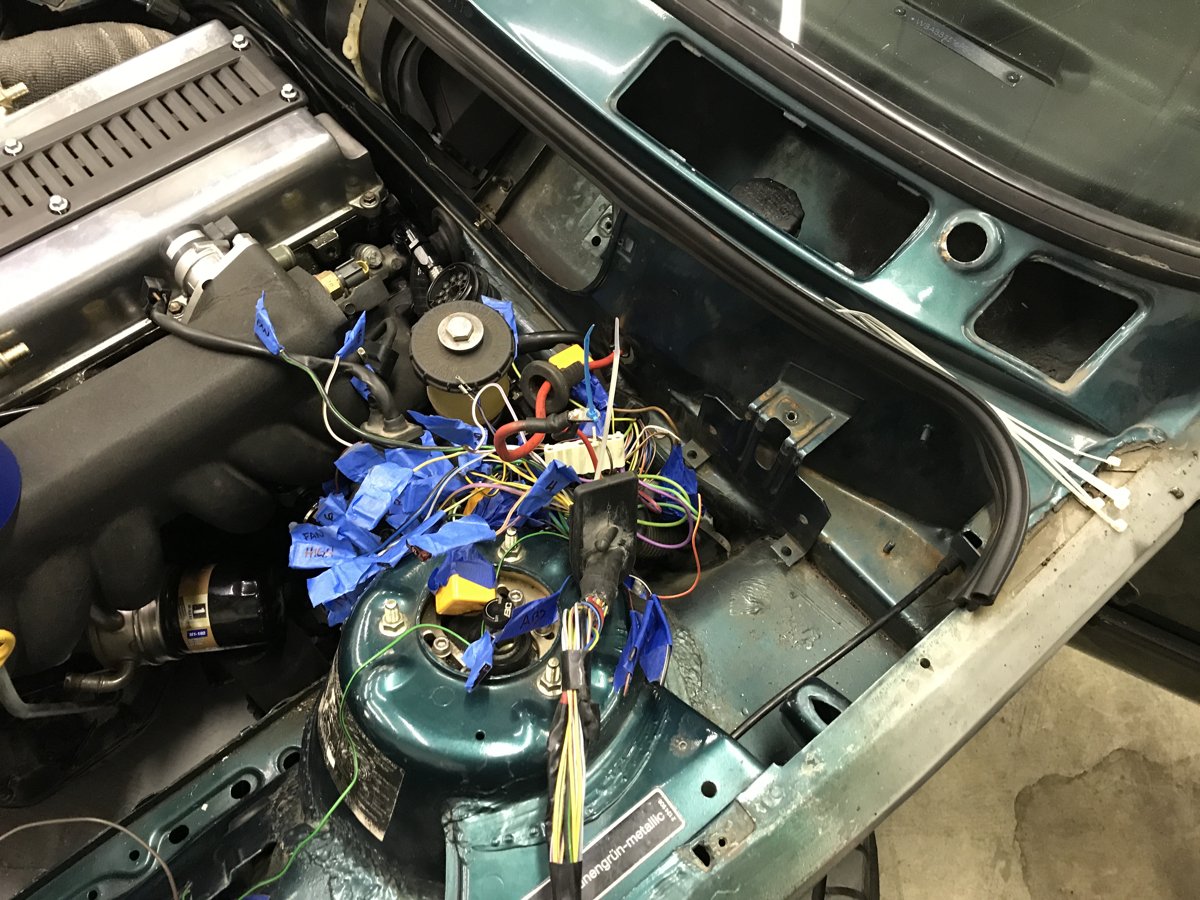

      Besides that, I also started digging deep into my engine harness double checking everything and making sure all the wires had sheathing and were completely free of cracks and splitting. I found that one of the grounds was back-feeding to my TPS which was explains some of the issues I was having at more than 50% throttle. I fixed this and went for a drive only to realize my coil packs are toast. I will be ordering new OEM coils and should be ready to go.

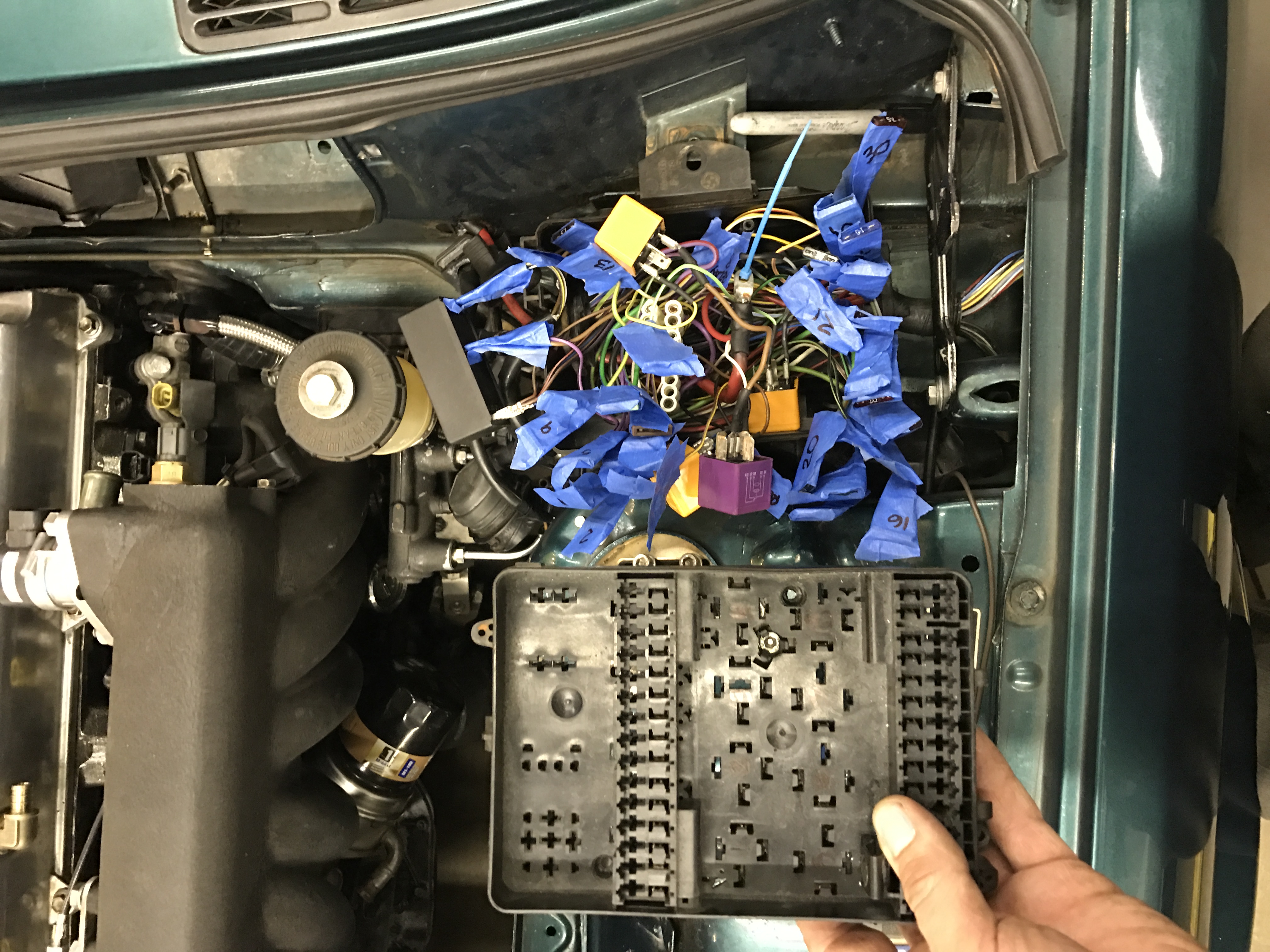

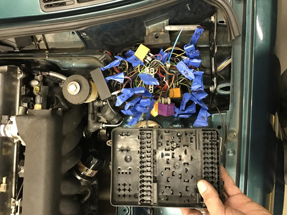

      But that didnt stop me from messing with the one last eye sore in my engine bay. THE FUSE BOX.  I started by unscrewing the box and labeling all of the connections. Once I got the box out I had to feed the entire head light harness back through the fender/ frame rail and carefully fed it into the firewall into the car.
      Here I continued labeling and removing extra wires and labeling the extras that I wont need just in case I ever decide I want to reinstall them in the future.
      I plan on mounting the fuse box under the dash in the large void where the ABS ECU use to be. I also will be making a mold of the big rubber plug that was in the fire wall and mounting the round harness plug into it for now. I hope to run standalone next year, and all of this will change again.

        Stunning wheels!

          Wow those wheels looks great.  Fun stuff tucking the fuse box.  I will be doing the same thing on my e36 when it goes back together someday.  I think Earl did that on his compact as well.

              Stunning wheels!
              Thank you!! So many people hate them but I love the simplicity of them. The chiseled spokes and round center really matches the boxy yet smooth lines of an E30 IMO.
              Thanks!! The fuse box was a last minute, "welllll I really need to do this, I might as well" type of moment.  Its way more work than I intended to do since that car was so close to being road worthy. Its nice having less components in the car and being able to remove half of the wires though. Insane that the ABS and A/C required so much additional wiring.
              I have added and removed components in the fuse box of my E36, and I must say, it looks way easier than an E30, so consider yourself lucky.

                    wow those wheels are sexy! never seen them before.

                              - I am half way through relocating the fuse box under the dash. I started to look into Mil-spec connectors for the firewall and realized I'm getting carried away.... again. I will revisit this once I go standalone and just pressure myself to move forward. For now I am making my own firewall plug and connection.(pics to come)
                              -PCB for the fuse box has a compromised section on the underside in the corner. This looks to be from excessive heat or voltage. This was used for the "HIGH" fan speed on the AC condenser I believe. I wont need this particular circuit but I will fix it anyways just to prevent the possibility of opening the fuse box up again in the future.

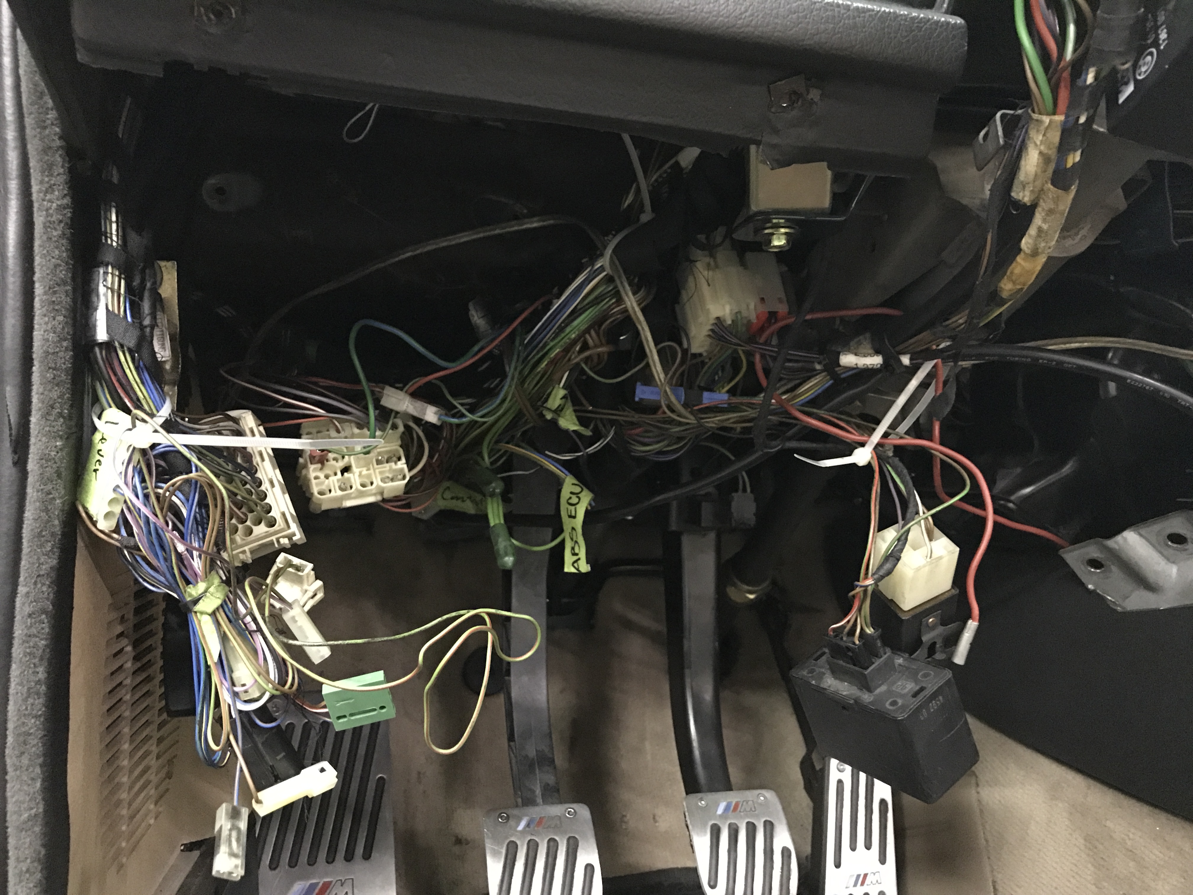

                              Some recent pics or the wiring mess:

                                      1. Moved fuse box wiring into the car
                                      2. Removed another large handful of wires from ABS,Cruise,A/C, and wipers
                                      3. Made tidy with what I could to the mass of wires under the dash.(I will revisit this when I swap to a tan dash)
                                      4. Drilled a new hole from the underside of the dash to the drivers side front frame rail and will have to reconnect all the wires for my headlight harness.
