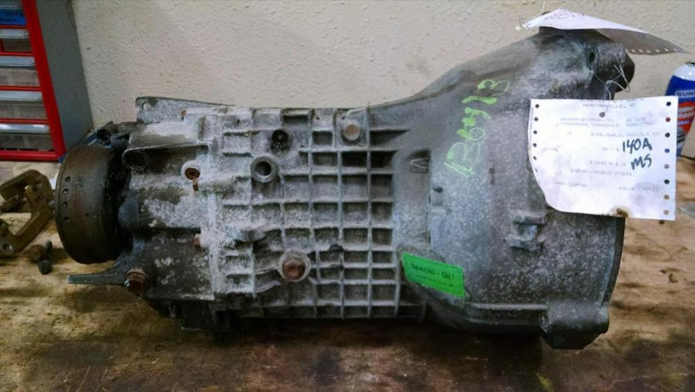

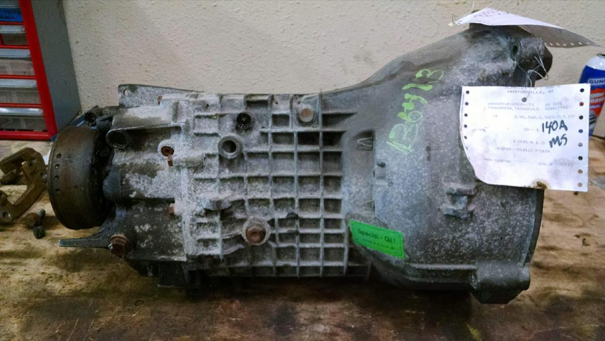

              So the old trans is out! Bought a Gearwrench 120XP long handle flex head watched to use in combination with the extension and snap-on wobble ext to get that 15mm around to the nut. Ryan "Speizo" held the 17mm wrench on the other end and it came off! We dropped the trans afterwords and he pulled the clutch while I started on swapping the output flanges.
              I upgraded to the bigger SETA driveshaft long ago when the driveshaft went out on the old burgundrot since I had one from my first car. Made a thin wall 30mm and got the flange nut off fine from the old trans but I ended up stripping the one on the new trans 😕 Fortunately I've been through this before since the same thing happened when I did that swap originally. It was harder to brace the flange since the new trans still had the vibration dampener on so I get to cut through all of that next time.
                #118
                2 Months later....
                I ended up never getting the flange off the replacement trans. After swearing so many damn times at the thing and giving up for a month I gave in and bought a replacement trans for my replacement trans  :rolleyes:  Got the flange right off on this one and swapped on the SETA/535i output flange. Went to pour in the royal purple 75W90 I bought and just as I was about finished with the 2nd bottle it all leaked out the output shaft seal  :angry: "Royal Flush"
                Ordered up the seals and Redline MTL, as thats preferred fluid of the MyE28 community, but didn't have time to work on the car this weekend. This concludes buying every single component in clutch/trans! Now to throw it all back in.
