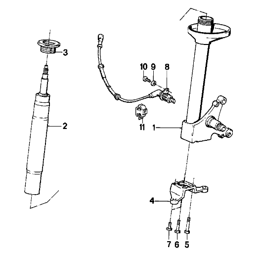

You could add shims between the knuckle and strut to add a touch of camber
This way you keep your drop hats
It looks sketchy but is very very common
I wish it were that easy on an e30! The M3 struts are two piece but not like the e36/later cars, the split is horizontal between two cast parts:
