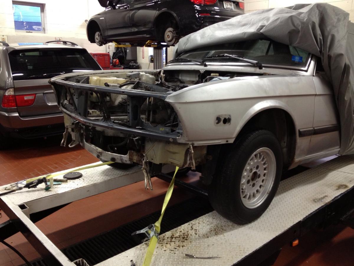

              Now to the pictures! Didnt get it welded up last night as I realized I was kinda unprepared  :huh: I will bring in the hood and fenders tomorrow so I can make sure the core support is in the right position because I didn't want to guess and be wrong! It wasn't as ready to be welded in as I thought, as you can see from the pic below I had some overlapping metal.

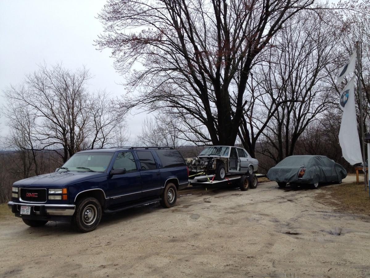

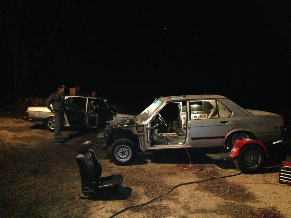

              Took me about 45 minutes to load this thing onto a trailer by myself in the pouring rain :( Didn't realize the parking break was on too lol, would have spead up the loading process!

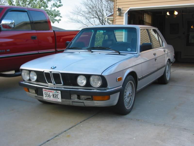

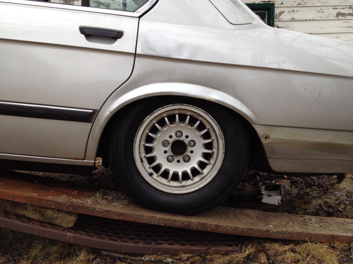

              Earl and Brian will be jealous of my mad tuck! Might even be the lowest on the forum  :lol: lol this is my "static" 2x4 suspension setup from when we trailered the car the first time. Still need to transfer the rear suspension from my parts car.

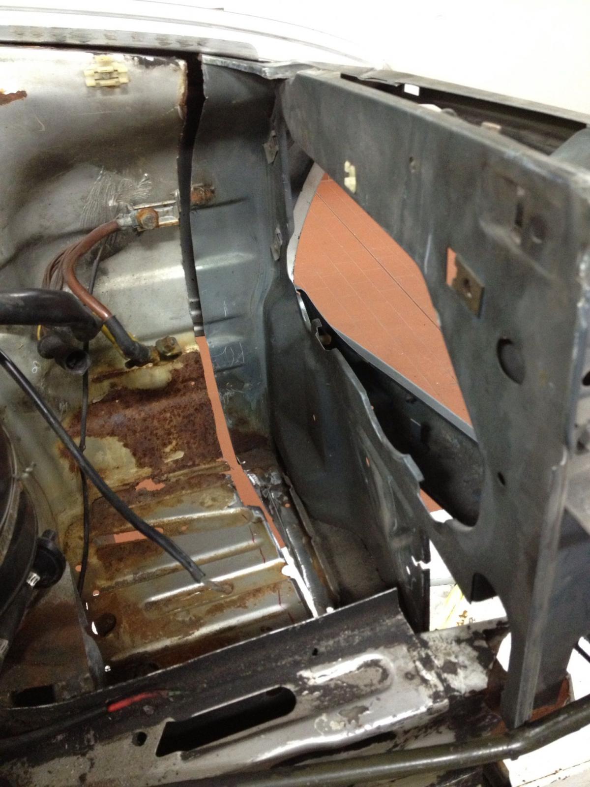

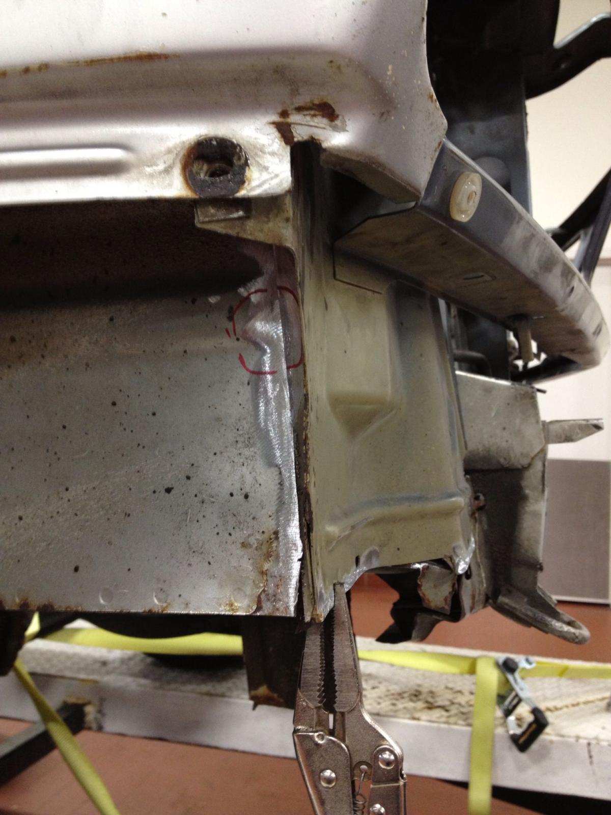

              So the work begins! Mounted up the core support for the first time and realized that the body needed some trimming for fitment on the driver's side. These are the cut lines I drew out.
              post-2724-0-96922900-1365739887thumb.jp

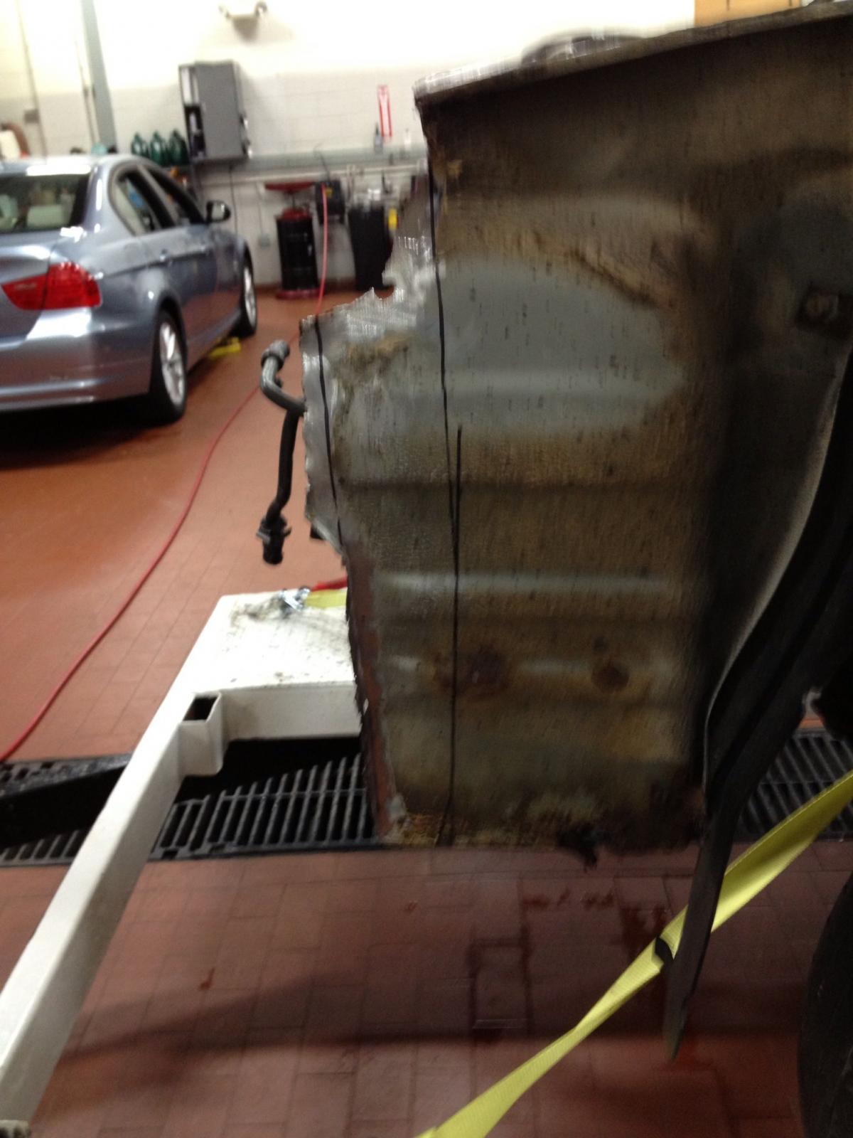

              Test fitment after cutting. Much better but I still had no way of telling if it would be accurate or not. I will be mocking up the front end tomorrow with the fenders and hood so I know exactly where the core support should sit.

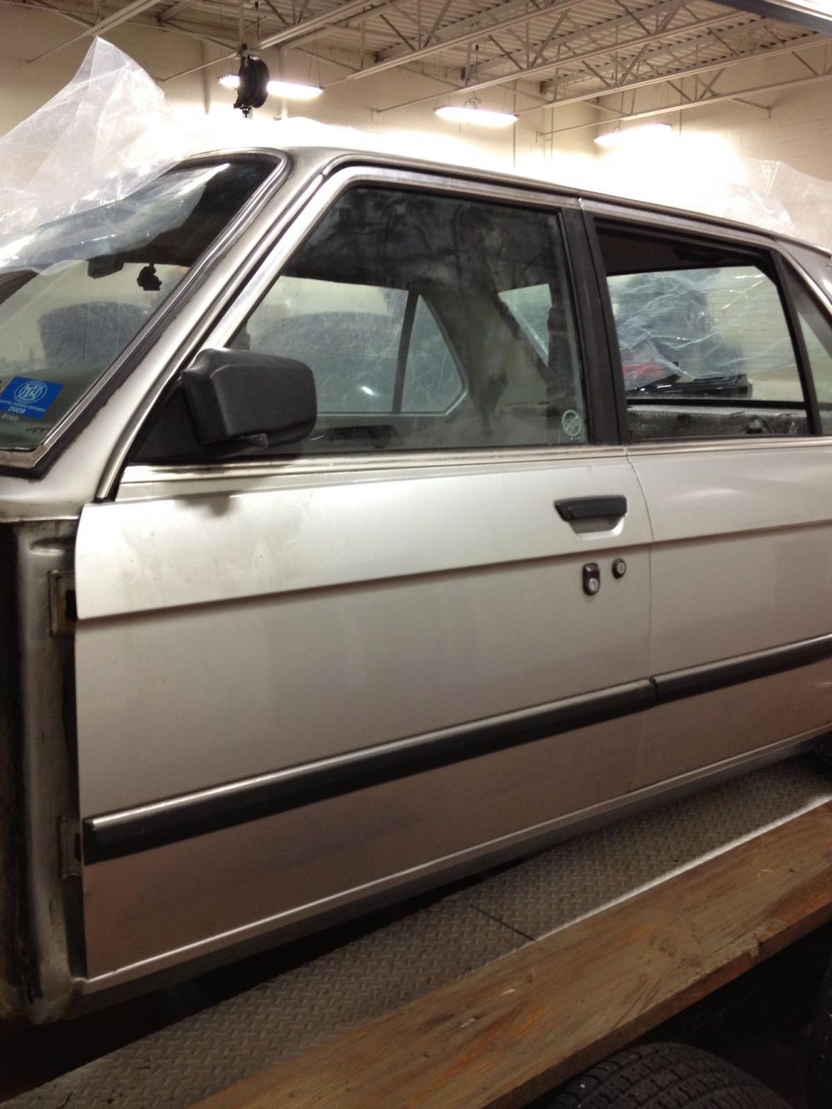

              Figured since the welding wasn't gonna happen, I'd remounted the driver's door. Its not on perfect but it shuts.

                Why does it look like there are two locks on the door? Keep up the good work Chris.

                  I'm still lower. unless those are 14" rims. My rim sits dead even with my fender.
                            14" wheels :P I'll have to measure how low the fram sits for bragging rights lol
                                  Sorry I didn't see this before Earl! The second key hole is for the Euro Alarm System. I hope to get it working down the road. For those of you that have seen Chuck's E30 touring he has the same thing.

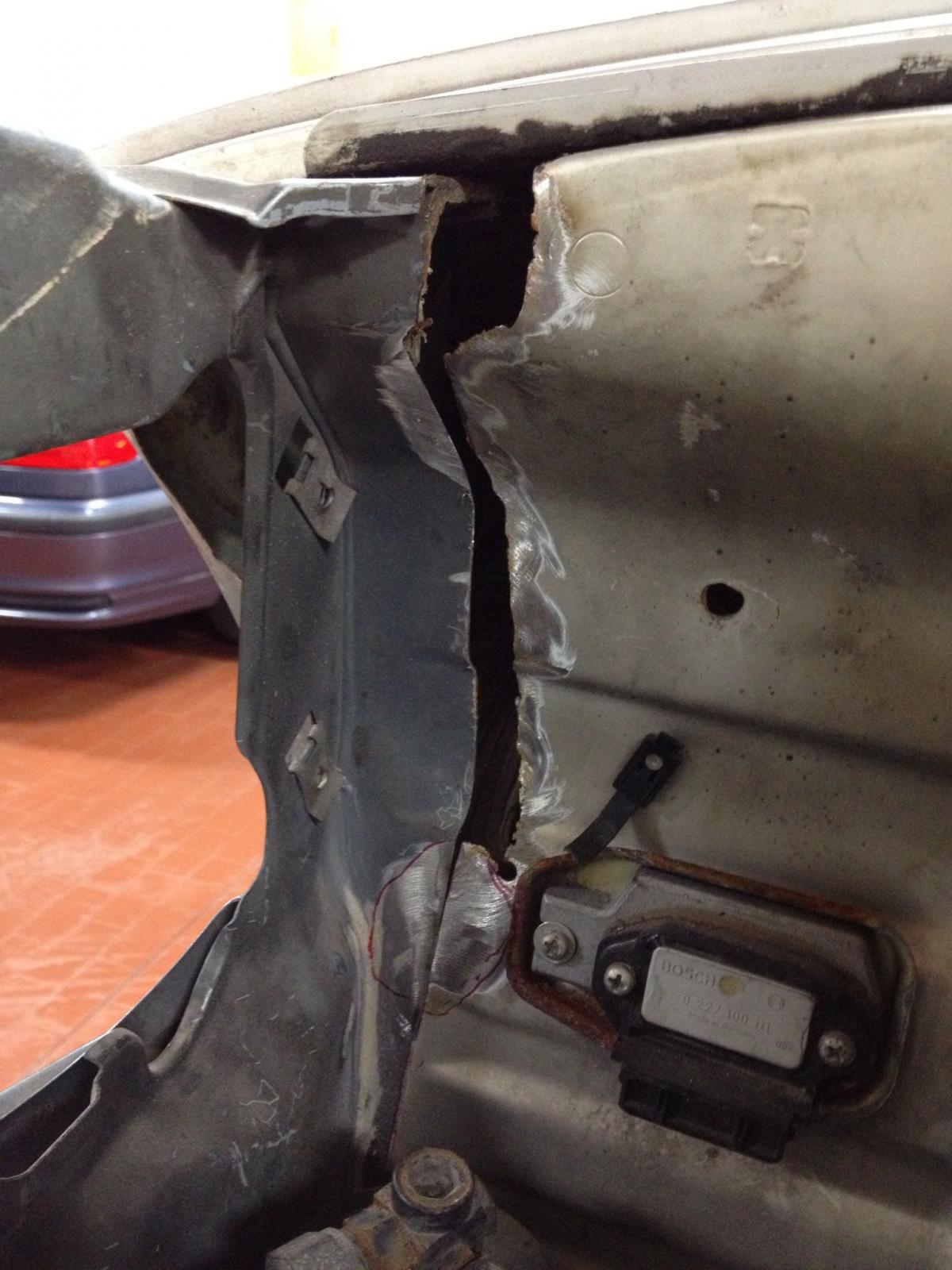

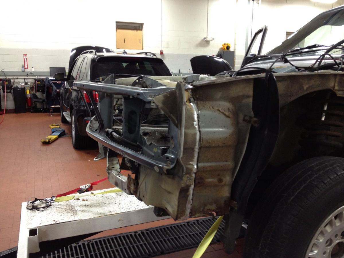

                                    Finally getting around to my update from Saturday. So to make sure I had the core support lined up in the right spot I mocked up the front end by attaching the fenders to the body and then attaching the core support to the fenders.
                                    post-2724-0-84231400-1366224223thumb.jp
                                    I had a little bit more cutting to do and turns out I trimmed out too much on the drivers side. Since none of this is structural and the only purpose of the core support is to hold the radiator in place along with the headlights, strength is not needed. Done the road this body work will be taken care of properly but for now its minimal effort where needed to get this on the road.
                                    Driver's Side
                                    post-2724-0-80603400-1366224325thumb.jp
                                    Passenger Side
                                    post-2724-0-09276200-1366224344thumb.jp
                                    Passenger side Seam between the frame and core support matching up perfectly
                                    post-2724-0-05590800-1366224374thumb.jp
