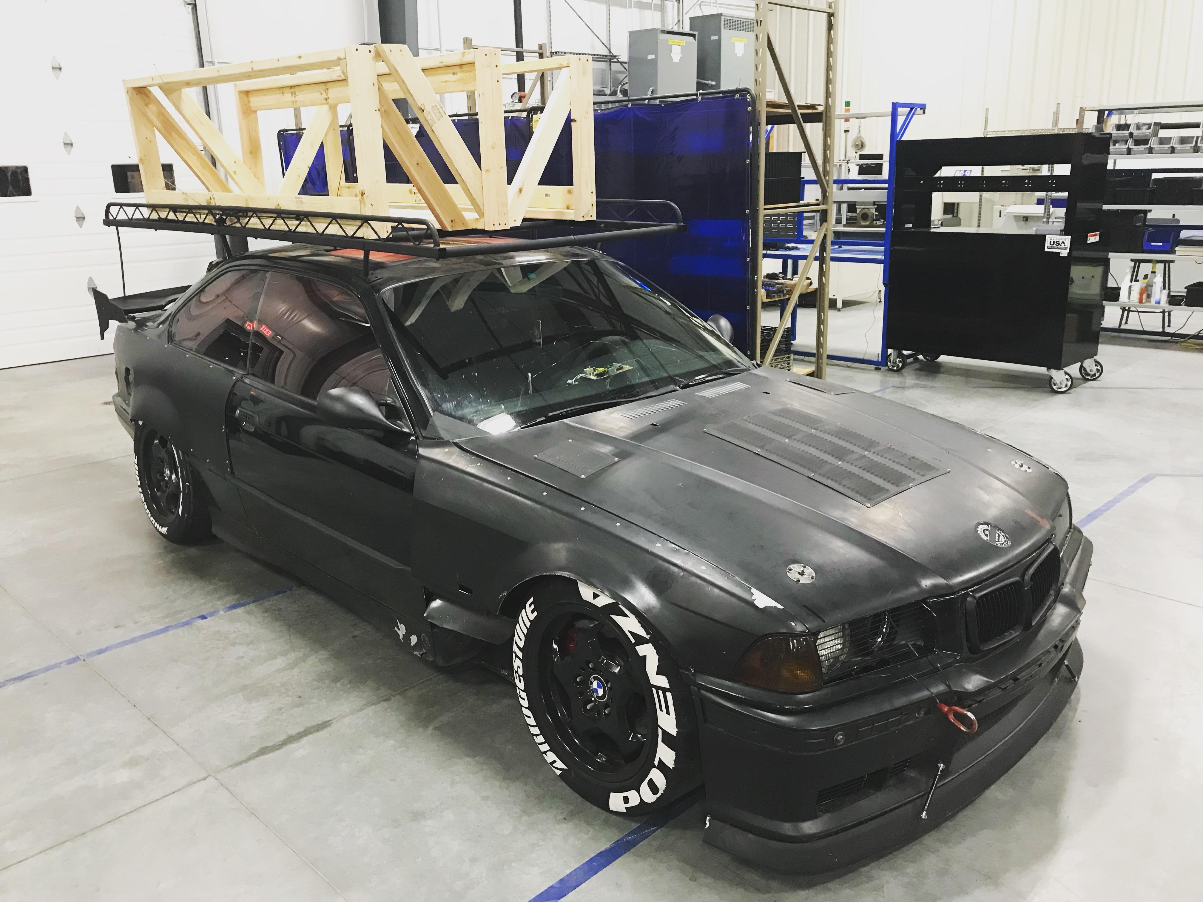

                                    my options are open. need to find something that'll haul the kayaks and related fishing gear around, which could be a wagon/suv/small truck. I can haul them around with a car as small as an e30, but it's not ideal.
                                    Sounds like you need a roof rack from a van 😉
                                      #246
                                      Jdesign said:
                                      Sounds like you need a roof rack from a van ;)
                                      lol. its less about outside space, and more about fitting two kayak seats, kayak paddles, fishing poles, fishing gear, weather gear, luggage all inside the car. the e30 worked fine for day trips, but anything overnight requires a vehicle at least as roomy as the touring.
