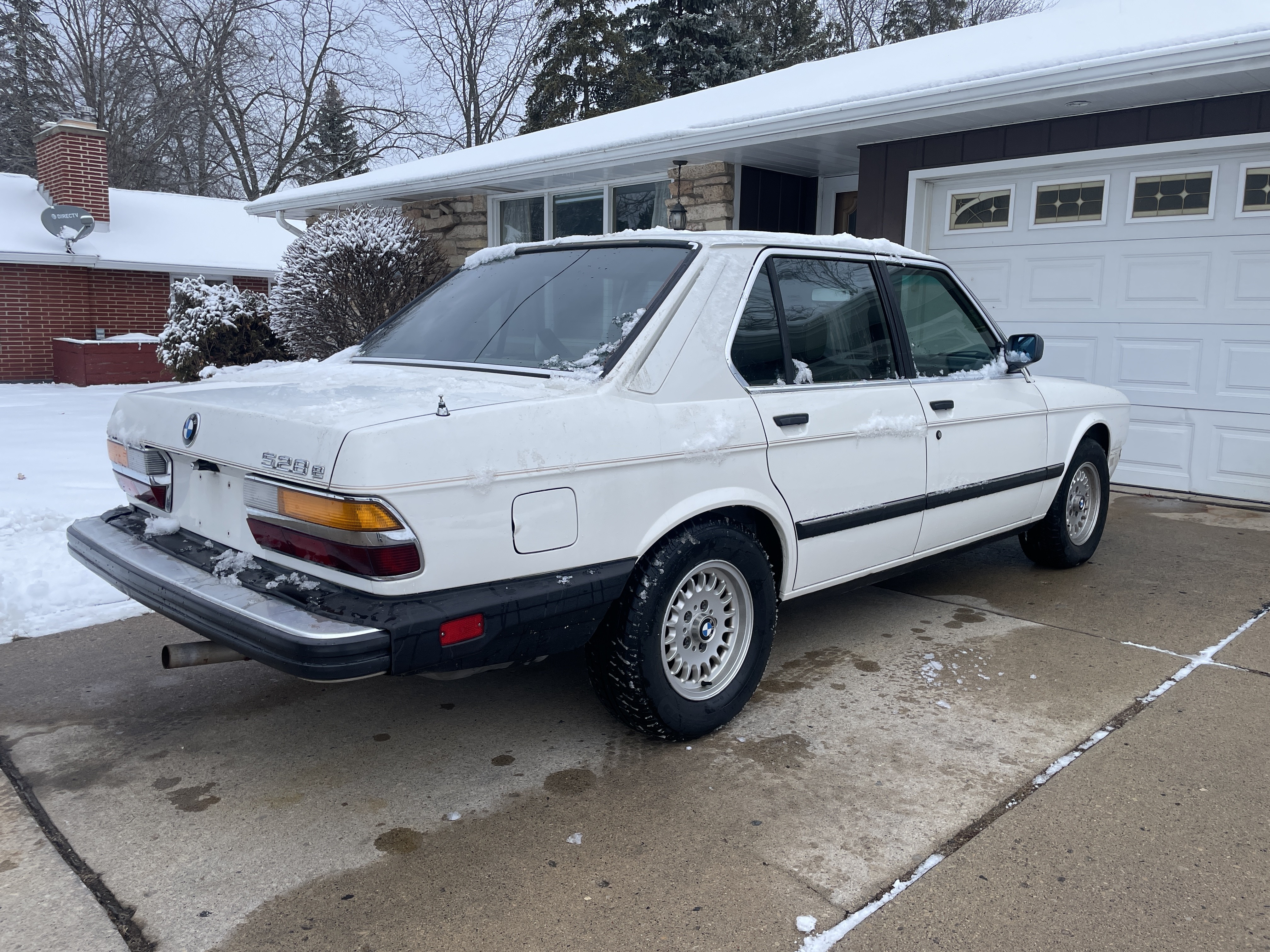

    I’ve had several Bimmers over the years. I have recently acquired a 87’ e28 after a long search. I have a clean car to fine tune. First thing I’d like to do is swap out the auto for a 5speed. Any experience or advice is greatly appreciated.

          Great notes - looks like this car is a 528e, so M20? He’d want a kit from a 528e.

            Shoot coffee hadn’t kicked in yet 😂 sorry my mistake but yes need a 528e donor. Gibson’s in Neenah still has two but I didn’t look closely last time I was there.
              Welcome! looks like a clean and fun project!
