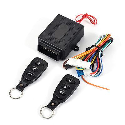

    Keyless entry. I installed a similar unit on my E30 and its one of the greatest things ever. Plus I really had to squeeze my pockets for the $10.49.

                    I managed to Install keyless entry with a vintage looking fob kit I found on eBay for $9. It works great and is very similar to keyless in an E30/4/6 where you just wire it into the trunk latch.
