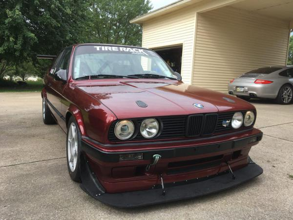

    if loosening the bolts that hold the bracket dont give you enough adjustment, you could slot the holes in the bracket to add up/down adjustment - they are plastic.
    Slot the holes in the bracket, or the body/valence of the car? This is a good idea and think I might try this tomorrow after work.
    I'm gonna paint the old kidneys black, liking how this all black looks. Also kind of makes me reconsider smoked headlights.

        Reach inside the wheel well to the back side of the bumper mtg bracket that you are talking about slotting, there are two 10mm (8mm?) head bolts, loosen those up a couple turns and then move the corner of the bumper to where you want it. Hold the bumper there and tighten the screws.
        Profit!
        I do like the black / calypso that you posted above!

          This is a good idea as well. I had tried to fiddle with the bracket when the bumper was not attached, but doing this seems like it might be worth the try before slotting the bracket.
          Kind of along the lines of what @Earl was saying, it’s decent fitment, but I would like to try and improve it.
              i guess either would suffice, but i suspect the brackets will be an easier task (plastic vs. layers of sheet metal)
              based on a photo of the bracket, it looks plausible, although i don't recall the hardware that is used here.
                #230
                That all depends if its OEM hardware or not, and whether anything has been tweak previously. That bumper seems to fit pretty well as is. There should be some adjustment in the brackets as mentioned but I would make sure you have enough room and its not under tension when you adjust it. If it is, you risk it just shifting back into its happy place after the first jolt down the road.
                Check this out as far as adjusting:
                http://e30.bmwdiy.info/bumper-adjust/index.html
                Also I have a 280-300mm Broadway convex mirrors in most of my cars including my Dually and I love them. I have had them since my JDM high school days and it just feels weird not having one. I actually prefer a Broadway over a wink mirror now too considering I have one of those in my E36. The visibility and division in the panes of glass just isnt the same as seeing it all at once in one focal location.
                  #231
                  Can't slot this, as it's got a metal clip that goes around those holes that has the thread for the bolt that goes through the body.
                  That was a confusing sentence....
                  At any rate, the link @Jdesign posted is what you need in life.
