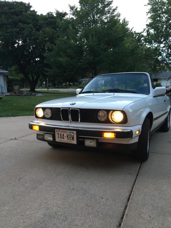

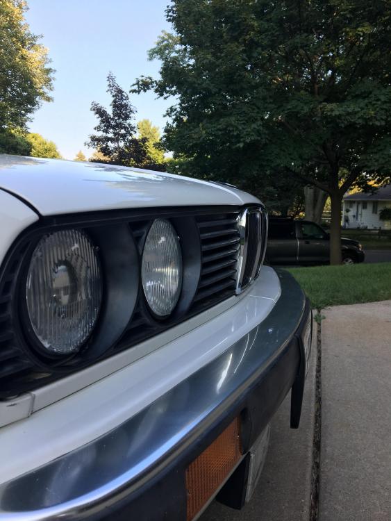

                                      Haven’t updated in awhile, I’ve really just been enjoying driving it lately. I rolled over 194k recently, making that more than 2000 miles since late May.
                                      I recently did some paint correction, took me around 16 hours for the whole process of washing, clay barring, compounding, polishing and waxing but was well worth it both in results and the lessons learned. Most if not all of the light scratches and swirls are gone, revealing a surprising amount of deeper scratches, gouges and chips. I suppose that’s what happens with 29 year old original paint. I’m going to go back and redo the trunk and hood, I think I can still get some more imperfections taken care of because I did a super light cut the first time.
                                      I also picked up a new to me sport steering wheel from @YoungCR to replace my cracked and worn out one. It made a huge difference in the look and feel of the interior, super pleased. I also got a replacement speaker as well, so my speakers all work now. Thanks again!
                                      The other new thing is a set of euro grilles that I picked up from a guy in Chicago along with a perfect, uncracked rear ashtray for $45 total. The drivers side grille is warped which is why I got them so cheap, but I made some good progress with a heat gun to straighten it out. It’s still a little wavy, but I’m gonna work on it more tomorrow, then do some filing, sanding and then paint to cap it all off.
                                      I’ll post some random pics of all this tomorrow.

                                        Today’s happenings:
                                        6B0BADED-BBE9-4F3A-8FFF-26F53FD1E58B.jpeg8433179C-44B2-4035-822D-A11999C63E7C.jpeg8FB3C328-1287-42CE-BE16-30F9D8D78088.jpeg8433179C-44B2-4035-822D-A11999C63E7C.jpeg
                                        Front right shock let go in a mildly spectacular fashion, guess that means that I have a bit of work ahead of me when I get back from school next year. All of the rubber in the front end is worn out anyways, so I’m just gonna do it all at once when I have the opportunity, probably with an e36 rack as well.
                                        I’ve heard that using e36 centered control arm bushings is a good upgrade, any other recommendations? Would e90 drop hats work fine with stock suspension, or is it not worth it? I’d like to maybe reduce the wheel gap a little bit if I can for cheap.
                                        Also, some pics of the euro grilles. The passenger side one is a genuine BMW part, but the drivers one isn’t and I think that’s why it fits kinda weird and was warped.030B5B03-C844-4451-8F0E-78BCBEB0A2A0.jpeg91D94307-942C-4075-88A7-69C4944DAC35.jpeg
