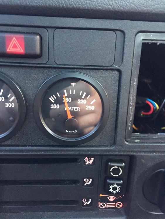

I got everything back together, charged the battery and went for a half-hour long test drive. The engine ran perfect despite the O2 still not being connected and now I have a different problem. The temp gauge reads too low
It sat steady at a tick under 180 or at 180 for the entire drive regardless of electrical load. FWIW I rewired so it no longer shares a power or ground with the other gauges.
if the mighty temp gun is to be trusted its about 15 degrees off. The top radiator hose reads 195 F.
I sat idling in the driveway for 5 minutes or so and the gauge only climbed to the 190 mark.
I will just play it safe and assume the gauge reads 20F too low and anything right of the 12:00 position will be the “shut er down” temperature. Consistently wrong is better than consistently moving around and I will see if I can make it more accurate another day.
