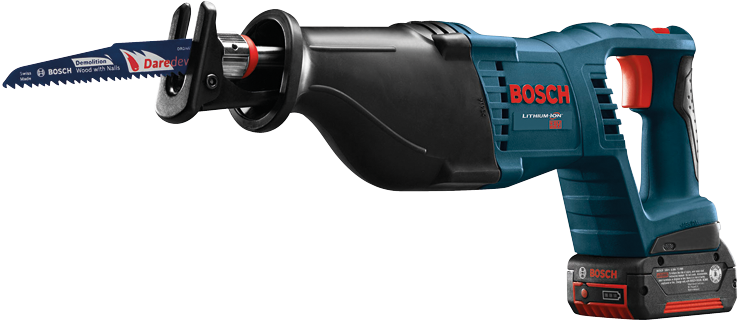

                Mannnn I really wanted to use my new sawsall. :c I yeeted it open today. We good now.
