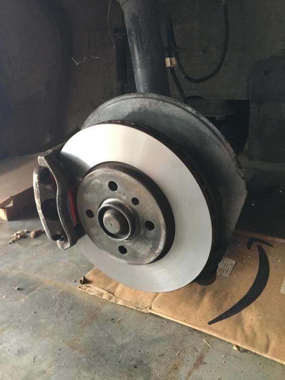

                            Got the car down and off the jack stands today, I finished up the brakes yesterday. I never got the remnants of the set screws out, so I guess I’ll try again this summer when I have good temperatures and space to move around.
                            F2CF5DC0-8907-4BDD-B029-346288138DFF.jpeg2C95C2F2-401E-4E69-97F6-DA433345511B.jpegTook it out for a drive, everything seems alright so far. I’ve got a few things that need to be taken care of, namely the power steering system leaking like a sieve, as well as a tiny leak in the fuel tank at the inlet.
