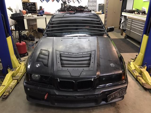

                                        I also started looking into what I might do with the hood. I have yet to come across some venting that I liked that is also fairly cheap. At a quick glance, online suggests I might have to order what I need if I cant find it locally. I want to make louvers, but actually buying or making a die, is way out of my price range. I was looking into home vent/ air returns and found a few of those around $20.. they might just do the trick. Otherwise I am just going to cut into the hood and bend the material down for venting like the red hood below. I figure if I mess up I can just cover it with the home venting.
