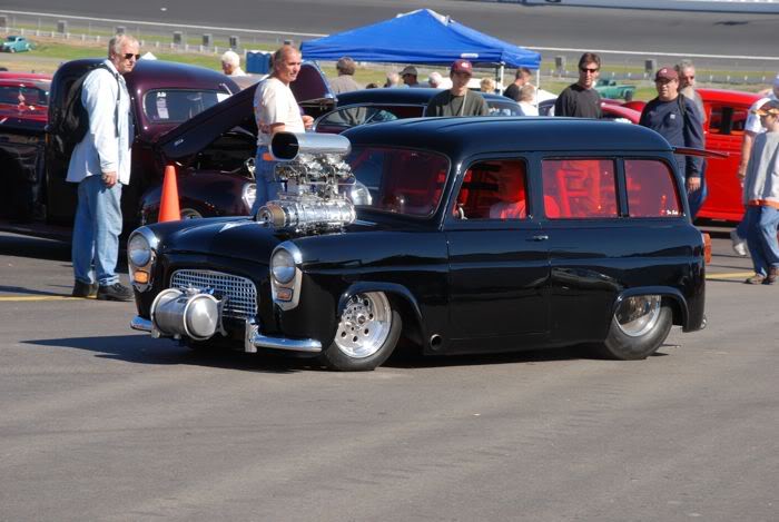

          Some inspiration for you. This car was at the Appleton meet back in 2012.

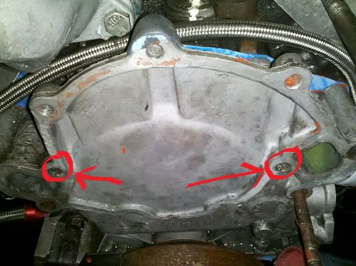

                                      So I got the whole water pump deal back into the car for the second time, only to realize that it was still leaking from somewhere. It turns out that if you own a Ford you have to get really use to taking things apart more than once. So what happened is there is a second set of holes in the timing cover for an older style waterpump. SBF's have been around and in production for a longggg time. Apparently my understanding is that I have a reverse rotating timing cover which is common for older carb'd 302's and mine is a newer fuel injected motor and I am using a regular rotating water pump.

                                      So I can run this timing cover but I will need to thread some type of plugs into the bolt holes that the coolant is leaking out of. Ughh.

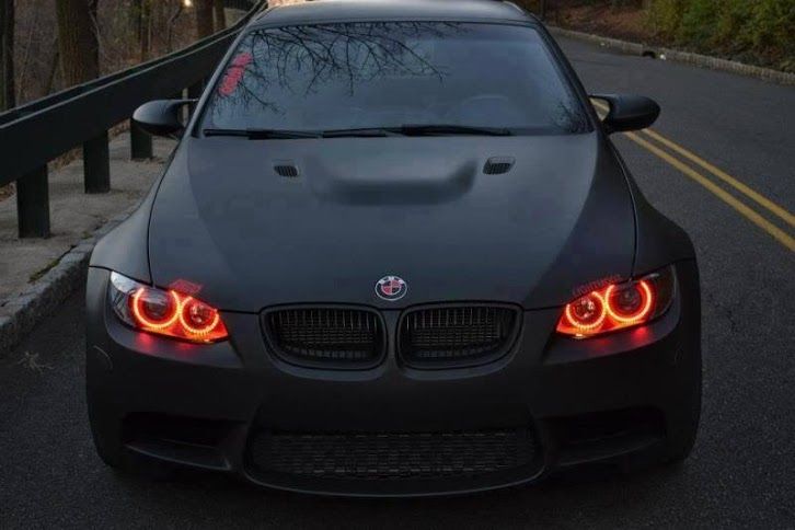

                                      On the more aesthetic side of things, I have come to the conclusion that I am going to add some red accents to the car to make it seem more, uh demonic or devilish? I ordered red window tint and plan on adding some red halos and red leds here and there like so:

                                        I think that red tint will actually look pretty awesome on this car. Nice idea!
