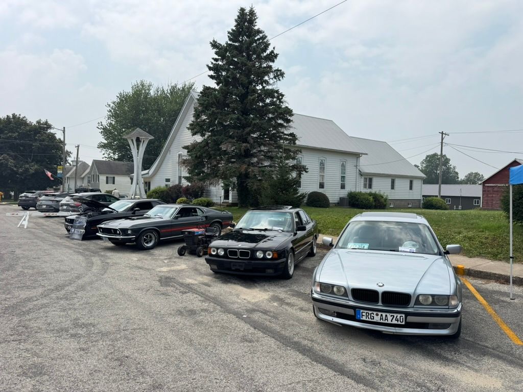

                      Not a whole lot has changed with this car other than racking up the miles! At 182k now, this has been my daily driver for the last 2 years and apparently 26k miles and hasn't skipped a beat. Replaced the steering linkages and idle arm a few months ago but still have some adjustments to do alignment and suspension wise. New parts did not solve the popping noise that I hear when backing and turning out of a parking spot. Unfortunately one of the tie rods I got from FCP was Lemforder china, completely different part so we'll see how long it lasts. I have some more oil leaks to chase down over winter as well and will need a new set of shoes for spring.
                      I did finally go to a car show for the first time in years for the town festival. I moved to a town of 440 people and unbelievably the neighbor down the street has a euro spec 740iL which is pretty neat, there's also few older Audi's in town as well. The Hellcat on the end is the first Hennessy HPE1000 kit installed. 1140hp to the wheels lol.
