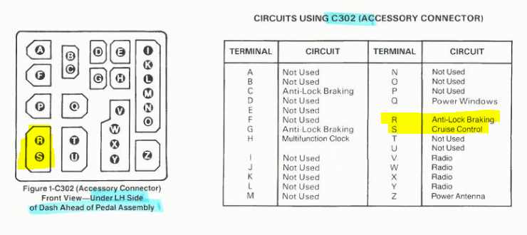

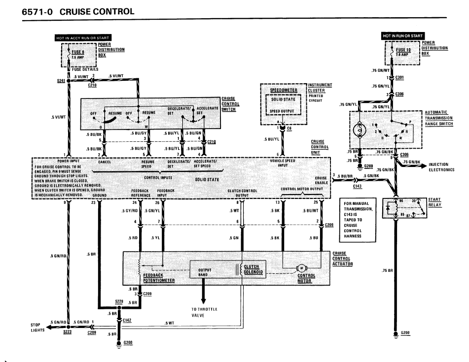

    Confirmed last night that the speed signal wire is plugged in behind the cluster. Confirmed the brake switch and clutch switch are good.
    I went to look more into why the CC connector wasn't getting 12v from the brake switch. This morning I confirmed that the brake switch on the pedal and on the accessory bank of connectors (i don't know what to call it) below are both getting 12v with key in pos2. I don't know why that circuit calls out R as ABS, because R & S get their signals from the brake switch - one is constant and one is the switched wire.
    After pressing the brake pedal, the switched side on the brake switch is 11.5v, but the at the pin on the accessory connector it's almost a full volt lower around 10.8. Which lines up with the readings I was getting at the CC ecu connector. Why would there be that much of a drop?
    I can't find any good information on what it means that for the CC to engage, Pin 9 (which is from the brake switch) need to sense ground from the tail lights. Does that mean pin 9 is grounded through the tail lights? I'm not really sure how to check that.
      #1123
      Still trying to figure this out. It’s not the cruise control stalk lever. My only lead right now is a potential voltage issue. These are the voltage readings i did this morning:
      The violet wire feeds fuses 4,5,6,12 and fuse 6 feeds the brake switch.
      Is a .5v drop through the ignition switch normal? I’m going to replace the brake switch and clean the brake circuits grounds under the rear seat, but still, is a small voltage drop like that something to expect from the ignition switch? The diagnosis from e30zone says that green/red wire should be feeding the ECU box with 12+ volts when the brake pedal is pressed.

        Cruise control works. I took the actuator apart and did a better job adjusting the cable. I think there was too much slack inside the actuator before.
