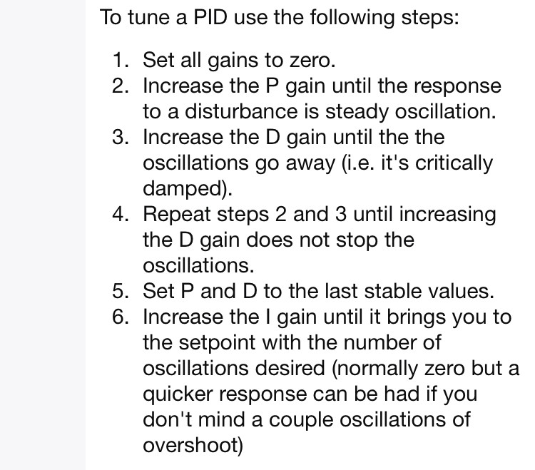

    Tune closed loop idle control: Did some work on this and it's getting better, but still oscillates/stalls when coming to a stop. Software accepts values from 1-3000 for PID parameters, but I have no idea what values are sane here.

      Something to try
        #269
        ^  We had to do this on the Miata for the EBC in tuner studio when setting up closed loop boost control. Also when finding the min/max for the IAC for closed loop idle.
