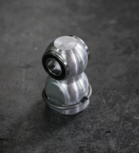

      • Get rid of the garbage Garagistic solid gear selector rod joint.
      A question about a general clean up of the engine bay. I wouldn't be going for full a fully shaved bay, but I would take a grinder to it to clean up the surface. Are there any negative affects that would come from smoothing out the seam sealer to an extent that would allow me to  effectively prep the surface for paint?
      do expound on the Garagistic part, please.
        It appears they now have a Version 2:
        @The Full Bananaand myself went in on the preorder for when they first made them and the first version, the bearing is flush with the housing. On this one it protrudes. So after you install it in the DSSR, the bearing doesn't do shit. Plus - they made it about a mm thicker than the oem one, so I had to file down the DSSR for it to fit in it. Basically ruining it if I want to replace the selector joint. I will be replacing the joint with an OEM piece and get a new DSSR from anyone else. I don't need anything else from Garagistic anymore.

            I saw those selector joint things when they had the first release. Passed because garagistic lol
            • The Full BananaT
              The Full BananaT
              The Full Banana
              #1066
              Can confirm, the garagistic selector joint is total bullshit. How they decided to release that is beyond me.

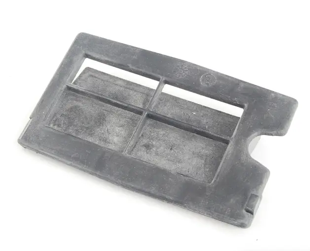

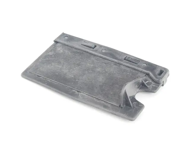

                              I suspect I may need to get somewhat creative with the non-return flap found in the HVAC box. It's this:
                              It looks like I could open the "clip" at the top and swap in a new piece of rubber. Other than roaming the isles of Menards looking for a suitable material that I could cut up, does anyone have any suggestions of a comparable material I could use? It's just rubber.

                                https://www.amazon.com/SPAL-30130012-Replacement-Rubber-Shroud/dp/B019XDLULW
                                rubber flaps for radiator shroud pass throughs might be the right “weight/thickness”
                                  #1076
                                  Exactly what I was looking for. Thanks!
