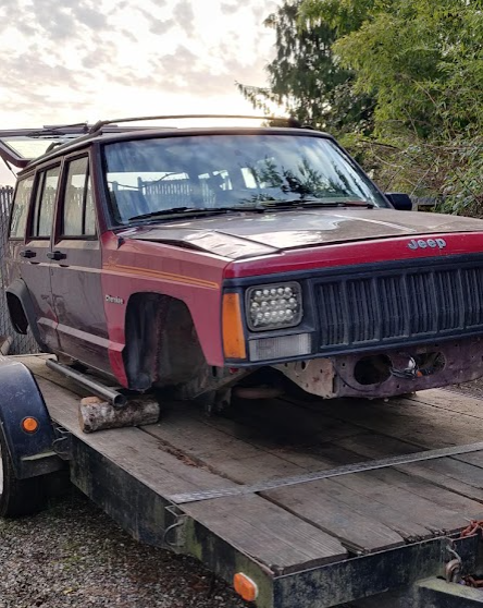

        Jeep got parted out awhile ago, wasn't sure what my living situation was going to be and the thing needed a trailer to get anywhere to play. Made money on the whole ordeal so it's cool.

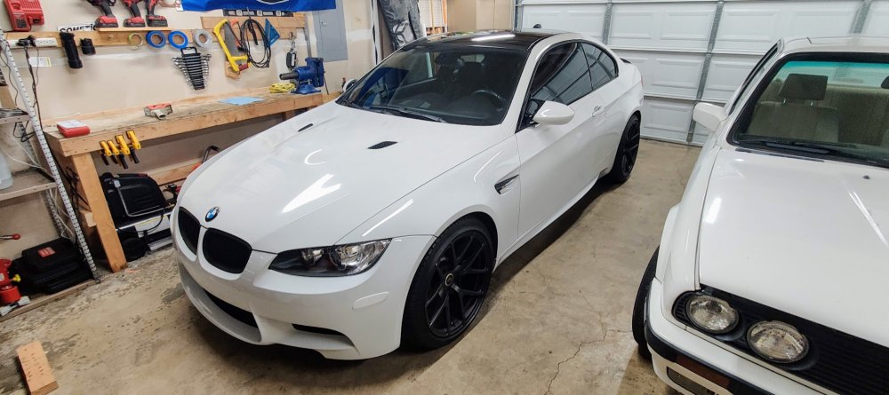

          I've been low key looking for an E92 M3 for a year or two now, and have had little success in finding what I was after. Recently a forum members old M3 went up for sale for a staggeringly good price, but there was error in communications and it went to a dealer who then wanted 5k more than they got it for and wouldn't budge on it. Since then I had been keeping a more serious eye out.
          This popped up the other day so I contemplated it for a day or two (that s52 head rebuild was not cheap) and decided to go look at it and deal with my decisions later. Needless to say it came home with me.
          Awesome dealer specializing in higher end cars, he appreciated how thorough I was being in my inspection and questions and he was very honest with me about the whole thing. We struck up a deal and away I went.
          Also got a ride in his FBO F90 M5 with meth that was ~800 AWHP and holy hell I have never felt something launch like that before.
          Anywho
          08 M3 6mt 105k, carbon roof, black interior, premium and comfort package, Vorsteiner wheels, KW coils, glorified straight pipes on it (zero rasp, sounds amazing, just a bit loud inside)
          It has been a riot thus far

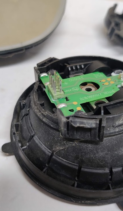

                    The drivers side headlight had its vertical adjustments backwards, Lee noted the SMC is the module responsible for these things, and that module helped me google my way through finding out the reset through ProTools (possible best $150 license I've ever bought). After a recode the headlight went right where it should and all motor directions are correct.
                    Drivers mirror was drifting around between drives which was annoying. Found a thread linking this issue to corroded pins in the mirror motor connector, so I pulled it all apart, cleaned up the contacts, and applied a smidge of dielectric grease before reinstalling. It seems 99% of people have had success with this, so I hope I keep the trend going!

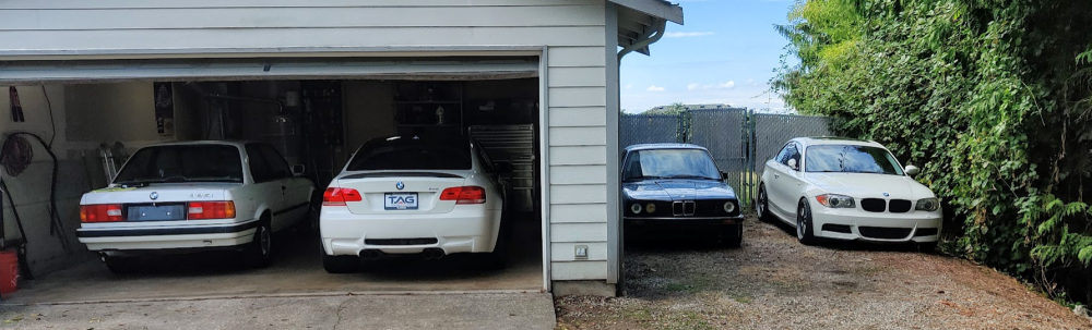

                    The driveway situation, before I put the truck in front of the 128 and E30
