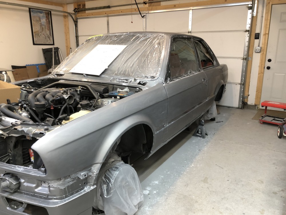

                  Alright. Moving right along. The whole car has 1500. The hood, trunk, and sunroof panel have 2000.
                  it’s pretty cool that even though these are super hazy straight on, at an angle you can start to see the gloss coming back and the reflection get cleaner.
                  Discovered that someone has messed with the sunroof panel in the past. The front most screw was missing on the driver side and the front most screw on the passenger side was nearly stripped. If you’re going to go in and start something - finish it.
