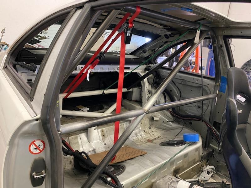

Before putting the main hoop back in we "clearanced" the rear seat area with the good ole attitude adjuster. Aka hammer. The idea was to make room for the chassis harness to slide back down next to the bottom of the main hoop. Really excited on how that little detail turned out.
Next we threw in the main hoop and tacked it in place again, then I got the rear down bars properly aligned and squared up and did a final weld on them to the main hoop.
