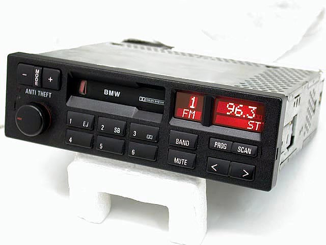

                                          In the pursuit of a solution to playing music from my phone in the e34 without replacing the head unit, I did a fair amount of web trowling last summer. I first identified that the head unit in my car is a Alpine CM5903L, and decided to do the common tape deck modification that directly solders connections from a 3.5mm audio cable to the pins on the tape board. This method requires the insertion of a "blank" tape into the radio to trigger it, and is well covered on other forums so I won't bore you with it more here. For reference, here's what a CM5903L looks like:

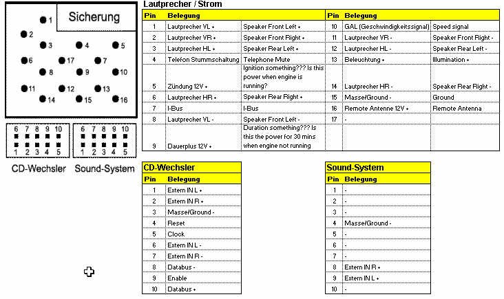

                                          He covered a lot of the basics such as the connector pinout and the general tech stuff in his thread, so I won't go as in depth here. The general idea is that by using a "jumper" wiring harness that goes between the CD changer plug on the back of the radio and the plug coming from the changer itself, it is possible to replace the audio inputs from the CD changer with inputs from a regular old 3.5mm jack. This tricks the radio into thinking the CD changer is playing (something that prevents you from simply wiring the three audio wires up alone with no connection to the changer whatsoever), while the audio signal is replaced with the music of your choice.
                                          Plug from CD changer that goes into back of radio:
                                          Corresponding receptacle in radio:
                                          CD changer pin diagram into back of radio: (the Sound-System receptacle was absent on this radio, not sure what it was for or which models got it, if any)
                                          Wiring colors used for each pin. Posted mostly for personal reference later.
                                          Note that you don't have to connect the audio L & R negative wires to the 3.5mm plug; you can just use the ground. I remember reading somewhere that those two wires and the ground are all common. I did not verify this, so I cannot confirm this. I used the ground pin in the radio for my audio ground with success.

                                          To install, the only other thing that needs to happen is the removal of the CD changer plug from the main connector that goes into the back of the radio for the speaker outputs and such. There's a small blue retainer that slides out like so when pulled on. Remove it, and the CD changer plug comes right out.
                                          Double check plug orientation and install the harness. Note that the little metal tab in the plug from the changer goes down and is a good reference for correct orientation.
                                          I then went out to the garage last night and installed it, and am pleased to report that it worked perfectly!
