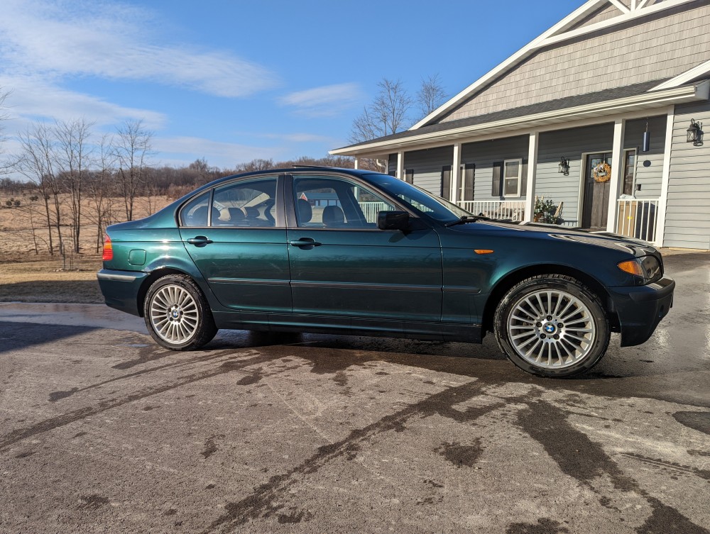

<?xml version="1.0" encoding="UTF-8"?><rss xmlns:dc="http://purl.org/dc/elements/1.1/" xmlns:content="http://purl.org/rss/1.0/modules/content/" xmlns:atom="http://www.w3.org/2005/Atom" version="2.0"><channel><title><![CDATA[The Green Hornet...]]></title><description><![CDATA[<p dir="auto">With the new job came a new reason to buy another car!</p>
<p dir="auto">Since I gave up the take home car with the old job, I needed a new (to me) daily for the upcoming commutes. </p>

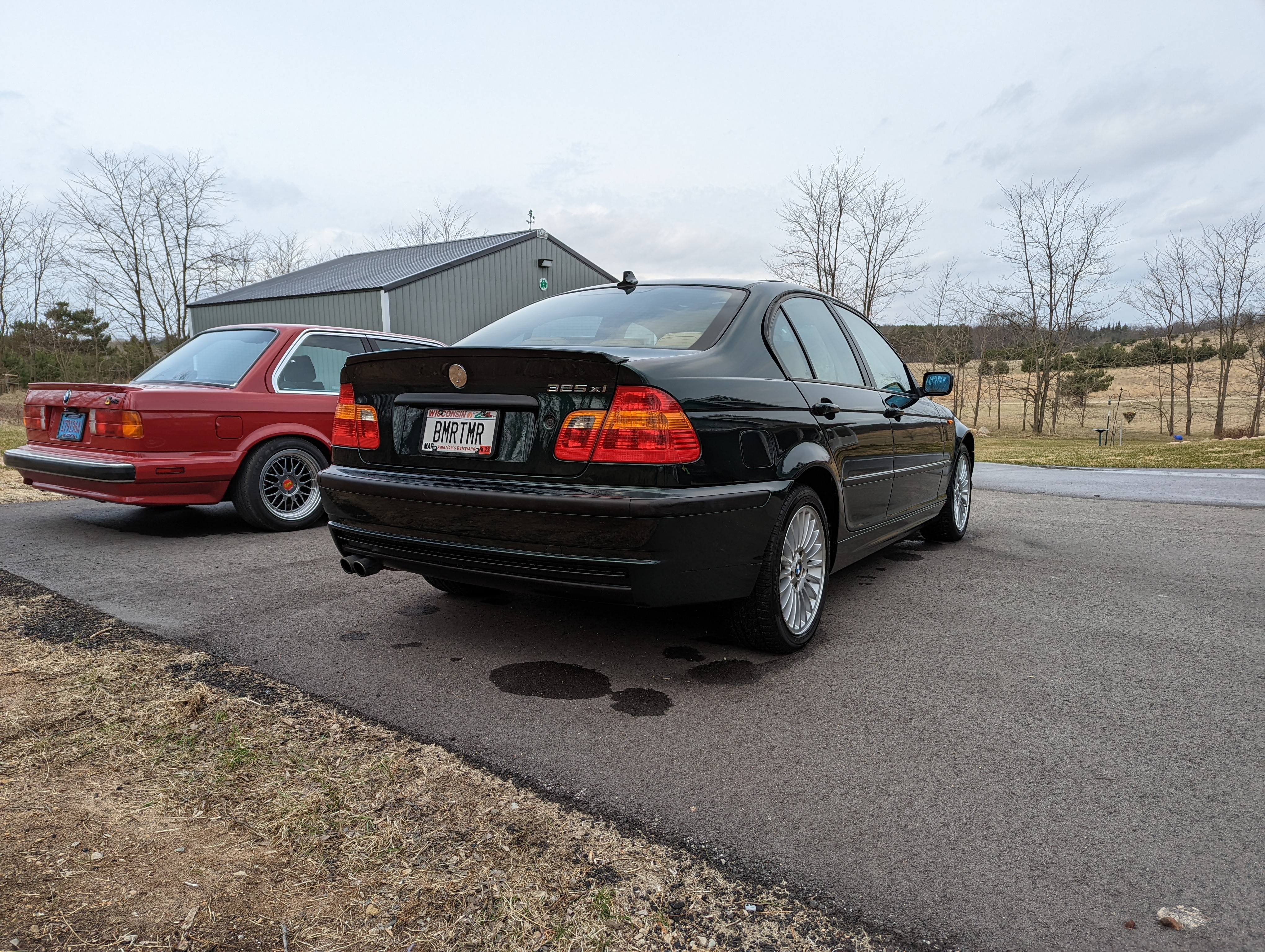

<p dir="auto">After thinking about what I wanted for a bit I settled on finding myself a nice E46, since a 2003 325i was the first new BMW I have ever owned, and haven't had one since 2006.</p>
<p dir="auto">After a few weeks of looking, and passing on a few cars, I came across this gem!</p>
<p dir="auto">2005 325ix, 106k, premium package, cold weather package, MK4 Navigation, Harmon Kardon, Xenon, and best of all.... Oxford Green with Carmel Leather!</p>
<p dir="auto">Overall a very solid car, and it drives wonderful. Gonna work on a cooling system overhaul and some minor maintenance this week.</p>

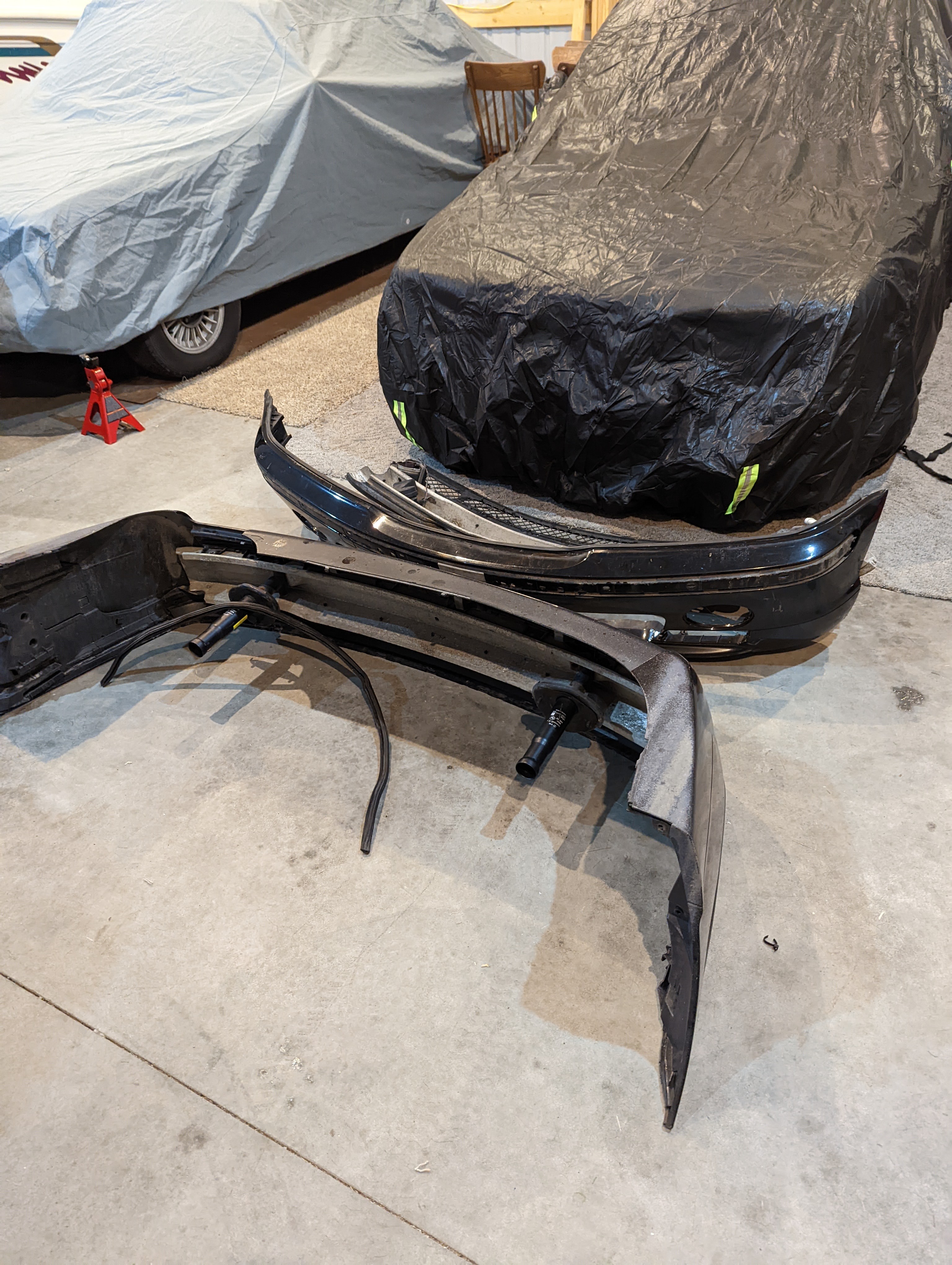

<p dir="auto">Next week it's off to the body shop to have MTech bumpers fitted, door dent removal, and rust mitigation.  </p>
<p dir="auto">I love it when a plan comes together...</p>
<p dir="auto">-Timmer</p>

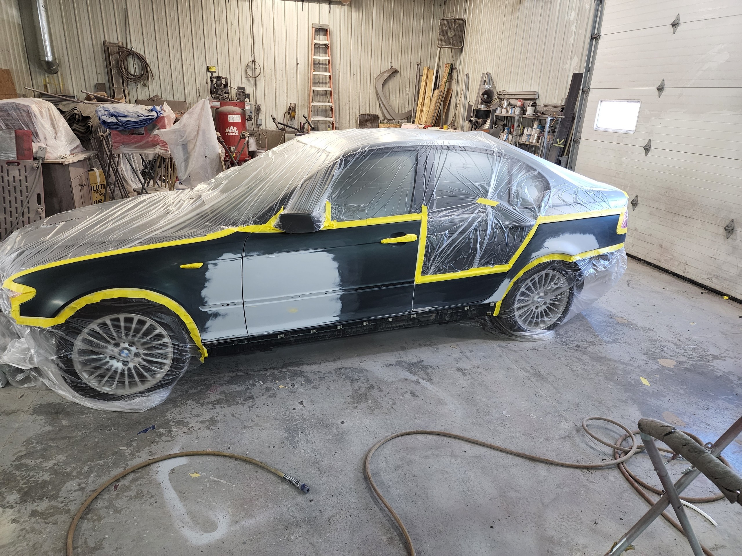

<p dir="auto">She still needs a good paint correction and wax, but I'll save that for another day.</p>
<p dir="auto">Feels good to save another E46...</p>

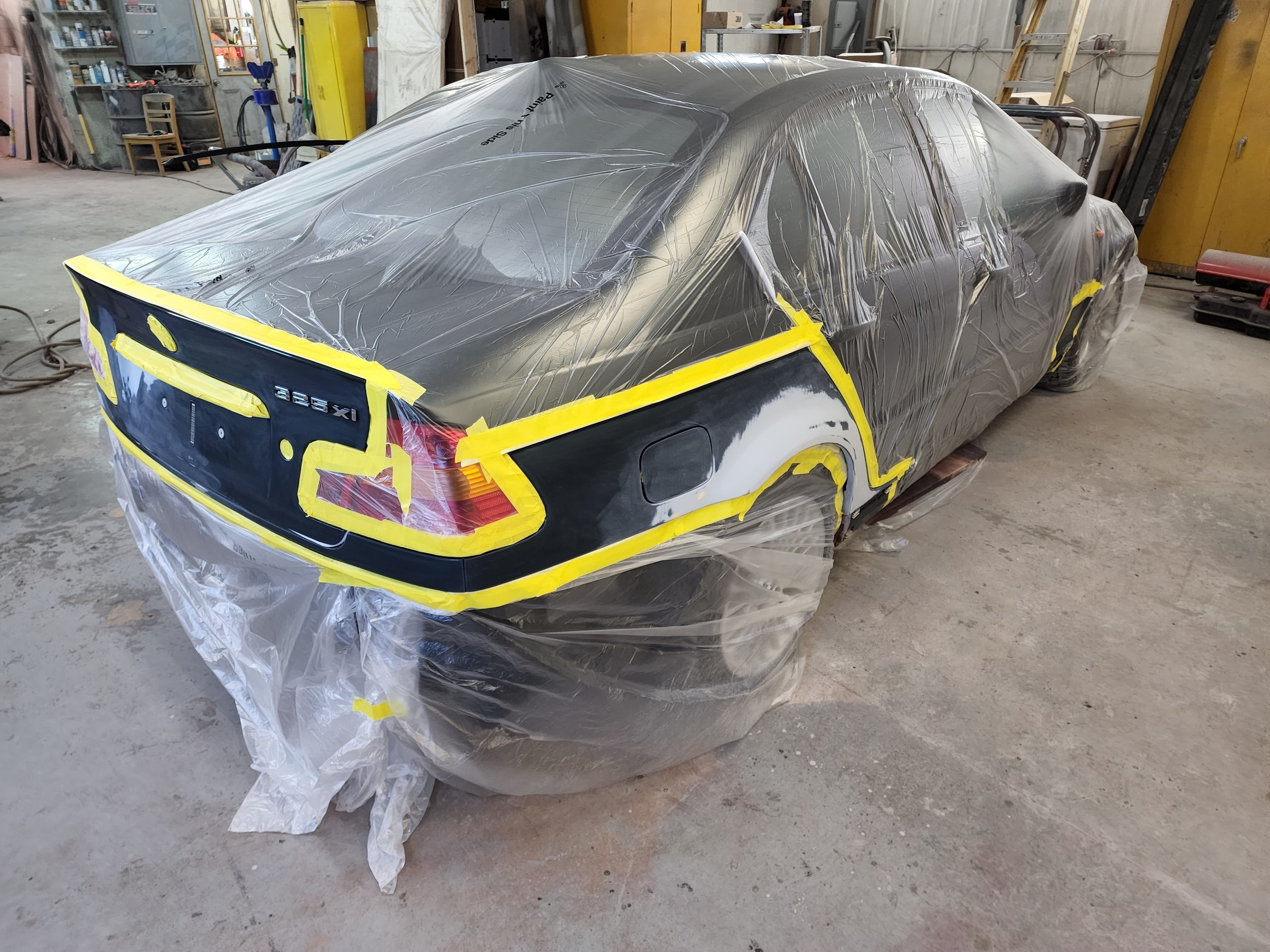

<p dir="auto">Just got word it's gonna be done tomorrow!  I plan on transmission, transfer case and diff fluid change this weekend.  </p>
<p dir="auto">Shes had some serious work done to her this week!</p>

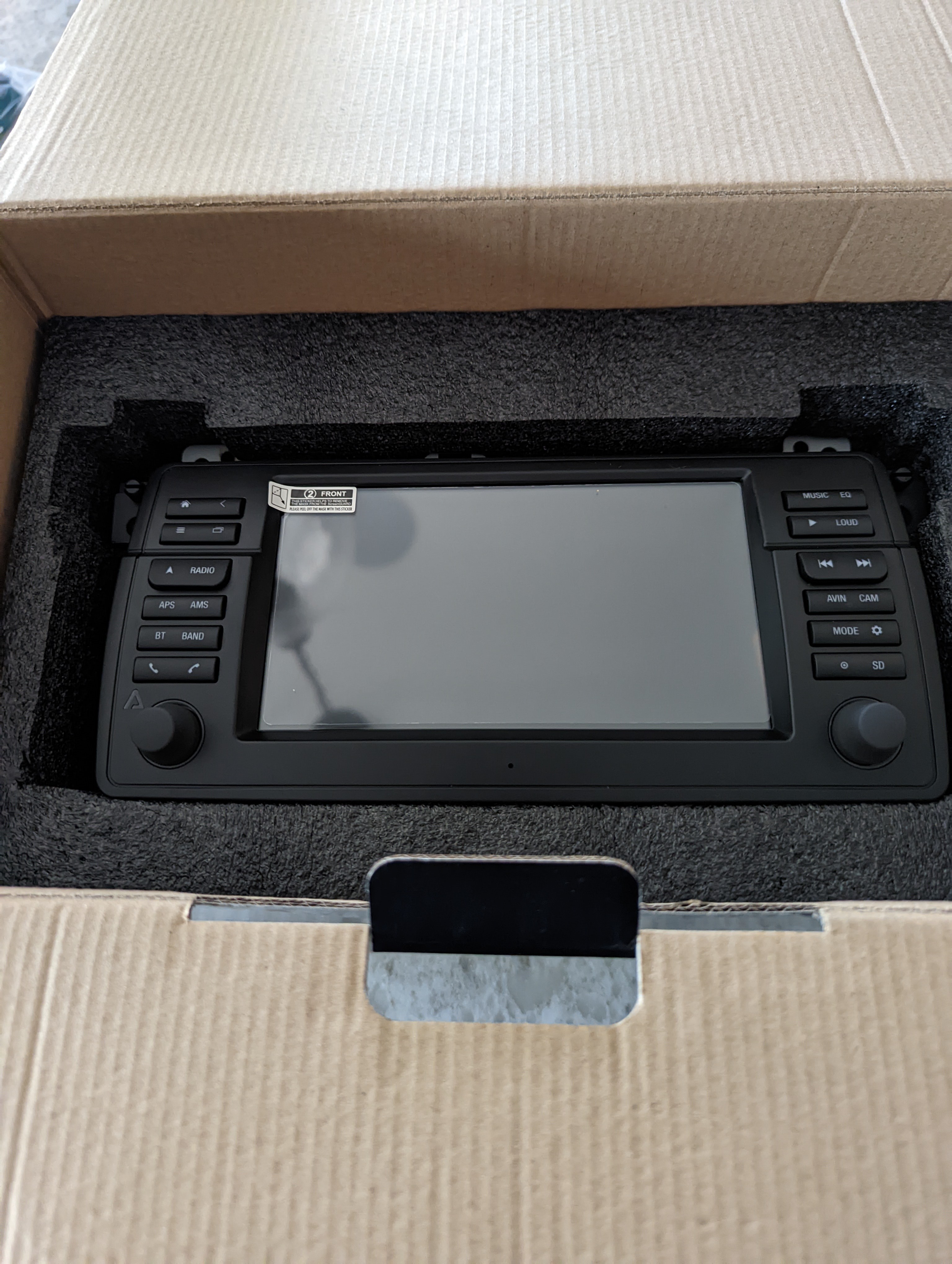

<p dir="auto">Since she's gonna be my daily, I treated myself to an Avin head unit as well <img src="https://wibimmers.com/assets/plugins/nodebb-plugin-emoji/emoji/android/1f60e.png?v=6c9209168ce" class="not-responsive emoji emoji-android emoji--sunglasses" style="height:23px;width:auto;vertical-align:middle" title="😎" alt="😎" /></p>
<p dir="auto">-Tim</p>

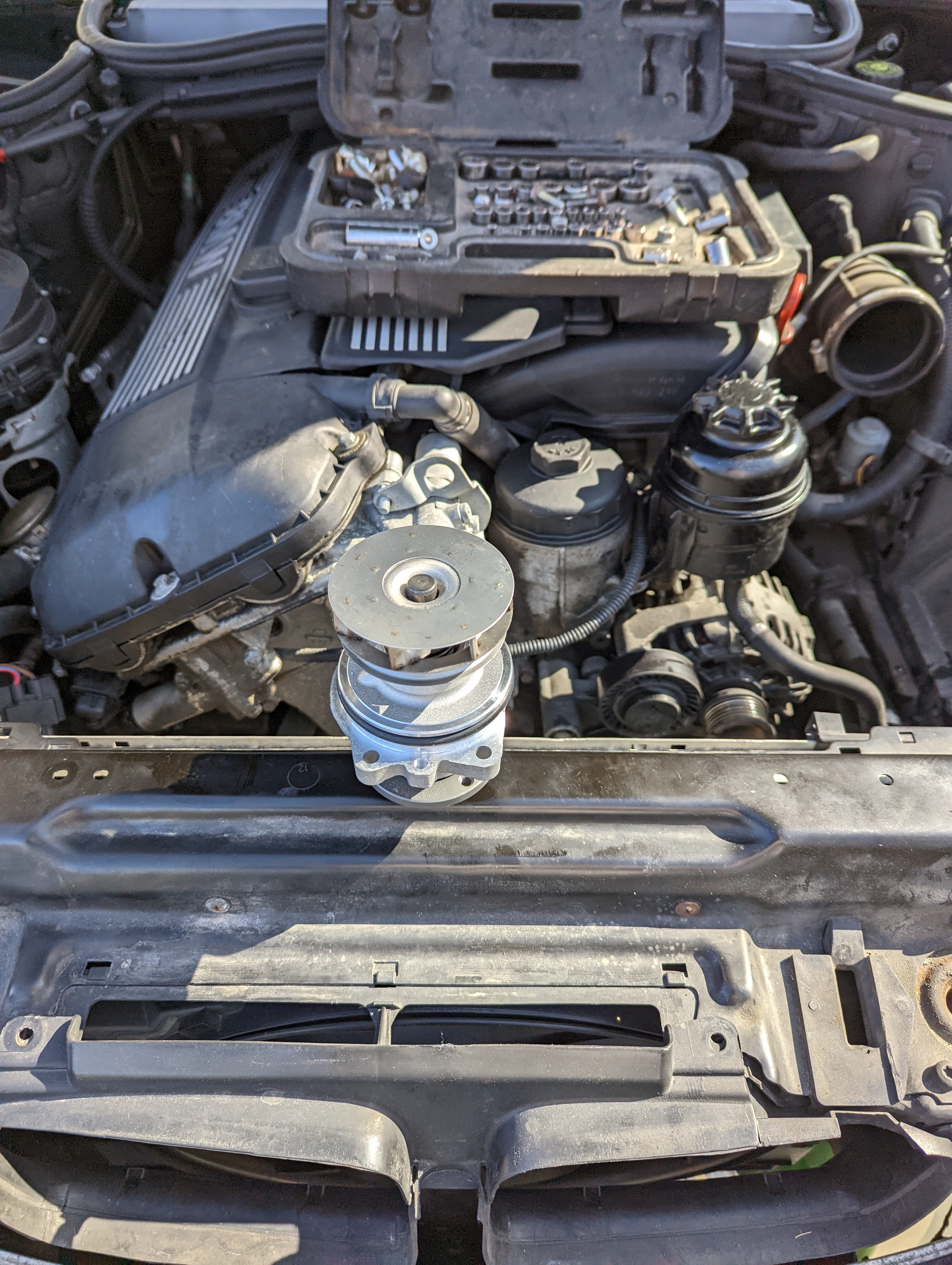

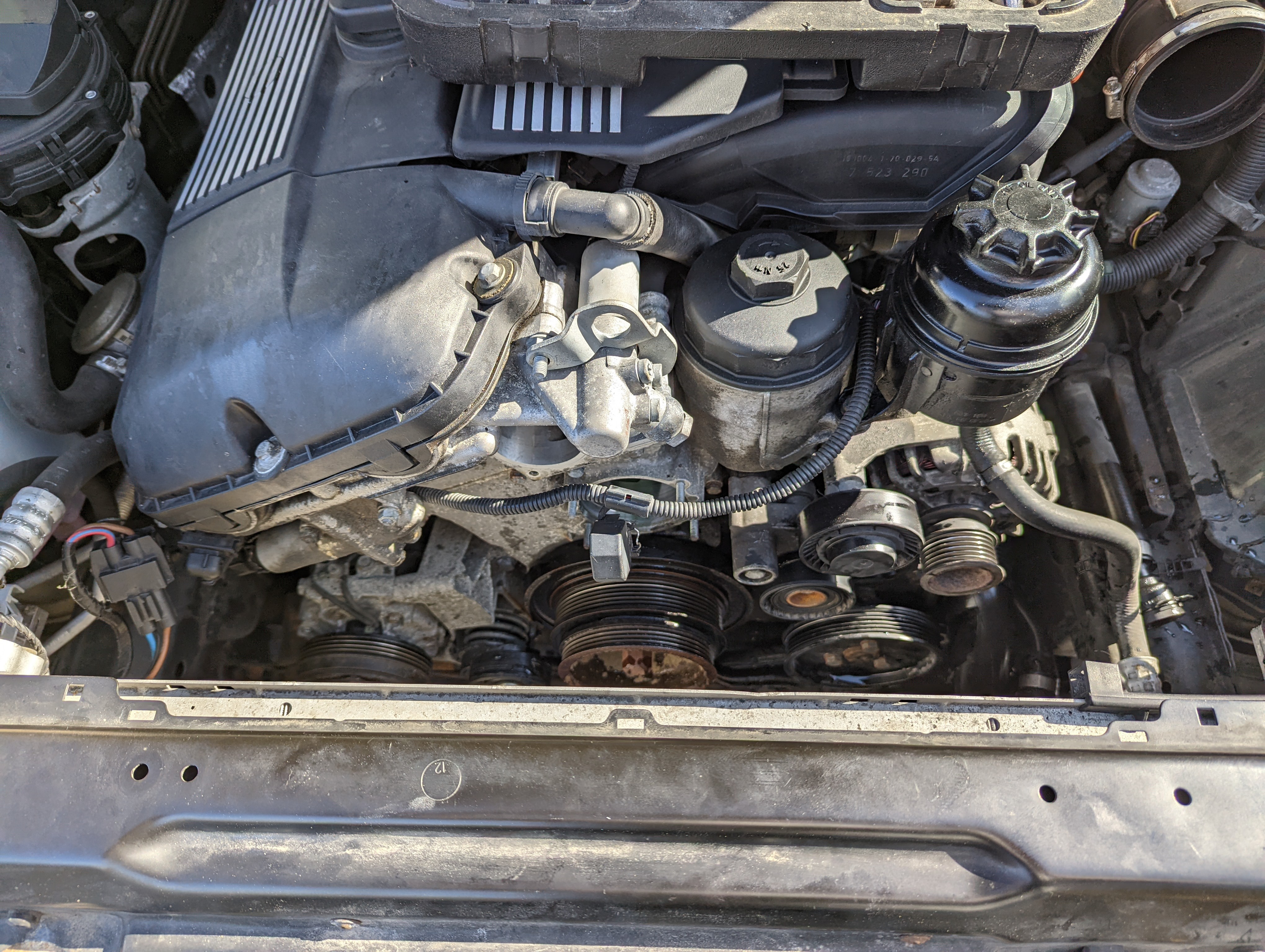

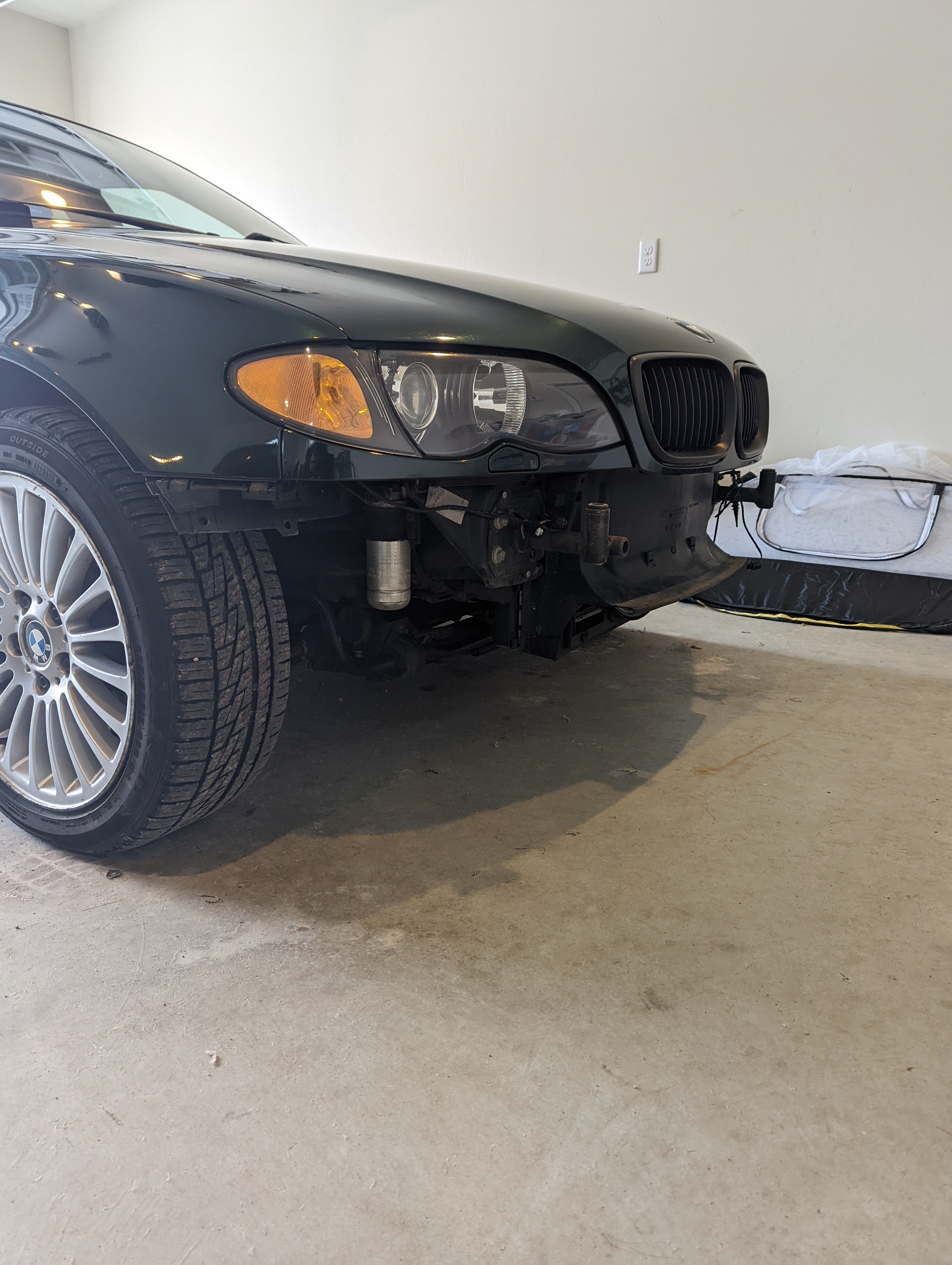

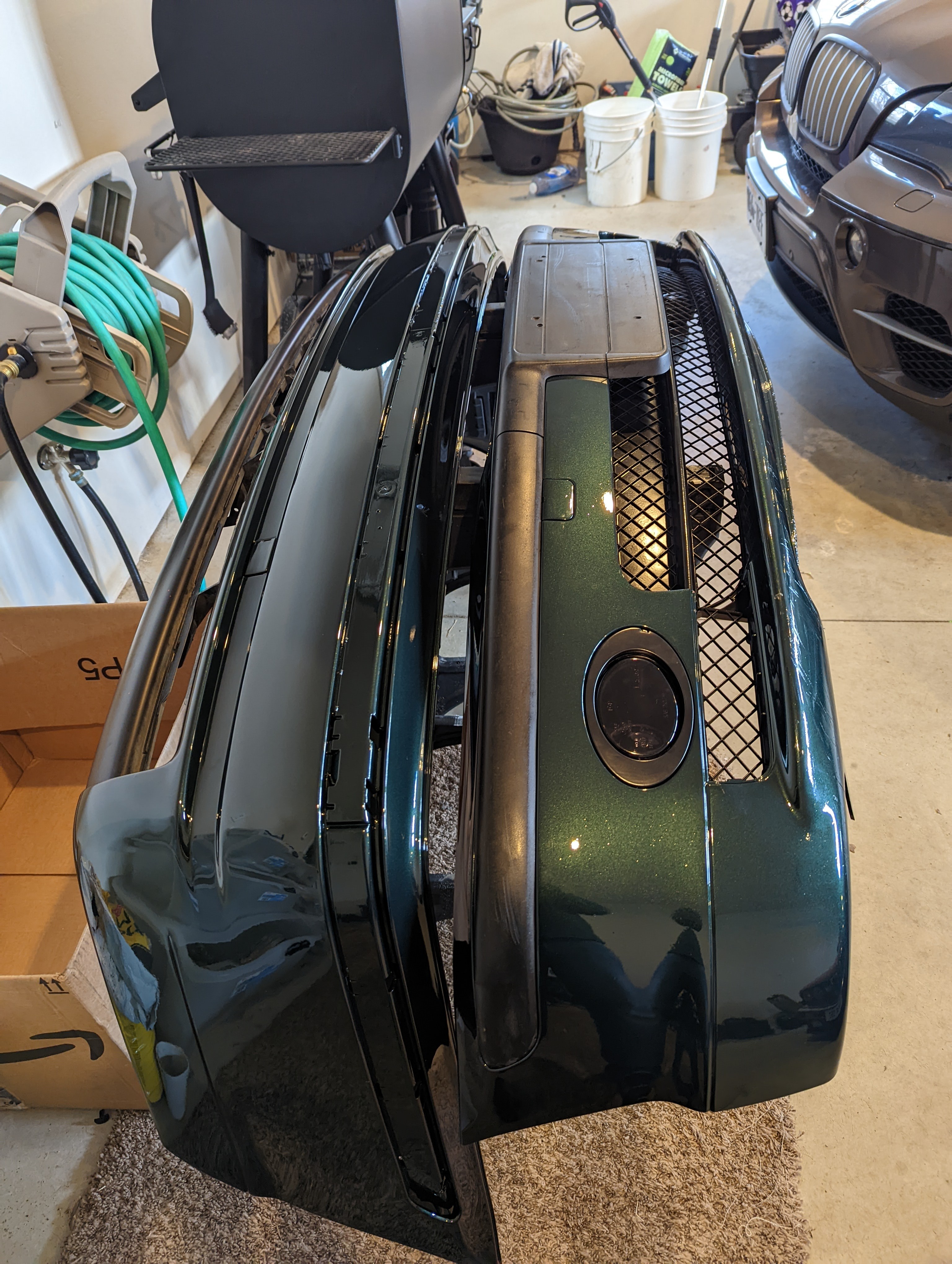

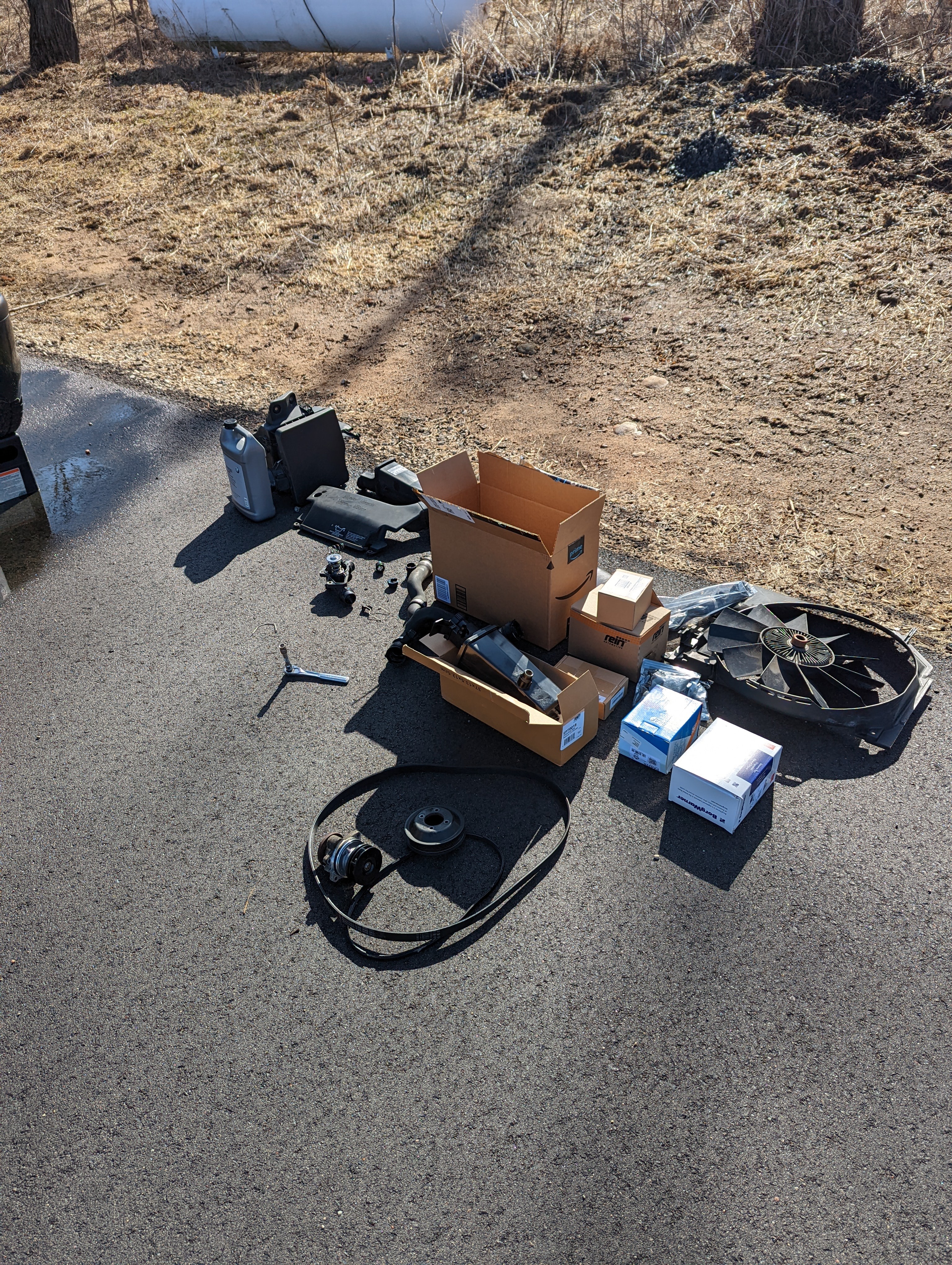

<p dir="auto">New hoses, expansion tank, thermostat, belts,  and upgraded water pump and pulley made of metal.   Should be good for a while now!</p>
<p dir="auto">Time to pull the bumpers and prep for the body shop!</p>
