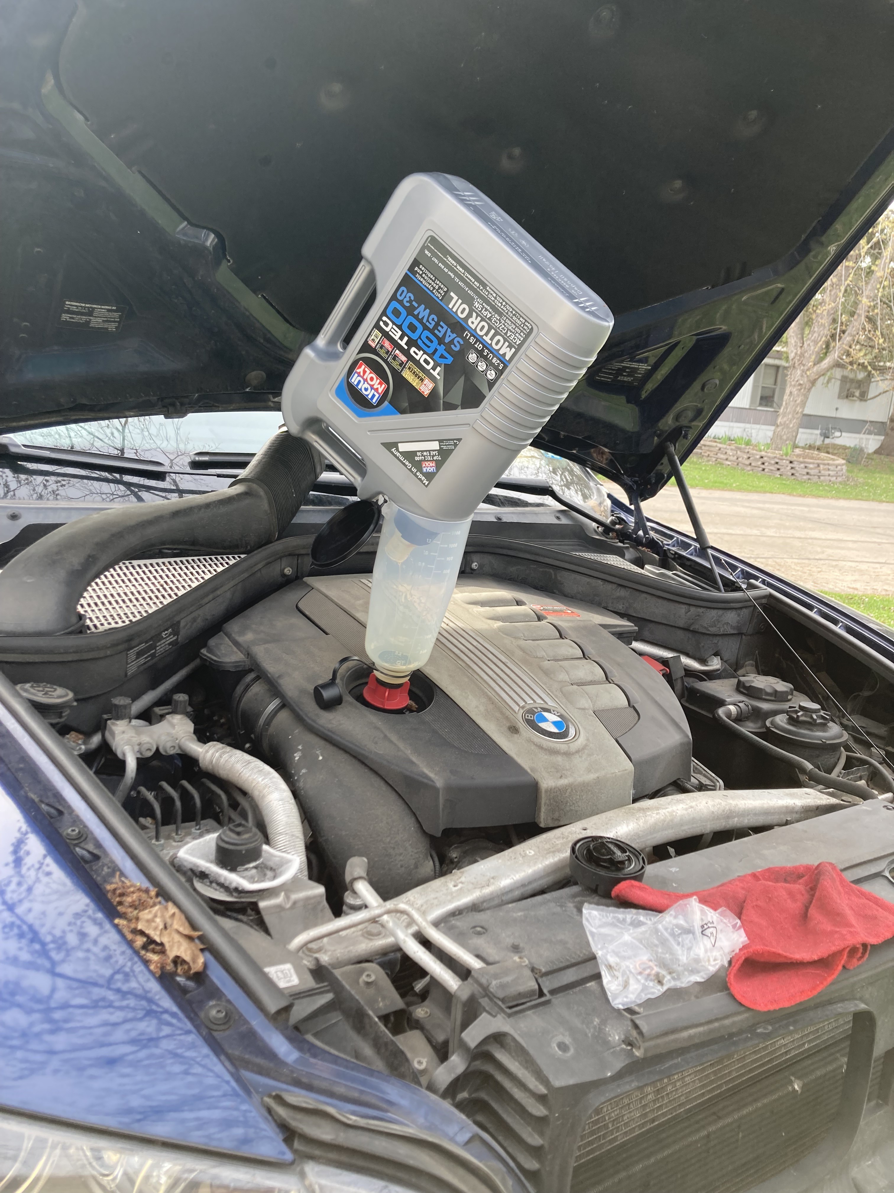

                          Used the pocket book wrench today to tick off those immediate concerns. Was happy with the service today from VL Performance here in Appleton.
                          12/30/2022 151,852mi
                          • VL Performance Performed:
                            • Liquid Moly Leichtlauf high tech 5w-40 x6l & STP Oil Filter P983
                            • Transfer Case flush with fluid and drain plugs provided from FCP kit
                            • Replaced fuel filter with provided Mahle filter

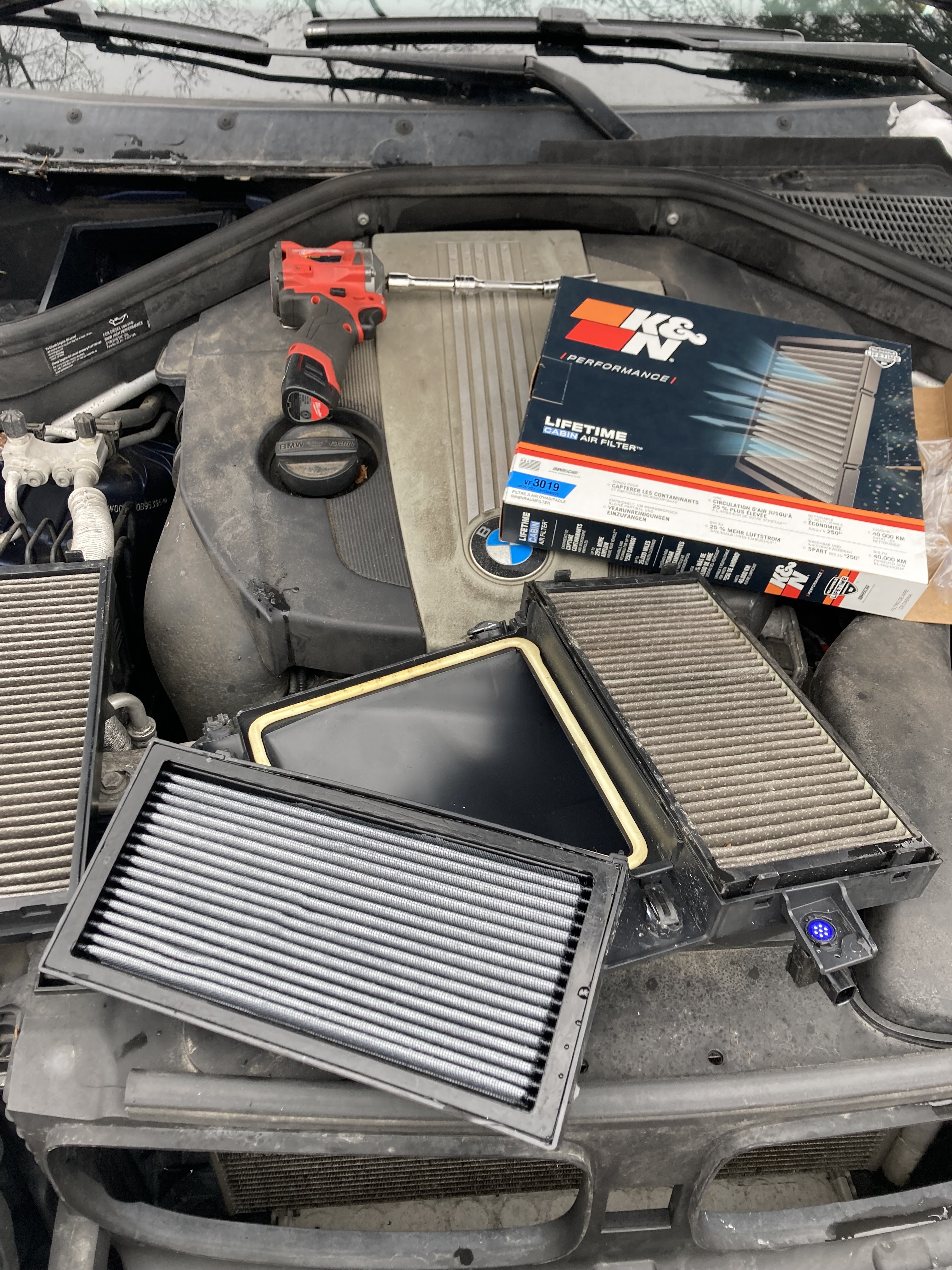

                          • VL Performance Recommends:
                            • Air Filter
                            • Brake Fluid Flush
                            • Transmission Pan Gasket

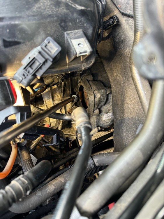

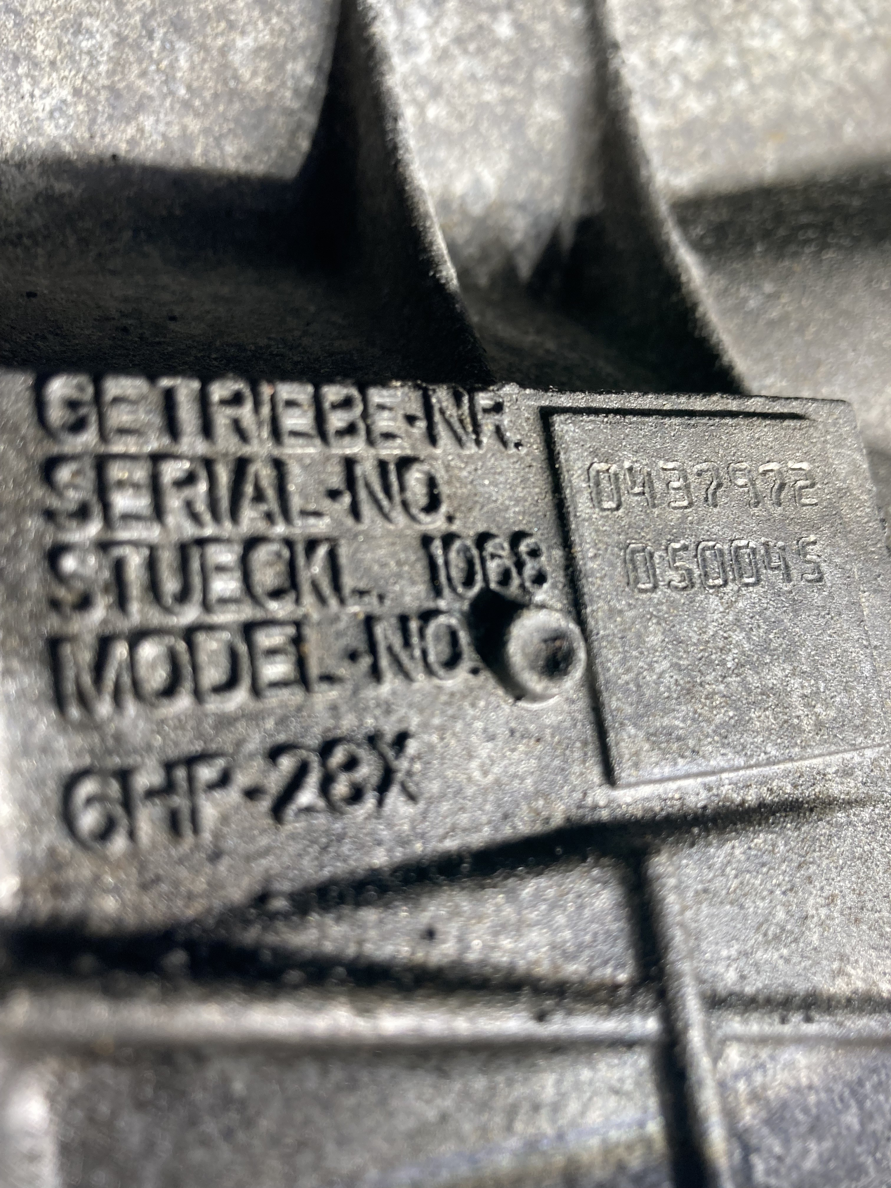

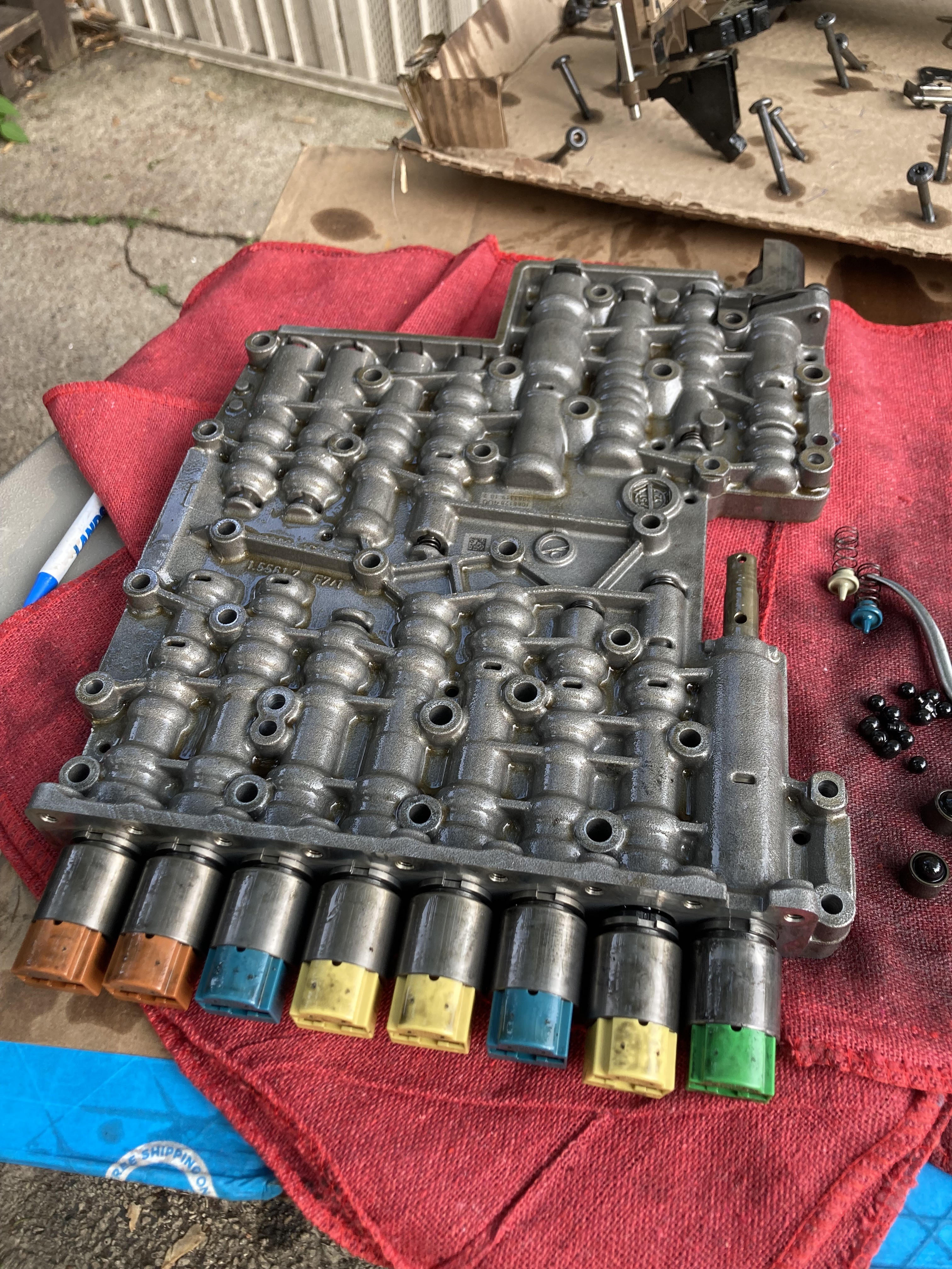

                              Crawled under the X5 for the first time to get the the main parts list off the transmission. Also installed the K&N VF3019 cabin air filters.
                              Below is a cross reference for the Tune My Euro E70 100k restoration/maintenance list to FCP OE or OEM parts for better prices/warranty. Certainly needed at 150k now and many are while you're in there with the intake manifold off and added power from the tune.
                              • FCP EURO
                                • M57 Sleeve kit for 6HP transmission
                                  • 31.4mm Automatic Transmission Valve Body Sealing Sleeve ZFS-0734317371
                                  • 40.7mm Automatic Transmission Valve Body Sealing Sleeve - ZF 24107520715
                                  • 25.9mm Mechatronic Sealing Sleeve ZFS-0734317370 x2
                                  • Mechatronics Sealing Sleeve ZFS-0501216272
                                  • Automatic Transmission Adapter Plug ZFS-0501215718
                                • GA6HP26Z Automatic Transmission Service Kit - 24117571227KT3
                                • Mechatronic Solenoid Kit (6HP21 6HP28) - ZF 1068298047
                                  • My parts list 1068-050-045 is not listed on FCP's product page but these pages have more complete references.

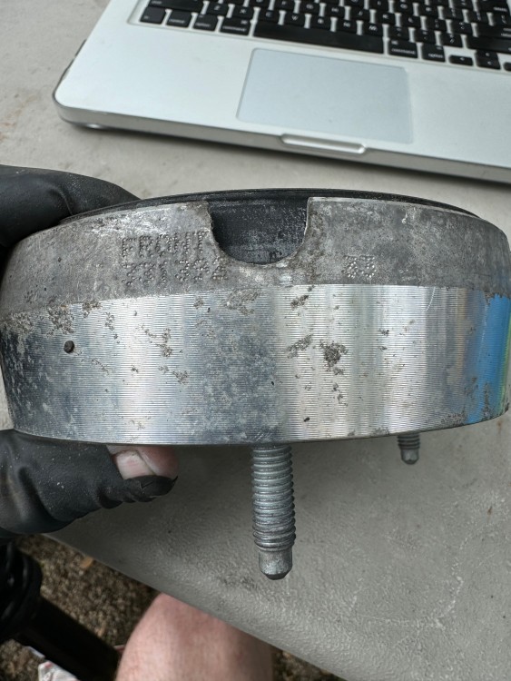

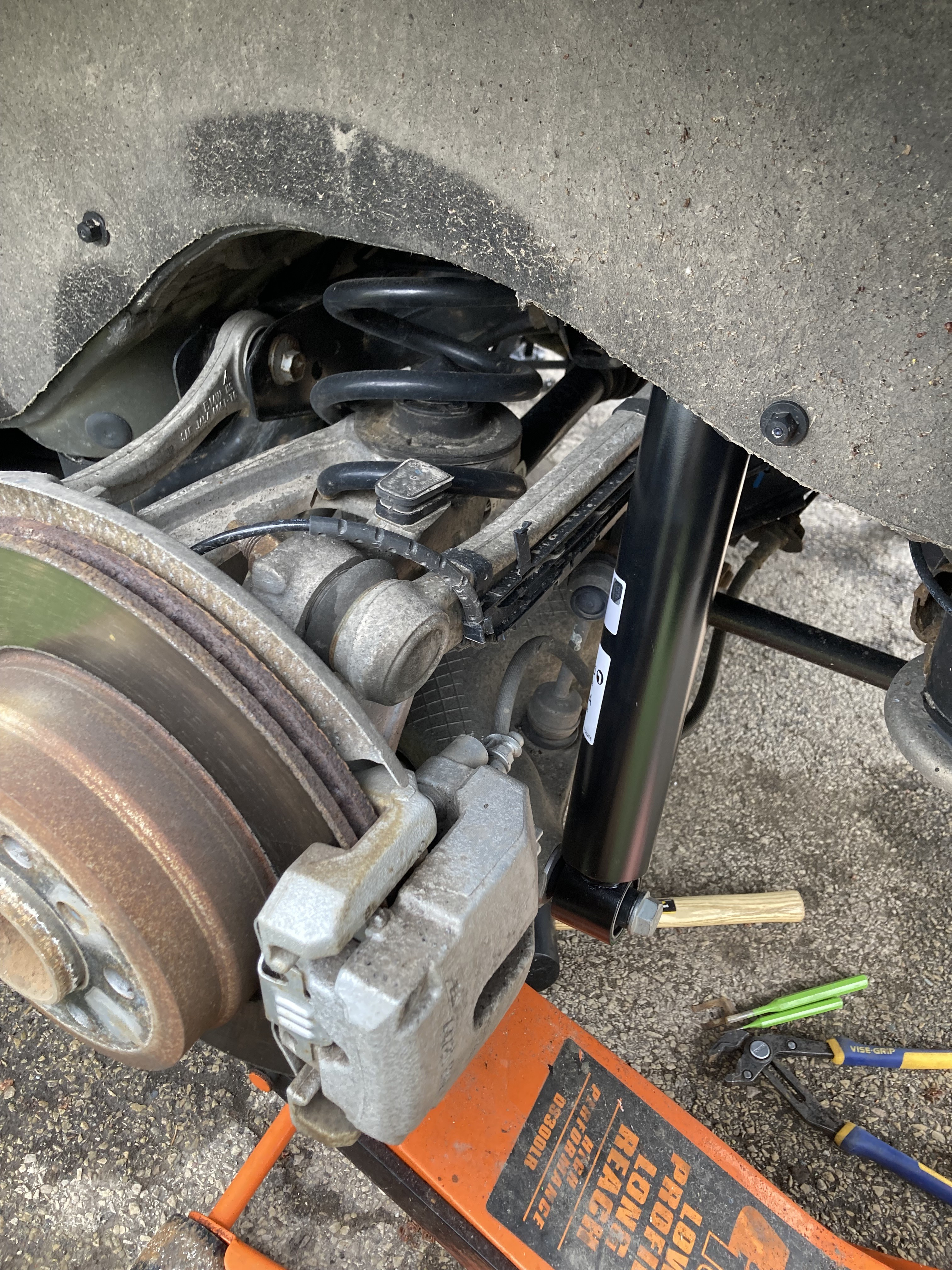

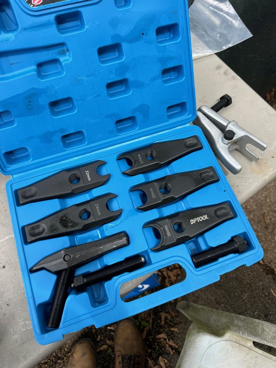

                                    I just did lower front control arms and thrust arms and it made a huge difference. I didn't realize how bad they were, they still felt tight.
                                    I also changed out the upper/lower strut bushings as they were gone.  No more clunks!
                                    Just a heads up, I went with Lemforder control arms and I got a bad one that had a leaky bushing... Apparently there was a bad batch made last year.  FCP Euro was awesome and made it right, and shipped a new one next day air.

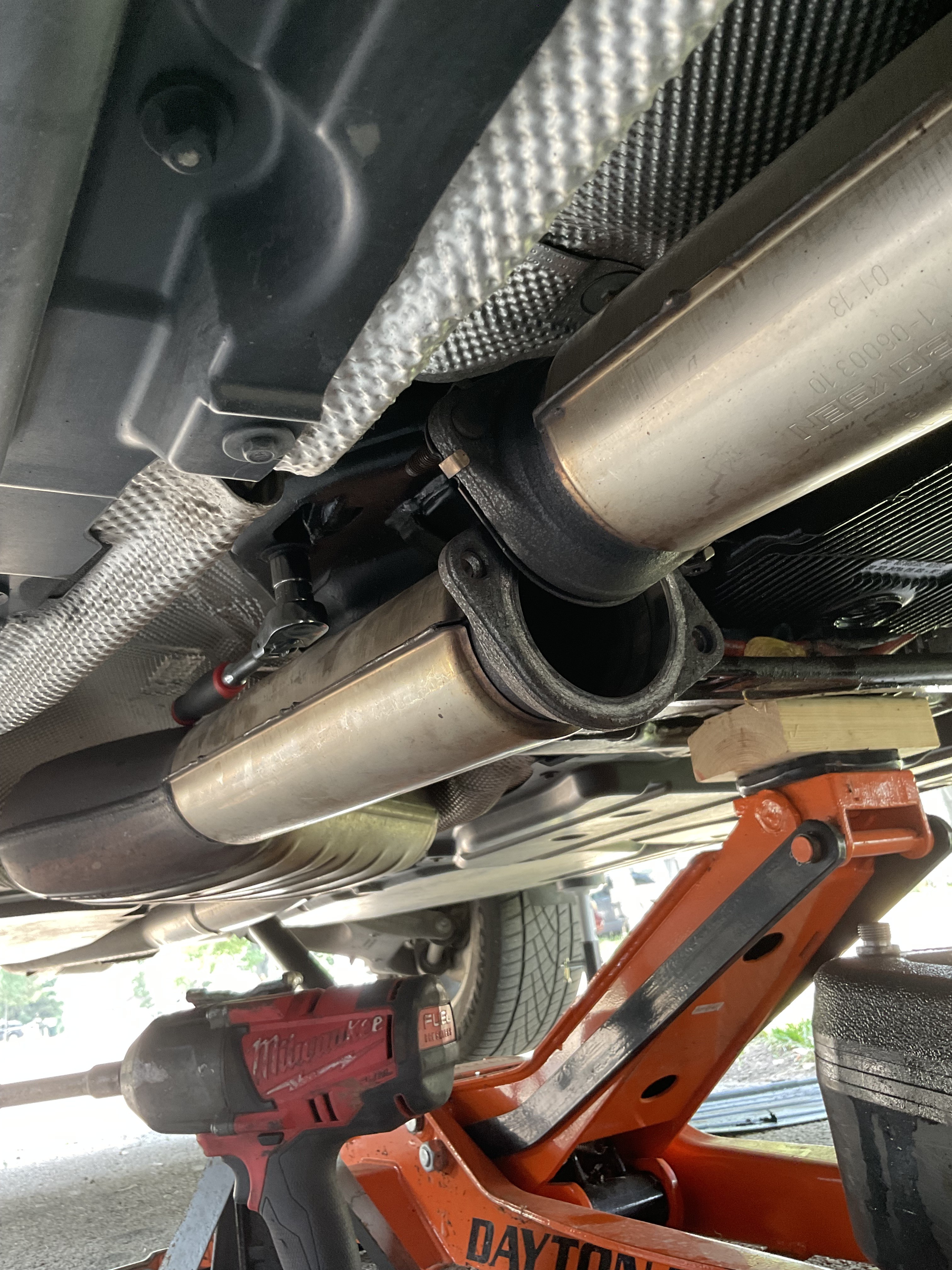

                                      I did the delete on mine recently and am very pleased with how it turned out.
                                      I would like to note that I would rather do rod bearings on the M3 again before doing another X5d delete... It was a lot of patience and odd body positioning.
                                      I went with the VSRF down / midpipe and the fit-up was pretty decent. I saw you had the buzzken one in there which is over twice the cost.

                                        Did you get the cat? What else did you need for install? I'd assume I'd just need these EGR block off's additionally. Forgot the VRSF has a resonator as well which I'd like, are you happy with the sound?
                                        https://www.tunemyeuro.com/bmw-x5-e70-low-pressure-egr-block-off-plate/
                                        https://www.tunemyeuro.com/bmw-e70-x5-lp-egr-coolant-block-off-kit/
                                          #40
                                          I did not get the cat, but doing it again I may. It's not bad but I like cruising with the windows open and spend time crawling around so I feel the smell may become a tad much. I may end up trying to get a catted one.
                                          Sound is pleasant, lots of turbo noise and a tiny bit of engine with the windows open. With windows closed I can't tell a difference from stock which is nice.
                                          I did the EGR racepipe at the same time (Bimmertune) and that came with the coolant blockoffs for that, and picked up the plate you linked above from a different source.
                                          The turbo noises and power gains are very fun.
