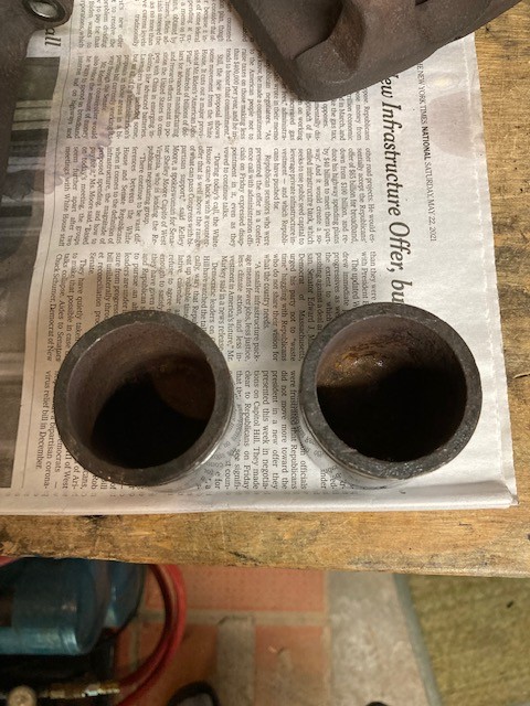

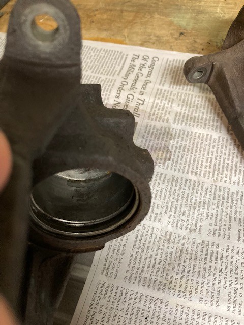

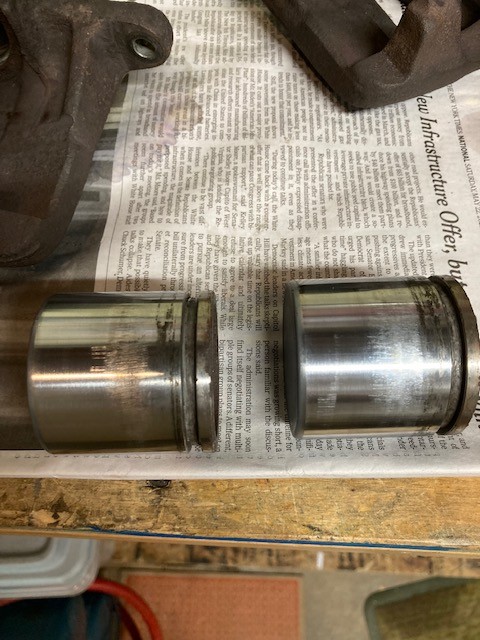

<p dir="auto">I replaced my e30 Girling front calipers on the race car with some Centric remanufactured ones last week due to a slightly sticking passenger caliper that was not retracting and dragging the pads, likely due to a disintegrated boot. Before I return the old ones for the core refund I thought I'd take a look to see if I could/might rebuild them just to have on hand as spares. </p>
<p dir="auto">These were what came on the car in 2007 and have never been rebuilt, yeah my bad. The insides look better than I thought they would. Inner seals were fine. I was wondering about the pitting in the cylinders which I can see and feel, and the scratches on the pistons (see pictures). I already have the rebuild seal kits in my parts box so wondering if these are "worth" rebuilding?  $$ wise the answer is no due to what I'd get back in the core charge refund minus shipping costs. I guess I'm wondering more about if these are rebuild candidates?</p>

]]></description><link>https://wibimmers.com/topic/6538/e30-girling-front-brake-caliper-rebuild-question</link><generator>RSS for Node</generator><lastBuildDate>Wed, 16 Sep 2026 07:34:41 GMT</lastBuildDate><atom:link href="https://wibimmers.com/topic/6538.rss" rel="self" type="application/rss+xml"/><pubDate>Mon, 19 Jul 2021 23:46:14 GMT</pubDate><ttl>60</ttl><item><title><![CDATA[Reply to E30 Girling front brake caliper rebuild question on Mon, 09 Aug 2021 04:03:28 GMT]]></title><description><![CDATA[<p dir="auto">i think it was a good choice to return, considering the pitting is not repairable. had similar pitting on one my e34 calipers that ended up nearly locked up. now, the guide pins were pretty bad too, so its hard to say which was the #1 culprit, but they would have bad hard to trust as a rebuild.</p>
]]></description><link>https://wibimmers.com/post/110498</link><guid isPermaLink="true">https://wibimmers.com/post/110498</guid><dc:creator><![CDATA[straight6pwr]]></dc:creator><pubDate>Mon, 09 Aug 2021 04:03:28 GMT</pubDate></item><item><title><![CDATA[Reply to E30 Girling front brake caliper rebuild question on Fri, 06 Aug 2021 23:53:53 GMT]]></title><description><![CDATA[<p dir="auto">Found more pitting on a closer look and decided to send back to get the core refund. RockAuto has a discount FEDEX shipping label for the core return which is a plus!</p>
