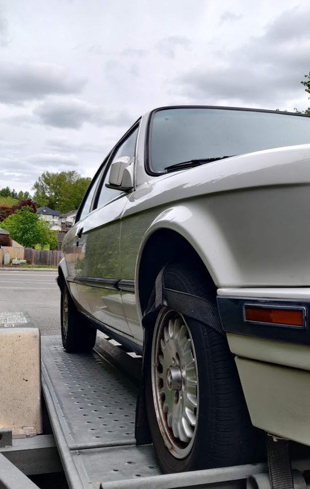

<p dir="auto">I was sitting in Oregon on a job site and came across a posting for an E30 from Cali, claimed one owner vehicle, with some mediocre pictures. <br />
Chatted with the seller, got more pics, a video or two, and I sent him some money to hold the car for me to arrive. Two days later I show up to his place in California with a trailer, worked out a deal, and left with the least rusty E30 I've ever seen. <br />

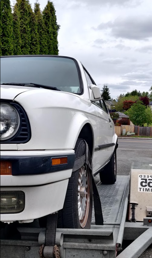

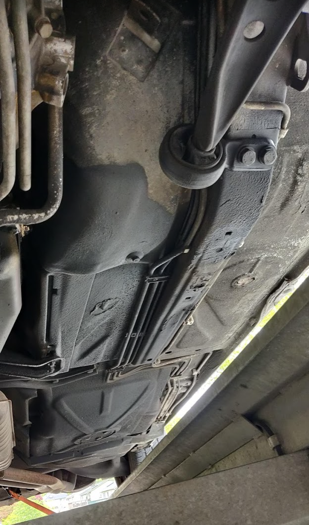

I was surprised on arrival to find two spots on the exterior with clear coat gone, but only on the hood and trunk which is easy enough to work with. </p>
<p dir="auto">Service record of one shop its whole life, original owner on the title, and I've now become the second registered owner of it. <br />
Every vin tag matches, one or two door dings on the whole car, it is astounding. </p>
<p dir="auto">So what's the plan?<br />
This is my long haul project car, the culmination of everything I've learned from working with E30's over the years. I am in no rush to get this completed as I want every facet of it to be exactly what I've desired. The intent is to completely remove the interior and replace it (interior is mediocre and tan) with black/grey things and custom seats that I've been working on. Driveline will be the S52 from my other E30, in a shaved and repainted engine bay. Suspension will be a hybrid of what I've got in my blue e30 and a mix of new parts. </p>
<p dir="auto">I promise this is (one) of the last E30's I will own...</p>

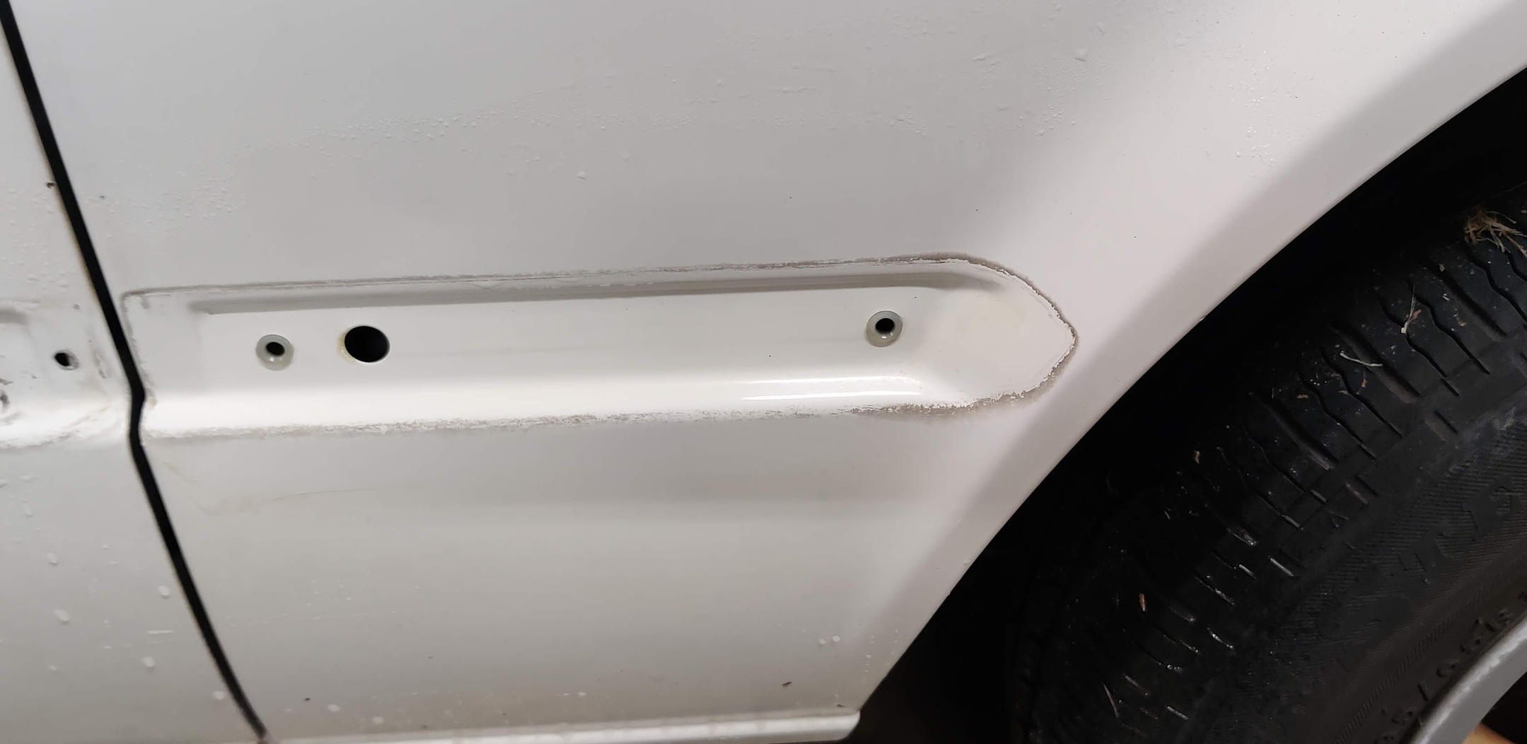

<p dir="auto">Considering the limited quantity of prep that was done on this I'm pleased with the way it turned out.</p>

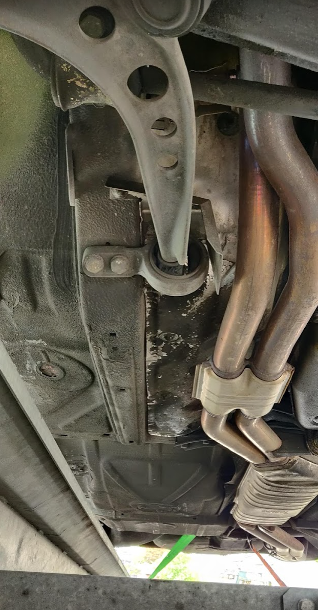

<p dir="auto">It's uncomfortable how easily everything comes apart on this thing... Parking brake lines running into the chassis came out without even pulling </p>
<p dir="auto">Tossing in riser bushings and new trailing arm bushings, rebuilding and painting the brake calipers, repainting everything, installing new brake lines, and putting it back in without a diff or axles (current ones lack grease, and diff is wrong for my application)</p>
<p dir="auto">Progress, not engine bay though, which I'm waiting for some warmth from the elements before painting. </p>
<p dir="auto">Refinishing the rear subframe is something I would like to do in the future. RTAB's, subframe bushings, powder coat the frame and the arms, and change the seals on the diff. I just need a place that the car can be up on stands for awhile.</p>

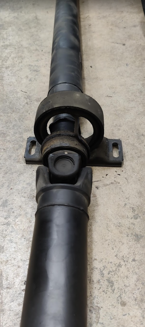

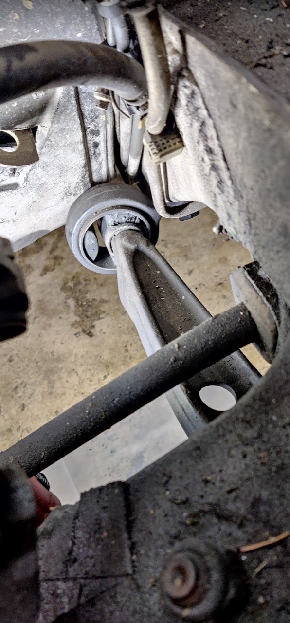

<p dir="auto">Finished pulling the driveshaft. The CSB seemed to be new which is neat! <br />
<a href="/assets/uploads/files/monthly_2022_01_image.png.95a3f33c57df5a179197ac22f8764d21.png"><img src="/assets/uploads/files/monthly_2022_01_image.thumb.png.21dd81acc437155f8ec218796014ace9.png" alt="image.png" class=" img-fluid img-markdown" width="335" height="750" /></a><br />
Wait...</p>
<p dir="auto">Found some performance parts hiding in it! Offset CAB's! <br />
<a href="/assets/uploads/files/monthly_2022_01_image.png.6559425fee7b850838818008bce22eea.png"><img src="/assets/uploads/files/monthly_2022_01_image.thumb.png.ef0045e59684ce8587f72cc0262c84cf.png" alt="image.png" class=" img-fluid img-markdown" width="350" height="750" /></a></p>

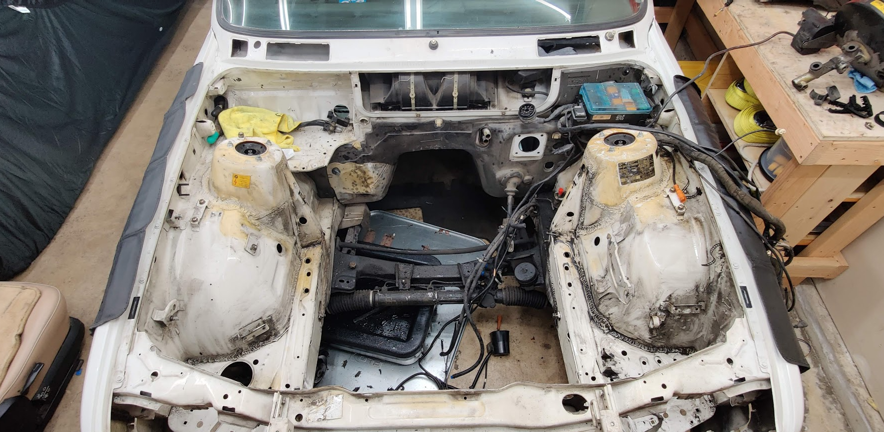

<p dir="auto">Haven't spent a ton of time on this, plenty of other things going on. Spent some time with it the past couple of days (after driving the other E30, my god that thing is frightening amounts of fun). </p>
<p dir="auto">I got most of the engine bay stuff out and did a light cleaning in there as it was quite gross. I'm thinking it'll still need a pressure wash to get all the small corners and such.<br />
I'm half tempted to not spray the bay, but I don't know why. It's not all that much work after having done it once. This one will be harder as I plan to leave all the brackets and such due to retaining cruise control and all of those fun things. </p>

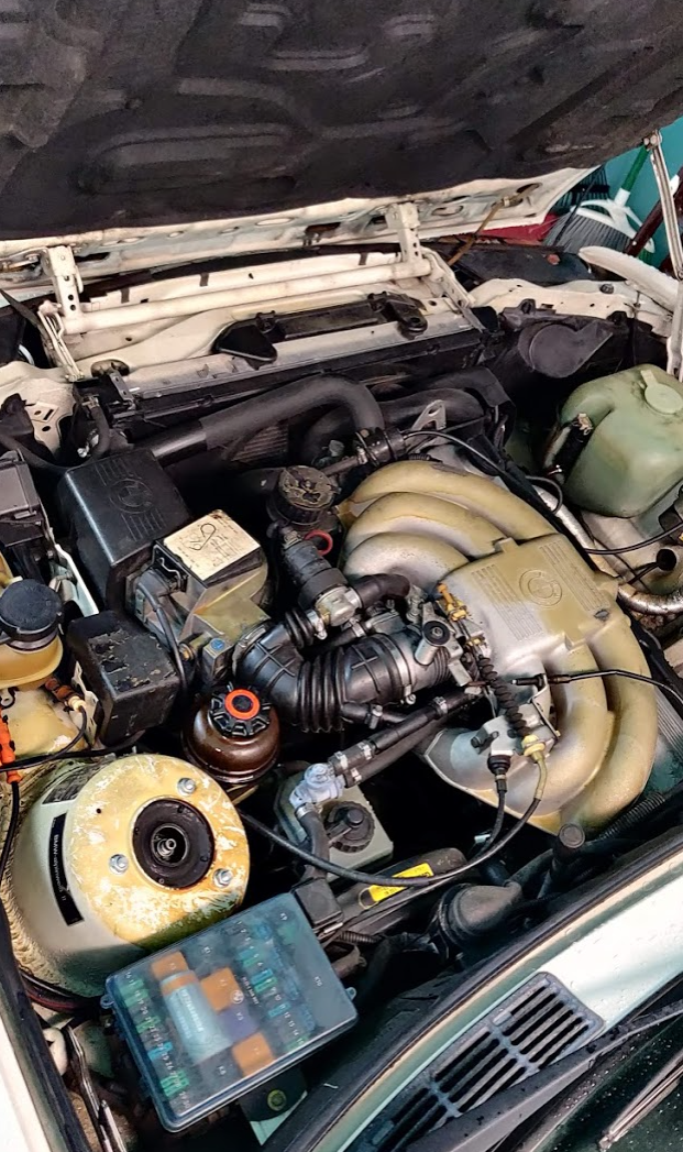

<p dir="auto">I'm debating on taking ABS out, but I don't see much reason to do as such. Anyone have thoughts on this? I've driven E30's without ABS and it was never much of an issue, just the occasional tire smoke from auto-x as one corner would go light. <br />

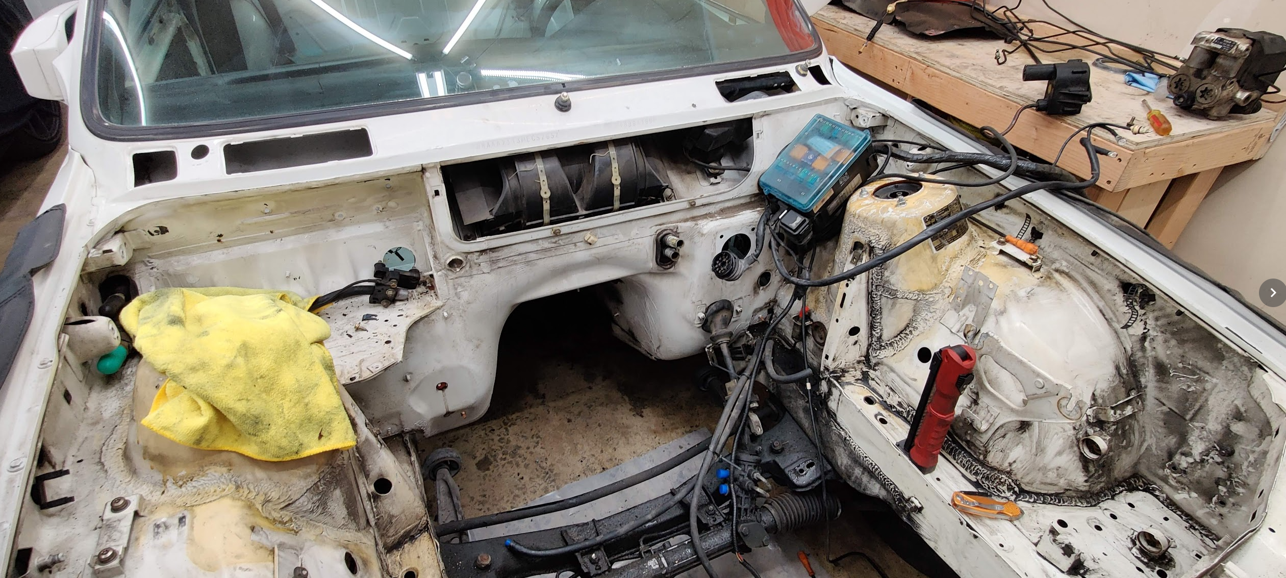

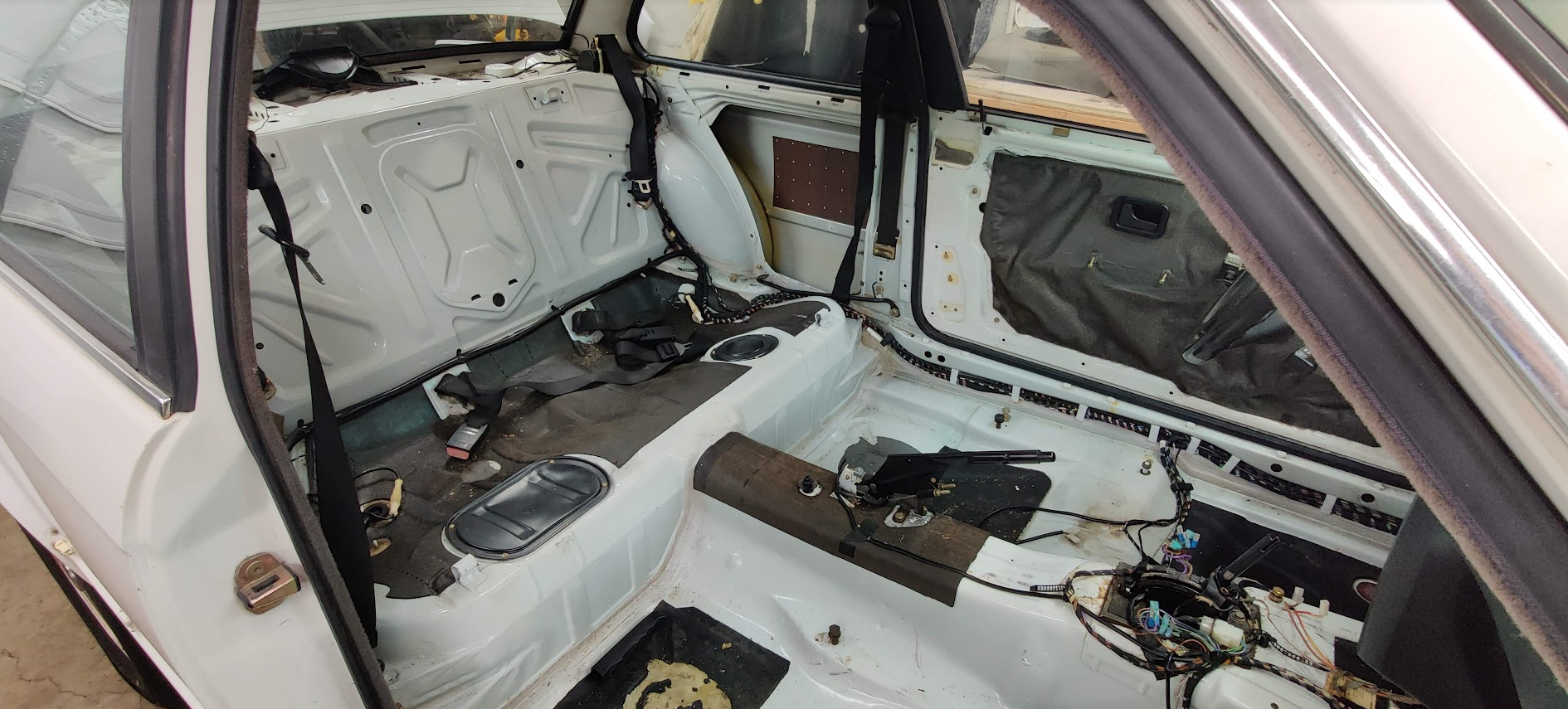

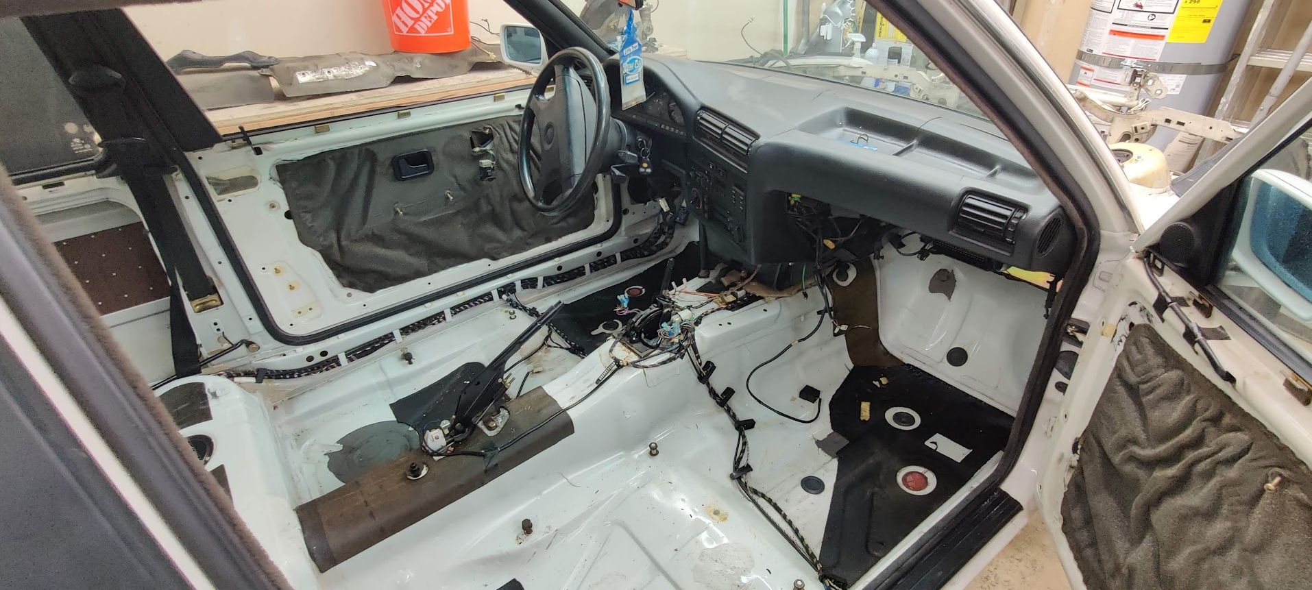

<p dir="auto">Interior is all out, engine is out. </p>
<p dir="auto">Getting started on engine bay cleanup and strip for paint.</p>
<p dir="auto">Intended things to keep with this chassis and with S52<br />
- AC (was working when engine was pulled, dryer looks replaced. R12 converted already?)<br />
- Cruise Control<br />
- ABS maybe? Unsure on that one so far</p>

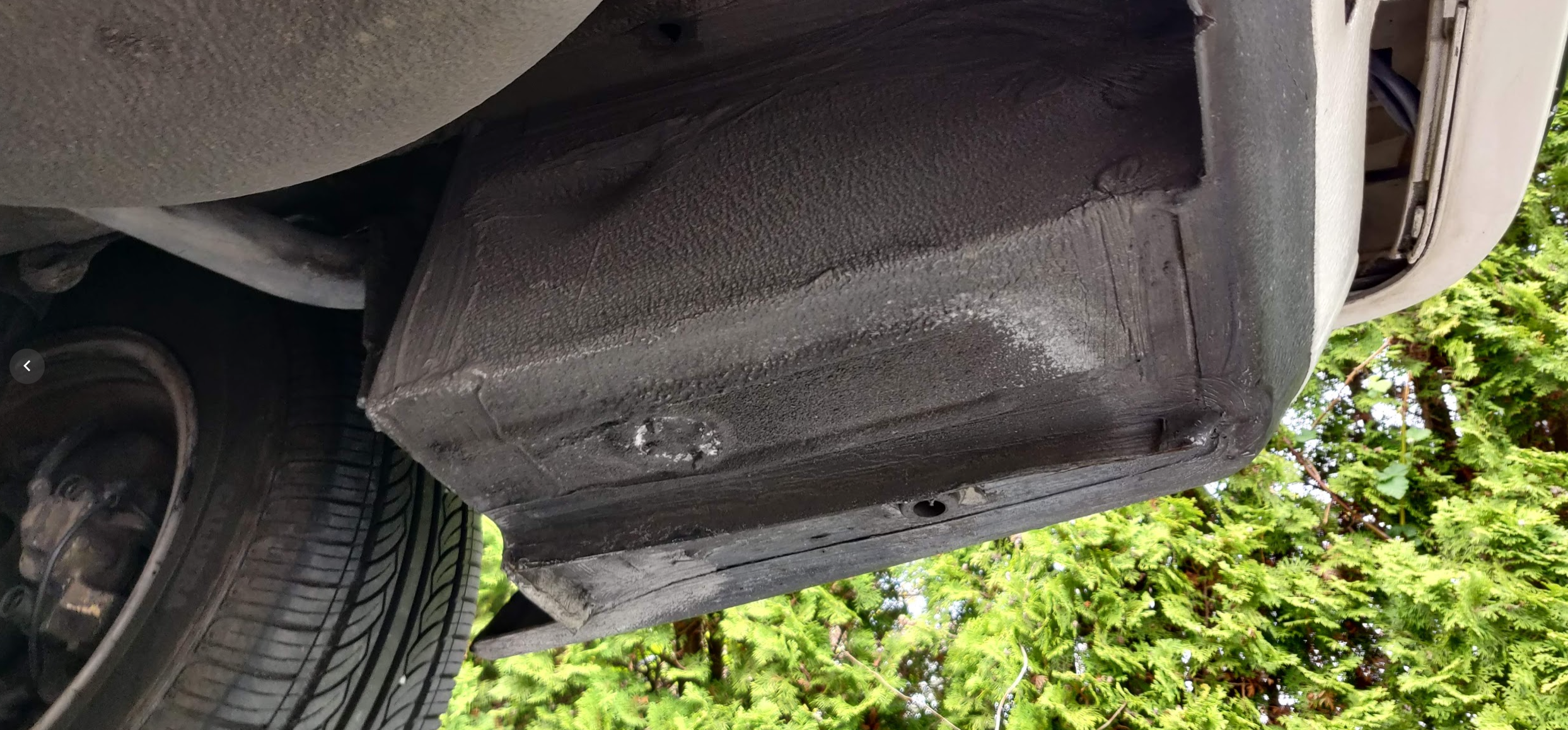

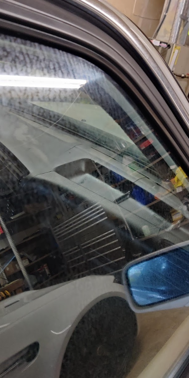

<p dir="auto">I didn't know how hard water could be holy crap. Tried vinegar and water, WD40 (internet for ya...), CLR, and eventually was direct by the fine folks of WiBimmers to quit messing around and get the DA and buffing cutting compound out. <br />
<a href="/assets/uploads/files/monthly_2021_11_image.png.3774a405d55e4ebe7eae857c6959714a.png"><img src="/assets/uploads/files/monthly_2021_11_image.thumb.png.b1e8ae138c8534f300a37131169cd681.png" alt="image.png" class=" img-fluid img-markdown" width="376" height="750" /></a></p>
<p dir="auto">Some amount of time later I had part of one window done. That stuff really clings on for dear life! It's looking like about 50% of the car will need this treatment. <br />

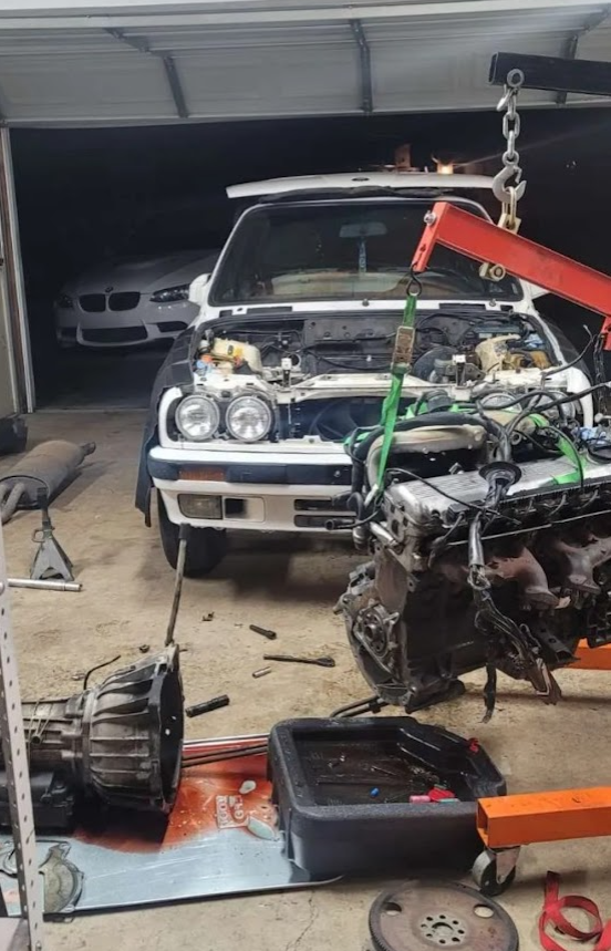

<p dir="auto">The S52 is finally at a point where I am comfortable bringing it over to this chassis, but I have realized this chassis is nowhere near ready for that kind of power. <br />
I wish it was as simple as just swapping front and rear subframes from the other E30, but I have a no rust situation going on that I would love to keep, so I will be sourcing all new parts once again. I think I will be making a big black Friday splurge for poly bushings for all areas of the car. </p>
<p dir="auto">I am very tempted to pull the engine out of this early, stash it, and get to work on the cosmoline and non shiny engine bay... I really enjoyed doing the last bay shave + paint and think I could do better a second time around. A truly horrible place to work in once painted though, as panic is constant about dropping a wrench! </p>
