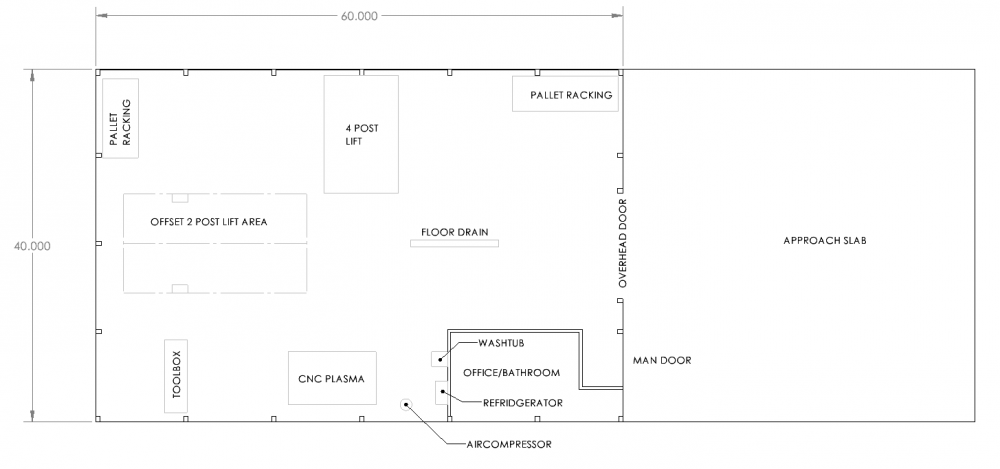

<p dir="auto">Been working on it over the years and I'm about to start finishing the walls and kinda 'finalize' how it will work.  I wanted to get others opinion on what you'd do.</p>
<p dir="auto">Here is the current set-up:</p>
<p dir="auto"><a href="/assets/uploads/files/monthly_2021_02_image.png.a4ac6259b99b02f7fd0a369877ef6dac.png"><img src="/assets/uploads/files/monthly_2021_02_image.thumb.png.82701ed0790604fb520cb4000bf2b9b0.png" alt="image.png" class=" img-fluid img-markdown" width="1000" height="469" /></a></p>
<p dir="auto">The office bathroom is there, can't be moved.  Same with the floor drain, Air compressor and wash tub.....well, I suppose since the plumbing isn't done, the washtub could move, but not very far.</p>
<p dir="auto">The 2 post lift is installed, but could move if I really had too.  It would be a pain because of the electric and air drops to that location.</p>
<p dir="auto">The pallet racks can move with a lot of effort and emptying them.</p>
<p dir="auto">The 4 post lift and toolbox are easily moveable (on casters), but need to be considered because of the size.</p>
<p dir="auto">The CNC plasma will most likely be coming to the workshop at my office sometime this year.  The electric for the plasma/welder is right there.</p>
<p dir="auto">Right now the lawn equipment takes up the space in front of the pallet racking in the upper right corner.  Keeps it easily accessible.</p>
<p dir="auto">I might add another overhead door on the wall right where the 4 post lift is, but that is a big maybe.</p>
<p dir="auto">My initial thoughts were to add shelving and work benches in the corner over by the toolbox.  Then maybe more benches/sandblaster/other mounted tools over in front of the upper left pallet racking.</p>
<p dir="auto">Any thoughts?</p>
<p dir="auto">Thanks in advance.</p>

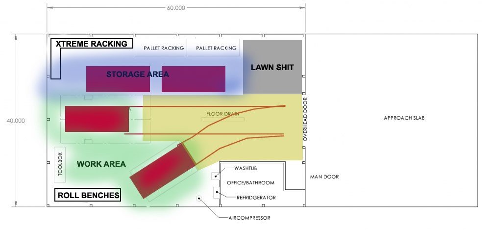

<p dir="auto">yellow area = clear area. gives access for vehicles and equipment into both lifts, lawn area and storage area.</p>
<p dir="auto">also  the "work area" with tool boxes and work benches are near both lifts</p>
<p dir="auto">the storage area leaves room for storage of one or two more vehicles in the inevitable event you have that need, and is also easy to just drive into (no jostling if the clear area is clear) <img src="/assets/uploads/files/monthly_2021_02_garage.jpg.b715815d8af0b84f47fc1f3bb33e3fa7.jpg" alt="garage.jpg.b715815d8af0b84f47fc1f3bb33e3fa7.jpg" class=" img-fluid img-markdown" width="1000" height="469" /></p>

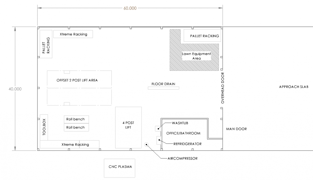

<p dir="auto"><strong><a href="/post/108921">REKIII said:</a></strong></p>
<p dir="auto">I changed some things around.</p>
<p dir="auto">I moved the toolbox to the back wall.  Close to the lift, but not in front of it.</p>
<p dir="auto">I added some of the extreme racking.  Assume it would be a bench with storage below and then storage up high.</p>
<p dir="auto">I added what I call 'roller benches'  I'm thinking they could be made with extreme racking or lumber, and essentially be heavy duty benches with large lock-able casters.  Then I could move them to a particular project in a different area if needed.</p>
<p dir="auto">I added some additional racking that could be benches along the north wall (as the pic is oriented).  There would still be enough room to park a vehicle next to the lift.</p>
<p dir="auto">Then I slid the 4 post over to where the CNC plasma was (for the future plan of moving it to the office shop).  It is 102" wide.  This would allow easier swing in and back onto the lift.</p>
<p dir="auto">I added my lawn equipment area.  Big 60" Hustler zero turn, dump cart, wheelbarrow, rototiller etc takes up a lot of space....</p>
<p dir="auto">Thoughts?</p>
<p dir="auto"><a href="/assets/uploads/files/monthly_2021_02_image.png.8b9783a1a374921c59677ae2ea8c2c20.png"><img src="/assets/uploads/files/monthly_2021_02_image.thumb.png.81ff62d99b535a3a34ec333f3d4256d6.png" alt="image.png" class=" img-fluid img-markdown" width="1000" height="575" /></a></p>
<p dir="auto">Looks like you are more efficiently using the space compared to the last design! Good stuff!</p>

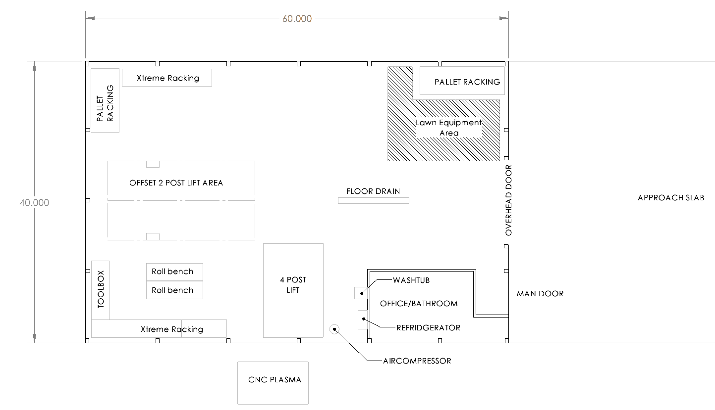

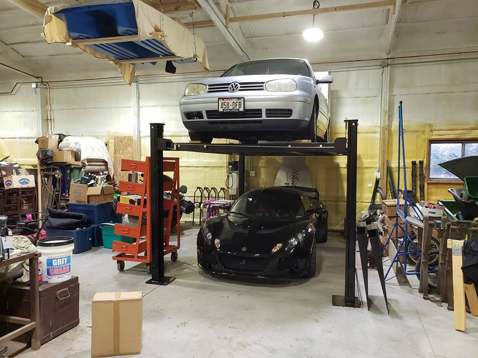

<p dir="auto">Here is a pic of the 4 post:</p>
<p dir="auto"><img src="/assets/uploads/files/monthly_2021_02_lift.jpg.f25250de7b4c02501a5933606a9ced46.jpg" alt="lift.jpg" class=" img-fluid img-markdown" width="960" height="720" /></p>
<p dir="auto">I'll agree 100%, where I have it right now is not ideal for getting cars on and off of it, or under it.  I has to use my tire dollies to slide the vehicles into place.  It was the most convenient place for it at the time.</p>

<p dir="auto">What are you using the pallet racking for? Actual pallets of stuff, or random storage? My thought right now is the orientation of the 4-post lift, it seems like it might be a bit of a pain to jockey cars in and out with that 90 degree turn. I’d be inclined to keep it as more of a straight shot, but visualizing the amount of room you have may be deceiving me lol. I would be inclined to put the 4-post parallel to the 2-post in the corner there where the pallet racking is, then move all the pallet racking to the “north” wall, with maybe one rack in the southwest corner for storing raw material or small items. </p>
<p dir="auto">I’d say toolbox would work where it is, or maybe put it in the northwest corner in front of the 4 post for easy access. Then you could have the southwest corner for the CNC stuff, any blast equipment, etc. and could even put up partitions between that stuff and the lifts to keep metal and debris off the cars. Kinda depends on how big the toolbox is and which lift you’ll be using to wrench on stuff more.</p>
<p dir="auto">Whatever you go with, that’s going to be a really sweet setup, I look forward to seeing it progress! If it’s anything like your basement project, I think I’m going to like it.</p>
