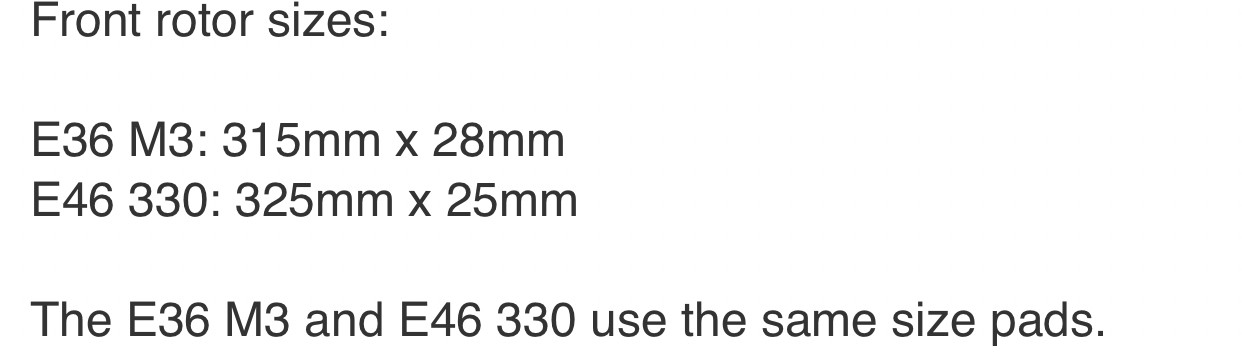

<p dir="auto"><strong><a href="/post/107992">jc43089 said:</a></strong></p>
<p dir="auto">Some 16" wheels will fit and some won't.  I have test fitted 16" Contour reps and they do fit over e46 330 brakes.  Not sure what others do.</p>
<p dir="auto">I'm actually researching this right now. My wheel choice is e38 style 5 (16x8 et23). </p>
<p dir="auto">-e46 325 front brake rotors are 300 x 22mm</p>
<p dir="auto">-e46 330 front brake rotors are 325 x 25mm (as Mitch noted^) and there's a really good chance my wheels won't clear these. </p>
<p dir="auto">-e36 m3 front brake rotors are 315 x 28mm (as Mitch noted ^), I don't think these would fit either ( might be close). </p>
<p dir="auto">After much thought all day with the help from <a class="plugin-mentions-user plugin-mentions-a" href="/user/kaiserrolls" aria-label="Profile: KaiserRolls">@<bdi>KaiserRolls</bdi></a> &amp; <a class="plugin-mentions-user plugin-mentions-a" href="/user/m42b32" aria-label="Profile: m42b32">@<bdi>m42b32</bdi></a> I think I will end up going with the IRP 5 lug conversion kit and run the e46 325 calipers/rotors. These will be a decent upgrade from the e30 260 x 22mm rotor and in fact, the e46 325 setup will be 1/10th of the price of a massive BBK which is also only 300 x 22mm!</p>
<p dir="auto">In closing, I'm going to mark this thread as closed and thank you all for the information. Appreciate it...</p>
<p dir="auto">-Nick</p>

<p dir="auto"><strong><a href="/post/107977">Nick_08 said:</a></strong></p>
<p dir="auto">Thank for sharing. Yes, 5 lug swap so I can ditch the 18mm adapters and get the benefit of the bigger brake package. Can I ask, are the e46 brakes around the same size as the e36m3? Thanks <a class="plugin-mentions-user plugin-mentions-a" href="/user/m42b32" aria-label="Profile: m42b32">@<bdi>m42b32</bdi></a>!</p>
<p dir="auto">17yo forum post</p>
<p dir="auto"><a href="/assets/uploads/files/monthly_2020_10_184446A7-E81C-45FD-8B0A-716045EA3462.jpeg.c38c9eaa5cdde875a9fc5d4920629010.jpeg"><img src="/assets/uploads/files/monthly_2020_10_184446A7-E81C-45FD-8B0A-716045EA3462.thumb.jpeg.a36c90054e4c33b306188bee8f377ca5.jpeg" alt="184446A7-E81C-45FD-8B0A-716045EA3462.jpeg" class=" img-fluid img-markdown" width="1000" height="284" /></a></p>

<p dir="auto"><strong><a href="/post/107975">m42b32 said:</a></strong></p>
<p dir="auto">Doing 5-lug swap? I've heard good things about these kits and am considering switching to this setup: <a href="https://www.irp.lt/individual-racing-parts-product/5-lug-kit-to-use-e36-e46-wheel-bearings-and-brakes/" rel="nofollow ugc">https://www.irp.lt/individual-racing-parts-product/5-lug-kit-to-use-e36-e46-wheel-bearings-and-brakes/</a></p>
<p dir="auto">Lets you retain stock geometry, but can then run e46 330 brakes </p>
