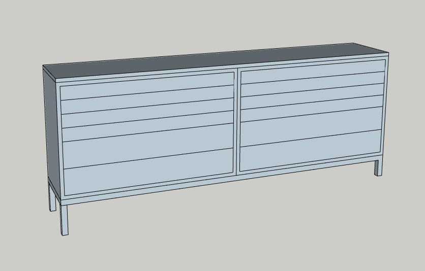

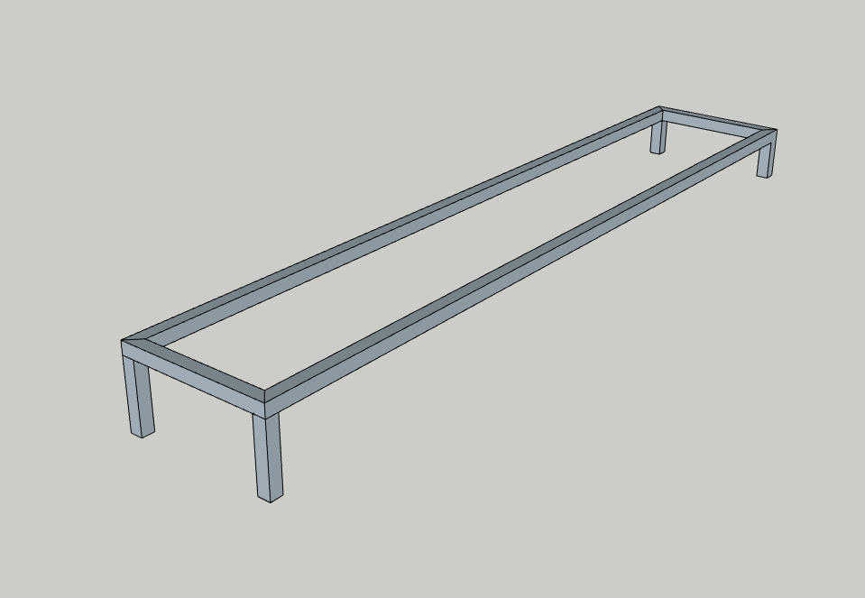

<p dir="auto">I think something like this would work best. Some square tubing that the boxes can sit on, and then legs either cut to fit my floor or close enough that I can than put adjustable legs on this. Looking for any advice or if others have their own solutions? I know I could just use some wood blocks and whatnot, but I would like this to be functional and look good at the same time. I'm putting a lot of effort into the garage for its remake and don't want to half ass this. </p>
<p dir="auto"><img src="/assets/uploads/files/monthly_2020_09_image.png.2192d7e64f2a41c3b4b1bde61cbd77b9.png" alt="image.png" class=" img-fluid img-markdown" width="959" height="663" /></p>
<p dir="auto"><img src="/assets/uploads/files/monthly_2020_09_image.png.45f14e3edb5d9d4a0f0d5eca512d0b74.png" alt="image.png" class=" img-fluid img-markdown" width="836" height="534" /></p>

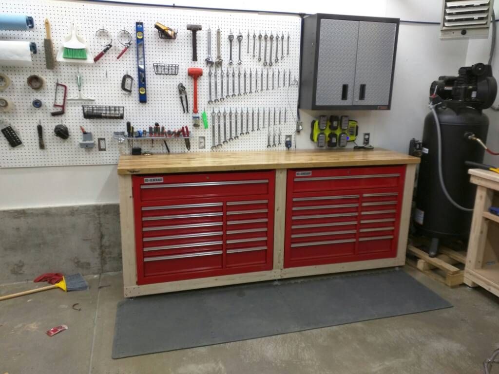

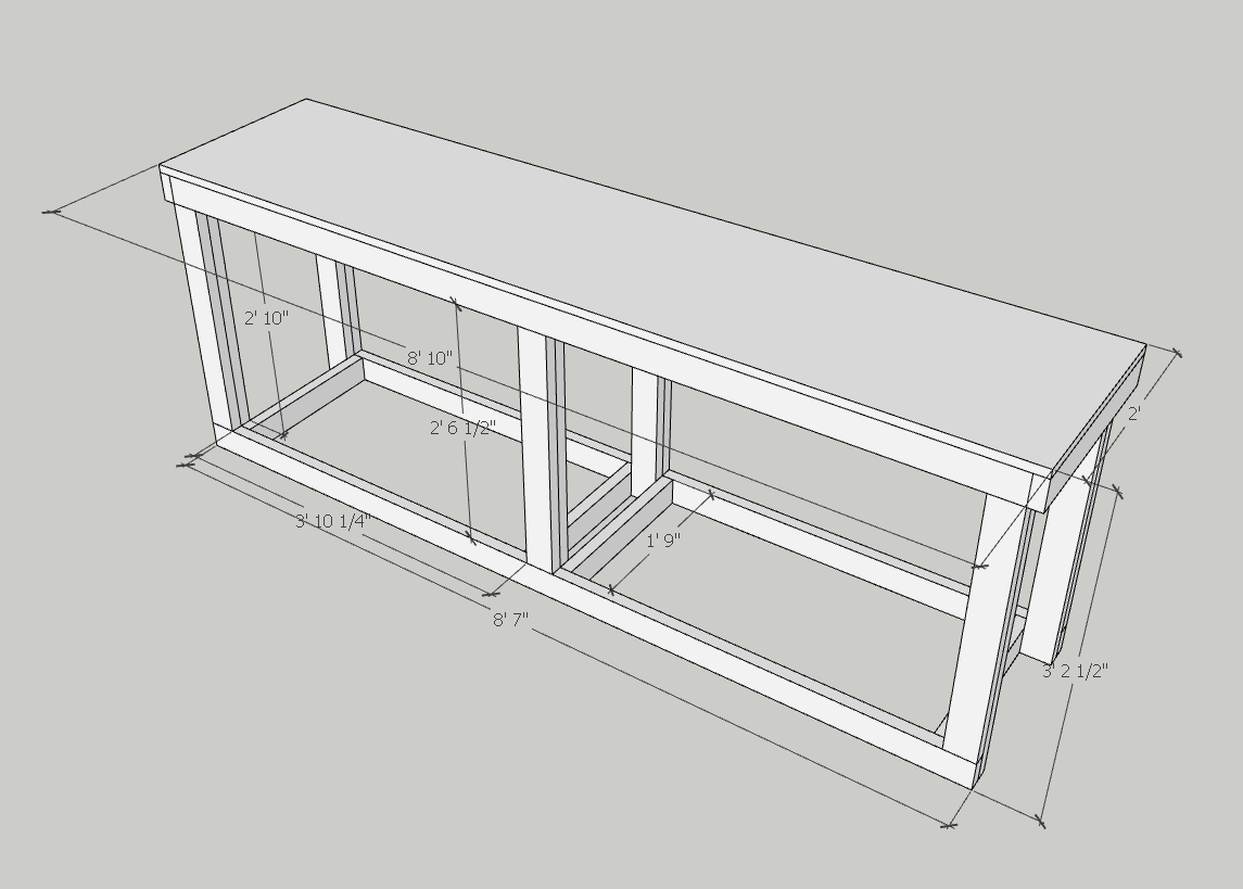

<p dir="auto">Here's a drawing for a workbench with two 46' tool chests if anyone wants it. </p>
<p dir="auto"><a href="/assets/uploads/files/monthly_2020_09_image.png.5c9a07bc8ce56331728b5aa525924dbd.png"><img src="/assets/uploads/files/monthly_2020_09_image.thumb.png.8f2fec18c1246c1239953c9c739d5cb1.png" alt="image.png" class=" img-fluid img-markdown" width="1000" height="716" /></a></p>

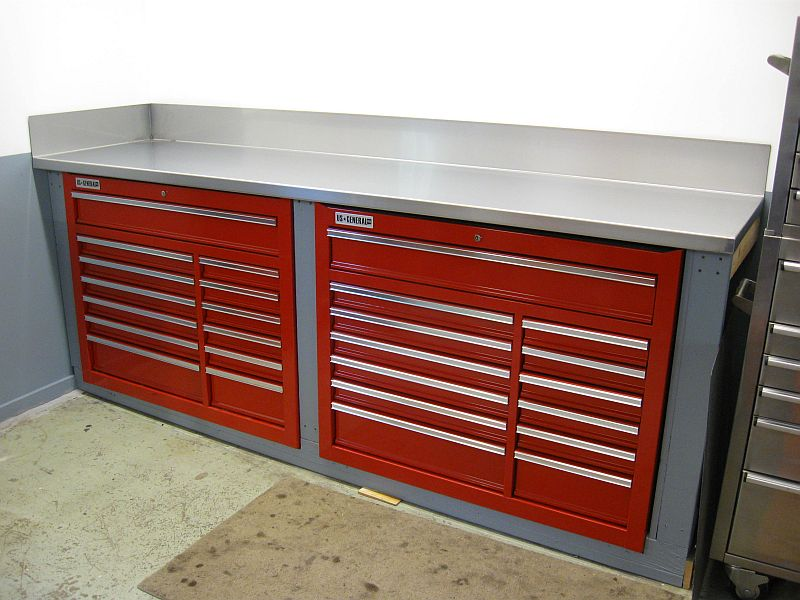

<p dir="auto"><a href="/assets/uploads/files/monthly_2020_09_image.jpeg.bd7951e29d9fcb14165f502d67a3b40a.jpeg"><img src="/assets/uploads/files/monthly_2020_09_image.thumb.jpeg.3e81ba701b98c67fa94994fa6dc4849b.jpeg" alt="image.jpeg" class=" img-fluid img-markdown" width="1000" height="750" /></a></p>
<p dir="auto">I found this example that I like.</p>
