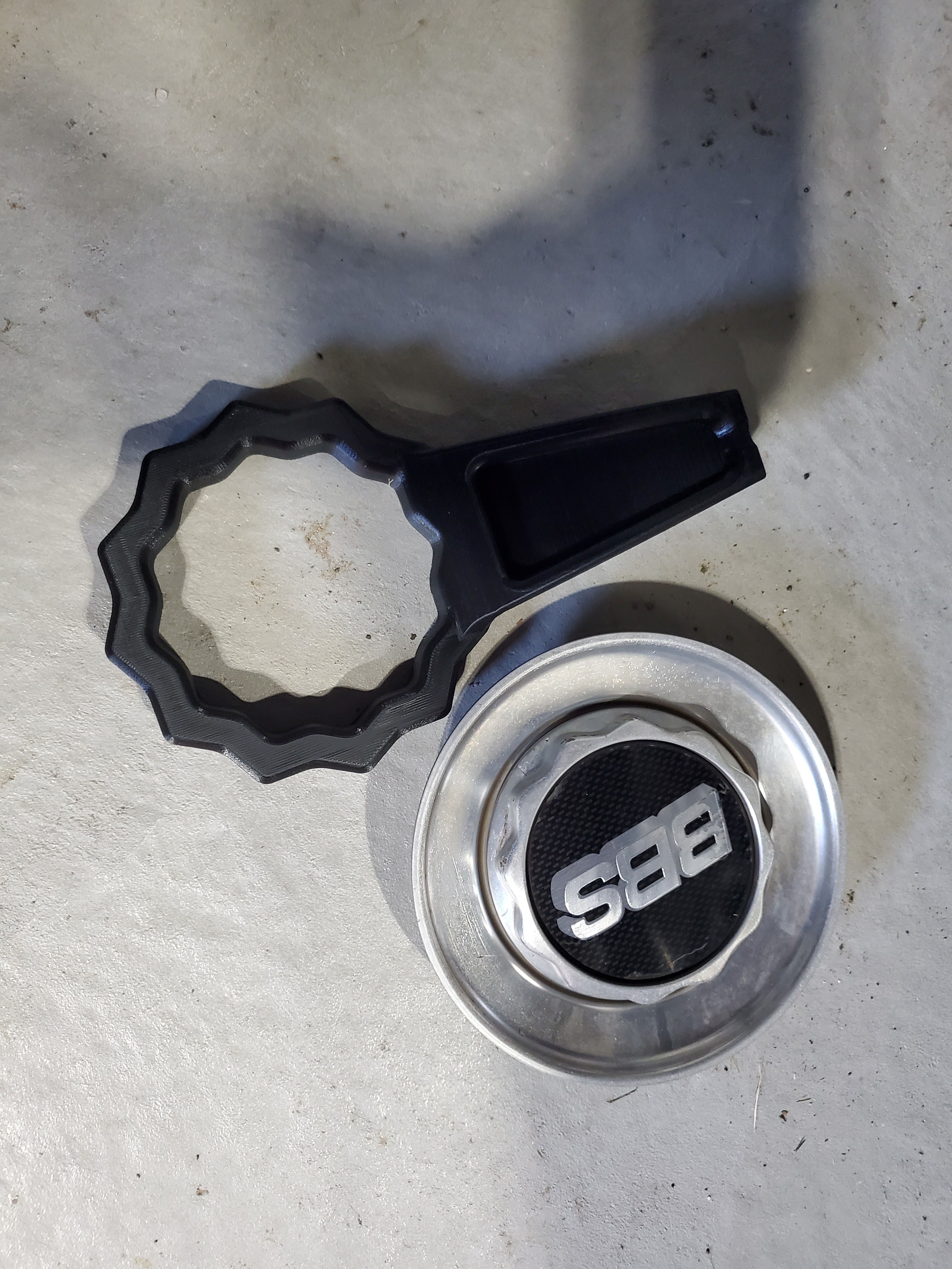

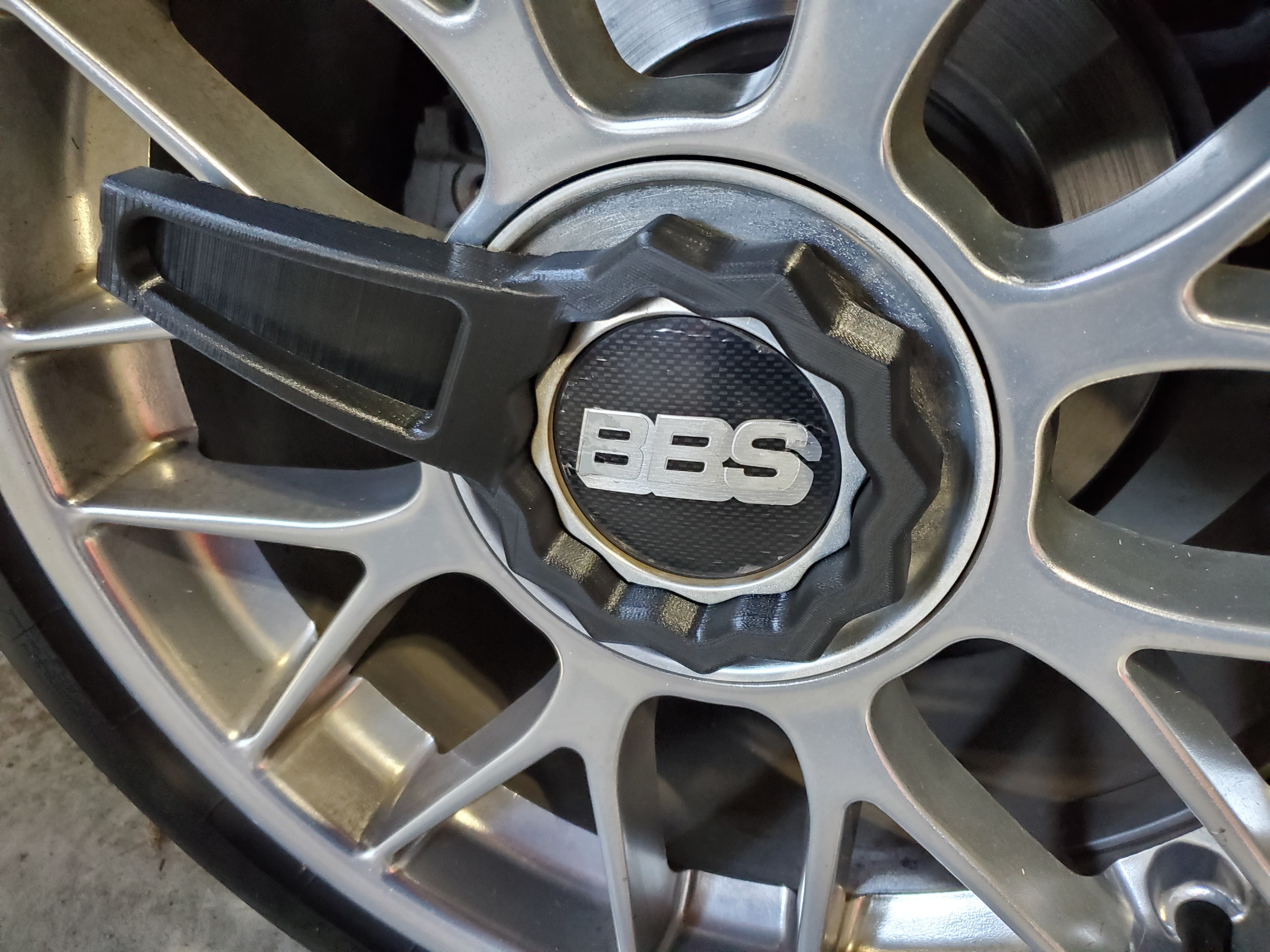

<p dir="auto"><strong><a href="/post/106792">Nick_F said:</a></strong></p>
<p dir="auto">if it doesnt work you can send me the file and I can print it at work</p>
<p dir="auto">Thanks! I wanted to give it a whirl on my machine to see if it was capable or not. I'm very impressed. </p>
<p dir="auto">If anyone needs the 6pt wrench I originally printed, let me know. I have no need for it.</p>

<p dir="auto"><a href="/assets/uploads/files/monthly_2020_07_20200708_065822.jpg.1cf8f122fe474244bd05a849c146128e.jpg"><img src="/assets/uploads/files/monthly_2020_07_20200708_065822.thumb.jpg.2cf9e2b3376e8af301590adfbd337f6f.jpg" alt="20200708065822.jpg" class=" img-fluid img-markdown" width="1000" height="750" /></a></p>
<p dir="auto"><a href="/assets/uploads/files/monthly_2020_07_20200708_065910.jpg.8f5734ed096cdd9f37c00ede9128d0f0.jpg"><img src="/assets/uploads/files/monthly_2020_07_20200708_065910.thumb.jpg.885930f957762d2a74d1913aefe3595b.jpg" alt="20200708065910.jpg" class=" img-fluid img-markdown" width="1000" height="750" /></a></p>
<p dir="auto"><a href="/assets/uploads/files/monthly_2020_07_20200708_065930.jpg.f9d27b3a12a184cfa59fdcf16c3aa6e2.jpg"><img src="/assets/uploads/files/monthly_2020_07_20200708_065930.thumb.jpg.fd485b477614f177af684fe39d49341a.jpg" alt="20200708065930.jpg" class=" img-fluid img-markdown" width="563" height="750" /></a></p>
]]></description><link>https://wibimmers.com/post/106793</link><guid isPermaLink="true">https://wibimmers.com/post/106793</guid><dc:creator><![CDATA[Bassboy3313]]></dc:creator><pubDate>Wed, 08 Jul 2020 12:07:01 GMT</pubDate></item><item><title><![CDATA[Reply to BBS RC Center Cap Wrench on Wed, 08 Jul 2020 12:06:17 GMT]]></title><description><![CDATA[<p dir="auto">if it doesnt work you can send me the file and I can print it at work</p>

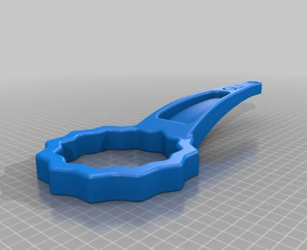

<p dir="auto"><img src="https://lh3.googleusercontent.com/-48K_Xri36GM/XwSW-pUXVaI/AAAAAAAAKFk/-vd6fO9MGPczMWj2_cAOleqvqg6cMDgXACK8BGAsYHg/s512/2020-07-07.jpg" alt="2020-07-07.jpg" class=" img-fluid img-markdown" /></p>
<p dir="auto">I feel like an idiot tho. The 12pt wrench 3D file that I found which I thought was for a smaller size, is actually the correct size. My 3D print program autoscaled it down to 65% to fit my print bed. When I bring it back up to 100% scaled, it is too large for my printer no matter how I rotate it. My solution, chop the handle down an inch or so and rotate it to fit the print volume and use supports.</p>
<p dir="auto">Original</p>
<p dir="auto"><img src="/assets/uploads/files/monthly_2020_07_image.png.8369697b834f54b728c6acdb7dd91ce4.png" alt="image.png" class=" img-fluid img-markdown" width="605" height="493" /></p>
<p dir="auto">After chopping the handle down to fit</p>
<p dir="auto"><img src="https://lh3.googleusercontent.com/-BXZaV84c0V0/XwSW_fi1TYI/AAAAAAAAKFs/Xid_7FAFAbs3449C68ztsSHMmRCPrcsFACK8BGAsYHg/s512/2020-07-07.jpg" alt="2020-07-07.jpg" class=" img-fluid img-markdown" /></p>
<p dir="auto"><img src="https://lh3.googleusercontent.com/-SScezpoE7lg/XwSXCSDDxdI/AAAAAAAAKGA/cu6q_O4tIBsyT3tetAKIIlMFklZOGEqUACK8BGAsYHg/s512/2020-07-07.jpg" alt="2020-07-07.jpg" class=" img-fluid img-markdown" /></p>
<p dir="auto">And showing the 3D print layers with support material</p>
<p dir="auto"><img src="https://lh3.googleusercontent.com/-jnku60tB-cM/XwSXB0Q8XLI/AAAAAAAAKF4/0IERvjyXz-8S4VNDWzQR8LBrFDfS9H8bgCK8BGAsYHg/s512/2020-07-07.jpg" alt="2020-07-07.jpg" class=" img-fluid img-markdown" /></p>
<p dir="auto">Just hit go on a 21 hour print, so we shall see how it turns out.</p>
