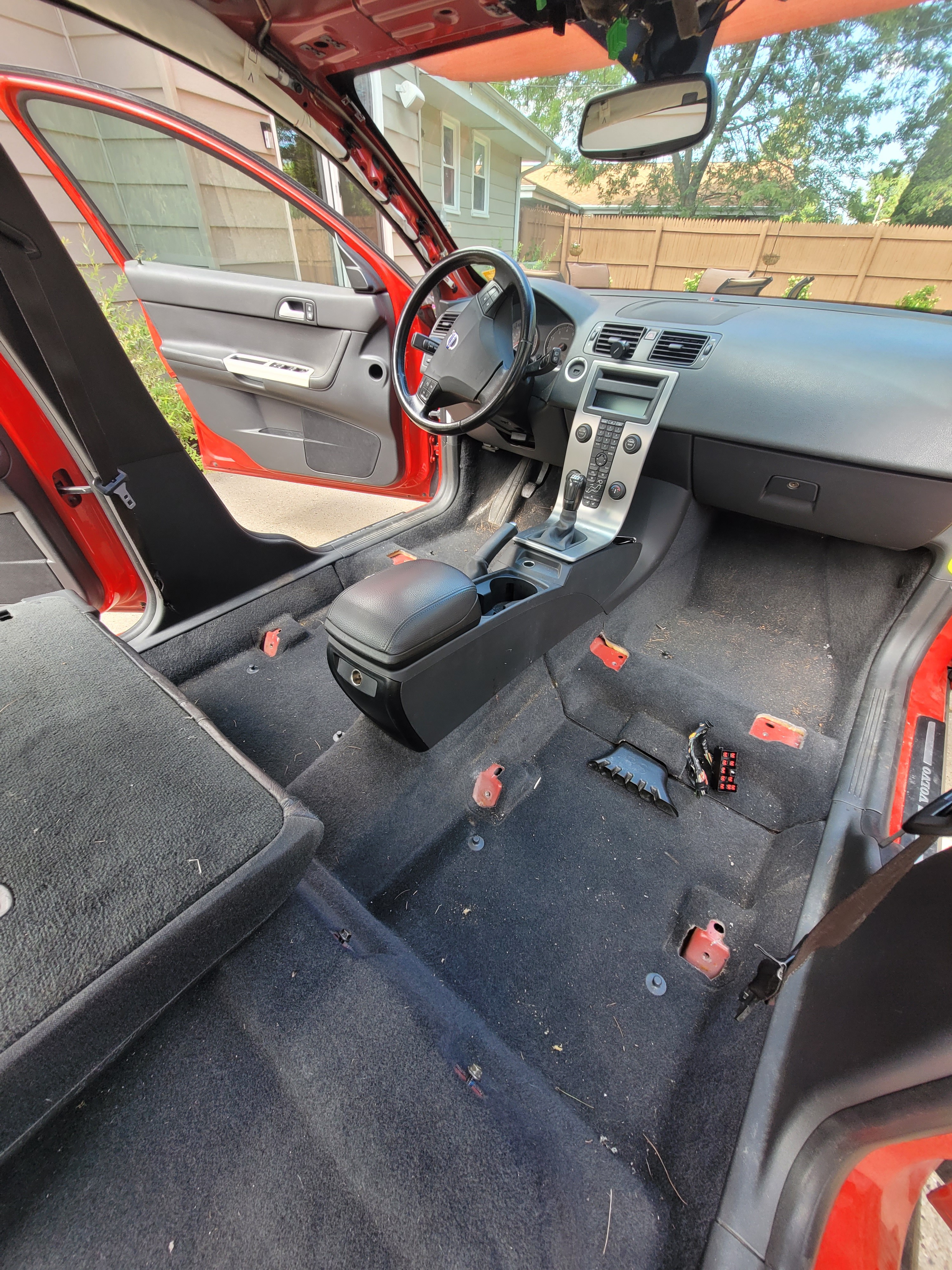

                                          well after a year (since i fixed the water leak), the musty car smell remained in the v50 and  i decided to bite the bullet and get the carpet completely out to dry. i thought the carpet was still wet from the original leak (there is a lot of foam underneath) but it turns out that it was still actively getting wet from:
                                          1. The AC drain was plugged and dripping water into the cabin and
                                          b) one of the two rear sunroof drains was also plugged and leaking.
                                          i didnt think to take pictures of the process, but it was pretty easy. Be sure to disconnect the battery before removing the front seats for all the airbag sensors.
                                          Remove: rear seat, front seats, center waterfall and console, 4x door sill plastic covers.
                                          Fix: detach and blow out the drain lines with compressed air.
                                          Test: set a sprinkler on top of your car and run it for awhile.
                                          I definitely miss how BMW stuck to fewer sizes of fasteners. (everything was always 10mm, 13mm, 15mm, 17mm)   There are fasteners of all sizes so its harder to tell at a glance what your dealing with (10, 12, 13, 14, 15, 16, 17 all needed for interior work)
