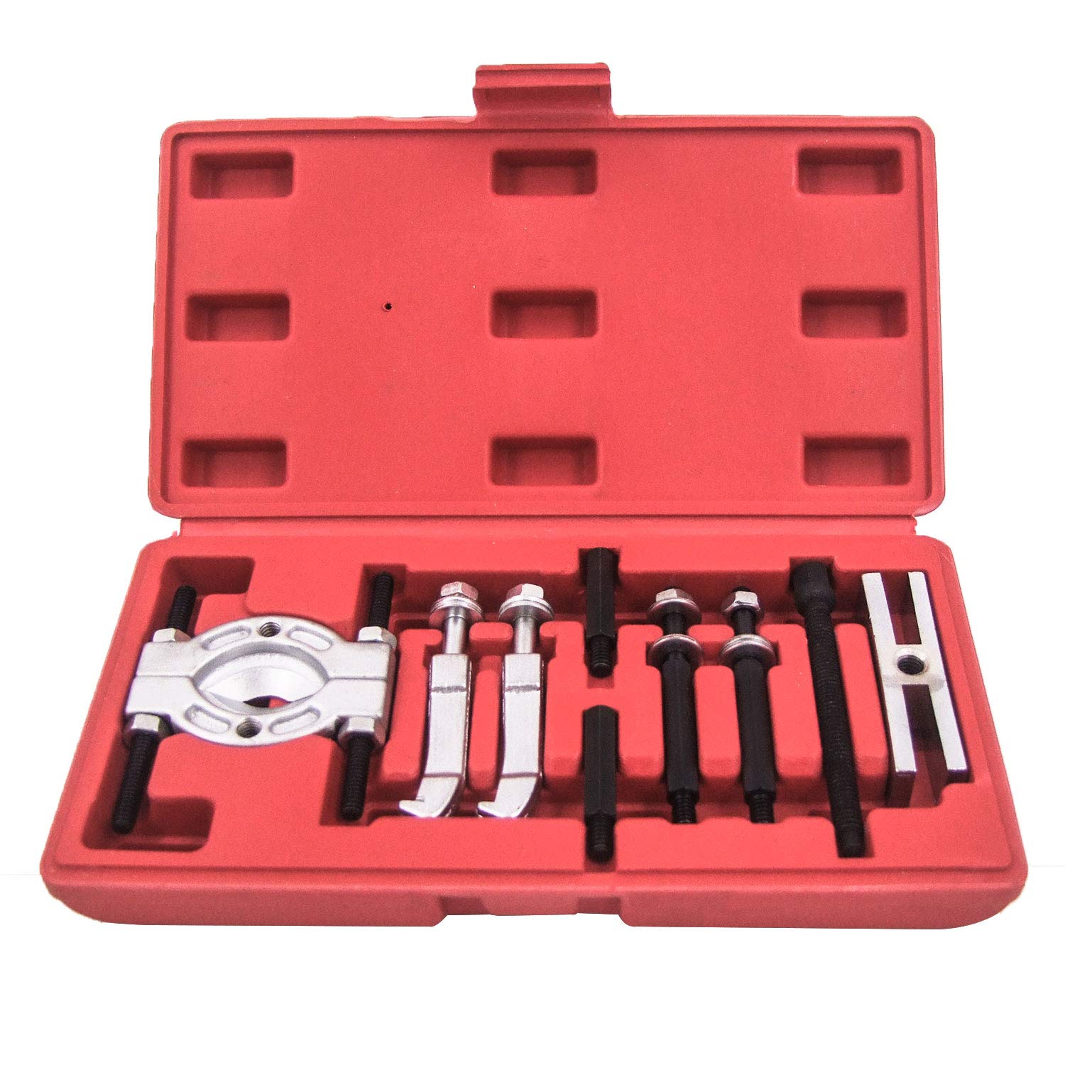

]]></description><link>https://wibimmers.com/topic/5703/wanted-to-borrow-e30-rear-wheel-bearing-tool</link><generator>RSS for Node</generator><lastBuildDate>Wed, 16 Sep 2026 08:08:03 GMT</lastBuildDate><atom:link href="https://wibimmers.com/topic/5703.rss" rel="self" type="application/rss+xml"/><pubDate>Mon, 19 Aug 2019 22:33:31 GMT</pubDate><ttl>60</ttl><item><title><![CDATA[Reply to Wanted to borrow: e30 rear wheel bearing tool on Tue, 20 Aug 2019 15:45:02 GMT]]></title><description><![CDATA[<p dir="auto">easy, with the right tools.  i just watched a video for an e46, the process is identical.</p>
<p dir="auto"><strong>The tools i had to buy (didnt cost much)</strong></p>
<p dir="auto"><em>1. FWD bearing puller kit, Amazon -</em> <em>$60  (you might even be able to rent this, not sure)</em></p>
<p dir="auto"><a href="https://www.amazon.com/Bearing-Adapters-Replacement-Installer-Removal/dp/B07GTDV1N2/ref=asc%5C_df%5C_B07GTDV1N2/?tag=hyprod-20&amp;linkCode=df0&amp;hvadid=241973068692&amp;hvpos=1o4&amp;hvnetw=g&amp;hvrand=6867693999644880277&amp;hvpone=&amp;hvptwo=&amp;hvqmt=&amp;hvdev=c&amp;hvdvcmdl=&amp;hvlocint=&amp;hvlocphy=9018836&amp;hvtargid=pla-571930072983&amp;psc=1" rel="nofollow ugc">https://www.amazon.com/Bearing-Adapters-Replacement-Installer-Removal/dp/B07GTDV1N2/ref=asc\_df\_B07GTDV1N2/?tag=hyprod-20&amp;linkCode=df0&amp;hvadid=241973068692&amp;hvpos=1o4&amp;hvnetw=g&amp;hvrand=6867693999644880277&amp;hvpone=&amp;hvptwo=&amp;hvqmt=&amp;hvdev=c&amp;hvdvcmdl=&amp;hvlocint=&amp;hvlocphy=9018836&amp;hvtargid=pla-571930072983&amp;psc=1</a></p>
<p dir="auto"><em>2. Ford front hub (axle) puller, eBay - $17 (verified it works for e30 rear axles)</em> </p>
<p dir="auto"><a href="https://www.ebay.com/itm/Ford-Front-Hub-Installer-3020/231457913674?ssPageName=STRK%3AMEBIDX%3AIT&amp;%5C_trksid=p2057872.m2749.l2649" rel="nofollow ugc">https://www.ebay.com/itm/Ford-Front-Hub-Installer-3020/231457913674?ssPageName=STRK%3AMEBIDX%3AIT&amp;\_trksid=p2057872.m2749.l2649</a></p>
<p dir="auto"><strong>The tools i have to rent (free)</strong></p>
<p dir="auto"><em>1. 3-jaw puller</em></p>
<p dir="auto"><img src="https://images-na.ssl-images-amazon.com/images/I/81x91lj1qEL._SL1500_.jpg" alt="81x91lj1qEL.SL1500.jpg" class=" img-fluid img-markdown" /></p>
<p dir="auto"><em>2. Bearing separator</em></p>
<p dir="auto"><img src="https://images-na.ssl-images-amazon.com/images/I/712yM+zWFQL._SL1500_.jpg" alt="712yM+zWFQL.SL1500.jpg" class=" img-fluid img-markdown" /></p>
