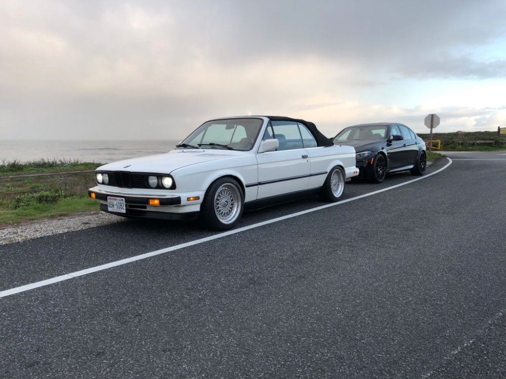

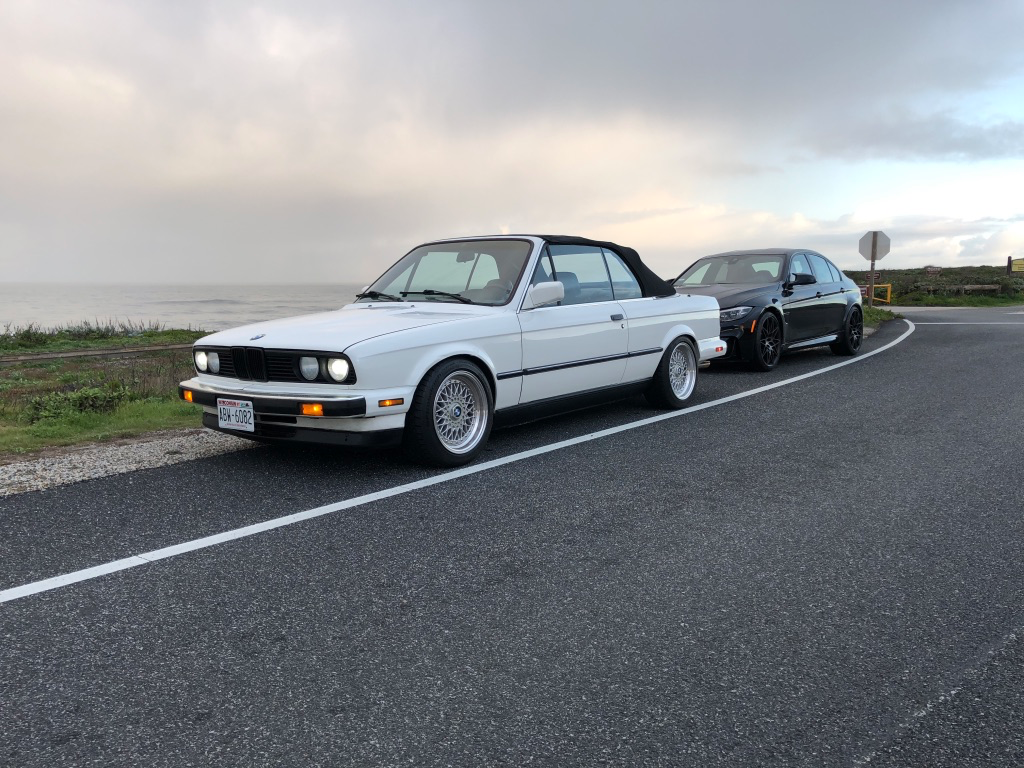

]]></description><link>https://wibimmers.com/post/99200</link><guid isPermaLink="true">https://wibimmers.com/post/99200</guid><dc:creator><![CDATA[P_Roloff]]></dc:creator><pubDate>Tue, 30 Apr 2019 01:51:27 GMT</pubDate></item><item><title><![CDATA[Reply to E30 A/C help needed - Madison on Tue, 30 Apr 2019 00:28:21 GMT]]></title><description><![CDATA[<p dir="auto">The patient:</p>
<p dir="auto"><a href="/assets/uploads/files/monthly_2019_04_image.png.32e940362feddc62ce9ebf2c132e4d5a.png"><img src="/assets/uploads/files/monthly_2019_04_image.thumb.png.005577f123cfd1c4c7560fa47fb92a63.png" alt="image.png" class=" img-fluid img-markdown" width="1000" height="750" /></a></p>
