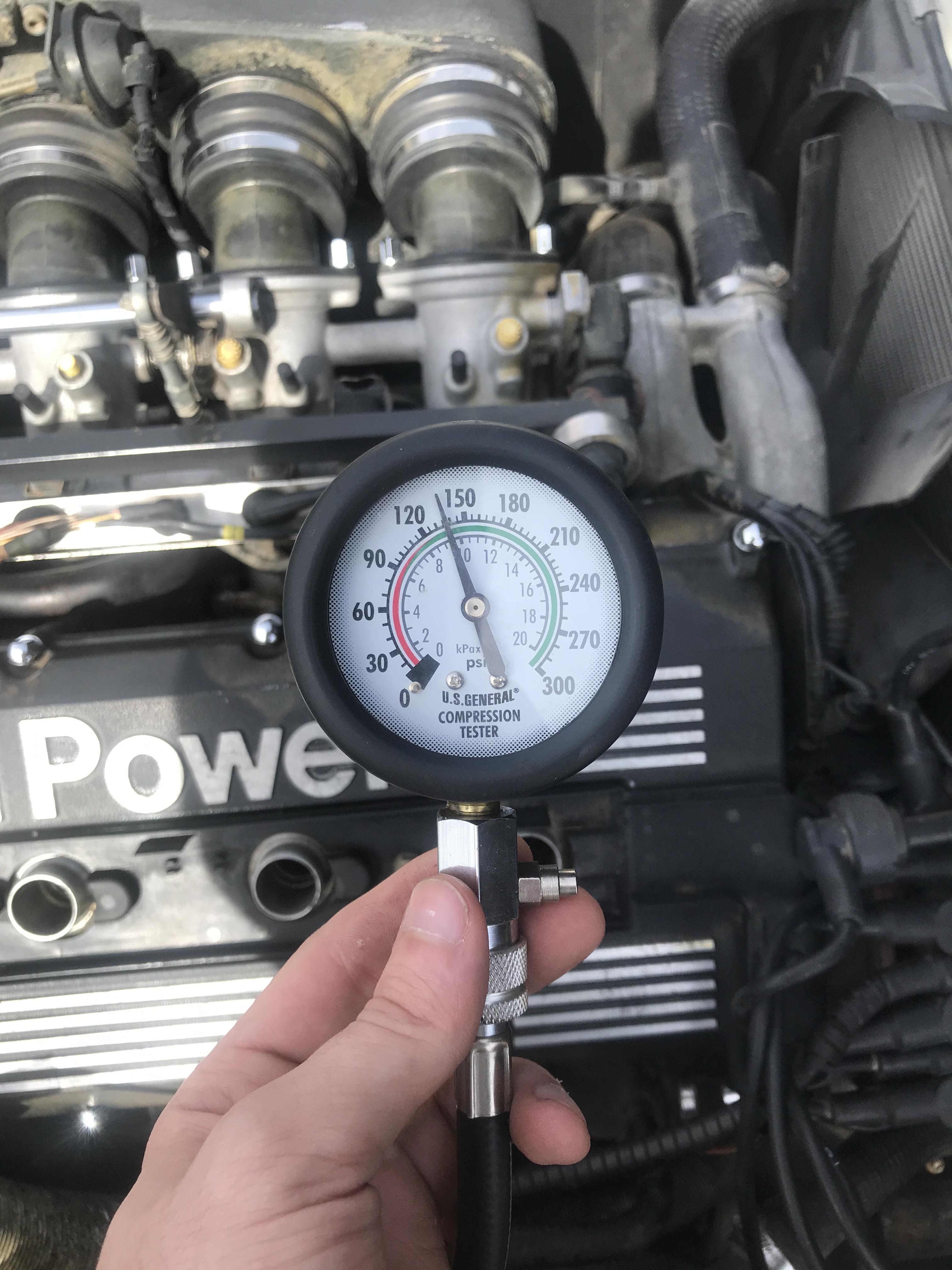

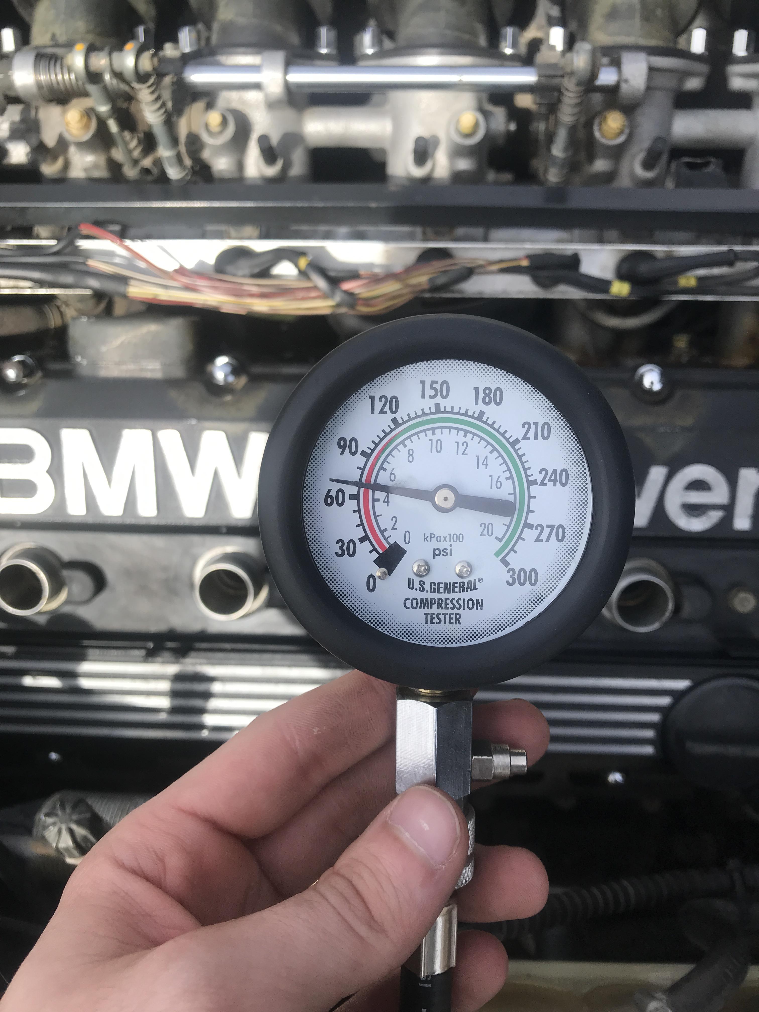

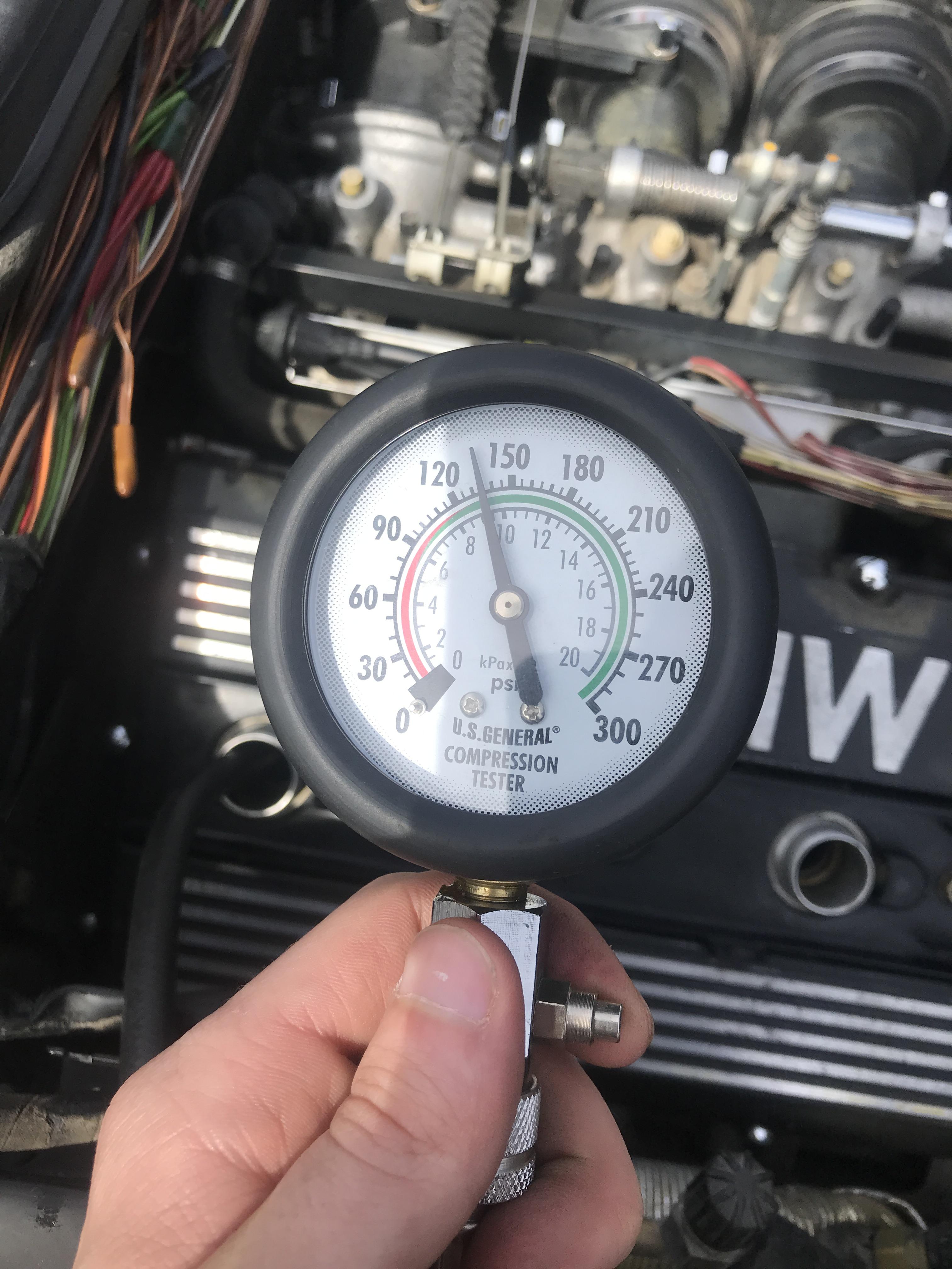

                          Well I got around to compression testing the motor this morning.
                          Test was dry and cold but
                          Cylinder #1 gave false hope, decent number for a cold motor?
                          Cylinder #2-4 crushed my dreams, I triple checked all of them and they were in the 60-70psi range
                          And back to a more normal number in cylinder #6...
                          I made sure to check each cylinder multiple times in different orders to make sure it wasn't user or equipment error
                          So yea thats bad.

                                        Could it just need a valve adjustment?  If the valves aren't closing all the way that would be a problem!
                                             @DrLeadFoot
                                          #40
                                          Valve adjustment would loosen up over time, not tighten up.
                                          adjacent cylinders usually indicates head gasket carnage.
                                          I feel it may be worthwhile to put some compressed air into the cylinders and see if its coming through the crankcase or radiator.
                                          dry/stuck rings, while less likely, can also be a thing.
